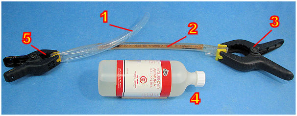

Ammonia is sometimes quoted to help in the bending of wooden strips.
Here is a simple method to use this product:
In a transparent plastic pipe (1), place the strips to be bent (2).
Fold and hold one end of the pipe with a strong clamp (3). Fill the pipe, in accordance with the length of the strips, with some ammonia (4).
Fold the other end of the pipe and hold it folded with another strong clamp (5).
Wait, according to the thickness of the strips, from half an hour to one hour.

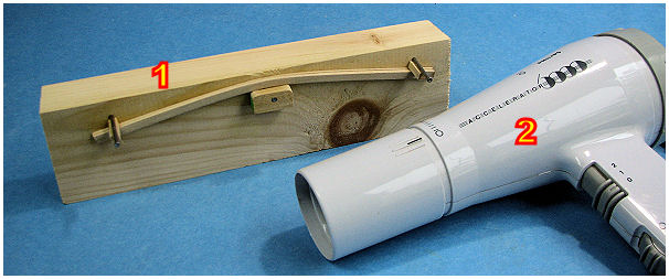

Then the strips are placed on a jig (1) reproducing the required curve.
A hairdryer (2) can accelerate the drying of the strips.
After a while (one night approximately), the strips are keeping exactly the curve of the jig.

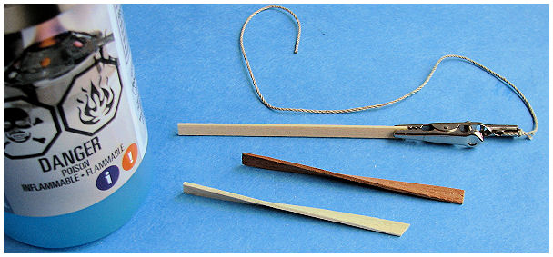

PostPosted: Wed Mar 14, 2007 7:55 pm    Post subject:
Wink
Just a small photo to remind that methylated spirit is much better than ammonia for bending wood. Odourless and drying very quickly.
- Five minutes soaking for whitewood.
- Ten minutes soaking for hard wood.
- Alligator clips and the small rope to keep the part in the heart of the container.
