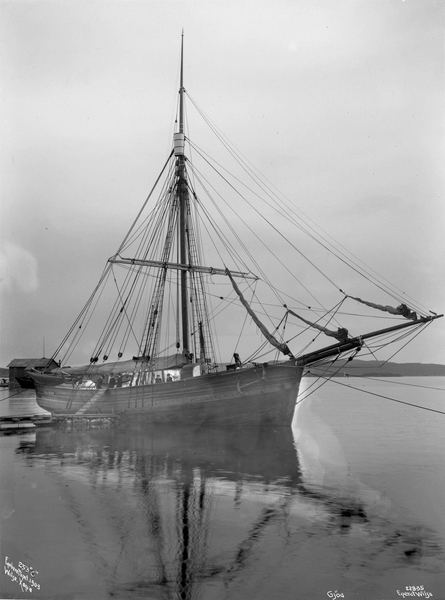

I base the rigging mainly on this image: http://digitaltmuseum.no/011014219978supplemented with numerous photographs of 4-5 still sailing vessels. There are some variations between the vessels in the details, but the overall rigging is quite similar. In addition Gjøa has recently been moved into a permanent indoor museum along with a partial restoration - the new fore rig seems identical to the linked contemporary picture.
There are two chain bobstays. The lower terminates in a tackle with double blocks, and can be re-tensioned with a lanyard, which I belayed on the rail on the windlass.
The dolphin striker was fabricated from a 1 mm brass rod tapered in each end, with a fastening bracket, fairlead and eyes cut and filed from brass sheet and soldered. The ball on the tip is a blob of solder, formed on the iron and carefully slipped onto the rod, careful not to heat too much to make it flow. The whole thing was painted white, as will be most of the iron work on the bowsprit and mast (for ref. caldercraft matt white). Chain martingales were "shackled" (read twisted copper wire with a little solder) to the aft eye and attached through a hole in the cat timbers in the other end. I used epoxy there. The front chain was attached to an eye in a band around the tip of the jib boom.
Whisker booms were made from 0.7 mm brass. The two hooks were made from a single piece .4 mm brass bent to shape and soldered to the boom. Where the two pieces attacked, I file the pieces flat (removed 1/3 of the material) for a good surface to solder and keep the diameter down. They were not attached to the cat timbers, as seen on some recent images, but through the rail a bit behind them. This appears to have been corrected on the real thing in the latest restoration as well. I haven't added any shrouds yet as I will wait until after the stays and anchors.
Below an image showing the current state. I have also attached gammoning and blocks for the jibs and square yard fore braces (the latter are the blocks on the sides of the tip of the bowsprit).  Still have some stray pieces of rope to cut, but I haven't got a good tool to do it with (my blunt scissors produced results for the bin), so it'll have to wait.
