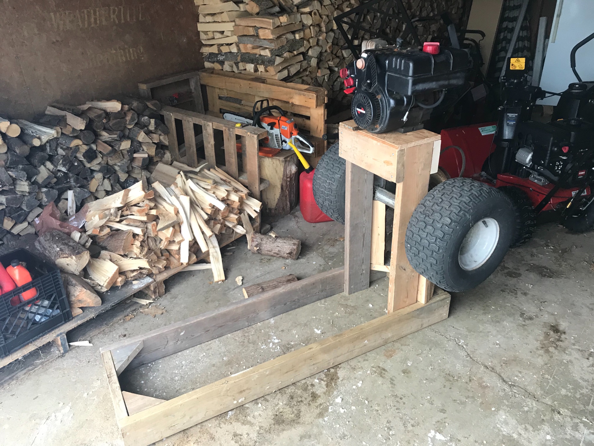

Taking some inspiration from some YouTube videos, I’ve started building my own rope tow.
The main mechanical components consist of a 10.5hp Tecumseh engine and the transaxle out of a lawn tractor. I had initially planned on using an old Ariens riding mower, however the cost of repairs just to get its engine running again were considerably more than I was willing to spend. The engine came out of a snowblower (bought it from the mechanic for a pretty good price), and it runs well. There’s more than enough power to haul up a few adults, and a few more kids.
This is where things stand with my rope tow so far. At the moment the engine and transaxle are just mocked up to give you the general idea. The wooden frame will require a bit more bracing, as well as some side stabilizers. A “V” belt will connect the engine and transaxle. The differential will be “locked” by stalling the unused wheel.

Well, all the construction I can do in my garage is now finished. Tomorrow I’ll disassemble the motor and axle, in preparation to haul the whole thing out to the hill.
The larger bracket, with the brace, will be fasten to a conveniently placed tree, and will guide the return rope clear of upwards riders. The sheave isn’t yet attached to the arm, that will happen when it’s installed.
The other piece with the larger wheel is the return pulley, and it will be lashed to yet another conveniently placed tree at the bottom of the hill.
The smaller “sheaves” were all wheel rims from a garden cart, and the return pulley sheave is an old wheelbarrow rim. The axles were made out of 5/8” rebar, and everything spins quite freely.

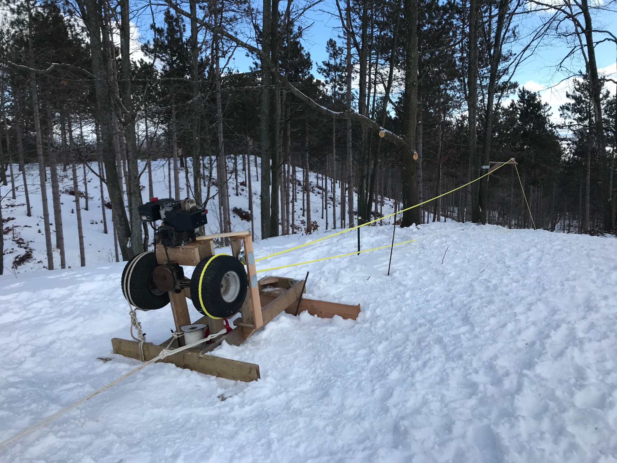

Well, it works!
My sister and her family came up today to help get things set up:
It turns out, I got a little more than 600 feet of rope (yay!). There’s a couple of small tweaks needed, but otherwise it’s ready to haul skiers and sliders! I’ve been grinning like a fool all afternoon.

As promised, a few more photos:
Aside from the weight of the machine, it’s tethered to four six foot lengths of rebar pounded into the ground. For the test runs yesterday, this hadn’t yet been done, but the machine hardly moved while towing one adult up the hill.
Just ahead of it is the safety stop. There’s a cord running across the path of the tow rope (on the two stakes), connected back to the throttle. If anything pulls on the rope, it cuts out the engine almost instantly. (Peace of mind)
At the bottom of the hill is the tail pulley. Despite the rope running along the ground, I managed to pull enough tension to get the tail pulley floating.
Looking up the hill. I will probably add a couple more intermediate pulleys to keep the upwards and downwards lines separate.
The lift is perfectly useable as it is, and I will be out soon getting in some turns.
