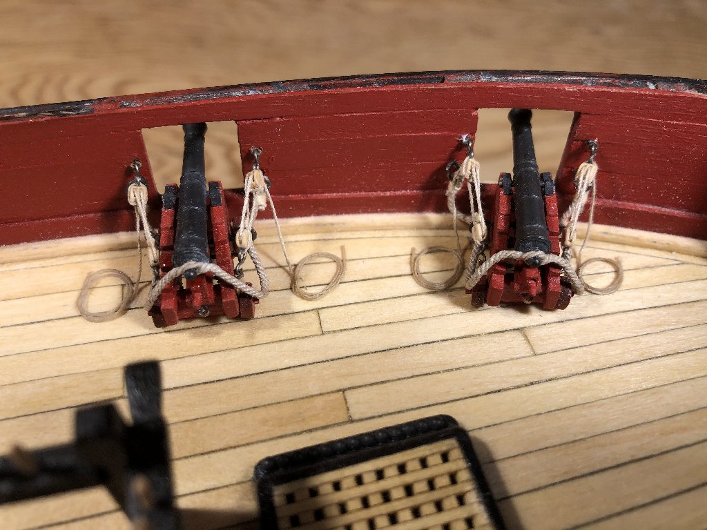

I finished the guns and their carriages.  The barrels were blackened using the same method as I used on my Independence.  Soak the barrels in acetone, then muriatic acid (15 minutes each) and then place them in JAX Blackener for 1-2 minutes.  I was going to leave the quoin handles natural because I was happy with the way they came out (nice and small).  But they looked very white and, really, they would have been painted the same color as the carriages, so I relented.  I hope to mount and rig them in the next few days.

Very nice. You did a wonderful job so far. I like the colour of the wood and the paintscheme as well.

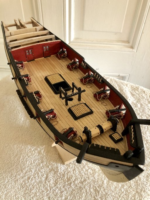

The guns and their carriages have been mounted along with their breach lines.  The aft two guns will not have a problem with the partition to the officer’s quarters since it will be removed and stowed below the water line whenever the boat “clears for action”.  I made the other holder for the cannon balls along the aft hatch using the same technique as on the forward hatch.

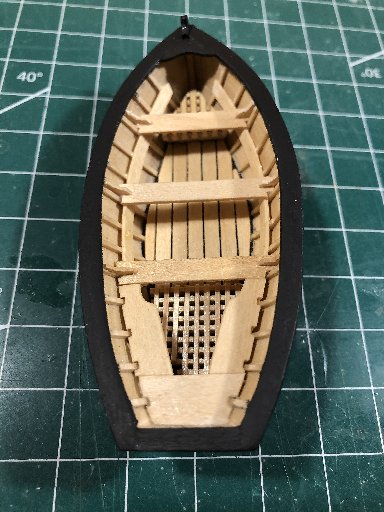

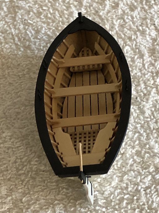

I decided to take time off from the main hull and work on a small boat which will hang off the stern.  One of the officers in my club did a Tech Session at one of our meetings on making small boats using a method he called Lifts.  I’ve heard it called “bread-n-butter”.  I use a plan for a 16 foot long boat from the ‘Anatomy of the Ship’ series - the HMS Diana.  The lifts correspond (in this case) to the three horizontal lines in chart # 1 and #2.  The curved lines in #3 are the same lines.  So I carved out three sections using the lines in chart #3.  My three lifts are below the plans.  I used basswood and I made the boat in two halves because the keel-stern-stem piece will be cut seperately.  The lifts are sanded to get the shape of the boat using chart #1.
VO2h3ma1WyzL90TPVug9KH95HbbAufQ25uO21TrlhRMl97hH-UC0C5q4MncIGCSDuq7gQ3EMnC3taI7msVWgZLMxXagln5h5M0GfOcVbTdzHf2Tw_pBy6qXZT1AfSyuqIymSCz-y
Then the center of the two upper lifts is cut out leaving about 1/8-3/16 thick pieces. The bottom piece is left solid since it will be covered with the floorboards.
jdIn3B7GcW3qDfUkj2QKQdNPt41VKpHYay0Ns0oiBmtgEAed5Y3Ii8ZwoRoKE1ukqRqhjwdHuVU9qMXSqfw0pibQfsF5tKB1NN9F3TZjMCeSv2pLnrTwASFGkni5Zh8xv8PLhXhb
Next the inside of the top lifts were smoothed out.  Then the three lifts of each half were glued together and more sanding was done.  I didn’t use any power tools.  Power tools scare me.
-BXgufapTLcMJg42O5Mbp52jLz3kNWpdDDrUAd9ITjEpHcO56eS7gWnPP2EnQOeo3bMrQUBUx_ImoQ3KOPktveG-wD5YU30yyzaOlmEcXlSH1s0MomAkLwAjxJJxH2L27lRrOYgV
Once the bulwarks are about 1/16th or less, the centerpiece and the two halves can be glued together.  More sanding is done to make the boat “look right”.  I then added pieces of 1/32 x 1/32 basswood to look like ribs.  I also added 1/32/ x /1/8 for the risings which will hold the thwarts and 1/32 x 3/16 floorboards.
c7GTiyhDB4ECgVMKgjx9MELxDWXEmv44awOEr0kF3C9uWtv1ysZ9tdy6YJCwrAh47GEi6srYky1oOxkWGCvWF7GWpAEeAkNZPewQWbXFejO0z5qOH8ZsUH4wadOi5QdqBNtWSYxa
My lifts didn’t fit together very well.  The outside joins weren’t smooth so I used gello and painted the outside of the hull white.  The thwarts and aft seats were added and gratings, as well as the breasthook and knees.  I also cut out a ‘cap rail’ and painted it black.
btoB9Nj7cvtCUD5ZJEb8tWs2xZIT24fzOqipx2RG3p8OhEsN3mSk520ZDxcq8c7BEPutxKiWwb0imYcdAtHmvB-vpiRr2h_B6Xu_oNGWar48umqdaG2HafvhjrcXtft5ajB9lkfb
gb9Psi2MbYQl7zI2GYQELR95p14dkyhngyWn9Vv6i7JXJ1uiQIcEiRG7piSSMBinS2SbKK0QcRx6XPQJfrIrO0GBiKI3pH_1Z-6HQMqEaTq3-fAg0NXdHFAJkyrzFsREOBWC1QSd
I still have to add a rudder, I think, and oar locks.  It’s hard for me to imagine that this is a 15+ foot boat.  I used a measuring tape on my shipyard floor, and this little boat was actually pretty big.

Great work. That is going to look really nice hanging on the stern.

Next up is to finally rig the guns.  I just need to add the out-haul lines.  I’m using 3/32 Syren blocks and .008 Syren line.  I also made the coils from the out-haul line.  Coiling them was pretty easy: just twist them the way you would to coil a garden hose.  I use diluted white glue to hold the coil onto the deck.  I’m only rigging one or two guns per day since I think that’s enough.  So far I completed the port side guns.
RdaR1Is-1UwjwoQjXEI-eKedUuxffMwN4J15F4LSjtyDgzppmjBrSDjSB-8FyPjJLe5xVfKHKG6shtOJZ4qwn9rjyVUT3h_BdjzuREzmRzXMkUH5uXjmlTVipHjaTDGtDEHkN3Bw

I rigged the rest of the guns.  I also added channels and more belaying pin racks.  The belaying pins I made are not glued in place yet.  I’m going to remove them so they don’t get hurt.  I also made a rudder and tiller for the ship’s boat and added oarlocks.  I’m now ready to start on the quarter deck.
OaHJfR_ZBYDlu0zFjb9zm90y9asefA5sPGtEJarq42XWBpoK9UYHhO8bmKtPsv2PAHFo4KwIJ9gdnCYosGV8WpD2_Xss18tbpYnYsqihW-D79uOQzJ1Z35o2bYRV2AJyle7BqhFx     wkJC4Dj5LVSKGoFWYvfZ1fI17_pWbGslusJucSNRNC1SebPBI7CH6pP6HSeyrdYrqbt_yYvWZgWuZI2OsoKr2HNaGImXmcTfwpM1QhGBzFVDM8U9Ogx68vNbn97ncpAdMeI3Xp94
