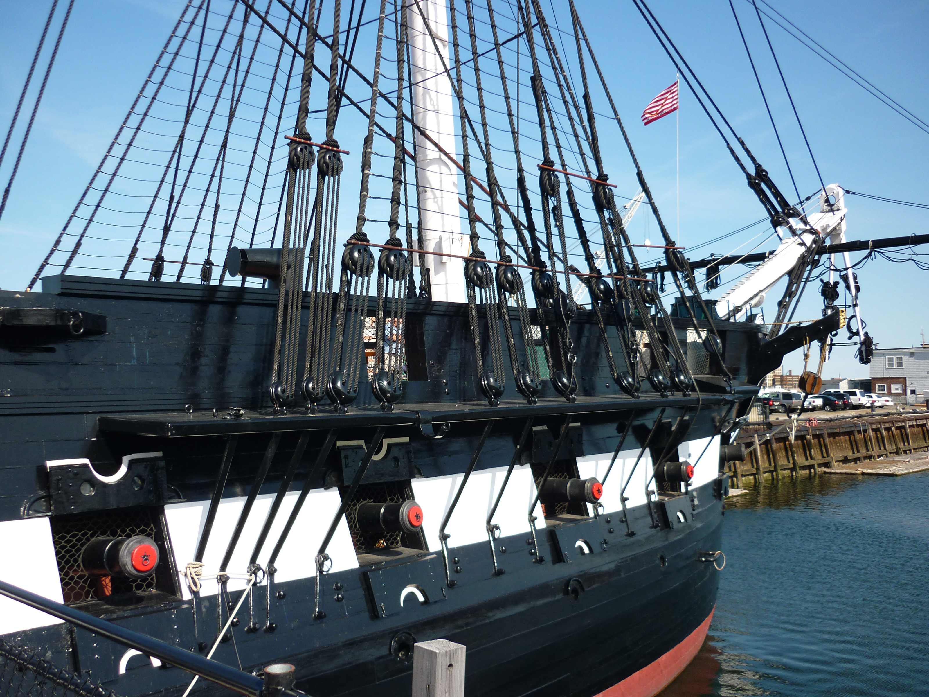

Mspedale6102: as said already, the plastic hull has a thikness of roughly 2mm, which according to 1/96 scale would be around 20cm, wheras the connie's hull has a thickness of at least 53cm (if not 60+, dont have sources now by hand).
This "upgrade" changes the looks and makes the open gunports more realistic from the outside, as you see the bulwark when you are looking from an angle and not only a thin sheet of plastic.
It adds the impression of "Real Armour".
I took the idea from Force9's build btw ;)
Refer to these images of the real thing to see what i am talking about:
