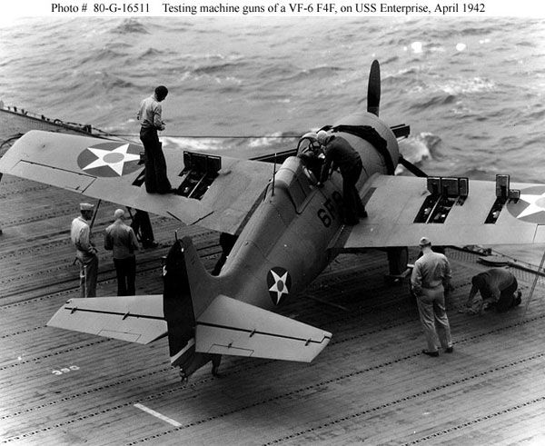

If I remember right, they did arm the planes on the hanger deck in many cases early on in the war and then learned the hard way not to do that.  So they probably would have the guns in place, but no ammo.  The reason for not removing the guns was they had to be boresighted each time they were removed and replaced.
Past Builds:
Link to comment
Share on other sites
Like I said, it is possible that they might replace the guns or perform some other maintenance with the wings folded that would require that the gun hatches be open.
The big exception would be the laying of the belts of ammo, (At least in my opinion) The F4F was noted as an aircraft that had some problems with the guns jamming. Ask Mark to be certain, but I think outside of head space and timing, problems with jams on the M2 is the belt feed system, so laying the belts into their proper location to insure proper feed was one of the critical needs in reloading the guns and would be done with the wings extended and the ammo bays horizontal.
I think that with all of the extra detail you are already adding that having the gun bays exposed would be just a matter of extra frosting and would not be missed as a required detail.

Yeah.. what Lou said.   Ammo would be a no with folded wings.   From what I remember, we left the ammo in the boxes and some guys actually made special "lids' that only let one thickness of ammo come out.  .50 cal ammo is surprising heavy.  A lot heavier than 7.65 mm round.
Maybe have one gun out and on a cart for "maintenance" as visual interest thing?

I think that unlike most planes where the guns are grouped close together in each wing, the six gun F4Fs had the third gun in each wing located much further out on the wing in it's own bay. In your picture above, of the F4F with the bays open when the wings are folded, the third gun is the long narrow bay located on the far left of the second picture.

It's not technically accurate...... Standard MG maintenance procedures established that all MG work from replacing them to loading ammo was done with the wings unfolded and locked...... (not to say it couldn't be done with wings folded as I'm sure the inventiveness of the aircraft maintenance people was at a very high level, but it was not standard procedure)

As an old Weapons Officer, I wonder how they bore-sighted or synchronized the guns. The USAAF/USAF used firing in butts to take an a/c to and live fire to make sure all guns were shooting at the same piece of sky. How and where did they do that on carriers? As we transitioned to Vulcan 20mm Gatling guns, we used a bore-sight board, parked 1,000 inches from the muzzle of the rotating set of barrels. No live fire required. We usually fired at targets between 1 and 2 thousand feet away, using a lead computing optical sight using radar ranging when we could get a radar track of said target. Firing inside of a thousand feet could lead to coming back home with souvenirs from the target.Do not ask how I know that.
I think that this picture may hold at least part of the answer Ken. Just shoot over the side and observe the impact of the rounds in the water.
600?cb=20120426172546
Simple and pretty low tech but I would think it would get the job done. kind of using the side of a building to aim the headlights on your car back in the day.

Picture is missing Lou.
Strange........... it shows on my computer in both the original post and your quote. I added another of the same picture, hope it works this time.

Yep,    I see it now Lou  - thanks.
