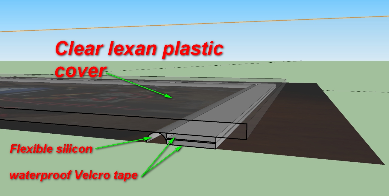

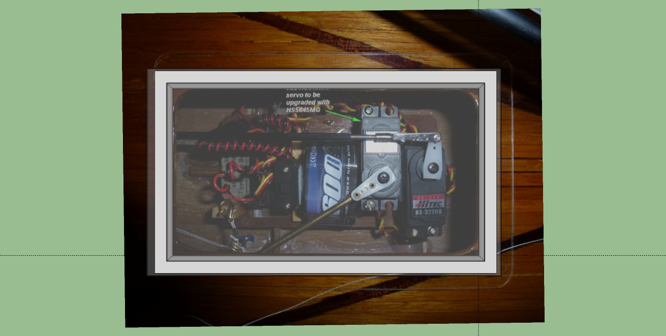

RC friends, I have had the issue of small leakage around the hatch area.
So, this is the an idea I played around with (design wise) at the hotel room out of town and away from modelling.post-967-0-65525700-1380771814_thumb.jpgpost-967-0-99964200-1380771811_thumb.jpg
I am to make a mock up for trial before putting this into reality. Better have the trial and errors before going sharp. :)
An alternative to the clear lexan cover is to make it in wood matching the deck pattern.

So how are you going to hold the Hatch in place? I find that very little water gets from the aft side of the hatch. If you seal the sides and the front you should be good.
