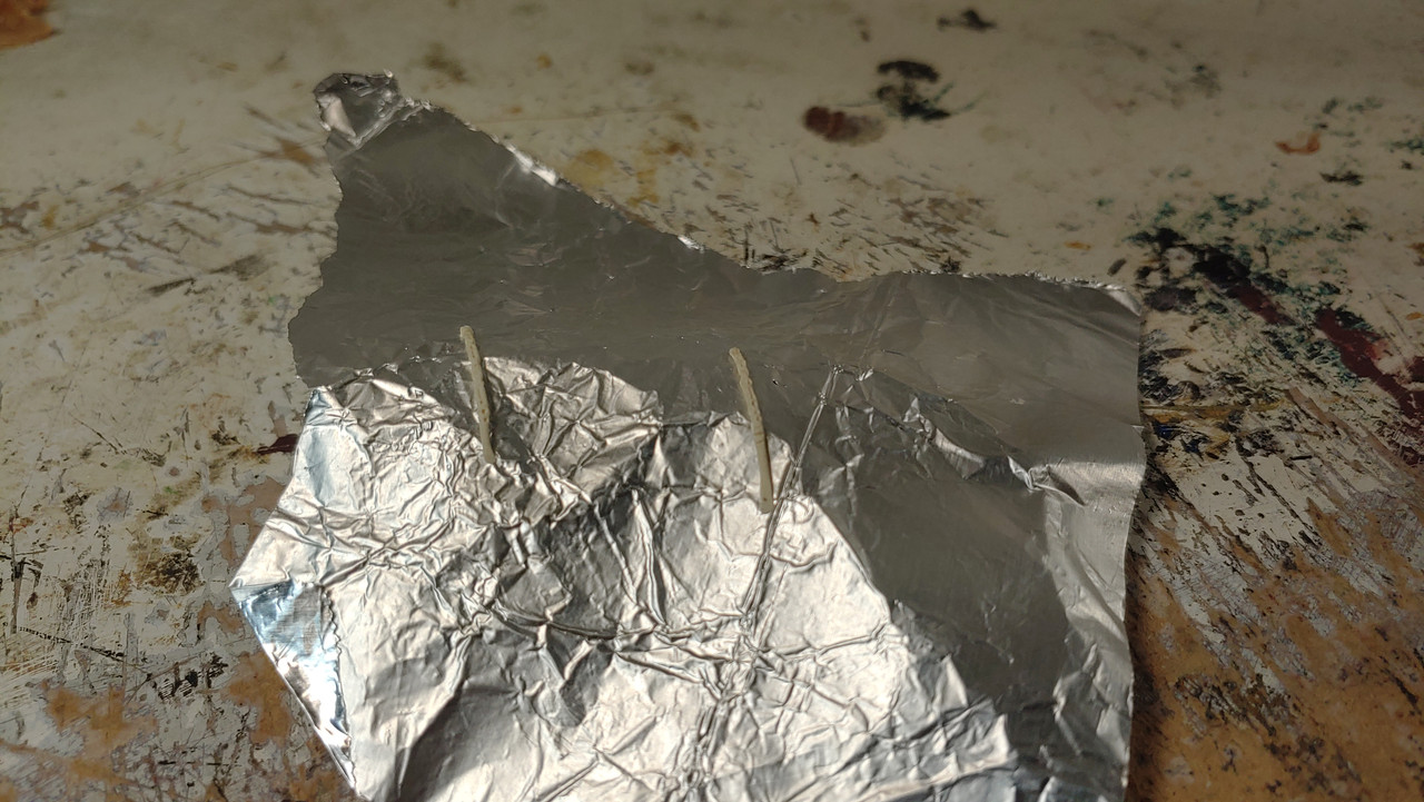

The Sulpey clay fresh out of the oven.
Pieces attached to the aft dome and roof modification completed.
A base coat of Desert Yellow to check the effect, I still have a few more mods yet to do to the lower Qtr gallery before I move to the upper. While not perfect it looks acceptable at this scale, thanks for looking.
Michael D.

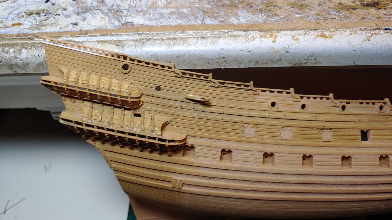

With 90% of the hull sanding complete I've focused my attention to the channels, with the fore channels completed I wanted to try out my new process to achieve the desired look I'm after.
Base coat is Tamiya flat desert yellow followed a thin wash of Tamiya flat white. up next is a thin wash of burnt umber followed by slightly thinned almost dry brushed raw umber then a thin wash of flat black on the middle gun deck ports, once I spray some dulcoat on it, it should give it a deeper tone. I'm quite pleased thus far with the results. The last picture is taken without flash.
Thanks for looking,
Michael D.
