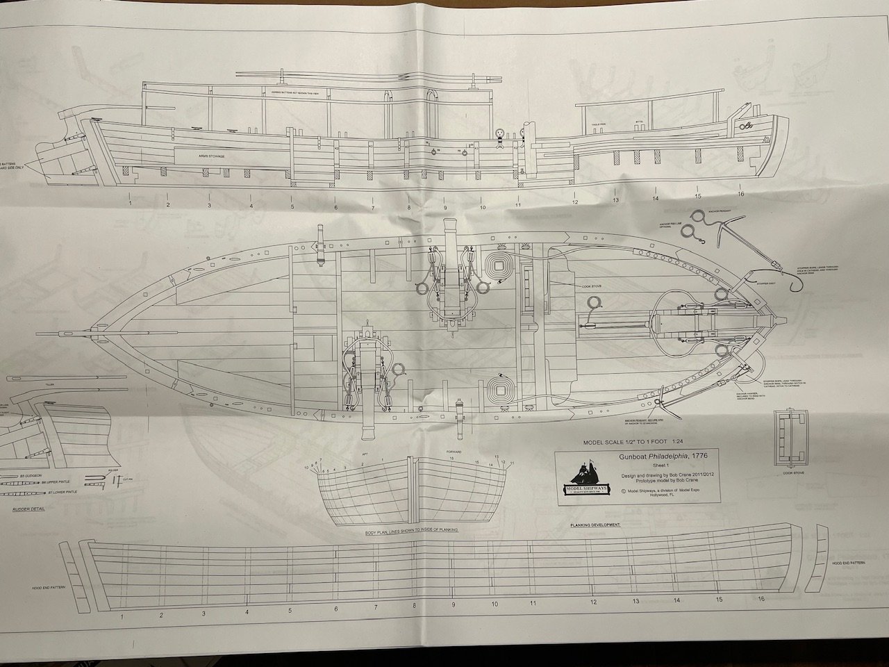

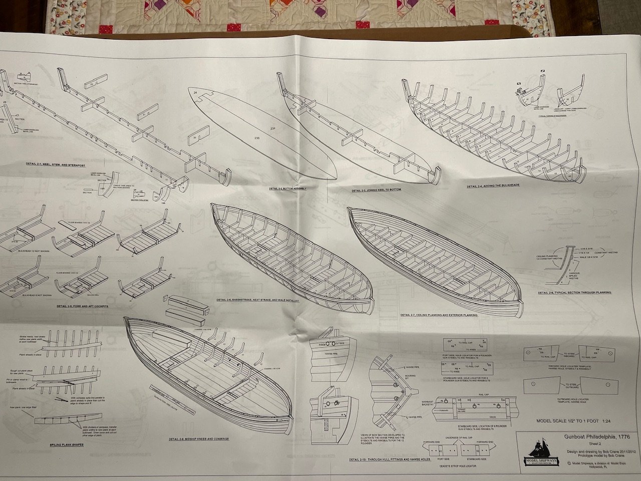

It's a different style of model from anything else I've built or have in my stash. And the instructions are also quite different from any model I've worked on so far. The instruction book is text heavy with almost no illustrations. Instead, there are lots of large paper plans that include build instructions as well as the usual kinds of things that are on plans.

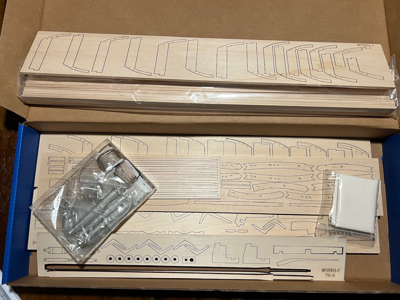

I’m following along with Olha’s build. I’ll probably fall behind at some point but will try to catch up when I can. First step is locating and labeling the parts for the bulkheads and the keel. As I mentioned, this kit has large plan sheets, including one with a full map of the sheets. Will copy the part numbers to the sheets. I won’t write the numbers on the parts because this model will be stained.
The instructions have you add the stem and stern post to the keel. All these pieces are thick and sturdy. The instructions then have you add additional pieces to the stem, but Olha pushed those steps to next week so I will to. The next step is to construct the bottom from three pieces (this boat is flat-bottomed), add the keel to the bottom, then add the bulkhead pieces to the keel.

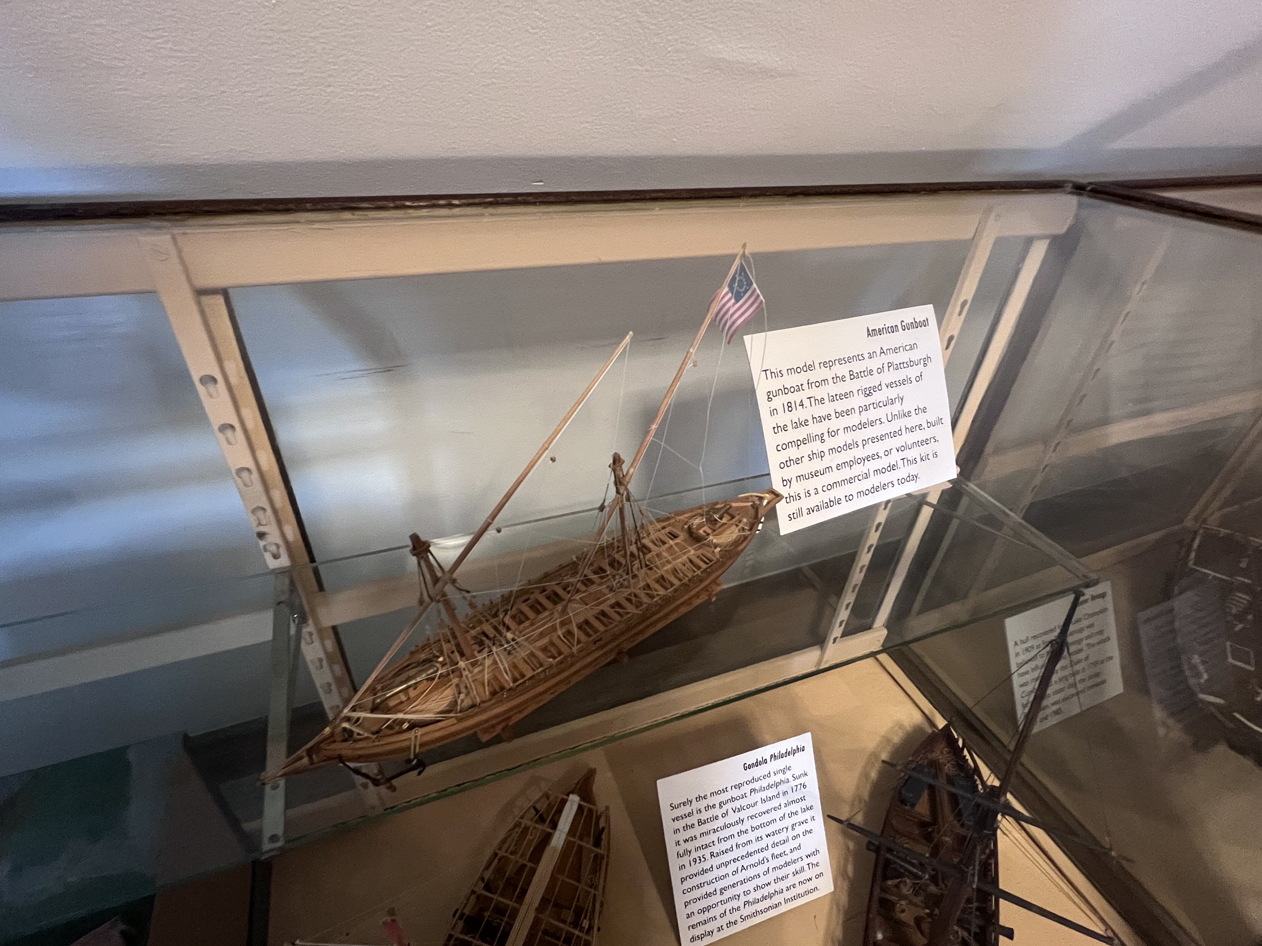

In the meantime, we visited Fort Ticonderoga while visiting our younger son this weekend.

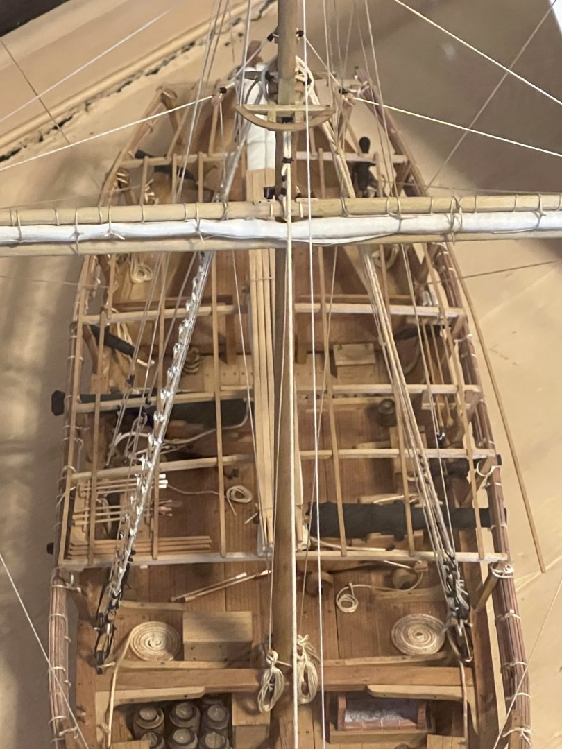

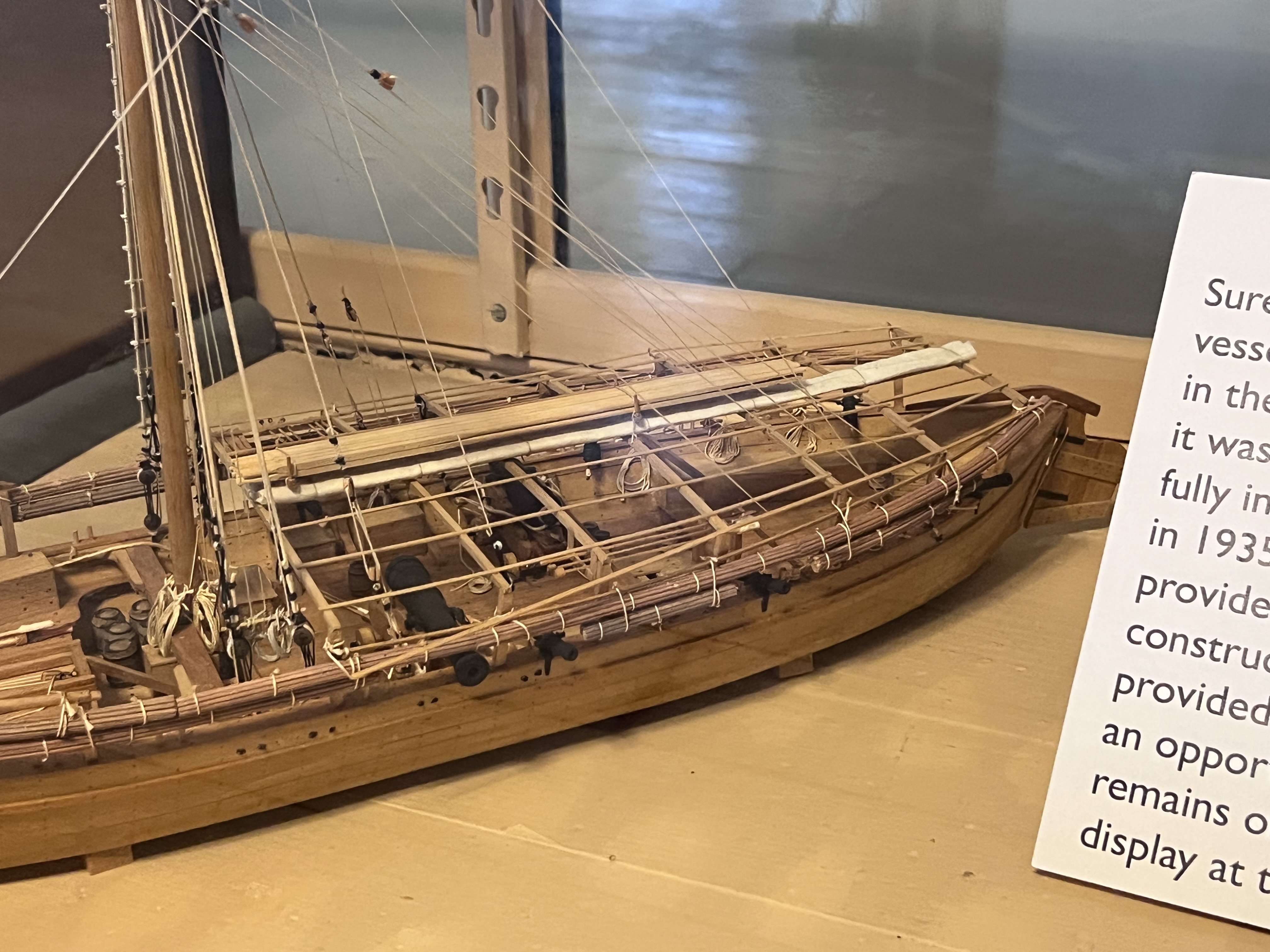

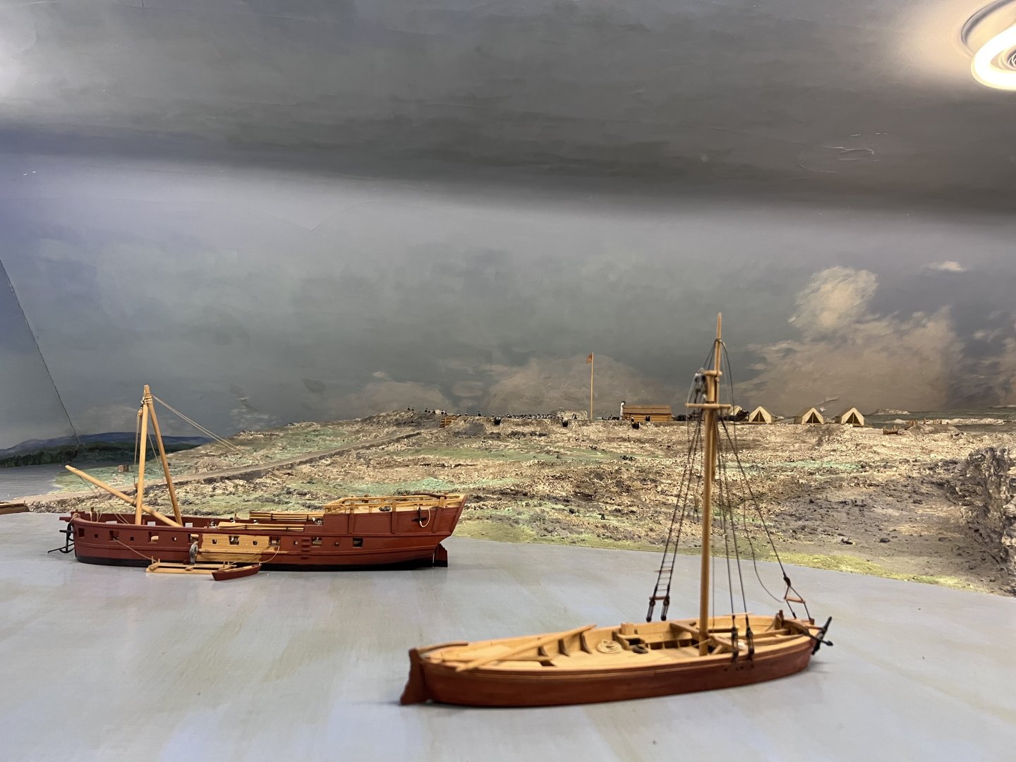

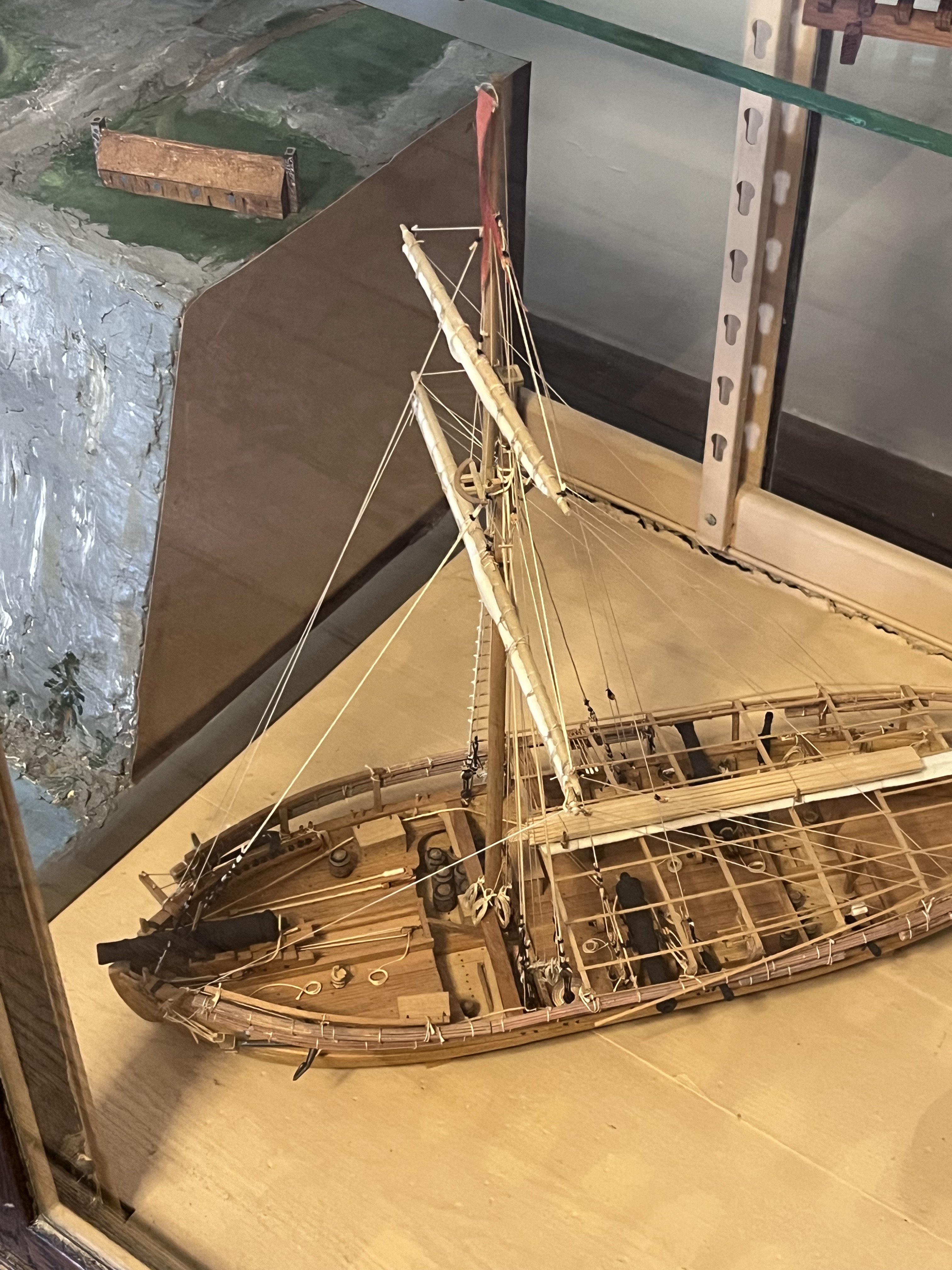

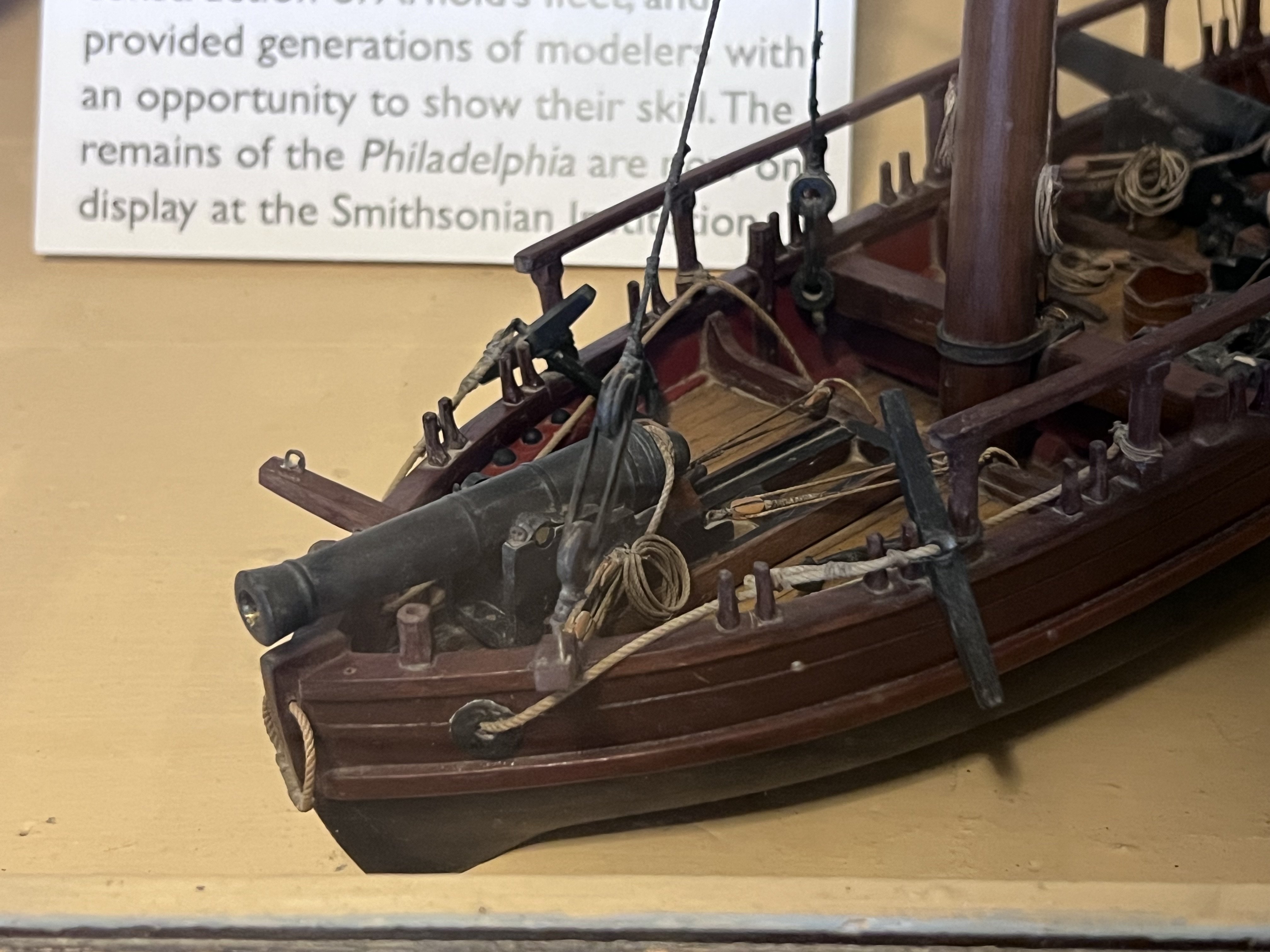

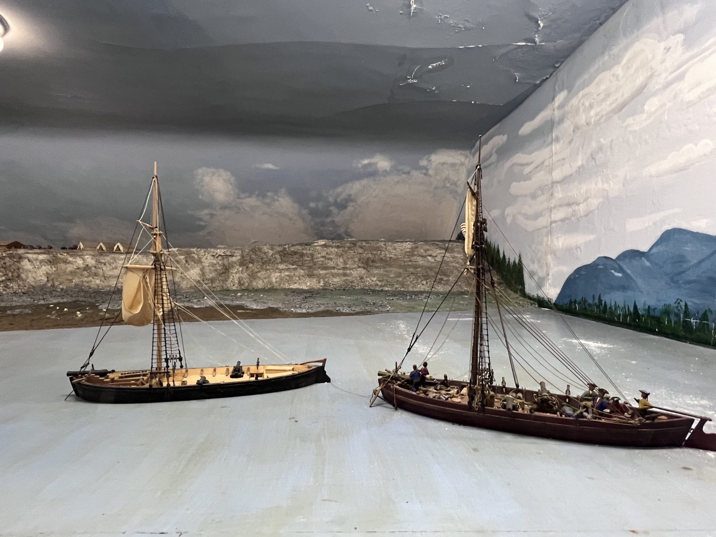

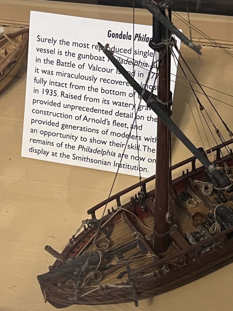

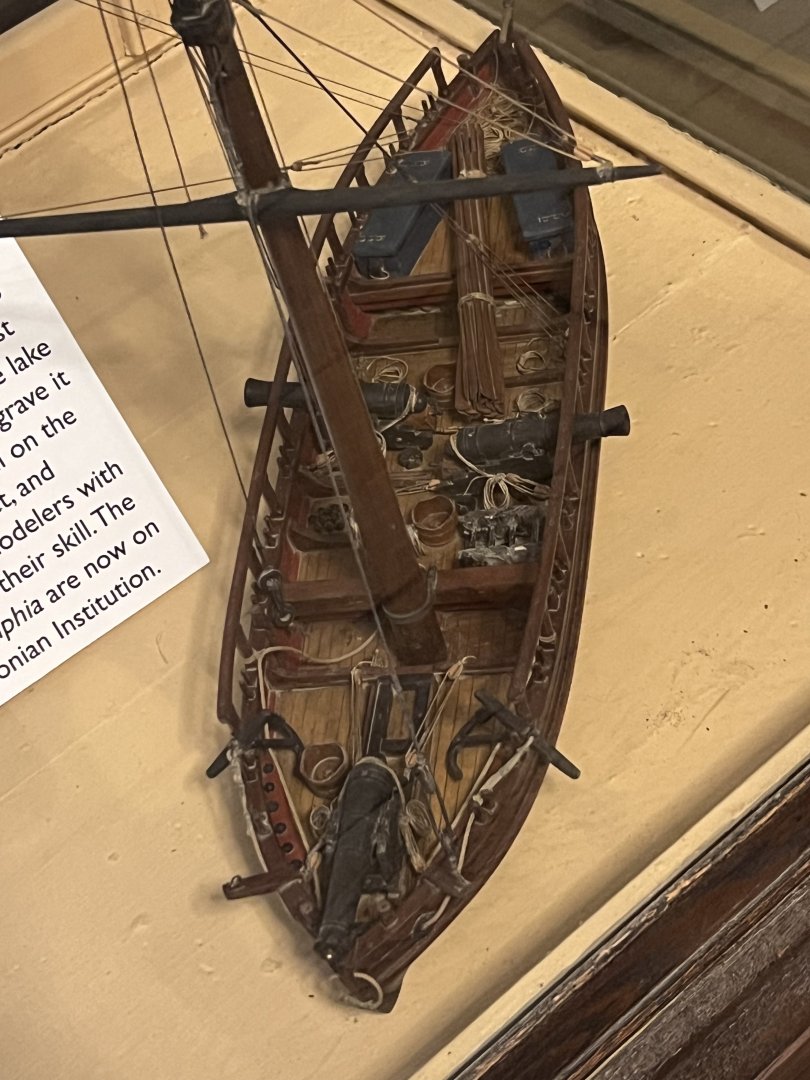

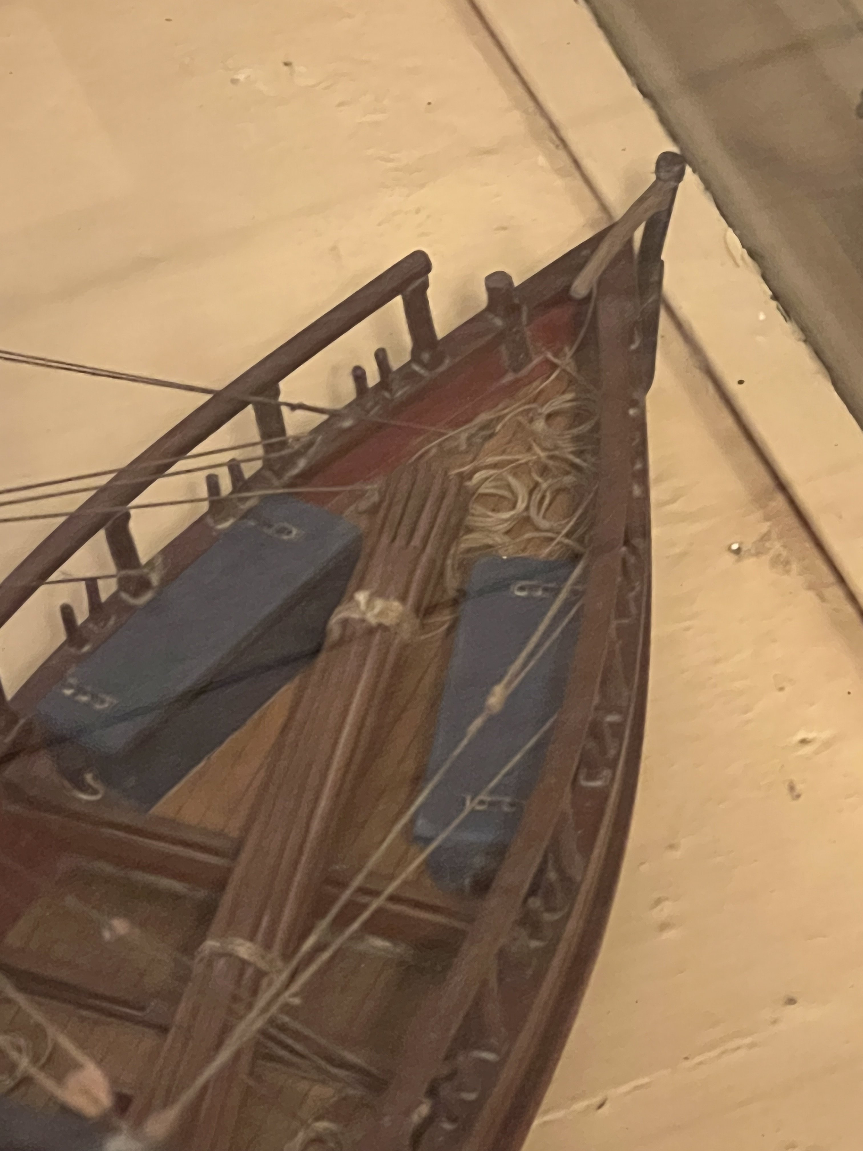

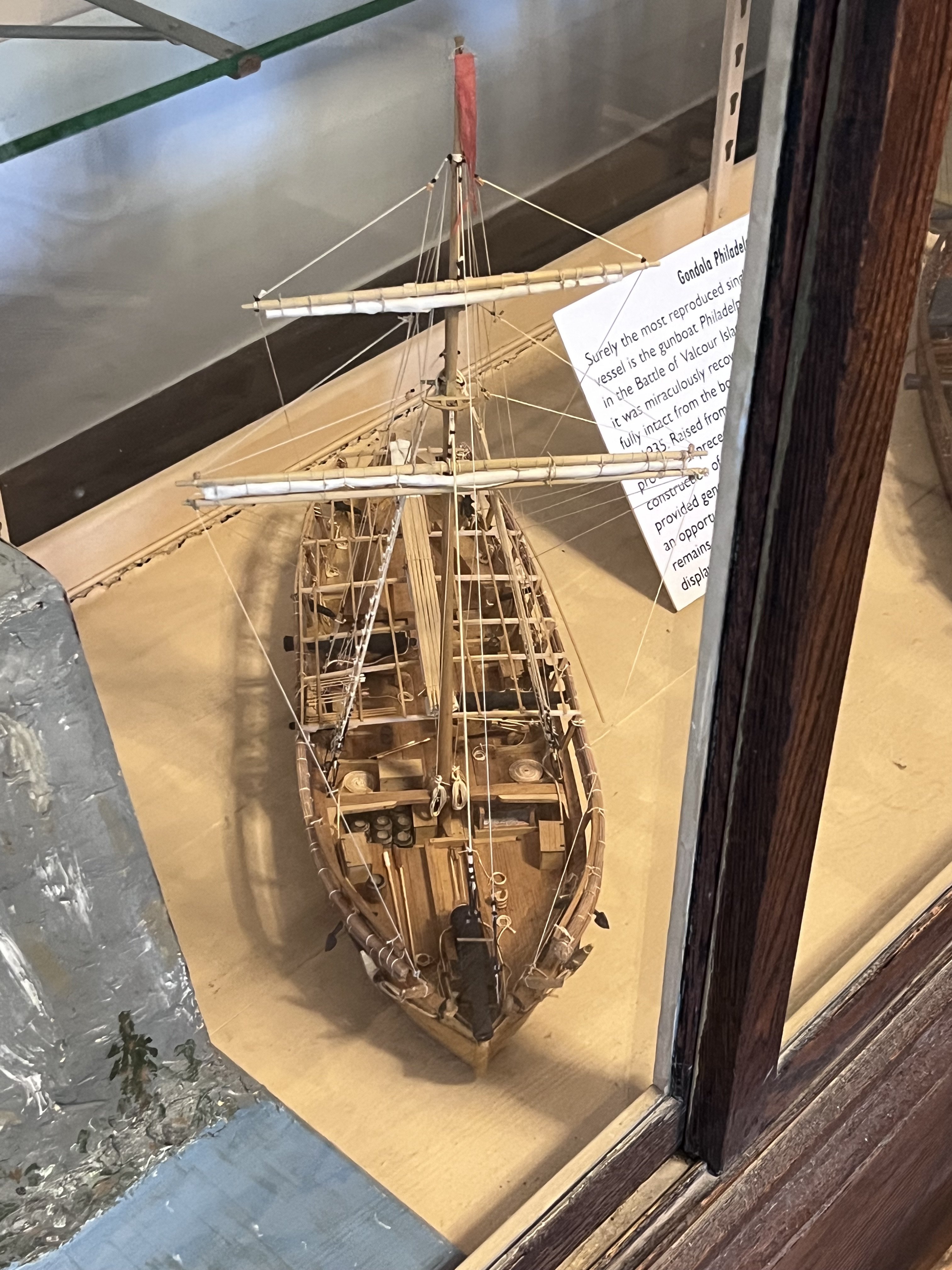

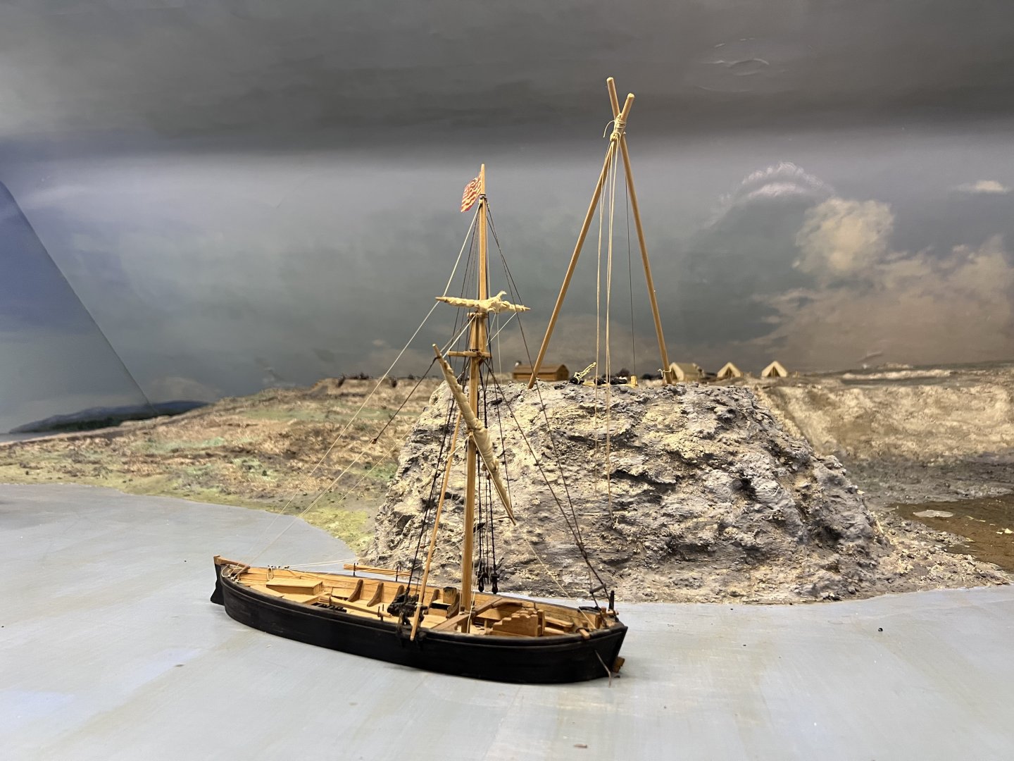

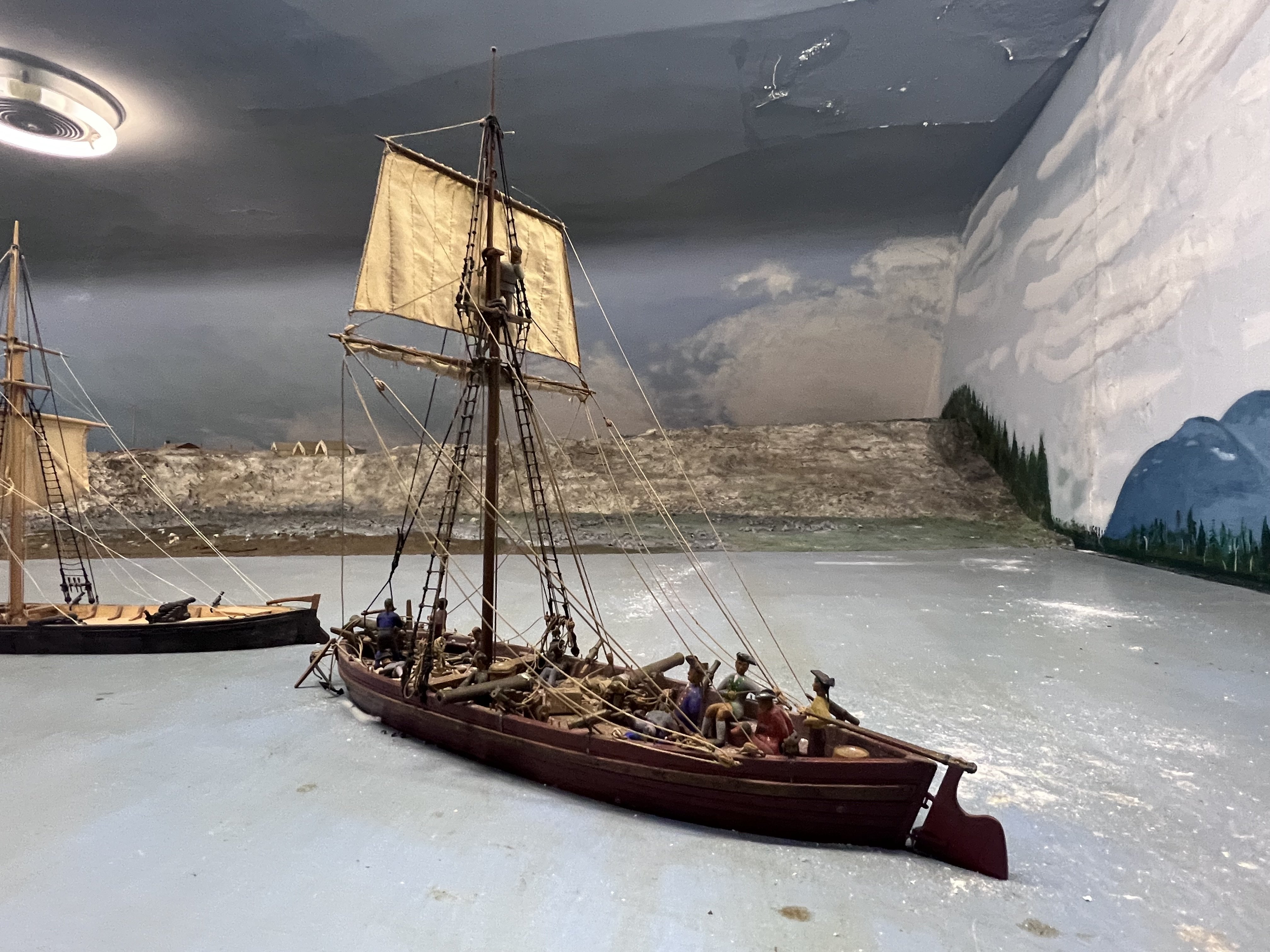

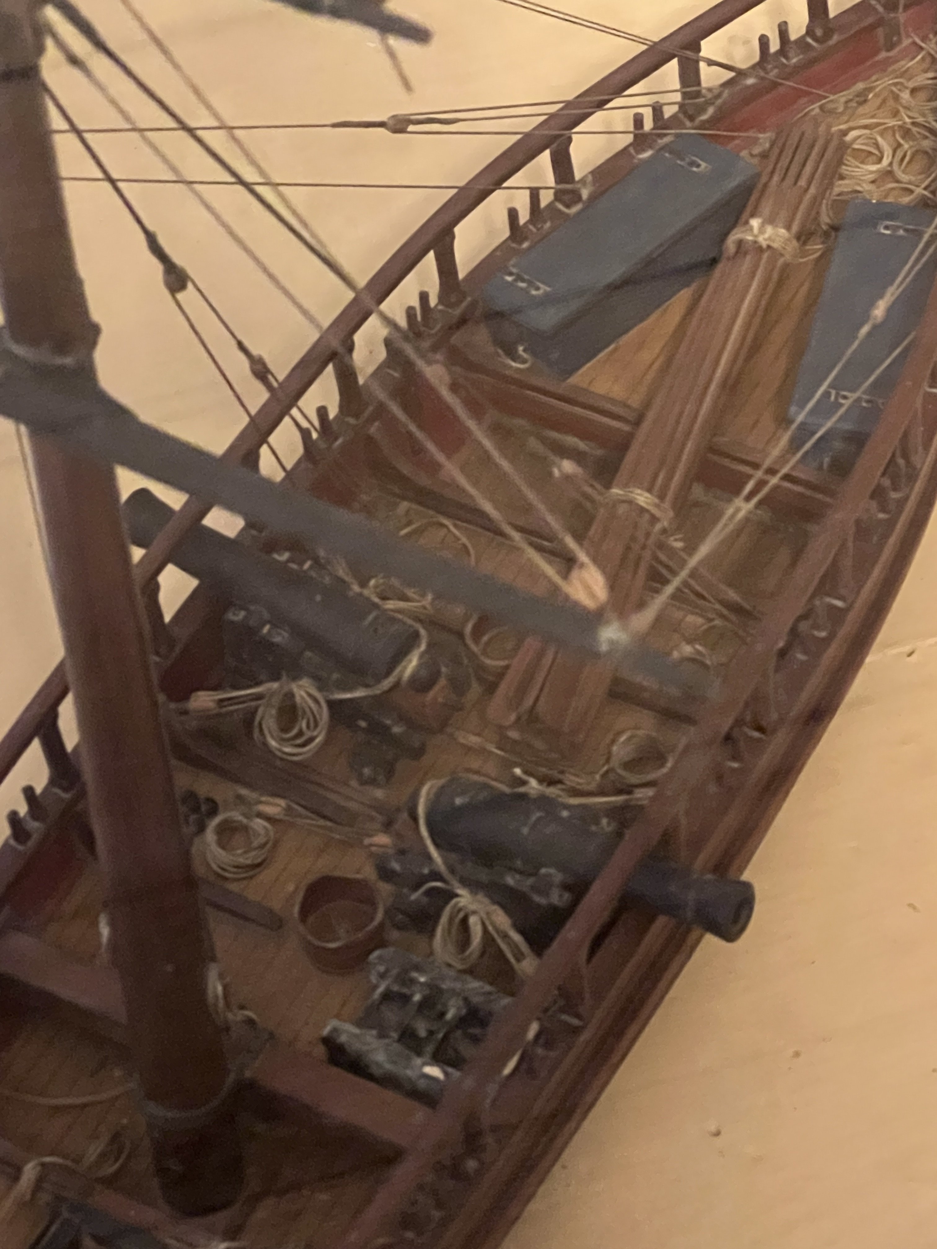

At the museum, they had a bit on the Gunboat Philadelphia - not surprising since it was engaged in battle and sunk north of the fort. Sharing photos of some models they had. Also sharing some photos of a large diorama they had, which included another model of the Philadelphia.
