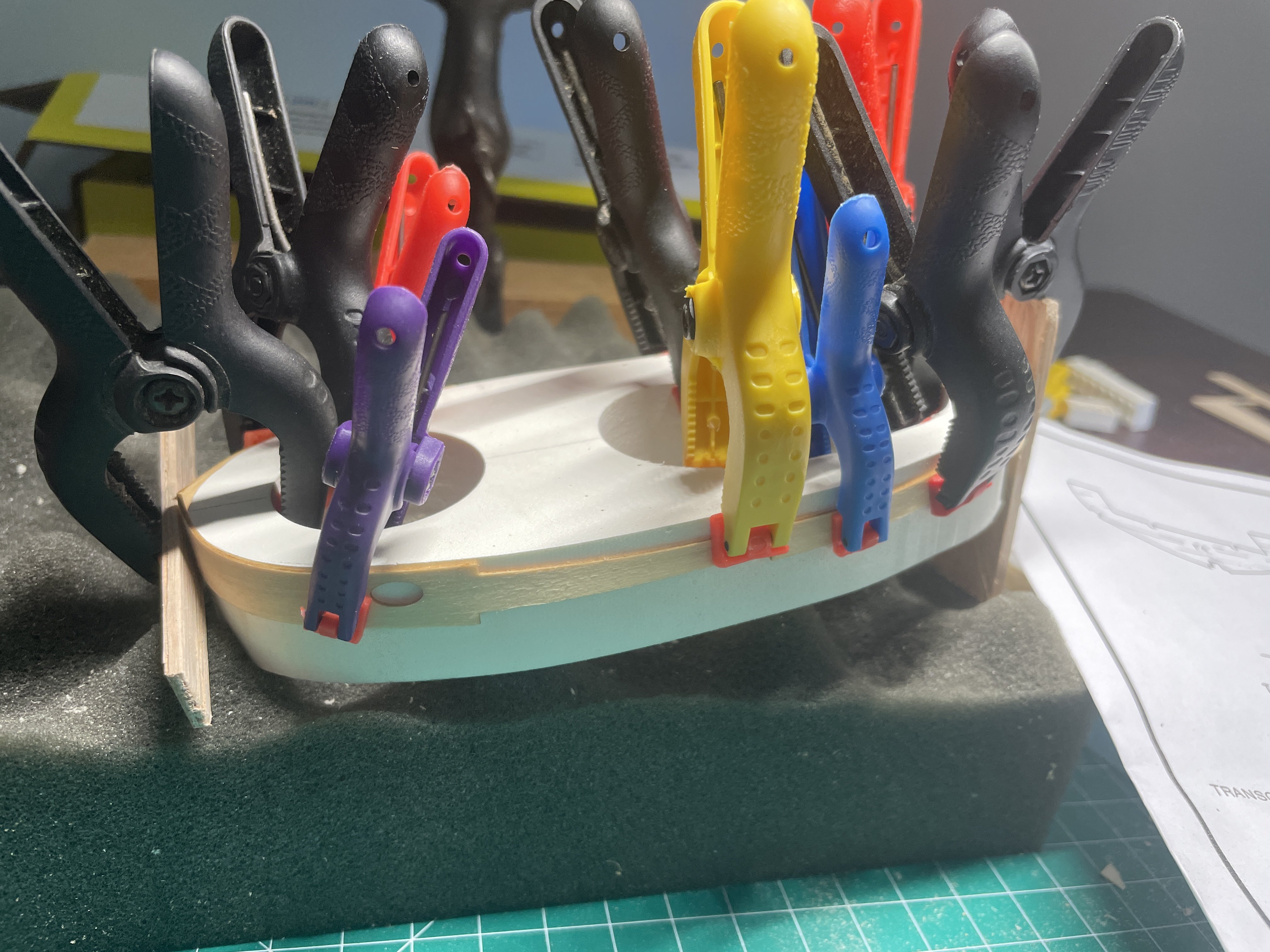

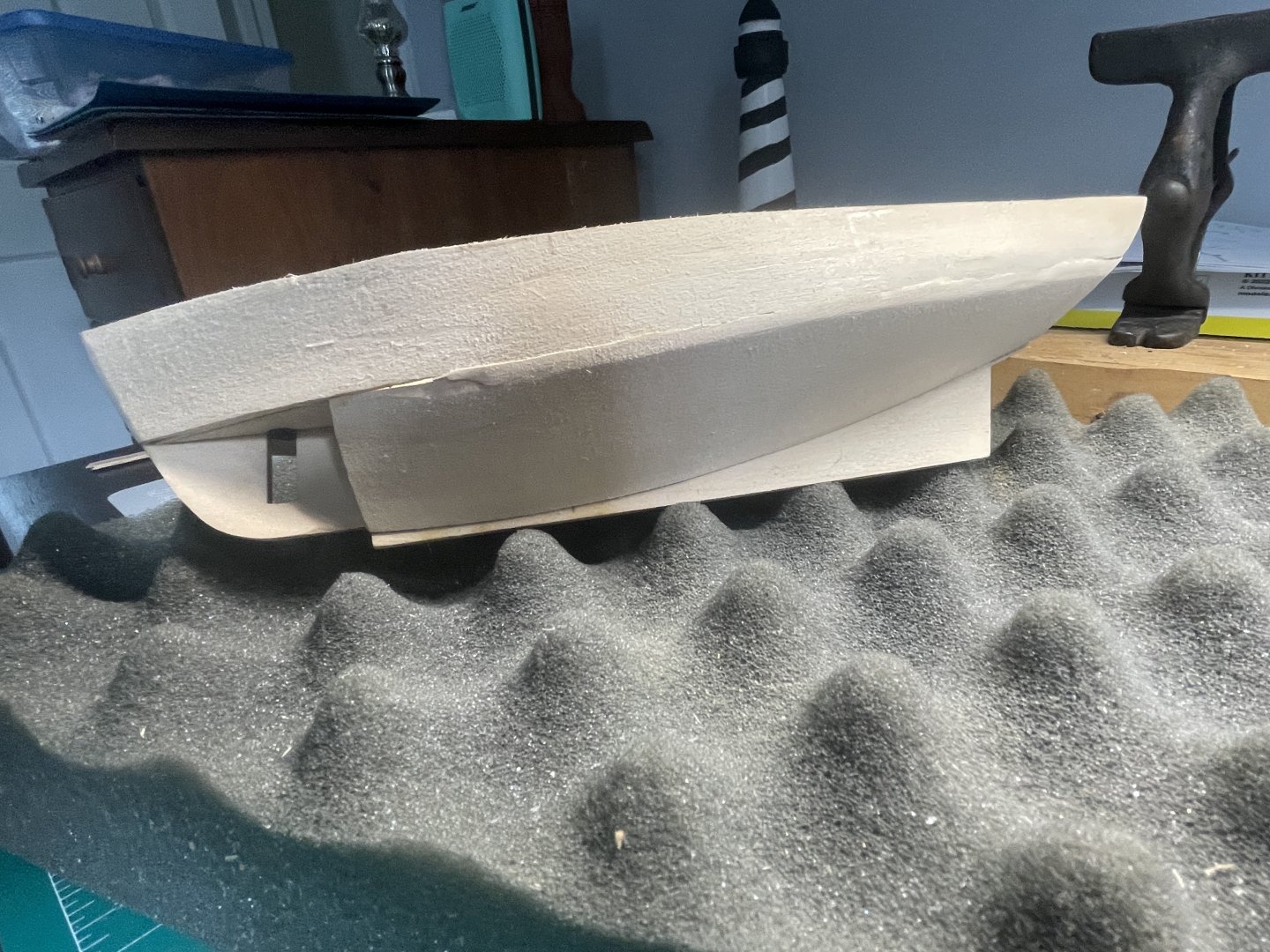

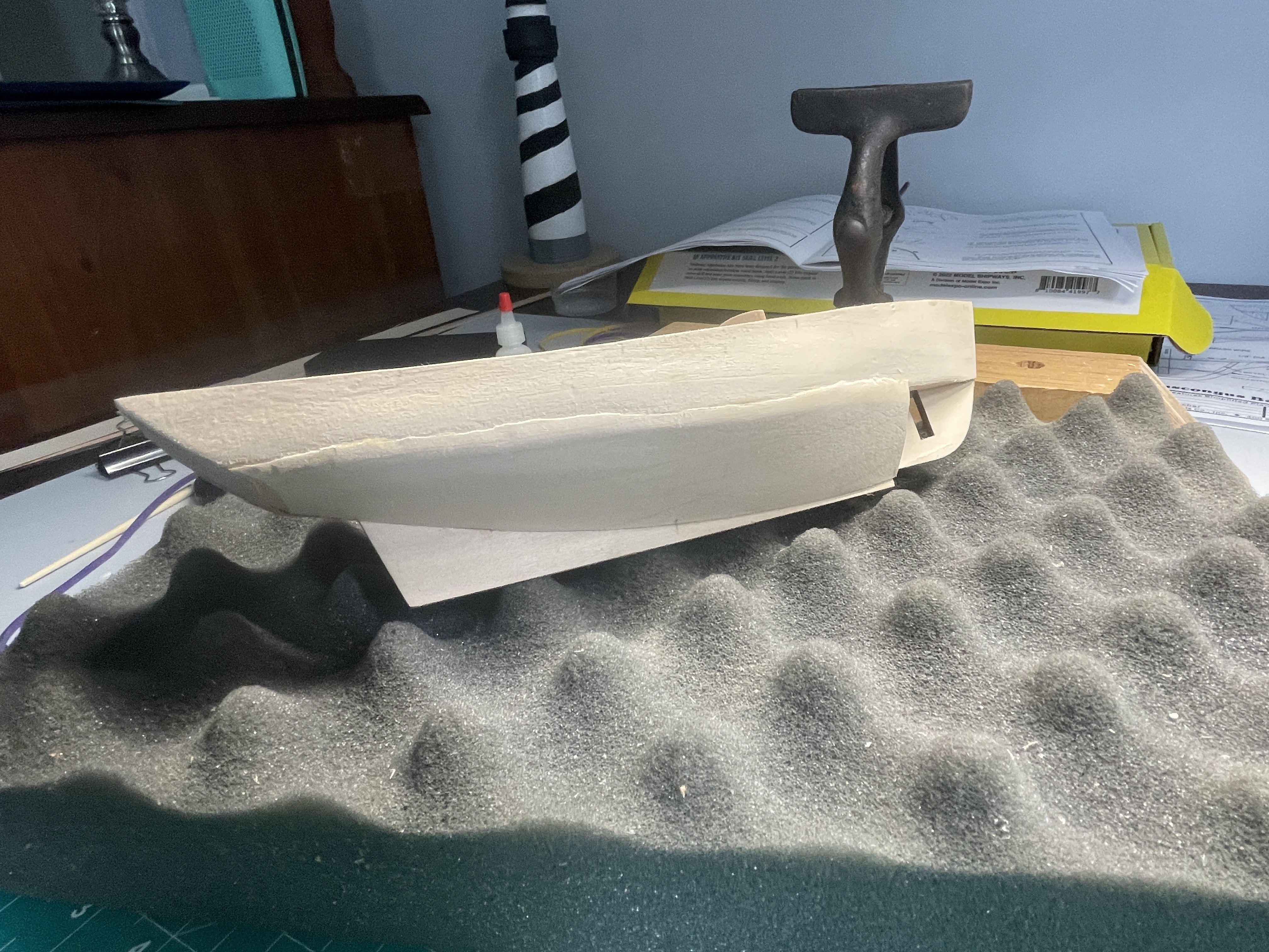

Based on comments from other build logs, I spent a couple of hours adjusting the edges of the deck and frames so that the hull planking would lay smoothly over the framework. I chose to soak the side planks in water and then using the curves in my oval sink basin, I shaped the planks. By running the planks over the long and short curves in the basin, I was able to shape the planks so that they closely fit the frame and the keel. I then clamped the wet planks to the frame and Keel to dry. IMG_5481.thumb.jpeg.3180591a89f65ec6098f08d8b2ad9c99.jpegIMG_5482.thumb.jpeg.40ac6d5f1778c01077cefb27bcd9d18a.jpegIMG_5484.thumb.jpeg.075eda1af31fbb9472047a59eb81447d.jpegIMG_5485.thumb.jpeg.bc48e3dd65e6812860de5adc0d04572a.jpegIMG_5503.thumb.jpeg.00b68b187acebb224b7728ad49e119c8.jpegIMG_5513.thumb.jpeg.1928ac287b0deb94867e4afb83d6175a.jpegIMG_5517.thumb.jpeg.35e6b7a8ae737f04a189c1c91d6e9aa7.jpegIMG_5521.thumb.jpeg.978ef29889f4ed395d98ab992b98b1c6.jpegIMG_5522.thumb.jpeg.deb8edaab50c33b8f371ad14030f269d.jpegIMG_5523.thumb.jpeg.7d8abf20458ffbf902b82b6261fb1342.jpeg

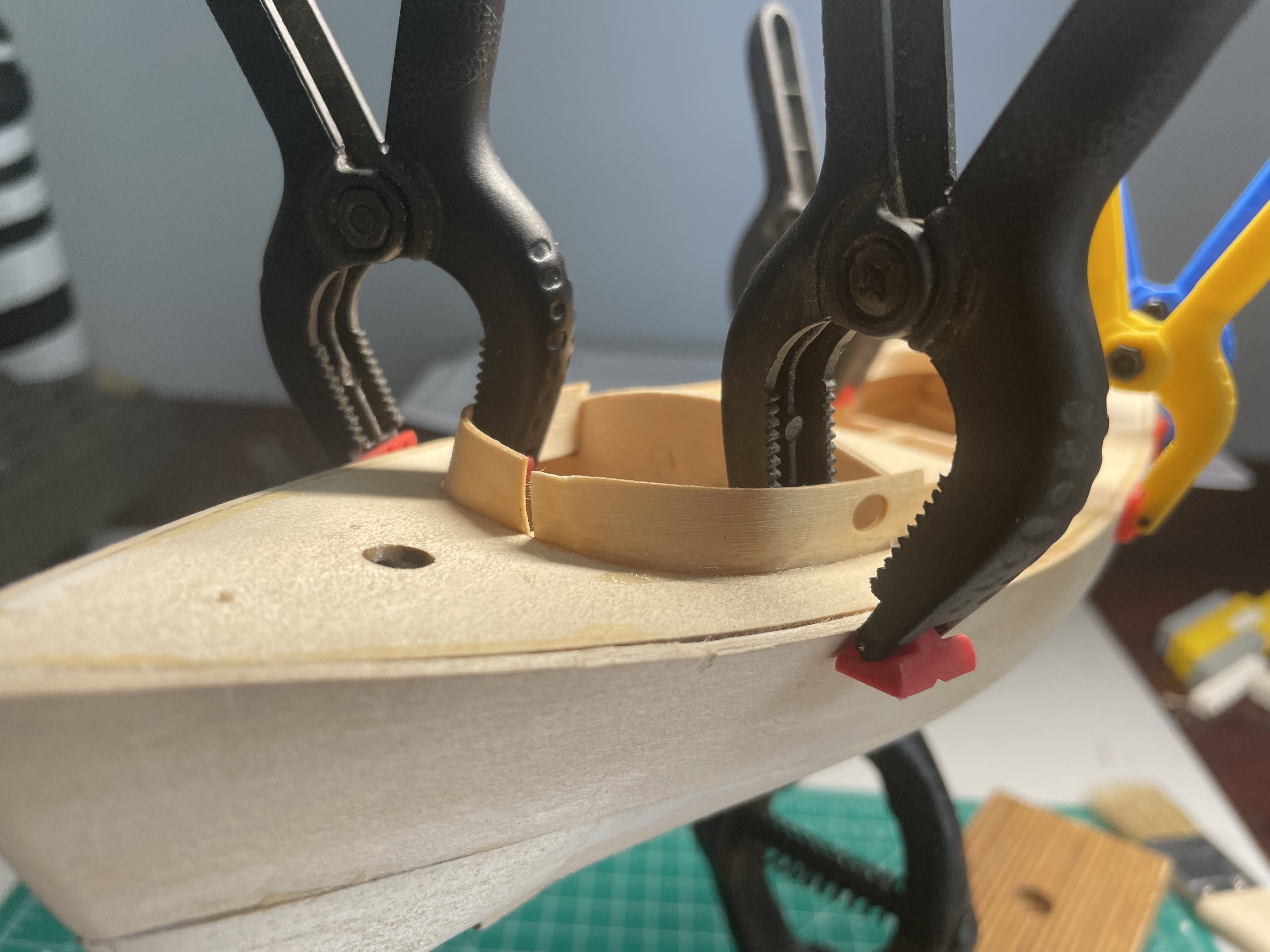

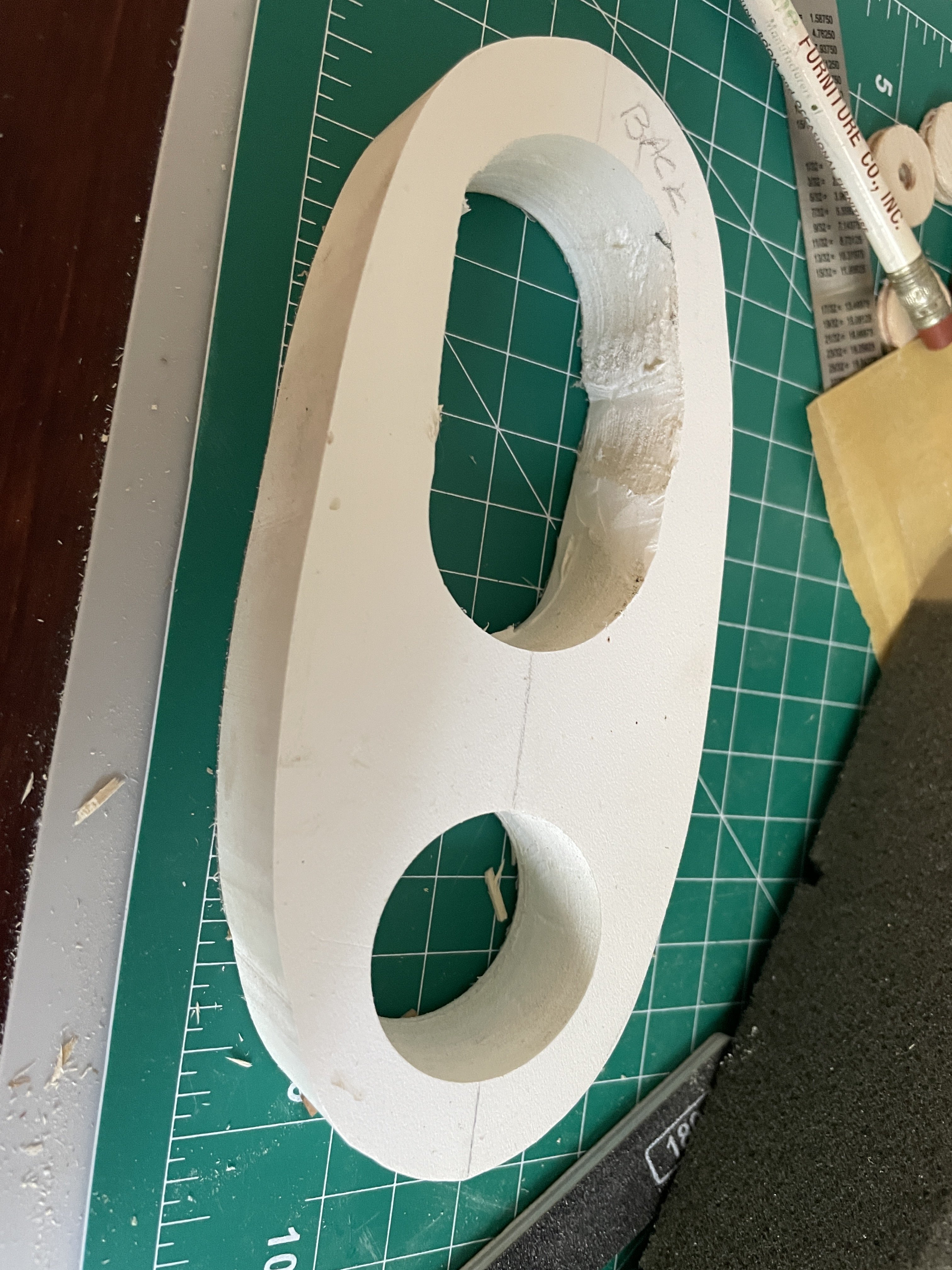

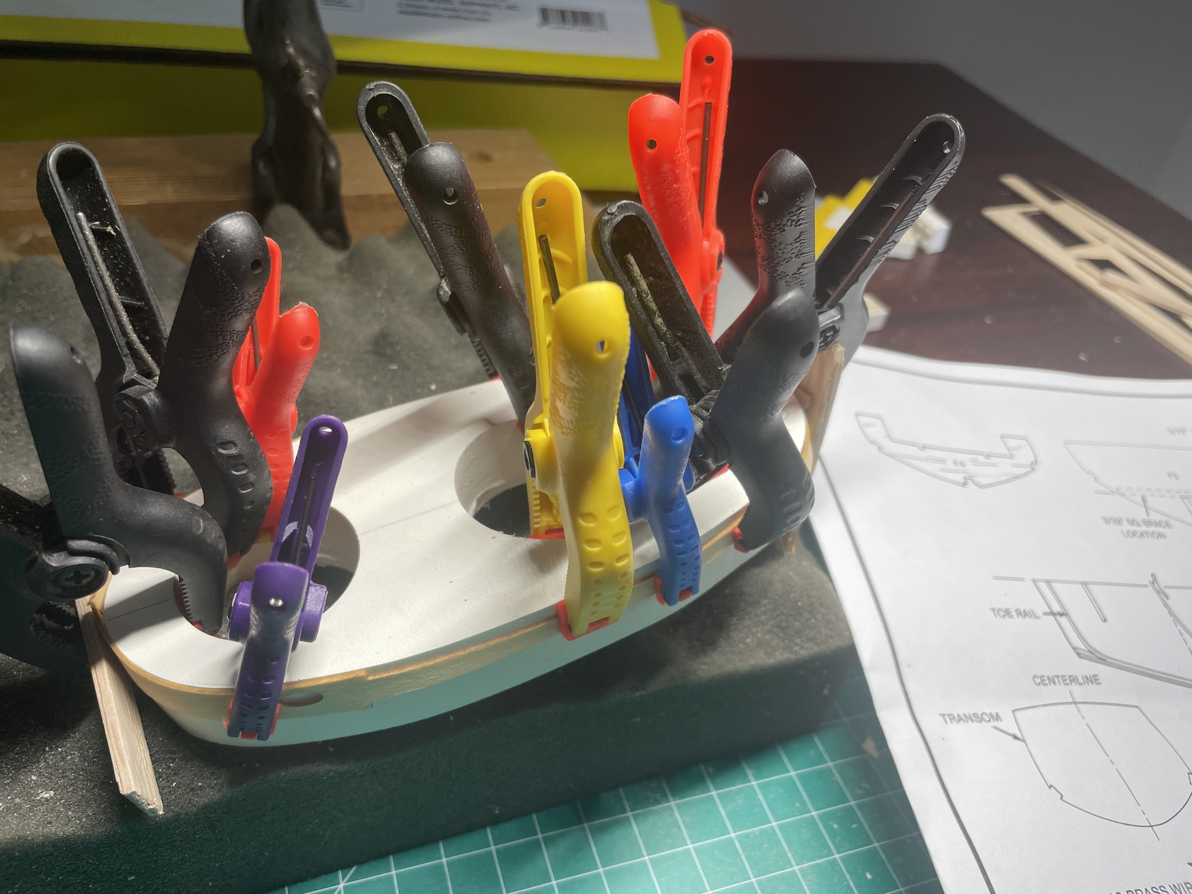

Getting ready to shape the cabin/coaming and decided to cut PVC block to the desired shape. This allowed me to soak and clamp the cabin/coaming on the PVC as it would’ve been difficult to clamp it to the model.
IMG_5699.thumb.jpeg.2b5a8533b1dc2fa81d6048c8c78a0961.jpegIMG_5546.thumb.jpeg.ff95e04827255b526750e77a6264e0a6.jpegIMG_5543.thumb.jpeg.63c69d4eebeafb470f55dc3209df74bc.jpeg

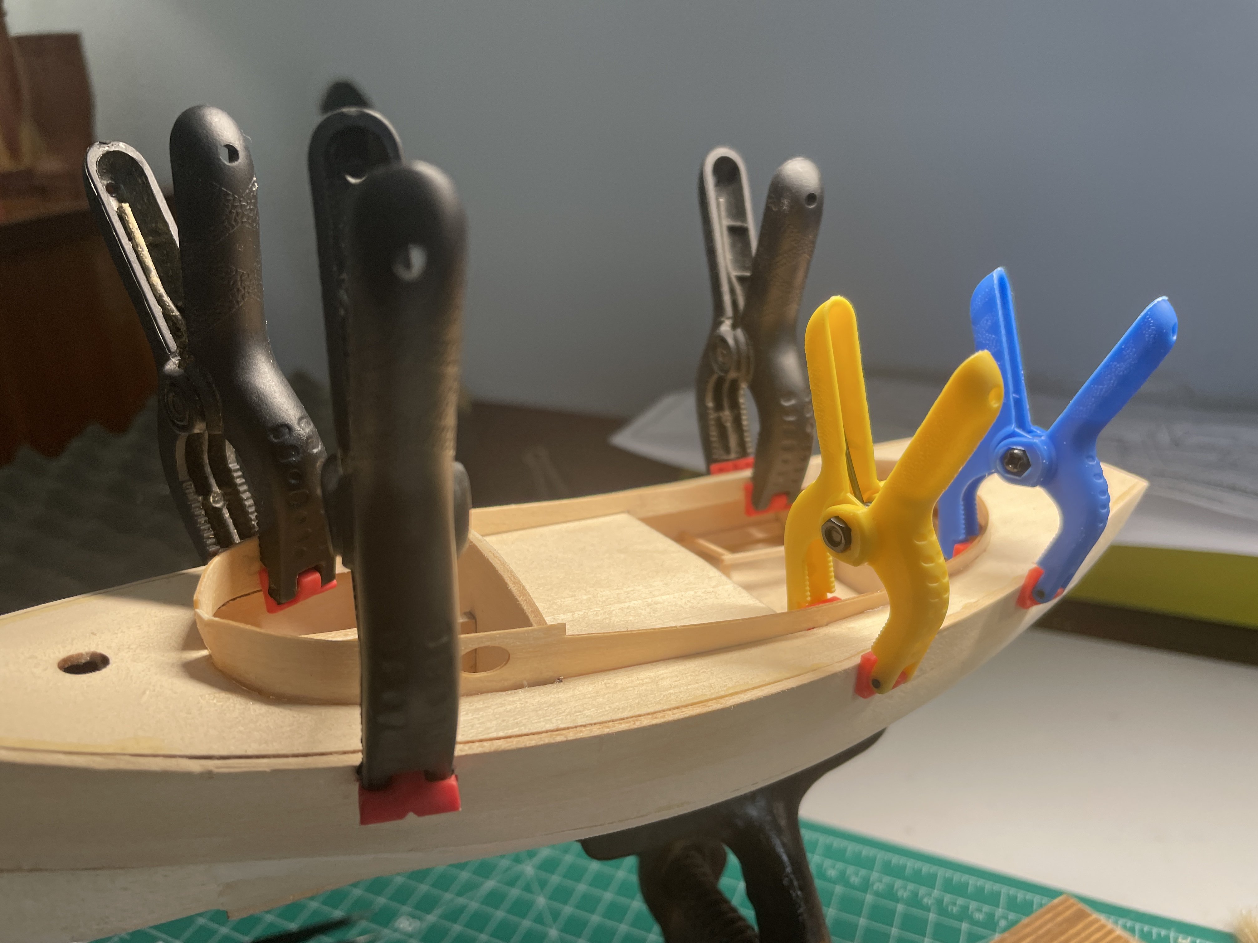

I don’t know if I should be attempting to bend pieces after soaking and gluing them as I go. So I have been soaking, shaping and clamping & letting the piece dry and then going back and doing final tweaks to the shape and gluing.
After drying, I glued the cabin/coaming and cut pieces to make seat braces and glue them. I had overlaps or gaps where the two cabin pieces came together in the front and back, so I added a vertical spacer to fill the gaps.IMG_5549.thumb.jpeg.ba54c5b6adbcb93461165a04b731e733.jpegIMG_5550.thumb.jpeg.14e6e6eb8aea835836dd384f714e5149.jpegIMG_5682.thumb.jpeg.26dce7b25ccefebdbe0a04b66bfed410.jpegIMG_5698.thumb.jpeg.5d289fbff64c8976ae779d253743d04e.jpeg
Next up is the cabin roof. After trimming to fit, it’s glued in place. I next cut pieces to form the hatch frame and glue those in place.
