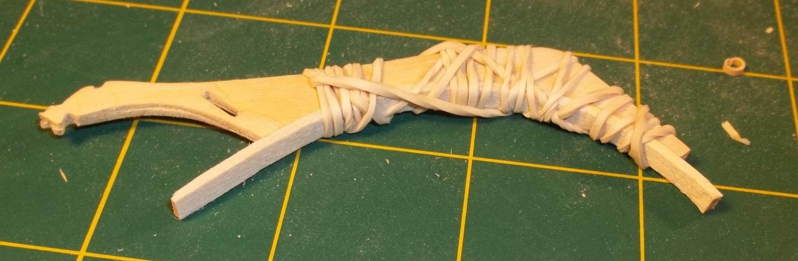

I got a little careless trimming the deck to fit the hull, and carved too deeply is several places. I had to splice in some scrap wood to fix the mistake. All part of the learning process :-)
Lots and lots of sanding to make the hull smooth as a baby's behind. Eventually I figured out what the "Hull Lines Sections" drawing was for. I cut some paper templates to match the sections, and check my work on the hull. I was pretty close just eyeballing it, only had to do some minor adjustments. Then, more sanding!

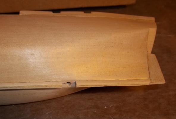

Bulwarks, stem, keel, and rudder have been installed, trimmed, and patched.
The instructions said to glue the stem first, then keel, then rudder. That seem backwards to me, so I did rudder, keel, and stem. Allowed me to get a better fit. Still had to patch the keel to stem joint a little (glue and sawdust worked fine).
I trimmed too much of the hull away on the bow, so I needed to add a filler strip to the stem before attaching it to the hull. Worked fine.

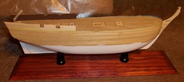

Hull fully sanded and sealed, ready for paint. The lower portion of the hull is going to be white. I read somewhere that regular white does not look correct on a model. They suggested adding a little grey or something to darken the white a bit. (I can't find the page where I read that unfortunately.)
Any suggestions on painting greatly appreciated.

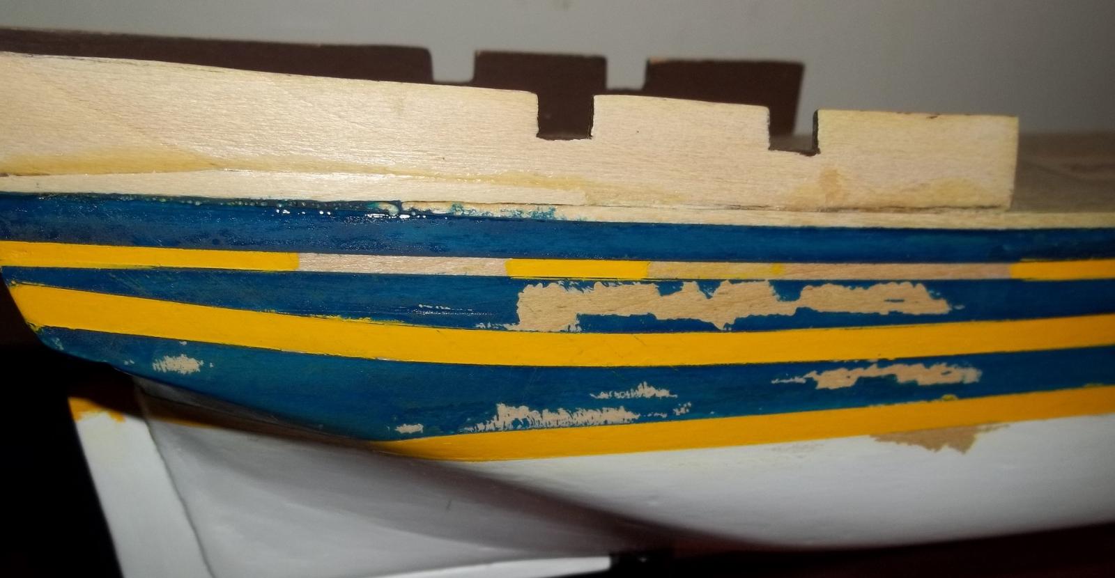

Finished painting the hull, time for the great unmasking. Not exactly what I was hoping for.  :o
Lots of paint pulled off. May not have given the paint enough time to cure before putting on the tape. Live and learn, touch-up time.   :(

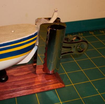

The snail is back! (Just look at that figurehead and tell me it is not a snail)
Clamped the figurehead up. I know, the clamp is bigger than the ship. :(
After the glue dried, the great unavailing. While the piece dry-fit just fine, I had a little trouble getting the figurehead seated perfectly while applying the clamp. You can see where the two pieces almost come together.
However, a little filing and sanding and all is good. You can still see the line, but it is perfectly smooth. After painting no one will ever know the what happened. (unless they read this post :D)
