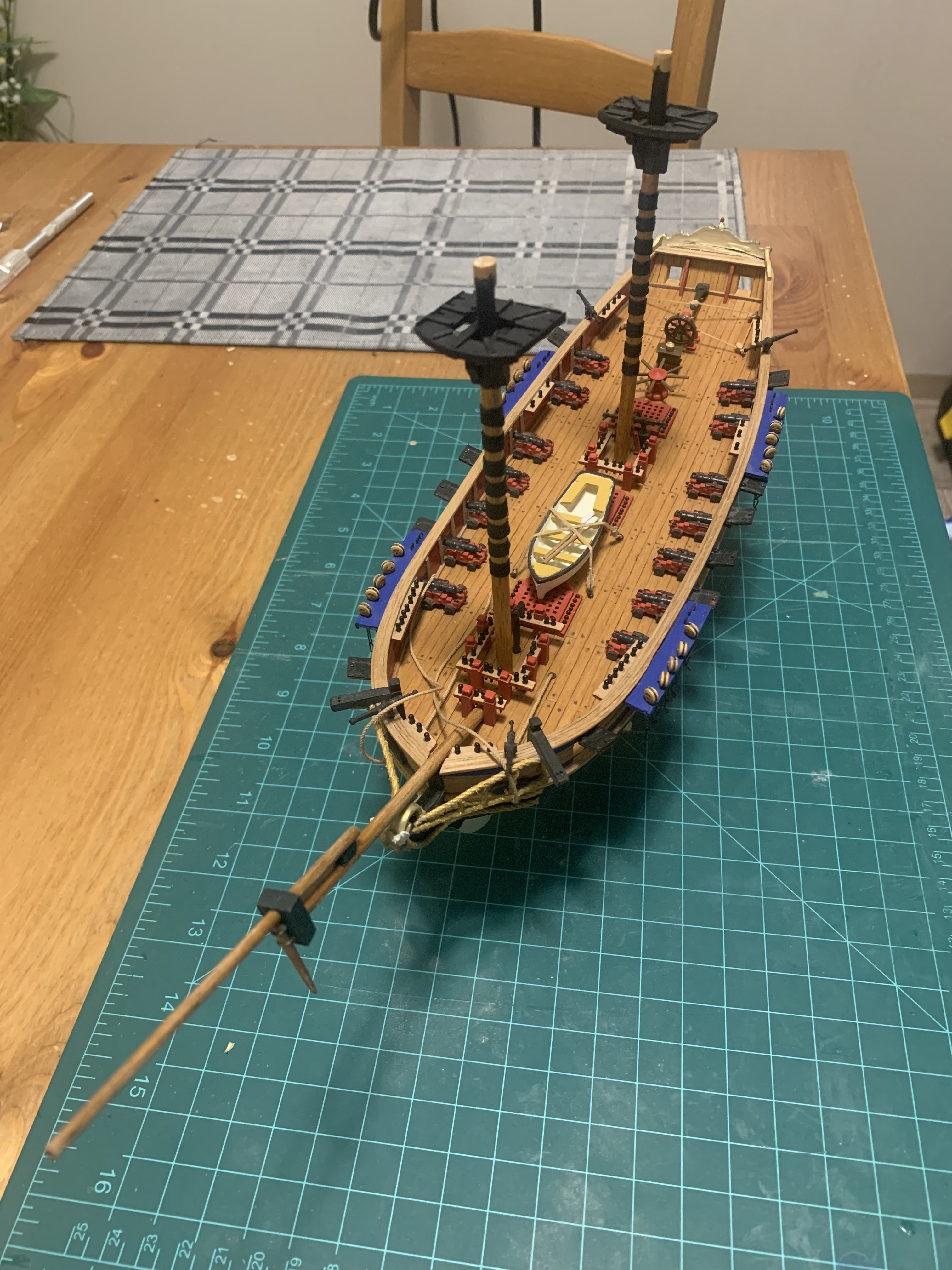

After a long hiatus kids life etc I’ve dusted off the ship and looking to get it finished. I’ve been looking at the chain straps and wondering what exactly is right for this period of ship? The picture on the box and instructions are two different things. I’m not sure if I have it right or start over and go with the instructions or something else. Any input would be appreciated or if there is some where else in the site I should post ?

Does anyone know what color or how the masts and spars should be finished on this model to make it historically accurate ? I can’t find much information online and not sure about the accuracy of what is shown on the box cover.  I was going to paint the spars and cross trees black but unsure about the masts and bowsprit.

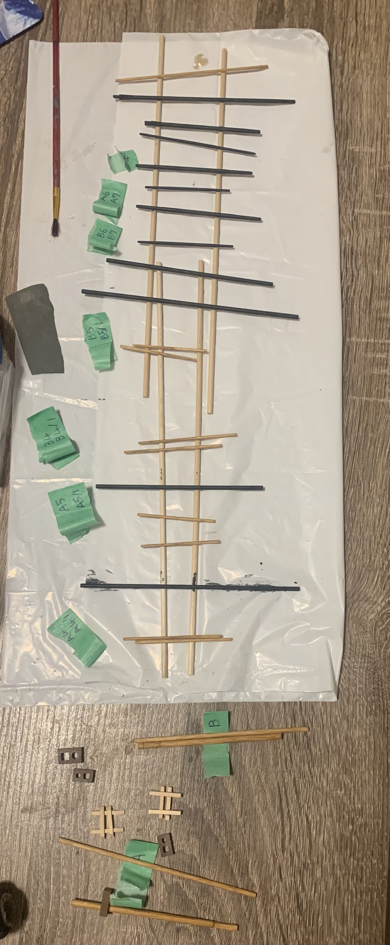

Looking over the mamoli rigging plans for this is a little intimidating as an absolute beginner. I have new blocks and rope because the kit ones are garbage but trying to desipher the kit plans and figuring out the best approach for rigging is where the build is at now.
Most kit manufacturers have some sort of standardized method of numbering the rigging lines and indicating where they should be belayed. I'm not familiar with Mamoli's method, but a picture or two of the rigging diagrams should help. Also, some of our members may be able to recommend some basic rigging books -- the rigging of English gun brigs should also be fairly standard.

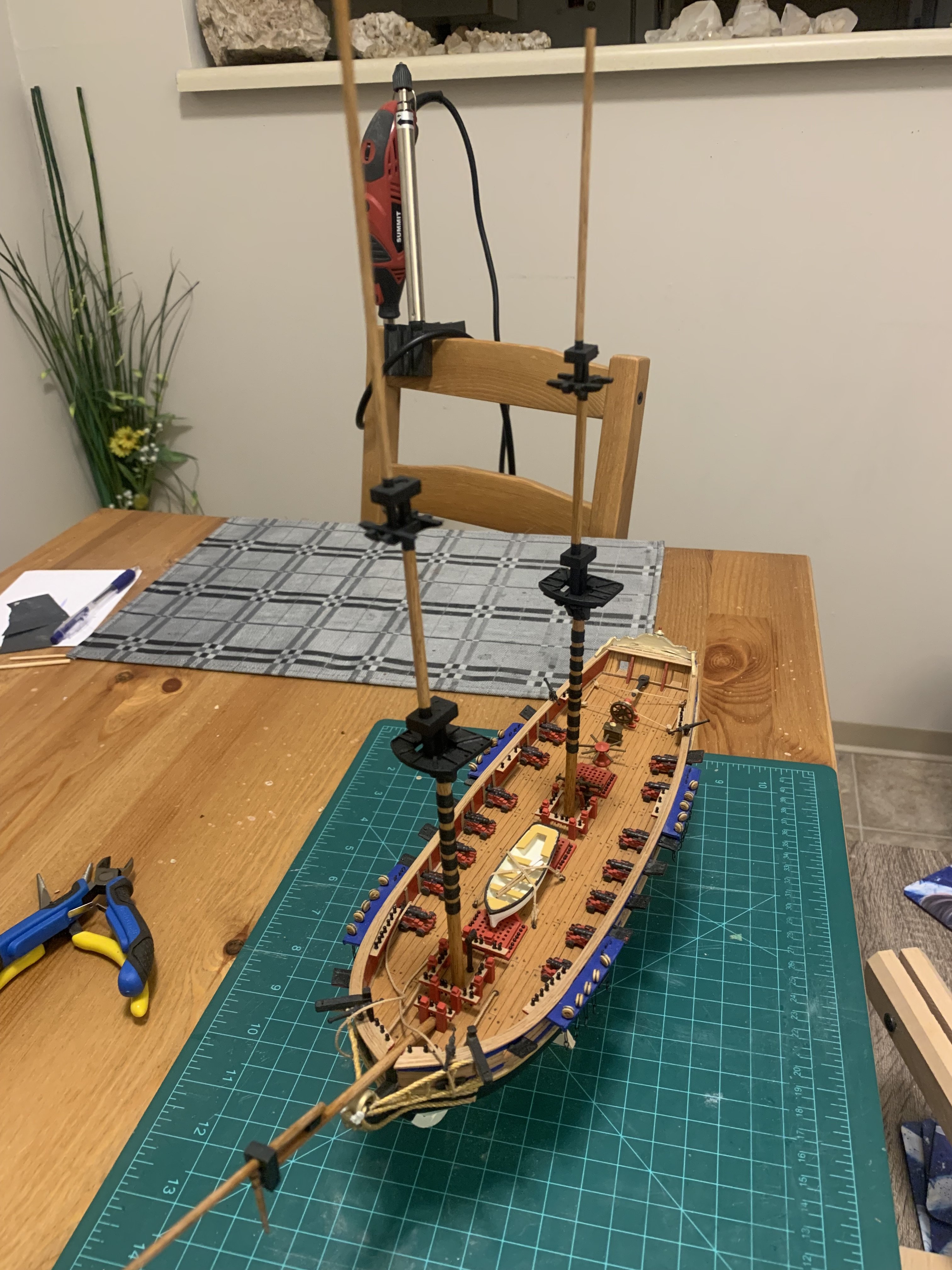

Everything is numbered etc im trying to look ahead and see if any blocks etc should be attached to places before starting on the standing rigging. On the bowsprit it says to lash the jibboom to the bowsprit then later in another step is to attach the spirit sail yard to the same spot that has been previously lashed. I have the rigging period ship book but it is all diagrams. It’s just trying to come up with a plan so I don’t have to backtrack later or try fitting a block or something into a place that would have been easier to do at the beginning of the rigging process.
