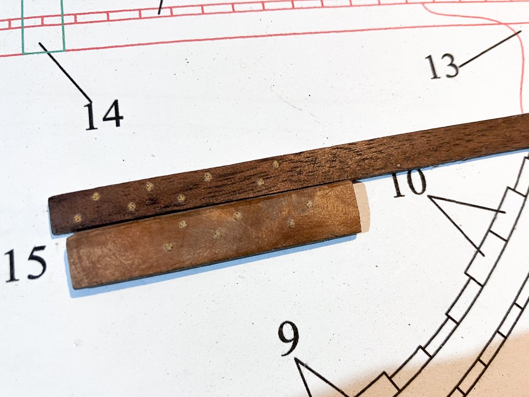

Happy New Year! Little bit of rest from daily realities and I tackled on limber boards and strakes. Before that I had to prepare new stock of my cherry wood, and this time I planed to 8mm: I drilled limber boards 2mm holes as I have seen others did. I have not seen any on the drawings. I assumed you are all right 🙂, and treeinailed with 1mm nails. Unfortunatelly I see now some mistakes I have made before with frames, they are not all the same. Next time I will try to do better. So my idea of having large part not planked has to be revised. Otherwise looks fine. I try to work as much as possible with chisel and planer to get nice planks cuts: I am gradually mounting thick floor stuff planks up to lower deck level. Then I will prepare deck beams. I took the risk of painting planks on one edge side. Not sure if planks were caulked on the inside. Perhaps someone can help me on that. In the meanwhile I am testing different wood pieces for outside planing. Ebone wood has been ordered for wales, but still have not decided on outside planking - cherry or walnut or? I would like to have it relatively dark. Having visited HMS Victory in Portsmouth some years ago, I remeber besides painted part, oak was quite dark. I like my cherry, but whole framing is made of same cherry and I would like to bring some contrast. On the other hand wallnut may be too dark and porous... I treated both wil oil to get the real colours: What do you think? Cheers -

Back home from Poland afer Christmas, still have few days off befor hitting everyday routine so I thought I would try to catch up with Trition. Bascially I finished the frames, gunports. And I keep finding mistakes I had made... Still have to sand nicely everything, sometimes correct here and there, otherwise it looks good. I have ordered ebony for wales, and some extra wallnut, expecing to come in next few days or so. In the meanwhile I am playing with thick planks and treenails. Have I not said before, the wood I use for now is cherry from my garden. Wales with anchor stock strakes apply to standard treenails pattern or not? -

Slowly I carry on. Finished all the frames, I had to re-make extra 2 of them. Treenailed them all as Chuck suggested and started to put everything together with quickly assembled jig to hold whole construction in place. I pre-cut, prepared selected frames for gunports. It was easier now. Next will come keelson and will move on with boards and strakes from bottom up. I am still figuring out which wood I will use. Should planks be shifted inside with same pattern as on the outside? What dou you think? Also I wanted ask about wales. Modfeld describes wales as anchor stock strakes. I have not seen anybody doing it though, Any ideas? EDIT: I found log by ChadB actually planking wals with anchor stocks, so that is clear for me now. Cheers Jerzy -
