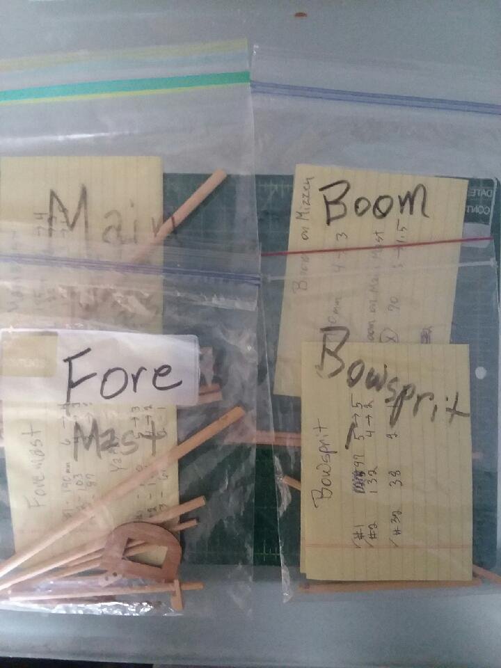

  3. Continuing with my description of using just basic tools for the build, here is how I approach working with deadeyes. As I mentioned earlier, I like to work on different parts to avoid getting bored with any one procedure. I had finished cutting and staining the mast and yard sections, so decided to start assembling the deadeyes. The thread included in the kit wasn't satisfactory, so I substituted some of my own. The first step is to pull pieces of thread against a block of beeswax to help straighten any tendency to curl from being on the spool. I wrap the thread around the deadeye very tightly, holding it between my thumb and first finger, leaving a short length of the free end to hold on to. Next, I place a small alligator clip on the deadeye, then pull my fingers back a little while still holding tightly to both the deadeye and the alligator clip. This is awkward at first but becomes easier with practice. I then turn the alligator clip a few turns with my other hand to get the desired look, then spread a small amount of CA glue (super glue) on the twisted thread with a toothpick, and use another toothpick to hit it with accelerator. I couldn't take any photos of putting the glue on the thread because I needed another hand to do it. The last thing is to snip off the remaining small length of thread. This procedure goes very quickly once you get used to it and it took longer to describe than actually doing it. I use a much longer length of thread than necessary to make sure I have enough when I start stringing the shrouds from the masts. I happened to have a couple of the alligator clips, but any sort of clamp would work. I liked this style because the tubular end made it easy to rotate the deadeye.

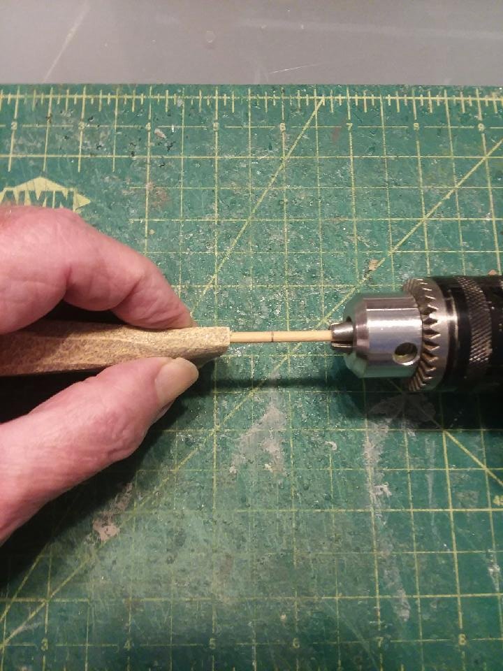

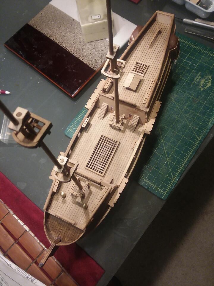

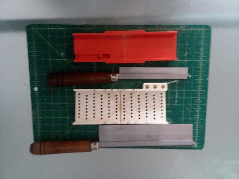

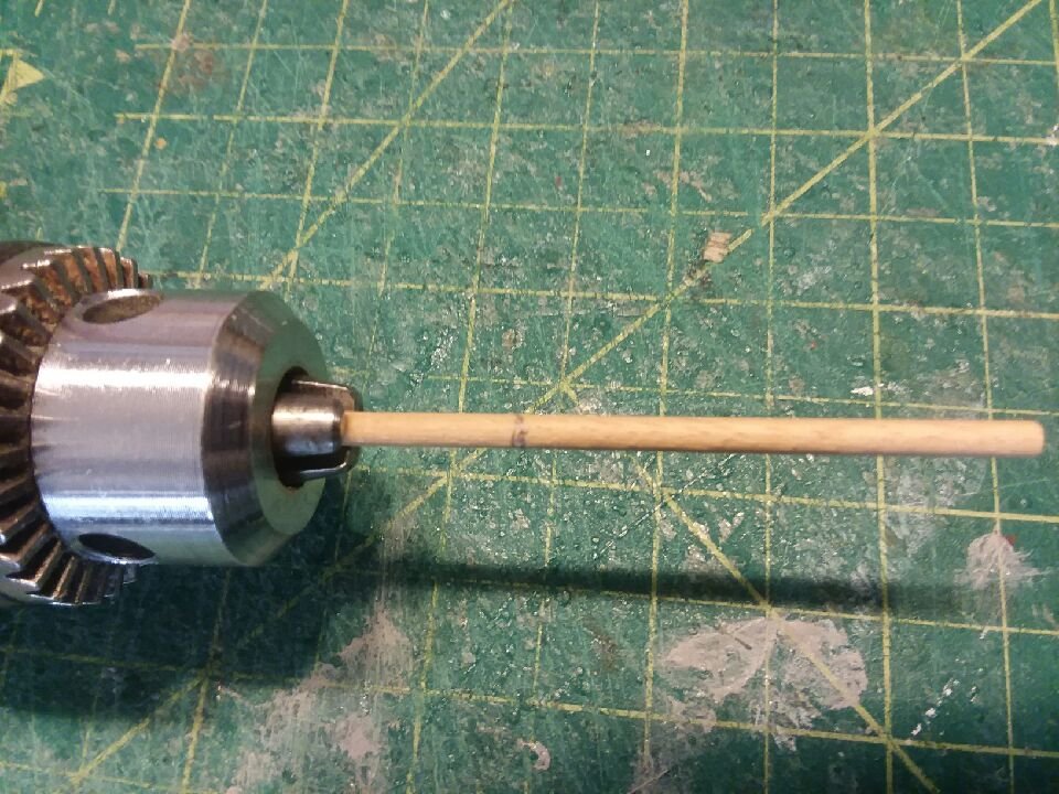

  4. Working on the masts was my next step after doing 4 more planks. I hesitated about showing my basic tools and approach but wanted to keep showing that a decent model can be built without having a dedicated workbench for building models. I live in a 3-room apartment and use the dining room table to work on. This means I have to keep everything in a closet and take it all out, then put it all back in the closet again when I finish. I had hoped this process would make me a more organized modeler, but it hasn't worked so far. I doubt that serious ship modelers are paying any attention to this build, as despite Mantua's assurance that this is a faithful reproduction of Captain Kidd's ship, this kit is pretty much a fantasy ship. I don't really care about this. My wants in a kit are pretty simple: I want an interesting kit that will provide me with some fun, and possibly challenging hours of building time. I want all the parts to be in the kit, especially ones unique to the kit. Most of all, I want good plans and fairly complete instructions. This kit came pretty close on most points, so in spite of probably not being very accurate, I enjoyed building it. Yes, there were a few speed bumps, but nothing I couldn't overcome. I just have basic tools, with the plank bender being the only specialized ship modeling tool. I don't have any special clamps or fixtures unique to ship building, and just want to show what can be done very simply. The Zona saw and miter box are fine for cutting the dowels for the masts because the miter box has a groove for holding round dowels along one side that holds it in place. I use the larger saw and miter box for cutting larger pieces of wood. I cut all the pieces of dowel for the masts at the same time and put the pieces for each mast in a separate plastic bag to keep everything separate for later staining and assembly. I use an ancient electric drill to taper the dowels for mast sections and yards. I finger tighten the chuck just enough to hold the dowel in place without damaging it. I make a pencil mark in the middle of each yard piece so that I have a better chance of making the taper on each side match. I start with coarse sandpaper and work down to fine grit to smooth it. Then I put it all back in the closet.

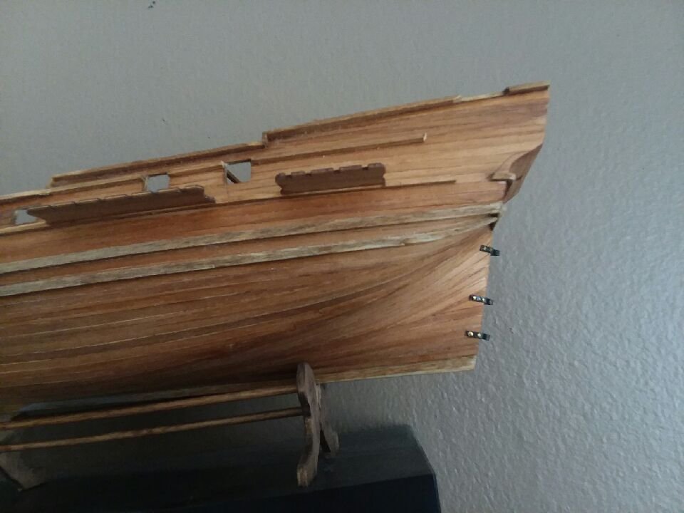

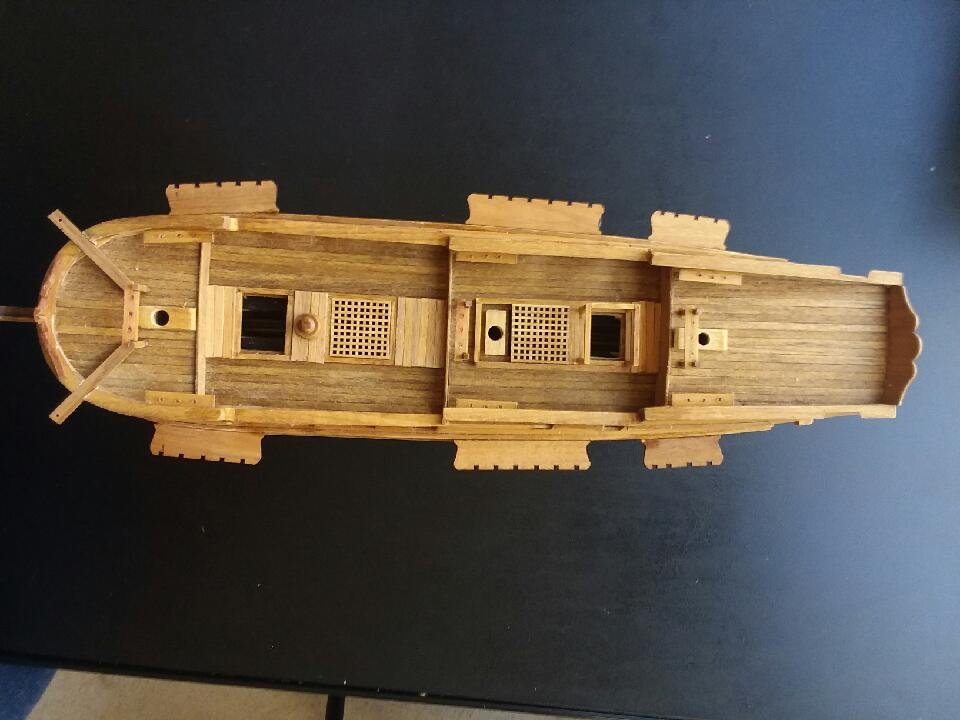

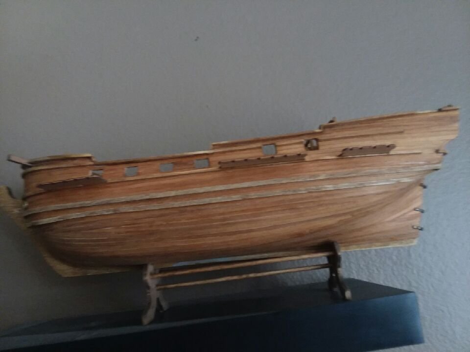

  11. Thanks to those who gave me info on getting my photos into my computer. I finally just emailed them to myself from my phone. Of course I had to then figure out how to get them onto my desktop. Obviously, I'm not much of a computer guy. I've attached 3 photos of my current build, the Sergal President, with the idea of possibly starting a build log. However, I don't want to re-invent the wheel by doing so. I've been building the kit on an IKEA glass-top dining room table using very basic tools, and wondered if this might be of any interest. I have issues with the kit that I've dealt with without going too far. I'll wait to get feedback on the idea of a build log.
