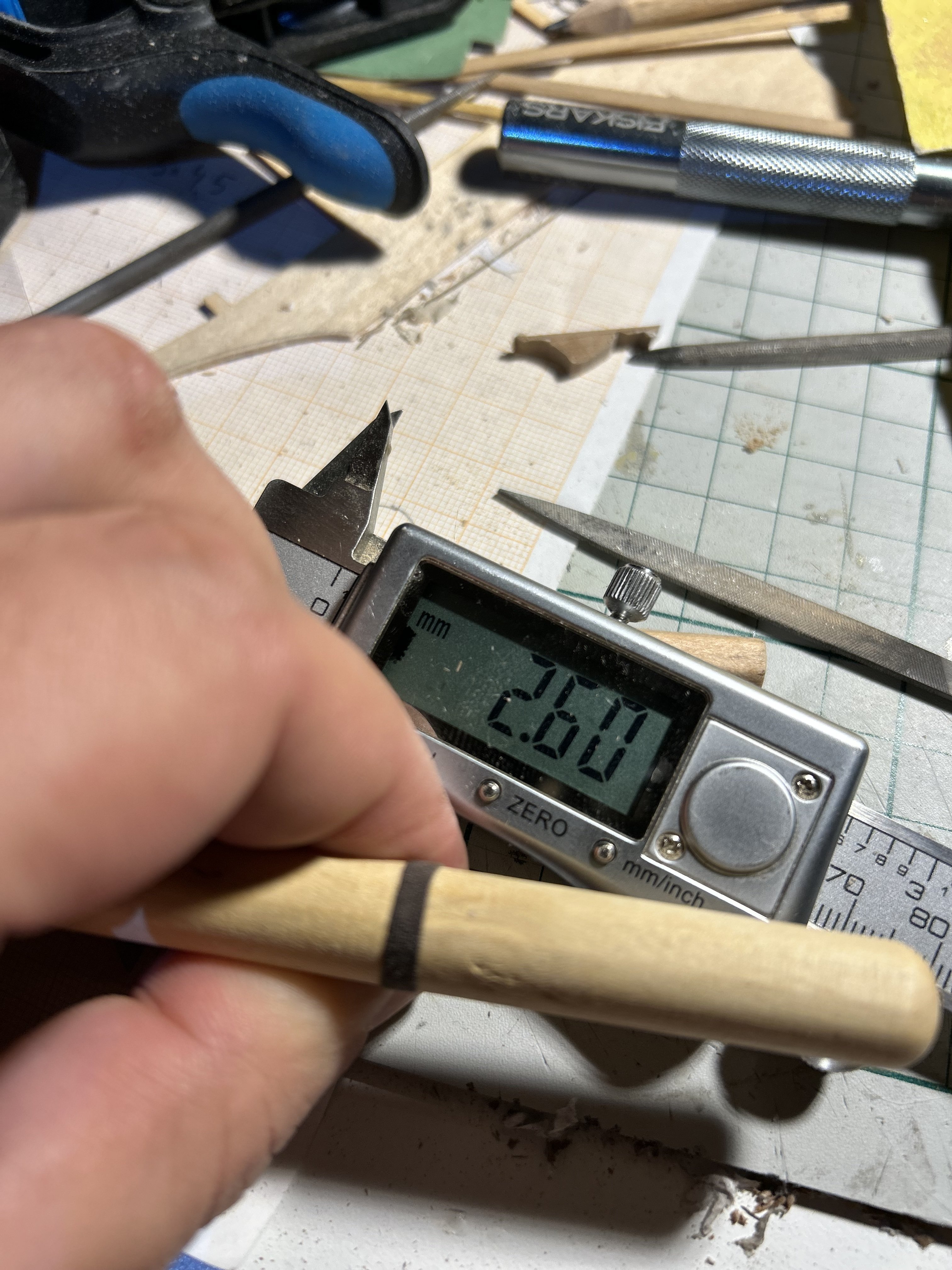

  5. Well, the panel from the kit is still much better, but I’m making progress

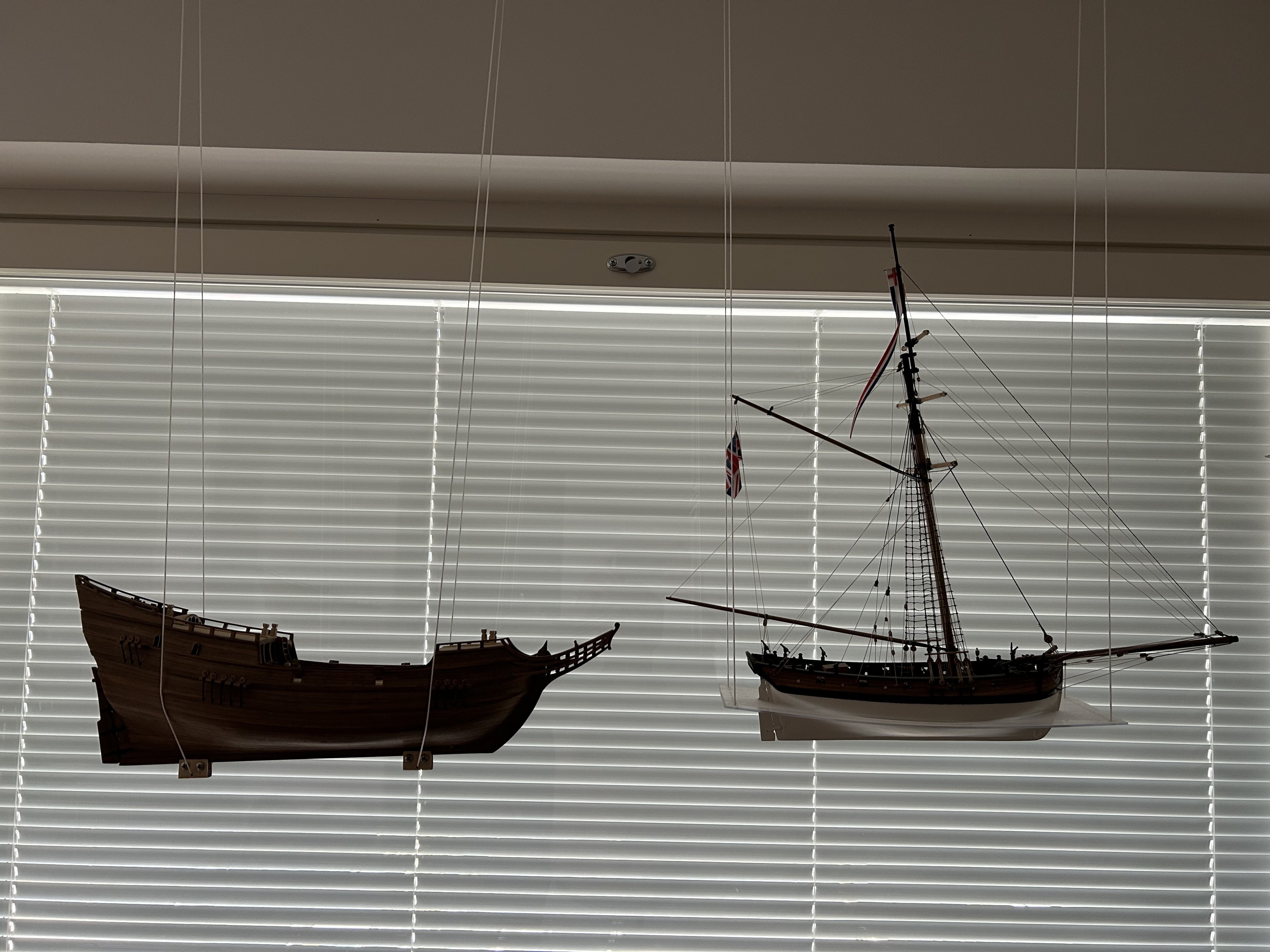

  12. Nirvana - Your Finnish is definitely way better than mine It’s a beautiful language, but I’ve lost all hope of ever learning it — probably the only realistic option for me would be a Finnish wife. I’ve started learning Swedish instead. It’s totally possible they have different versions, or that the kits are made by different manufacturers. Mine looks fine; the only issue I see so far is the fragile walnut strips — though maybe I just did something wrong.

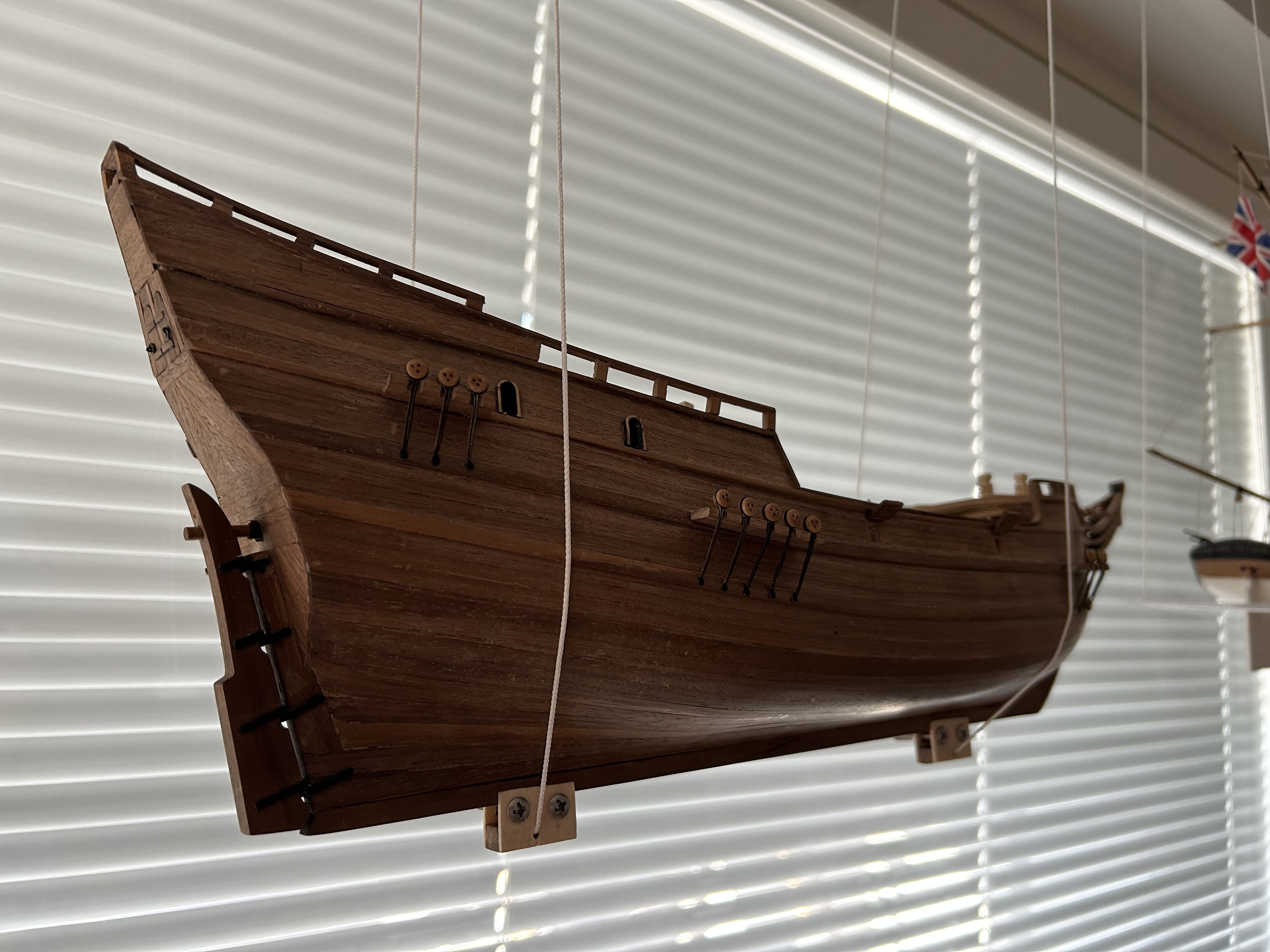

  14. I’m not planning to paint her heavily, but I’d like to add a few light accents. I'm not sure this is the best method, but should work.
  15. Moikka Nirvana! Great choice! Such a nice tiny boat — like a little bird. Next to her, even my Duyfken looks like a whale! I won’t miss your blog — as far as I can see, no two Gretels are alike, so it’ll be interesting to see your approach to this cute bird
  16. Bryan Woods — thanks! Your log is a great guide for me. It’s much easier to follow your steps
