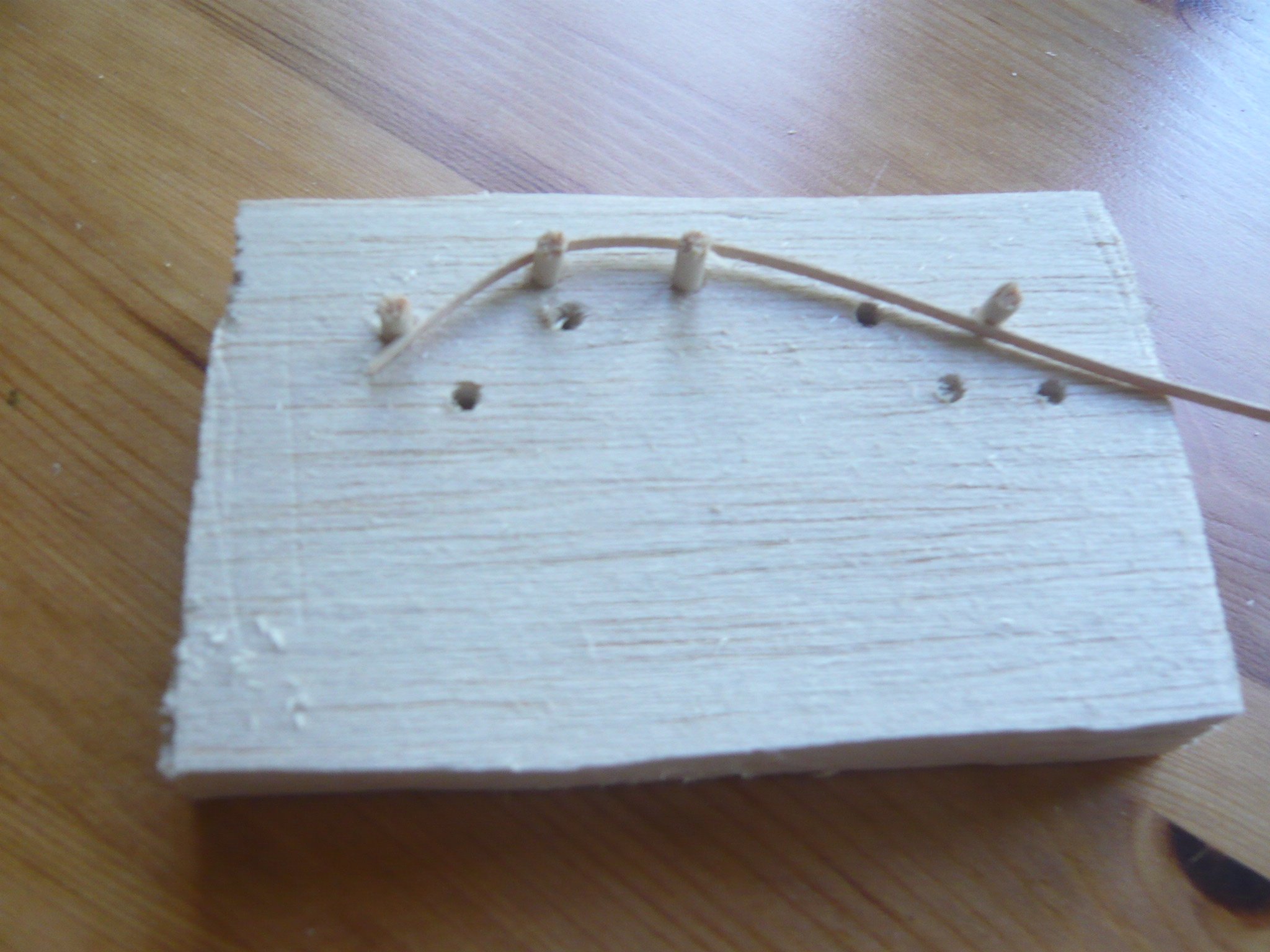

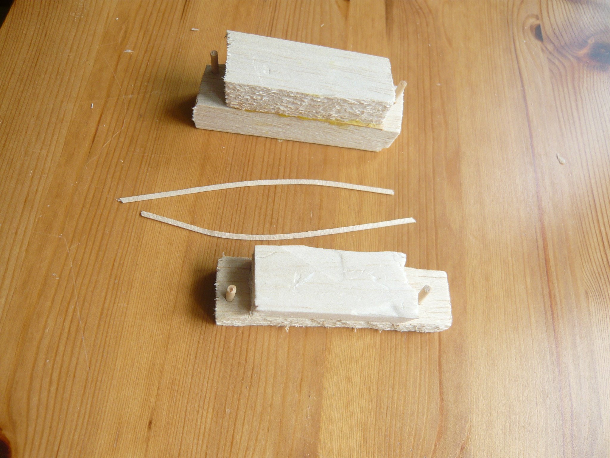

  3. Once again t’s a fair time since I updated this blog - apologies. The bow was a problem, and my initial efforts were a predictable failure. I tried using card, but it just did not look right, even though, unlike wood, there is no problem in bending it. So I have used stripwood, soaking it in hot tap water (provided the boiler is working, which was a bit of a problem until a new one arrived recently). The bent strips are then glued together to achieve a plausible thickness. As for the figurehead, I have used Milliput, as I can’t carve anything that small. The figure is no more than about an inch in height. One grandson said helpfully that it looks more like a seal than a lion, but I think it will have to do. I’ve gilded it rather than attempting polychrome - it’s not clear how the original would have been finished, but this seems best. There’s a good deal of tidying up to be done, and photos always seem to bring out the faults, but I hope this gives some impression of progress on the this part of the model. Meanwhile I’ve also been working on the stern, which is taking ages. Incidentally, I have belatedly found an excellent video of the model in the National Maritime Museum at https://www.youtube.com/watch?v=RAM-K193fYk. As well as the ship, it features ‘relaxing classical music’. I’m not clear who made it, but it’s not the work of the museum.

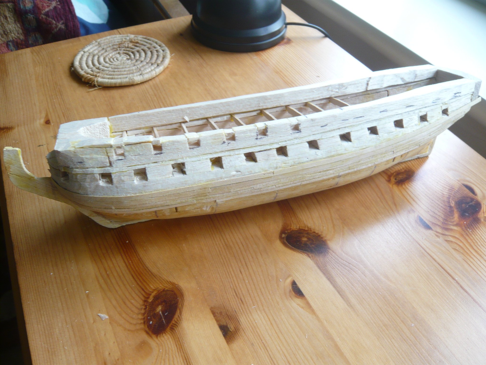

  4. Once again, it’s been too long since my last posting. The model proceeds slowly, Wimbledon on the TV having been the latest distraction. As the photo shows, some of the decks are now in place - the upper deck and the forecastle deck . They present some interesting issues. As I have not installed a large number of deck beams, I have fitted a thin card deck first of all; the planks are then be glued to this. Of the various ways of showing the caulking between the planks, the simplest at this sort of scale is just to use a fairly soft pencil to darken the edges. The focs’l bulkhead is also fitted. I was a little worried that the height of the focs’l deck seemed too low, but it gives, scaled up, a headroom of about 5’ 8”. As the average height of an adult eighteenth century sailor was about 5’ 5” that’s not a problem. The crew of the galleon captured by Anson, Nuestra Senora de Covadonga, were startled to discover that many of their captors were boys, and calculations suggest that on average an eighteen-year old would not have reached five feet in height. So they would not have banged their heads on the deck beams. So, here's a picture of the latest state of play. The plastic aeroplanes, incidentally, are the work of a 12 year old grandson, who is especially proud of the Catalina on the left of the photo. One big issue issue is the gratings, which I’ve not fitted yet. I have seen too many photographs of models where the gratings are just not right. Some have holes which are so big that sailors could put their legs through them. Others are flat, not curved as they should be. I have looked at ways in which others have made gratings, often using complicated saws and other machines to cut the notches, but I don’t have anything that could do that. Anyway, what I need is gratings with holes roughly 1 mm square, which I guess is a bit small for most machinery. So, it’s back to familiar techniques for me - old dogs and new tricks? Here’s a photo of a model I made in, I guess, 1959 or so. The grating is flat, which is incorrect, and the holes too large, but the method is what I still use. Firstly, millimetre square strips need to be cut. Then they are glued onto pieces of a wider strip (I did not have sufficiently thin sheet). Individual notched pieces are cut from this. I tried gluing square strips into the notches, but the results were awful. The problem was that it’s so hard to cut the notched cross pieces just 1 mm thin. So, after unsuccessful experiments, I went back to what I have always done, and stuck each strip to the next. The problem is to make sure that everything is properly aligned. It means that the grain of the crosspieces is wrong, but at this scale that hardly matters. it’s possible to bend the grating slightly, to give it the requisite curve. It’s not ideal, but it’s the best I can do. Sorry - some of the writing is missing from the photo, but I hope it's clear enough. Here's the best effort so far One problem is that there is no deck plan for Centurion, nor have I found a photograph of the model in the National Maritime Museum that shows how the gratings were arranged. There is, however, a useful photo taken from above of a modern model of Centurion based on the one in the National Maritime Museum. This sold at auction by Eldreds in 2020 for an impressive $7,500, for which the lucky bidder did not even get painted decorations or masts, let alone rigging (https://www.eldreds.com/auction-lot/exhibition-standard-admiralty-board-style-model-o_F934F9EBC2), which is useful. Also there are some later eighteenth century plans on the NMM site, and they are helpful.

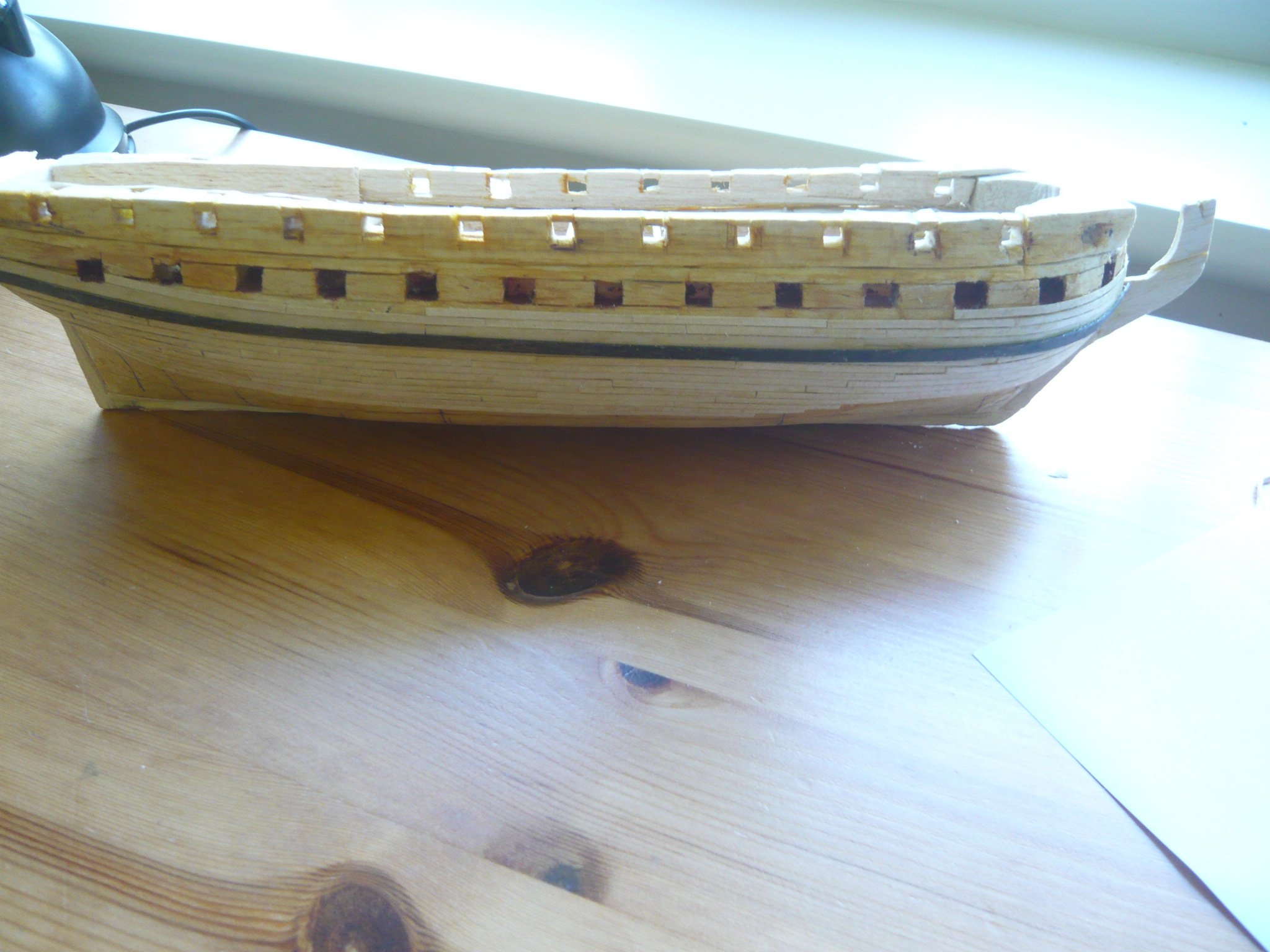

  5. It’s a long time since my last posting. There’s been the garden to do, and I’m in no great hurry. Well, the planking of the lower part of the hull is now finished. I’ve used strips of lime, 2 mm X 0.5 mm. There’s not much choice as far as I can see, and this is fine. Scaled up, that size would mean planks roughly one foot wide, so it’s not too unrealistic. The planking is not as neat as I’d really like, of course. It’s had a coat of shellac, and will have another after yet more sanding. As it does not look too bad, there’s a temptation to leave it unpainted, but a final decision as to whether to paint it white can wait for a long time. Most contemporary models had white hulls, but there are some exceptions. Oh yes, you may notice the moulding at the stern. That's an experiment with Milliput, and I think I will go on using it. Carving wood at this scale is beyond me.

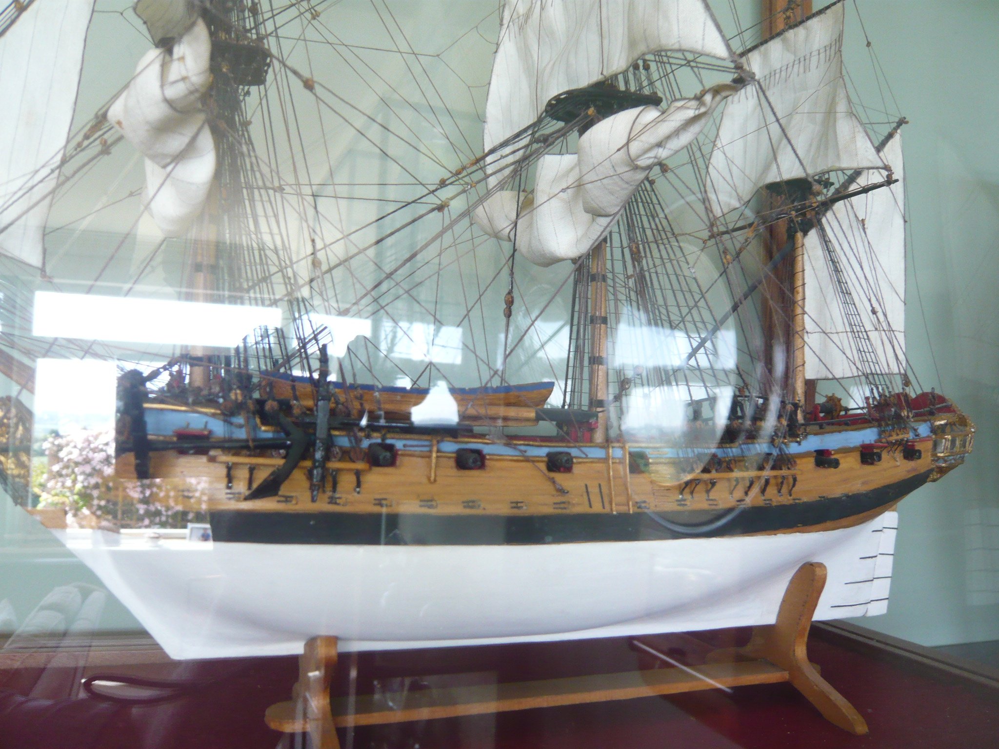

  6. Now, planking. One way of simplifying it would be not to plank the hull below the wales, and just to paint it white. This is what eighteenth-century modelmakers did with bread-and-butter hulls, and it’s what I did in the late 1950s, as in this model I made of a 6th rate (I think the sails, by the way, were cut from an old pillowcase). Apologies for the reflection on the case in this picture. No doubt the ‘white stuff’ used to protect hulls before the advent of copper plating hid some of the planking lines, but the picture by John Cleveley the elder of ‘A Sixth Rate on the Stocks’ does show some at least of the lines made by planking. So, I’ll plank this hull. It’s a bit like three-dimensional marquetry.The balsa wood is a bit of a problem as it soaks up the glue too much, so the first step is to put on a coat of shellac. Then I began with the wale, or at least with a plank which will in the end be under the wale. Calculations for the rest suggest that at the bow the planks will need to be roughly 2/3 of the width on the rest of the hull, and with any luck it might even be possible to do the planking without any need for steelers or drop planks. At this scale, with planks 0.5 mm x 2 mm, bending them is not too much of a problem. I have found it sufficient to soak the wood in hot tap water - no need for boiling - for an hour or so to soften it. It could be a different story with thicker and wider wood strips. I find a thumbnail often better than any tool, but a simple jig helps. The extent of the bend can be adjusted by using different holes for the pegs. Where it gets more difficult is that the planks near the bow need to be bent in three dimensions, and after finding a helpful video on the web, I am using formers to create the desired bend, which helps to prevent the planking having an appearance of clinker build. The formers are made of two blocks, with a template between them. I know it looks primitive, but it works. The glue I am using, incidentally, is ‘aliphatic’, whatever that means, and yellow. Like so many excellent things, it comes from Cornwall Boats. There’s no question of trying to reproduce the treenails that would have been used to fix the planks on the full-size ship - that would be impossible at this scale. Nor do some very fine models, such as that of Bellona on the stocks in the National Maritime Museum, show them. The picture above shows the start of the planking process, with the hull still in a pretty crude state. Do remember that it's very small. Next shows the start of work on the wales. The wales could be difficult, but I’ve not gone for a complex solution. The main wale should rightly consist of three strakes, with complex butt and hook joints. However, when I built Agamemnon to the same scale I tried anchor stock joints, but by the time the wales were sanded and painted, most of them could not be seen. So, I have gone for two strakes of 0.5 mm x 3 mm, with no joints. I’ve ignored the evidence of the model of Centurion’s bow in the National Maritime Museum, which shows what look like a double wale; the model made for Anson has solid black wales, and that seems right for this period. I have dyed the wood as this should make neater edges than painting.
