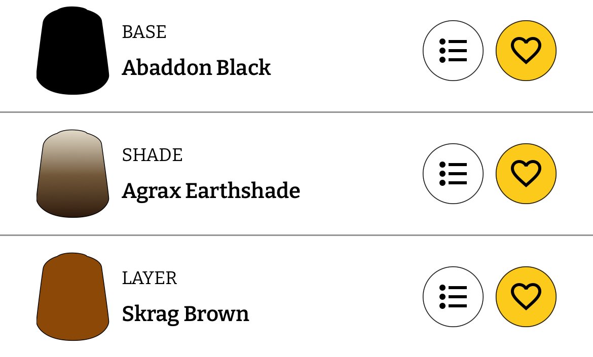

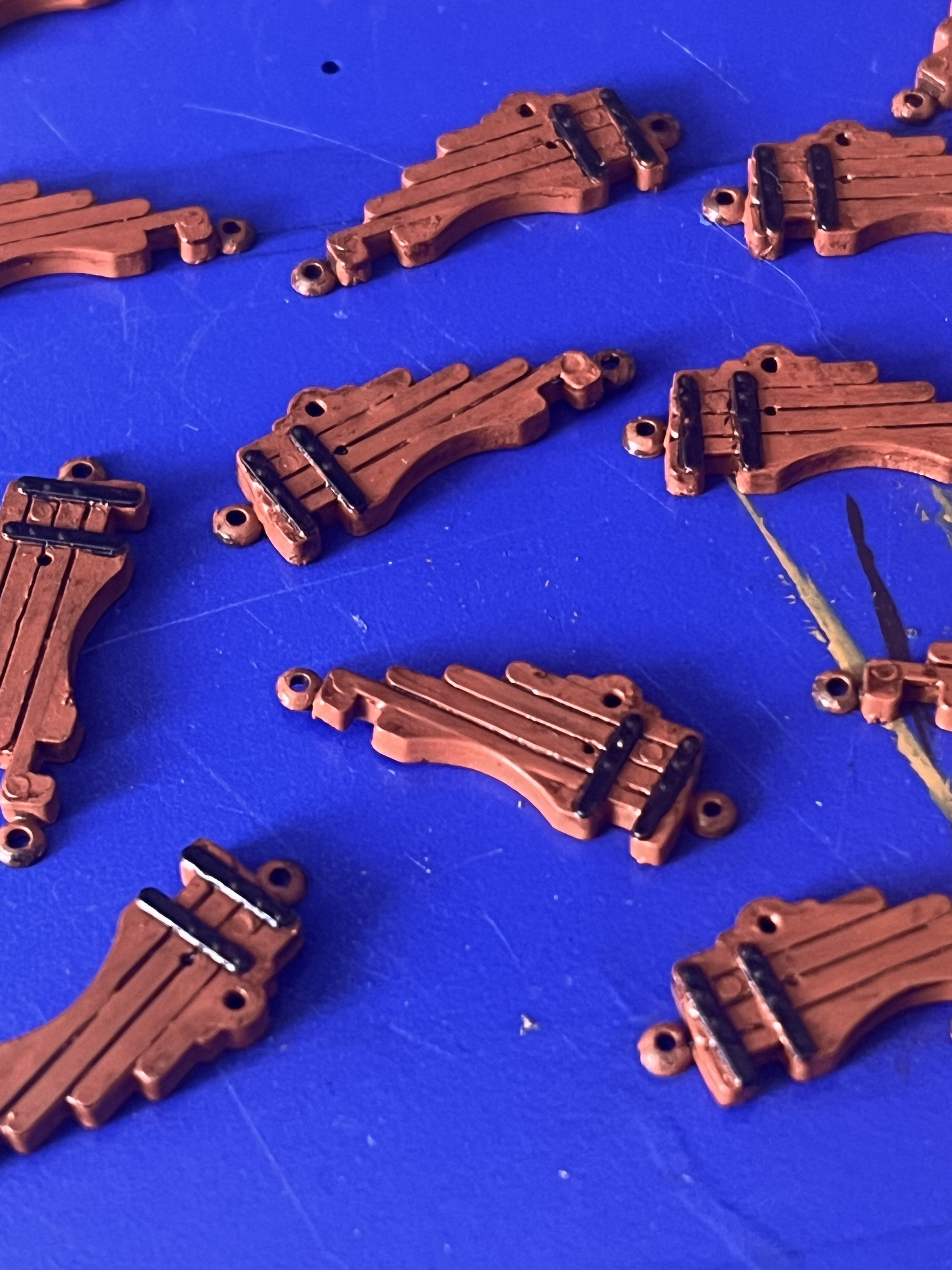

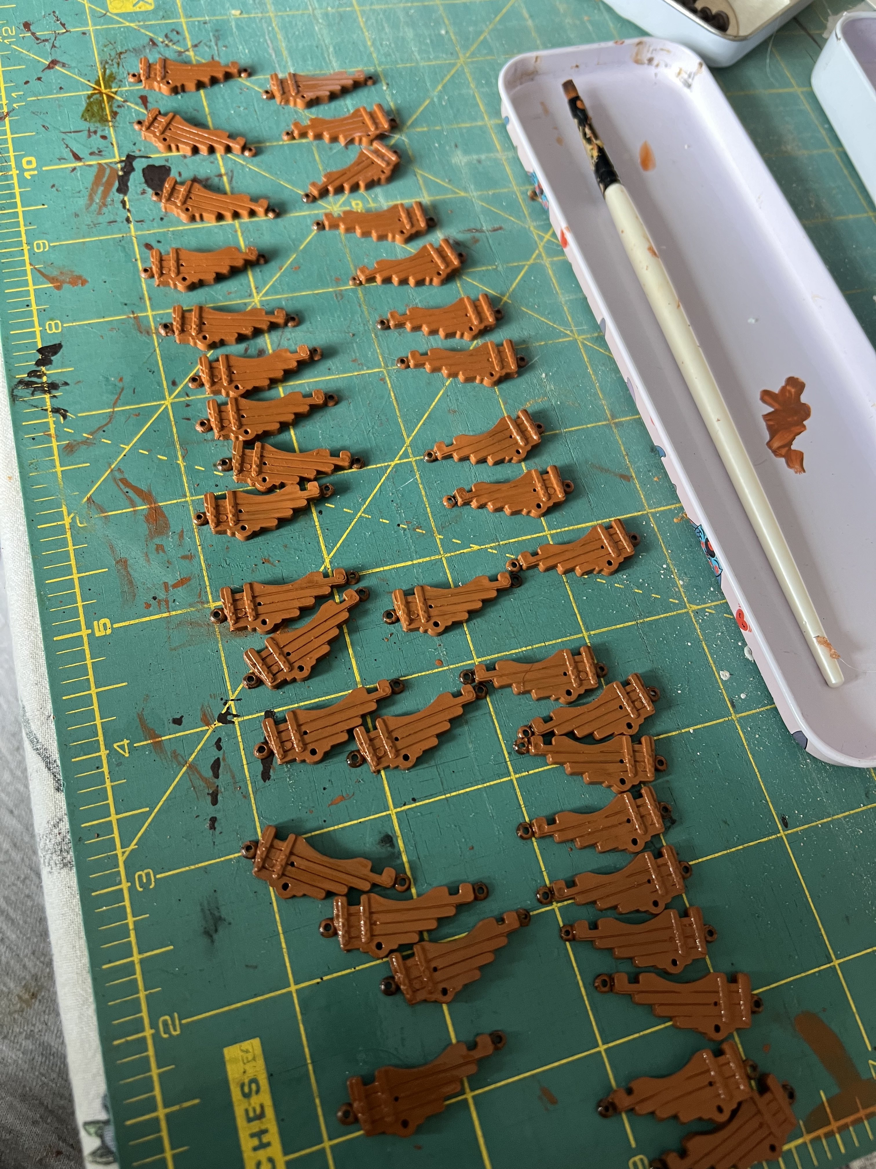

  1. Painting some of the canons for the Billing Boat Norske Love. Brown layer first. The a coat of hair spray to seal everything. Then I put some shading on it to give it some depth then finally the black for the metal work. Paint list is included in the photos
