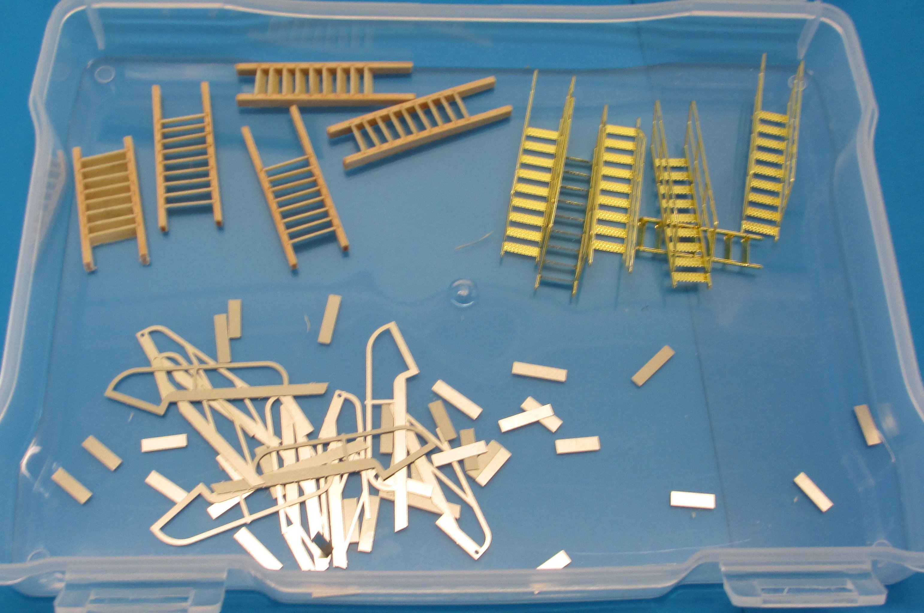

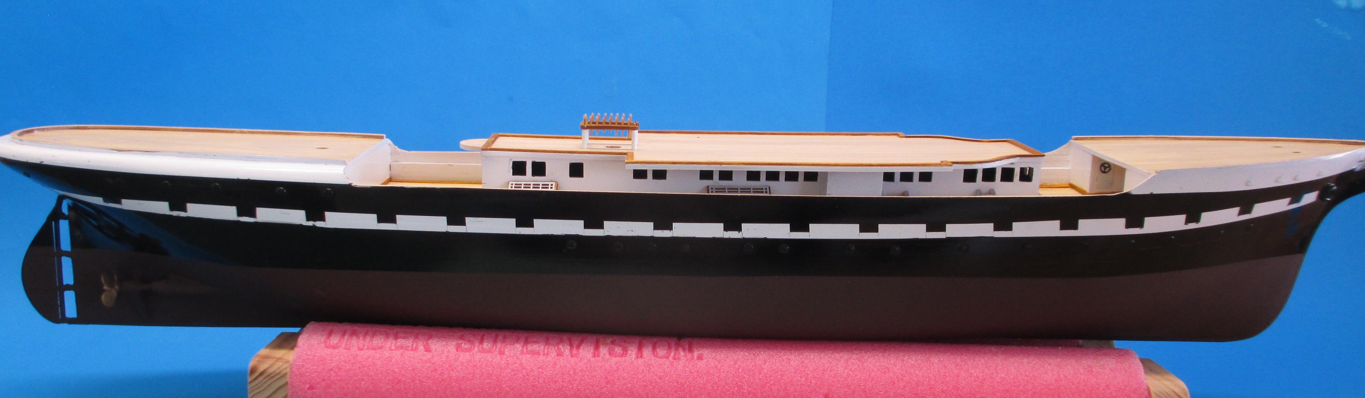

  2. I have had a break from the BELEM after mast pin rails and the ladder PE parts crumbled. Moving on, I have painted the hull and prepared most of the deck parts for final assembly. While waiting for the new PE ladders to arrive I built some out of scrap timber. I will use the brass ladders as this is closest to the full size ship - photos seem to show brass treads. The mast pin rails were made from 3 layers of 0.5 plywood. The larger Syren belaying pins look the best even though they are a bit oversize. The final ladders will be the brass treads glued to the original side rails. The plastic parts trays were money well spent to keep all the parts neat and tidy.

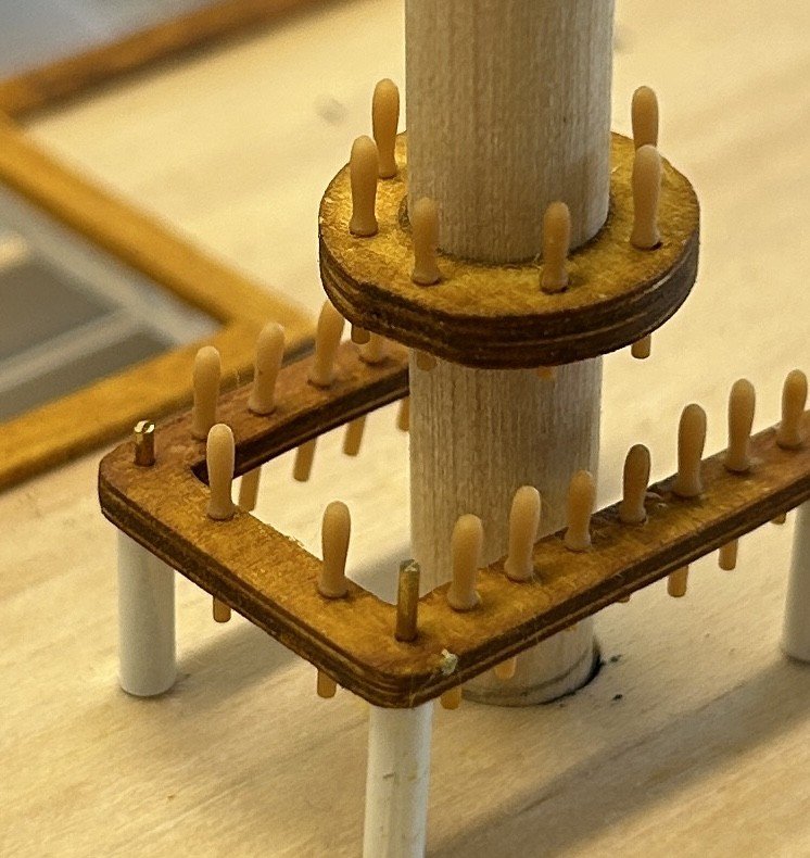

  3. Replace Pin Rails and fit Syren Belaying Pins The existing ply pin rails have been replaced with laminated 0.4mm ply. I used 3 layers of 0.4mm ply that were each rotated 120° and glued with Titebond. The resulting board was very stiff with no weakness in any direction and could be worked without any tear out. Mounting posts were made from 1/32" brass rod and concentric sleeves to make an overall 3/32" diameter post. The pin rails were finished with Syren 1:64 Belaying Pins. This is the AL version of pin rails and the new laminated plywood pin rails. I made the posts from brass as I had the material and it easy to work and fit. Fitting the posts to the deck was easy to align by drilling through the rail and deck together and inserting a brass pin to hold the rail position while the other holes are drilled. Then just insert the brass sleeves to complete the posts. The end result is now presentable but I will give the timber pin rails a slight reduction in size before final painting and fitting.

  6. An option is to make new parts out of laminated 0.5mm (0.020") birch plywood. Only glue together once the laminated parts are bent in position or close to it. Here is my replacement plywood of some pin rails that broke. Ian

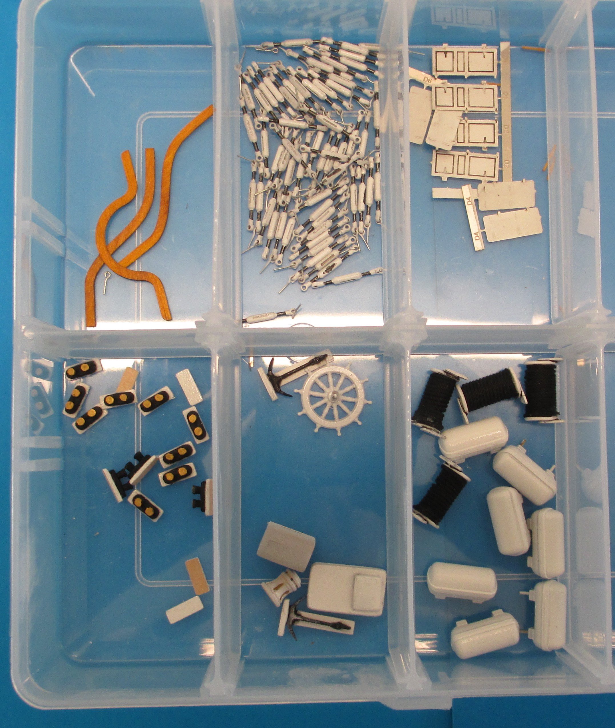

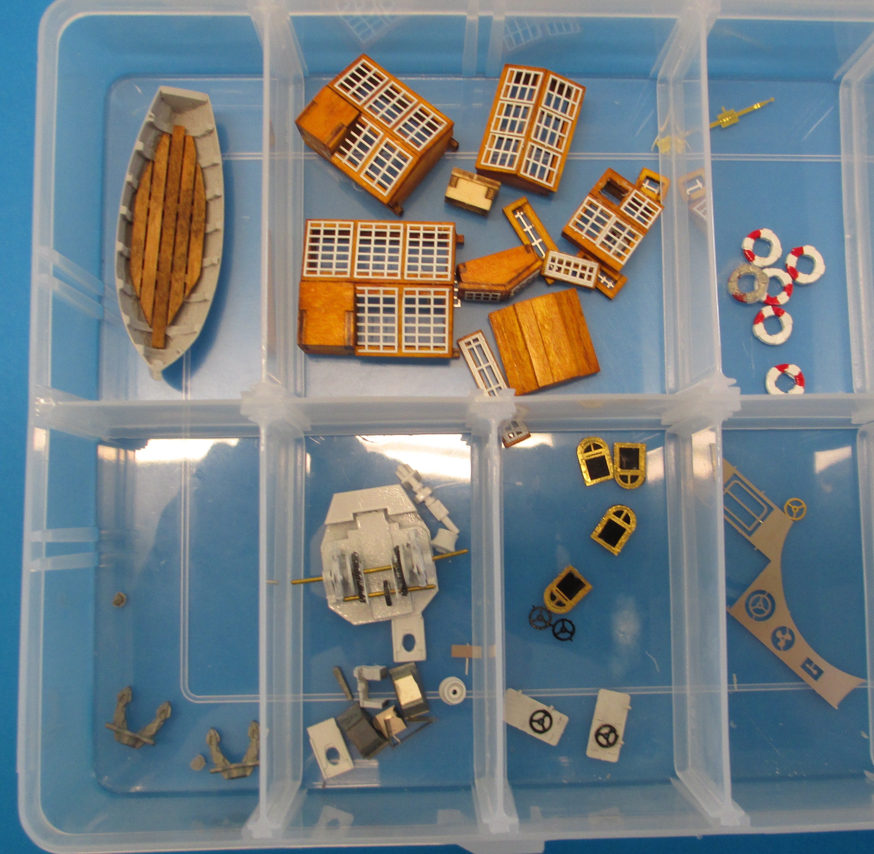

  7. I have decided to assemble and paint all the PE and cast parts in 1 or 2 batches. There are many hours filing to clean the s...alloy cast parts but the end result will be worth the effort. Below are some photos of the portholes and rudder ready for etch primer.
  8. For something different, I am building the smaller parts into final assemblies. Below are the hatches and light/vent boxes. The PE parts are stainless steel and much easier to work than brass that must be annealed to avoid work hardening and cracks. Paint finishes are a regular topic so I have included what I used on the PE parts - generally what I have for the plastics car models. The SMS Etch Primer was the first coat on the metal followed by grey surface primer and then white lacquer. I have always used Mr COLOR Leveling Thinners for lacquer and acrylic paints. The leveling thinners was a game changer for my car finishes where a little sanding with 1500 - 5000 grit sandpaper before the cutting polishes produces an excellent result.
