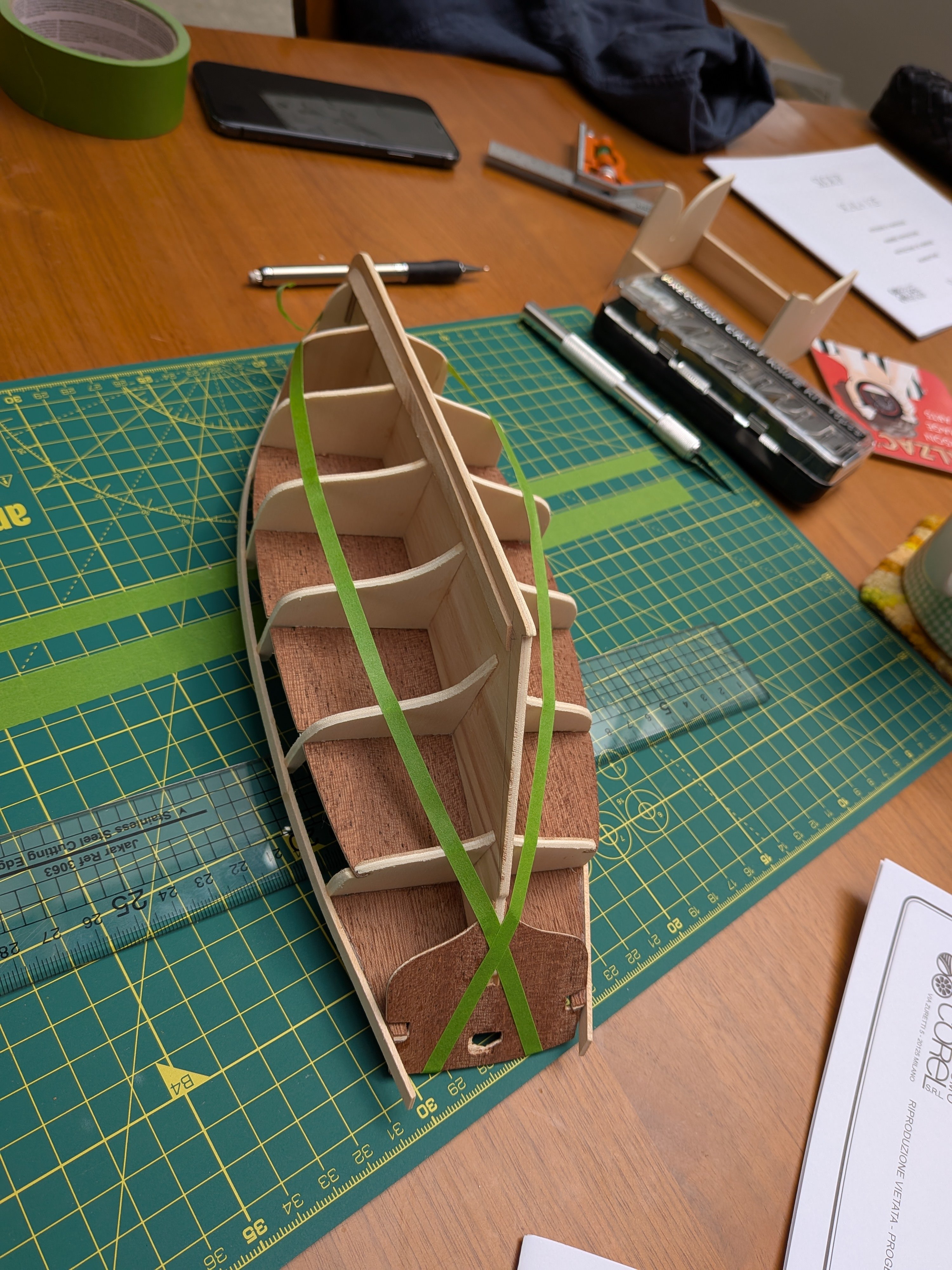

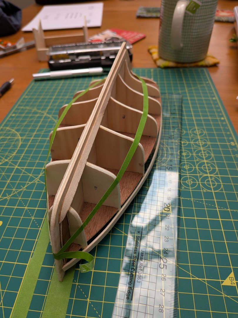

    2

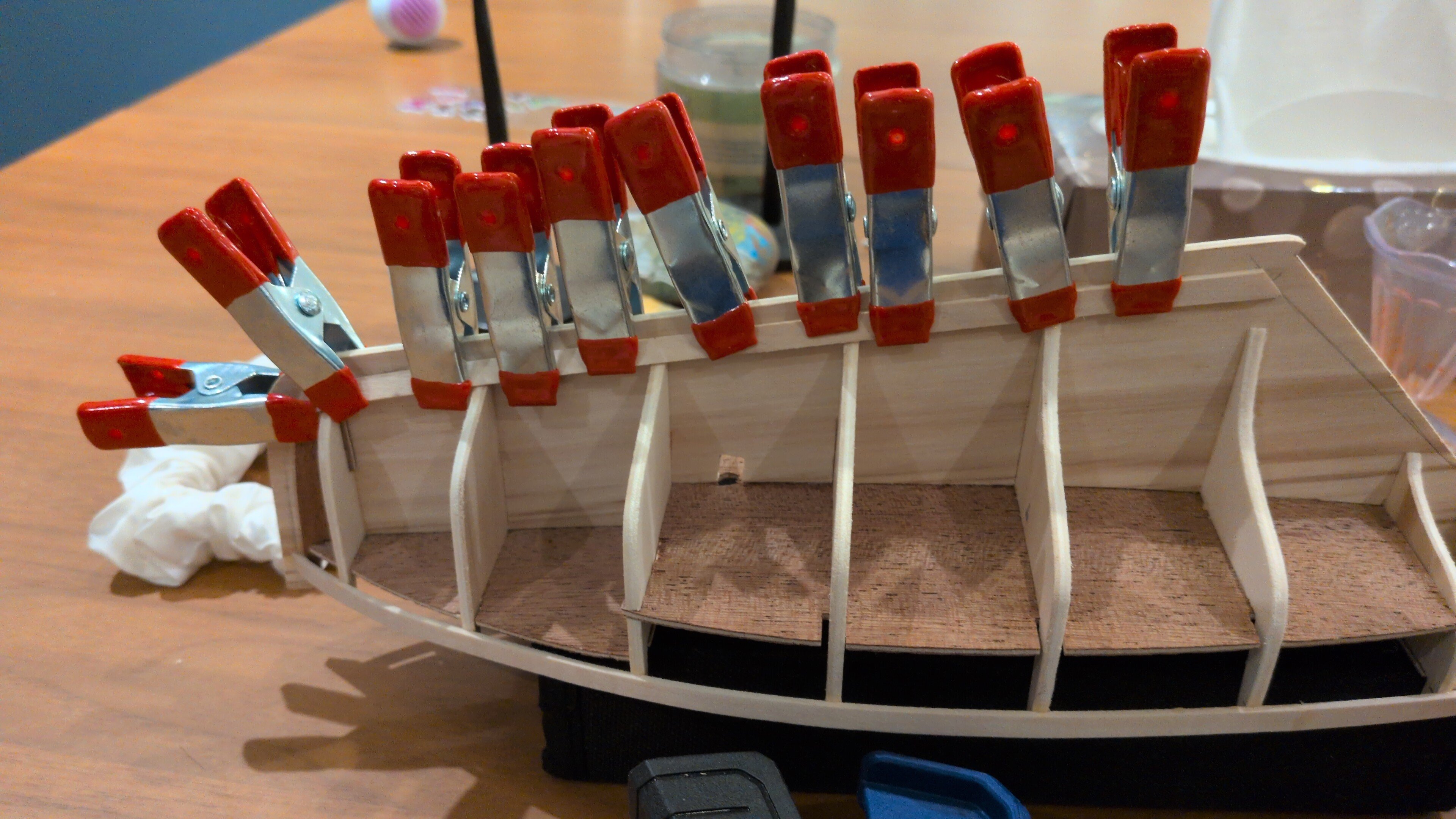

  1. I've bought a plank bender which helps getting it around the hull, but it seems some of the planks also need to be bent side to side to accommodate the curvature of the hull. This is undoubtedly due to my hubristic insistence on trying to avoid stealers and drop planks. So I've ended up with a lot of raised edges and gaps that will need to be sanded/filled eventually...
