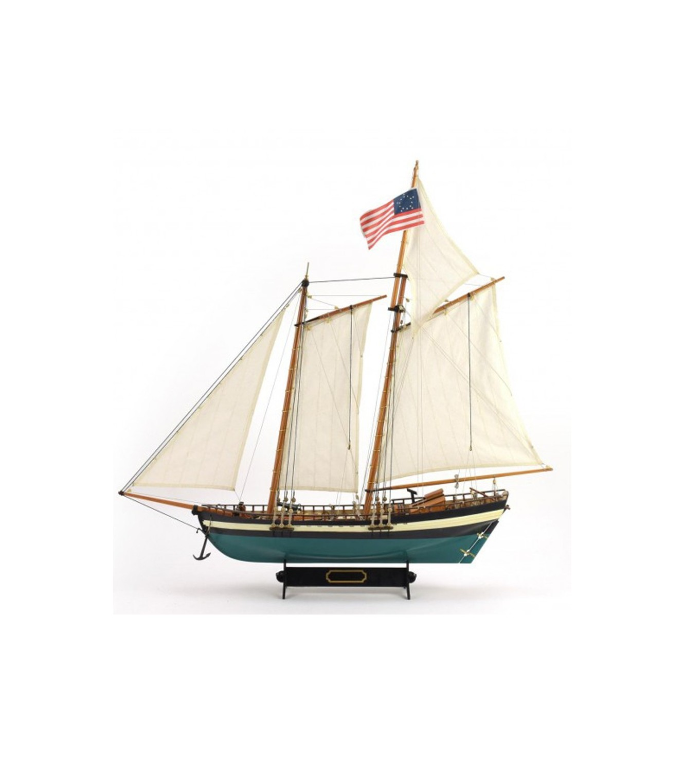

  4. So while my Bounty boat's fittings arrive, I'm getting started on my next build - the Artesania Latina Virginia Schooner. My main goal with this (my second build) is to do the planking well - ideally the 'correct' way rather than the instructions' method. Fortunately, this model will also be painted so I can hide mistakes if when they occur. (I'll likely refer to this vessel as a ship throughout the log despite it obviously being a schooner) First step was the framing. I am fairly proud of my idea to 3D print some blocks that I could clamp to each bulkhead to make them be almost perfectly square. (You can see some in the background on the right of this picture. ... and the deck (subdeck) is attached I expect tomorrow we'll start planning out the planking.
  5. Ok so we're pretty much done for now. I need to order some more pulley blocks and cleats to finish up the rigging so this boat is being put aside while those arrive. Next up is Artesania Latina's Virginia Schooner. So the sails went on fairly well. The jibs seem to be a bit larger than the instructions think and I had to move both forestays' attachment up the foremast in order to get the sails to even fit. Here is a highlight of the halyard I added to the mainmast and I did the same on the fore. Overall, I think this boat turned out pretty well for my first full vessel model (pending some little touch-ups). Definitely learned some techniques that'll come in handy in the future. The schooner I'm building next is only single layer planking so the pressure is on to do it right based on what I learned here.
