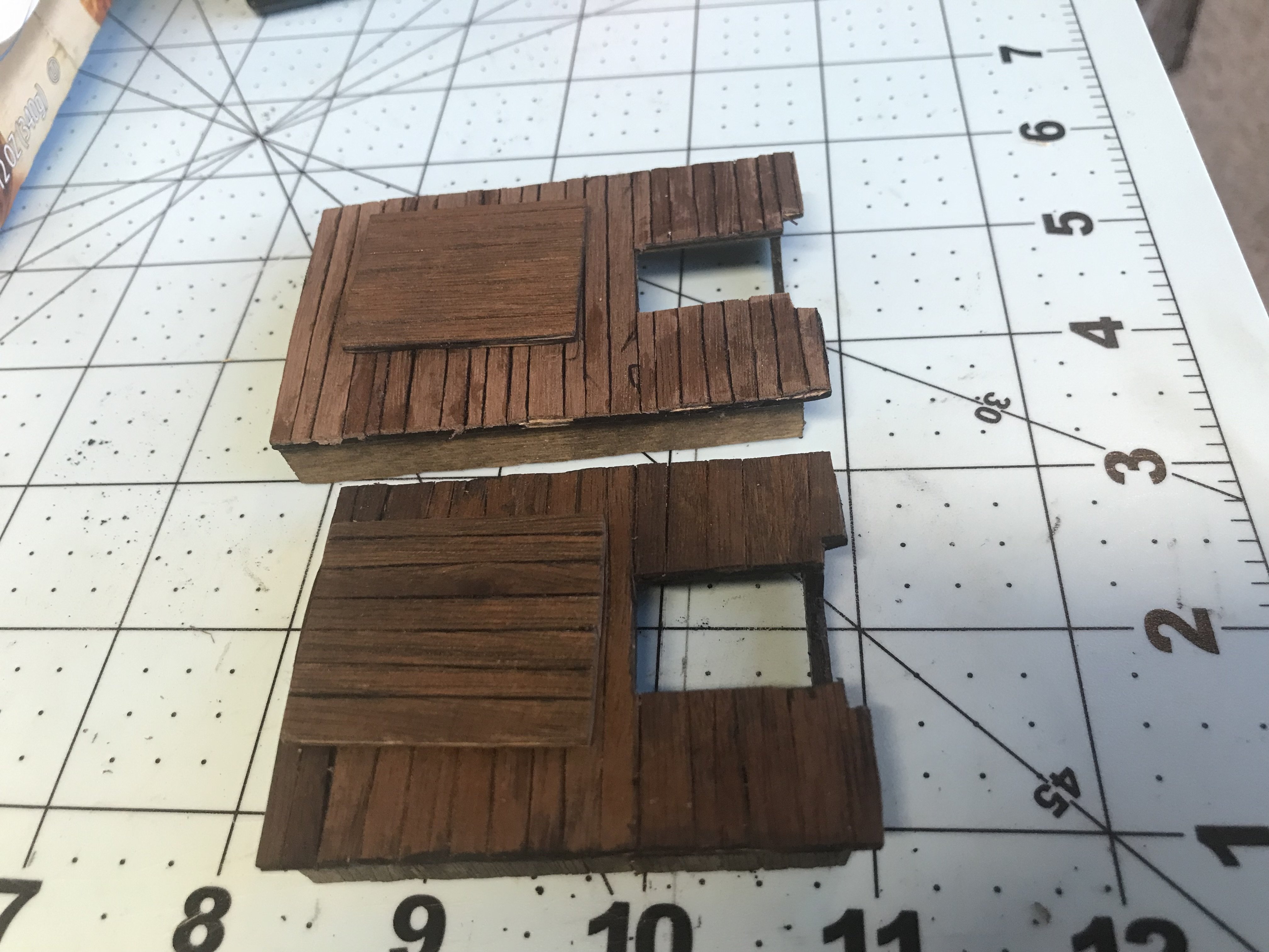

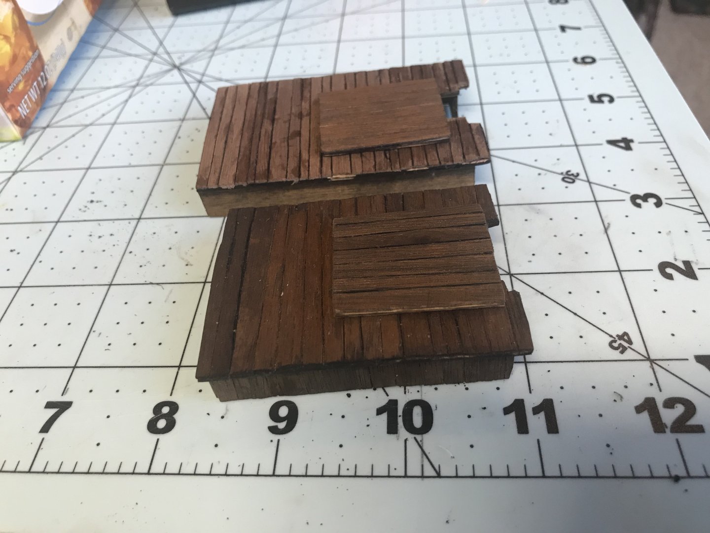

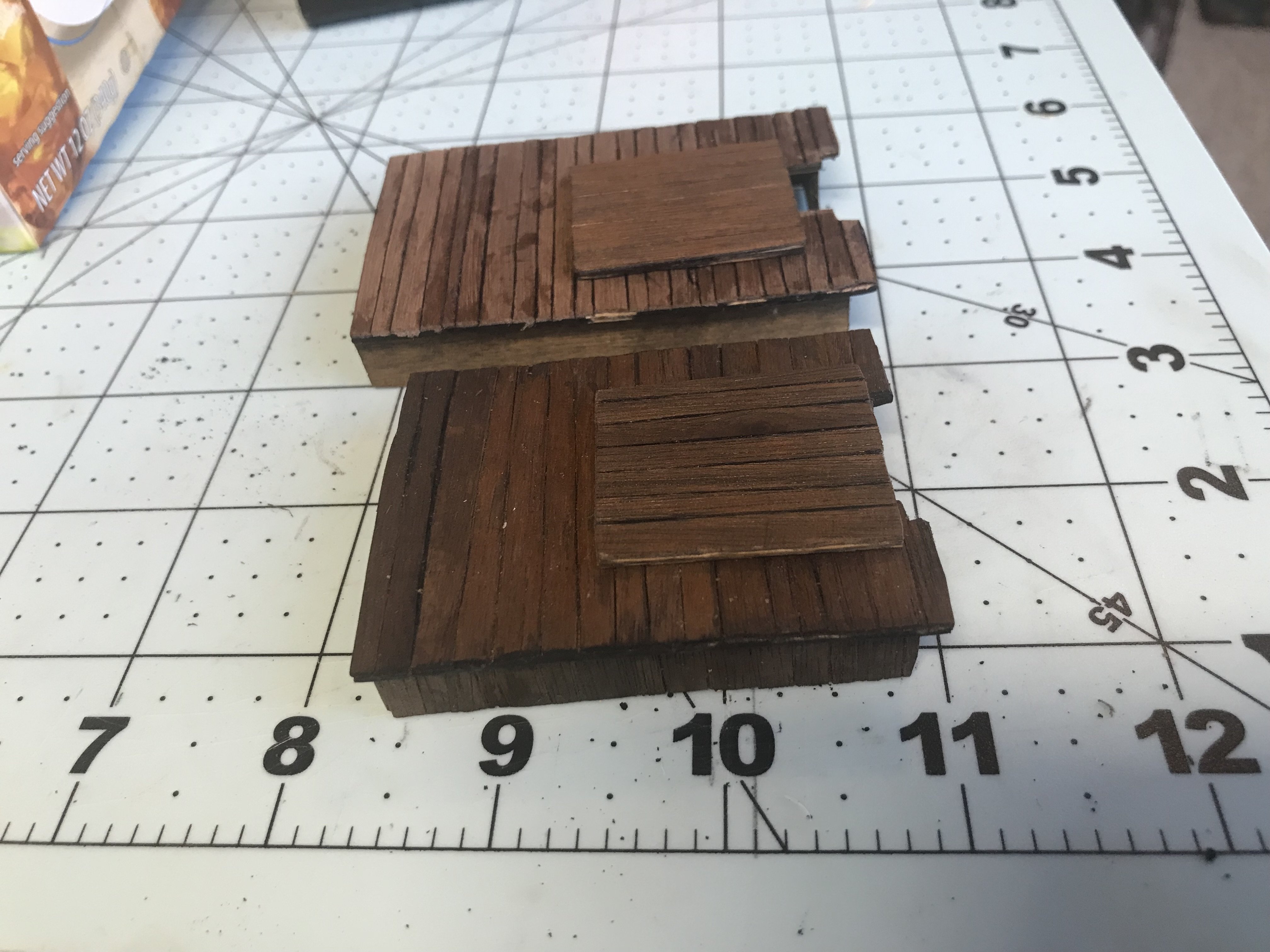

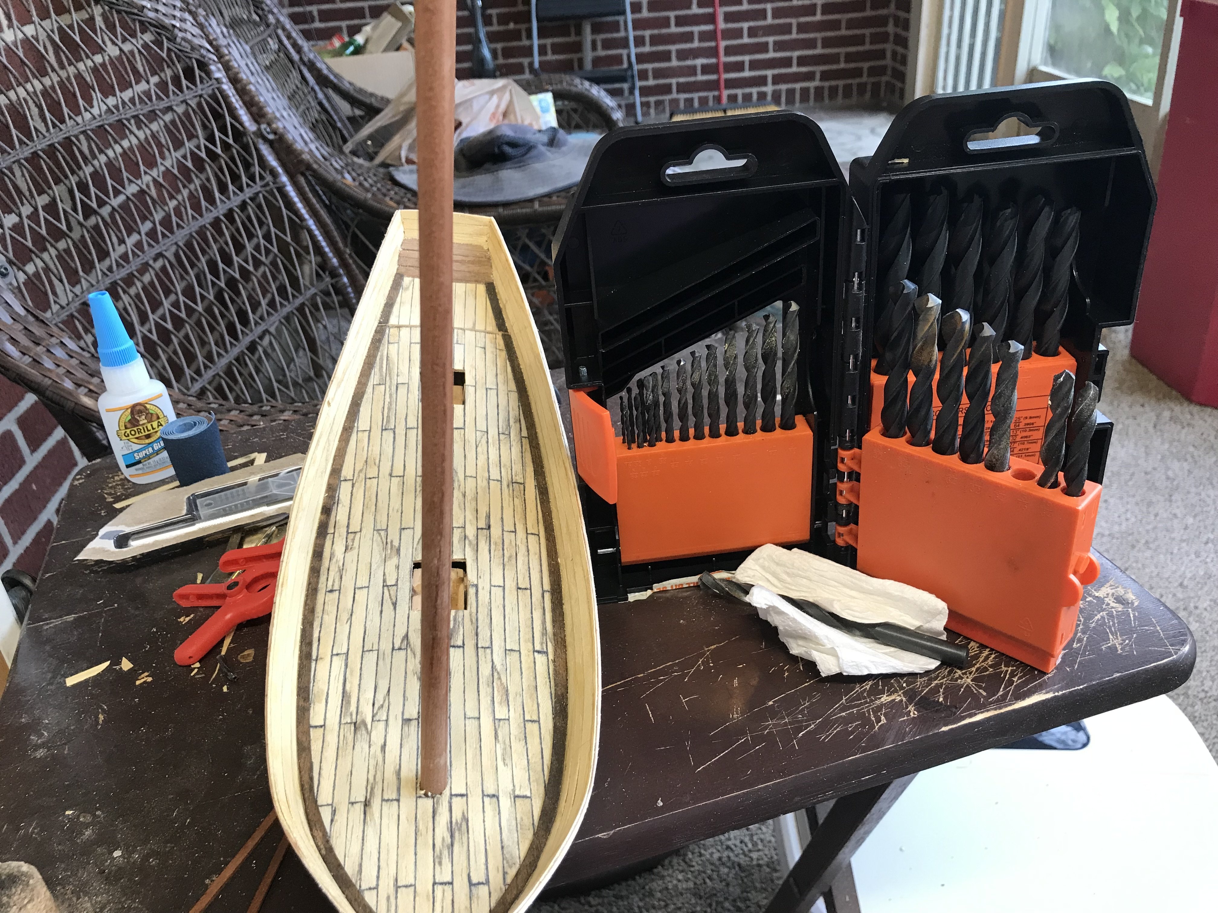

  1. Life’s been a little bit busy, so I haven’t posted. But I have been working a little bit at a time. I’ve got the stanchions and stringers installed. I’ve just about finished the deck houses. I decided to plank the roofs across the beams instead of fore to aft.  I like the look.

      Looking very good! I like the deck planking!

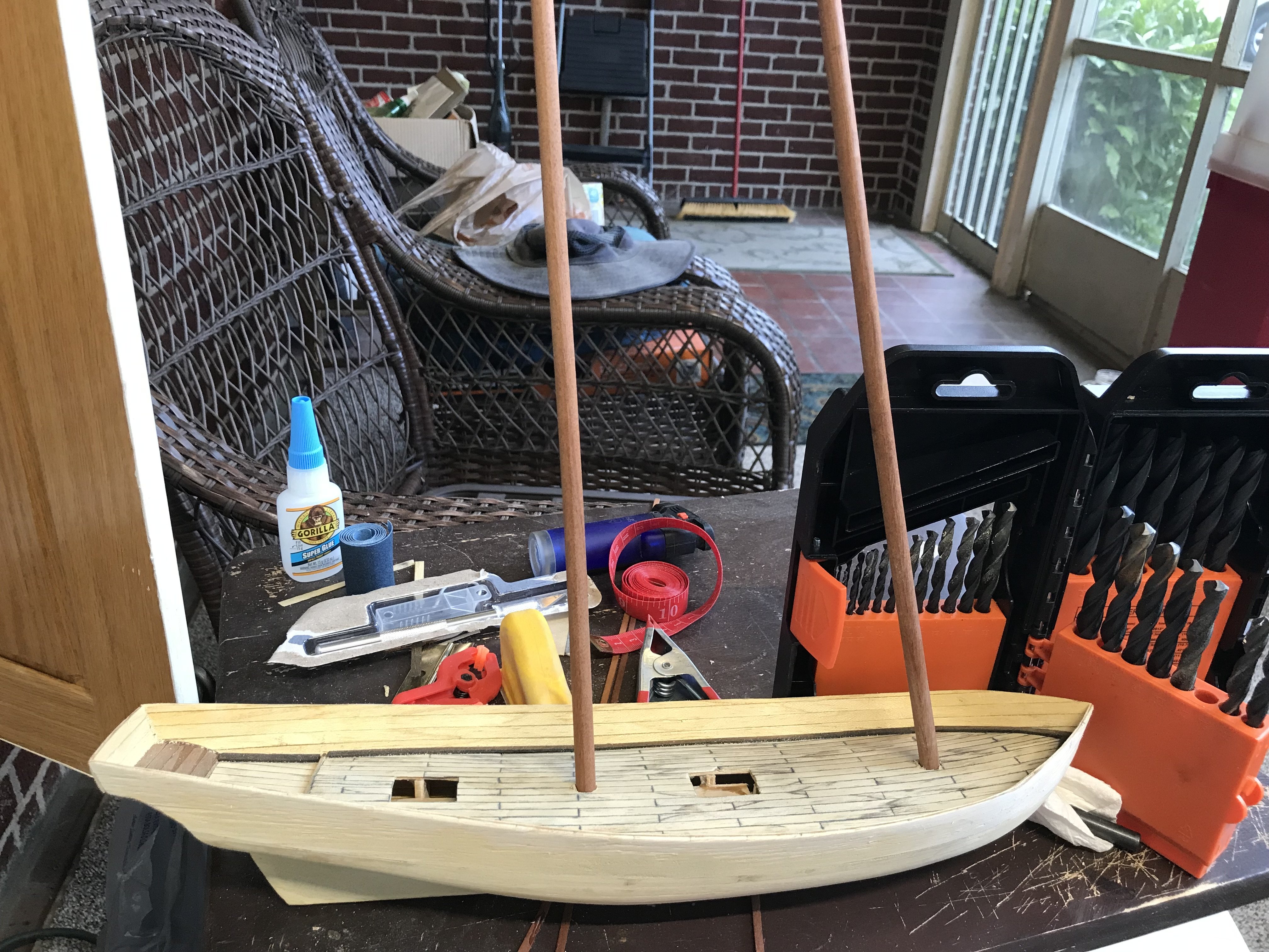

  2. I got the deck stringers stained and installed. I appreciate the work and skill that I’ve seen in making jigs and drilling the mast holes. I have a lot of drill bits and I started a very small pilot hole and worked my way up, one size at the time. It looks good to me. Now to work on tapering the masts.

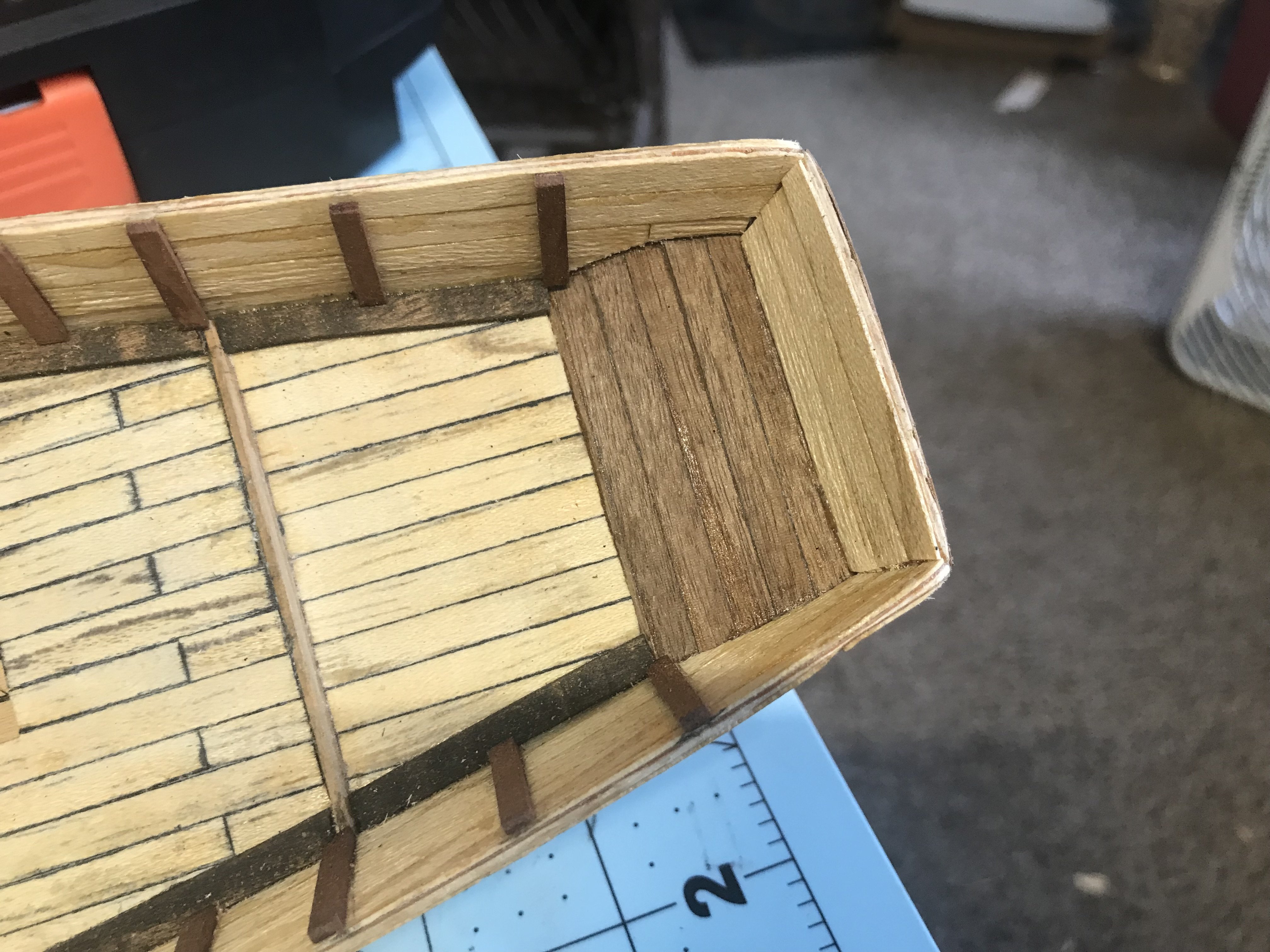

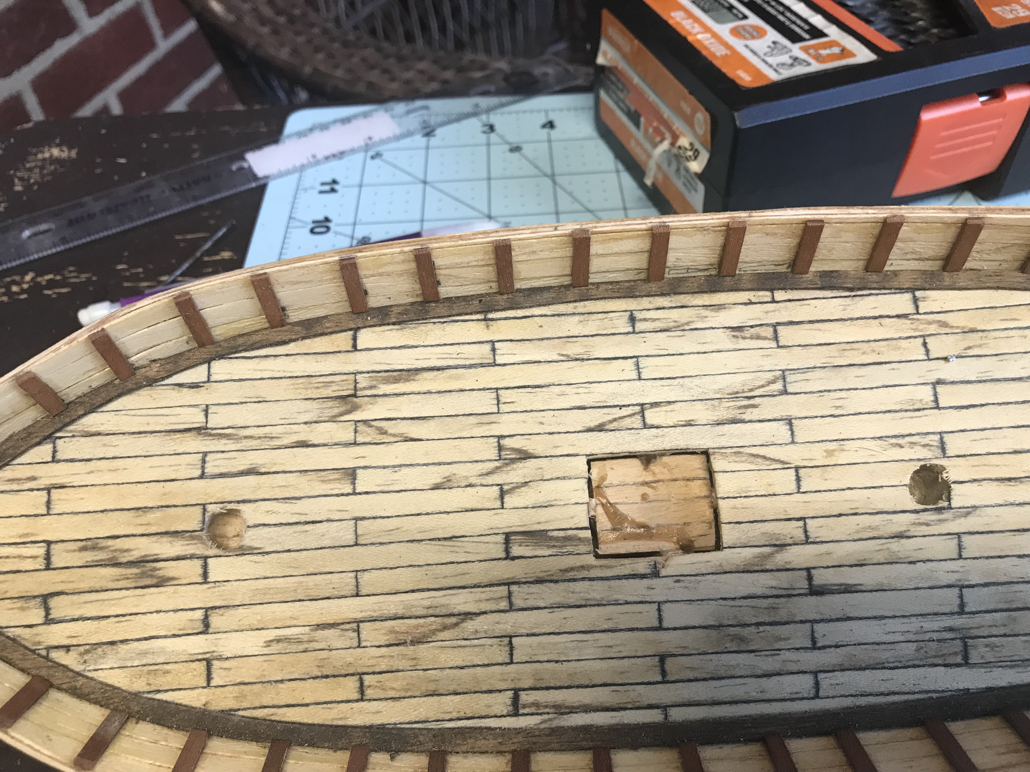

  3. Whining ended yesterday.  Today it’s back to work.  I don’t have any varnish to train th plywood walnut, so I decided to go ahead and plank th inside of my homemade bulwark.

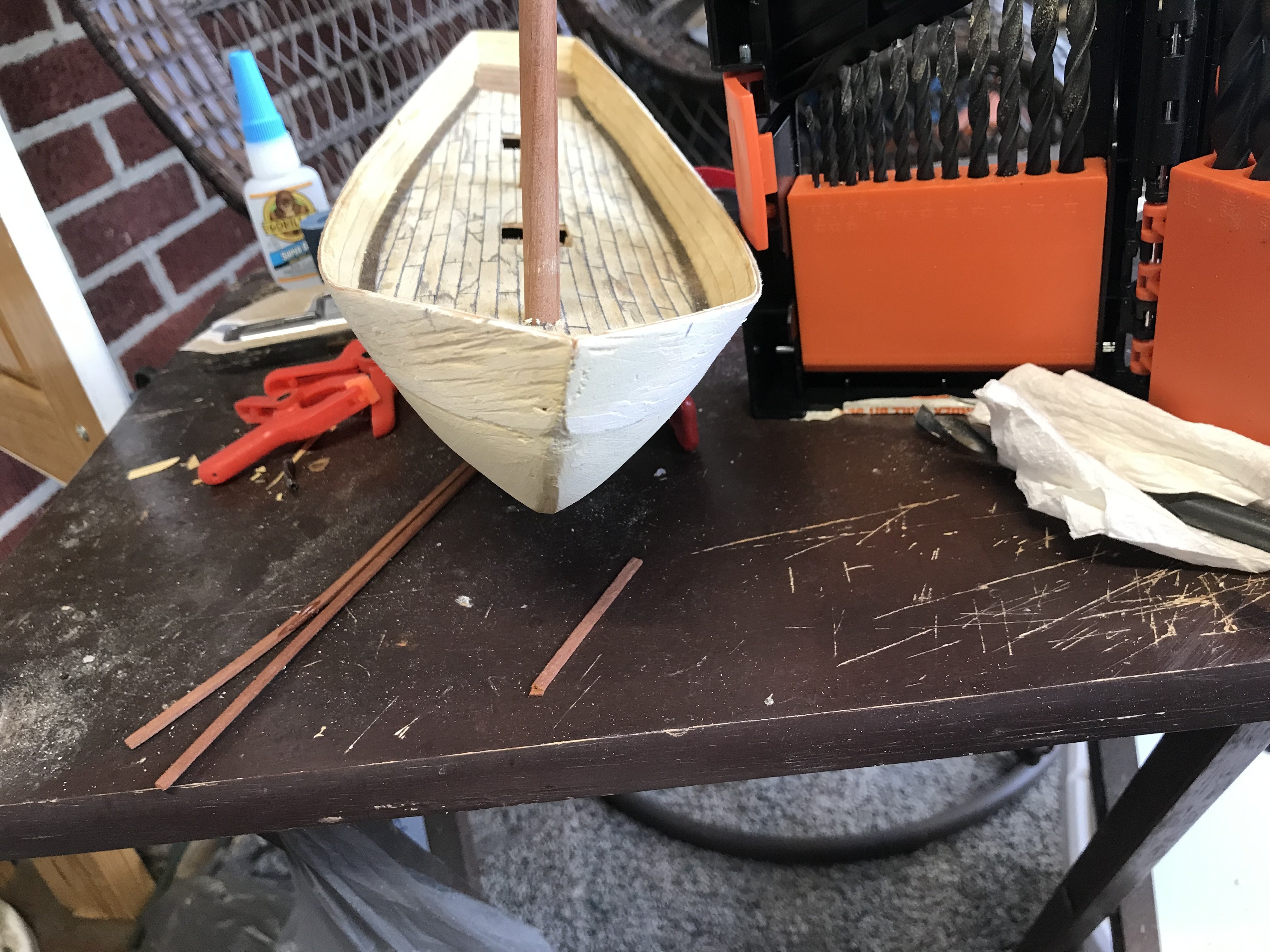

  5. I’m moving on to the deck stringers and bulwark stanchions. I don’t have the tools to make a fancy bending frame, so I used square push pins

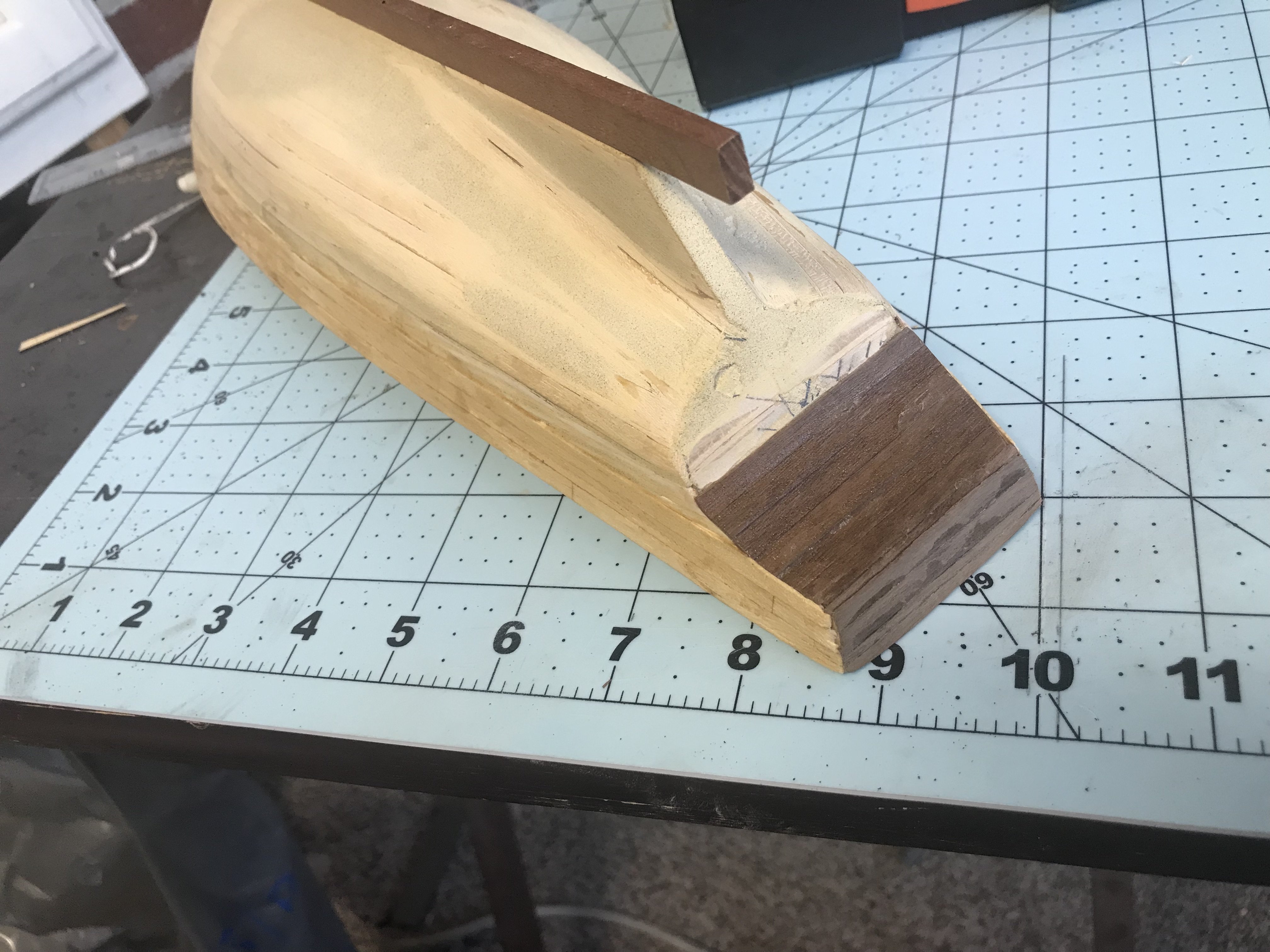

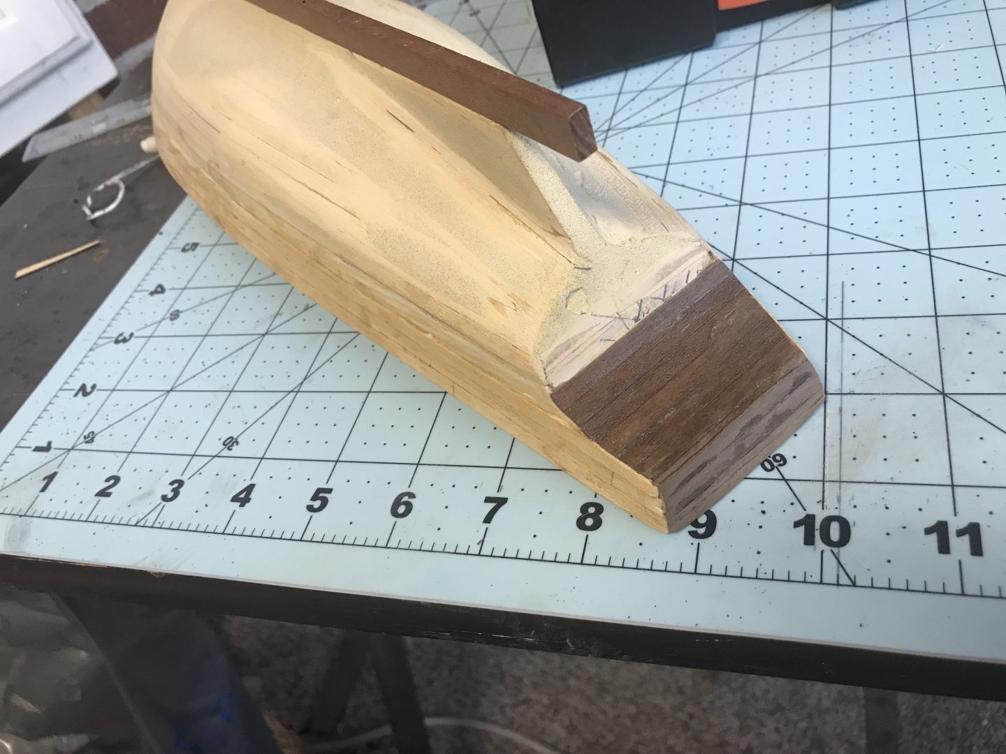

  7. I said I had no idea what I was doing. I was at the home supply store that rhymes with Goes. I found a piece of 1/2” birch plywood that was delaminating. The store practically gave me the piece. I brought it home and cut two bulwark pieces. It’s not finished, but it looks doable.
  8. I couldn't stand looking at it. Cut it off and waiting on some walnut veneer.
  9. I said I had no idea what I was doing. I soaked the bulwarks, wrapped them around a tuna can and when I started the glue up, the plywood delaminated. I’m torn between cutting it all off and leaving it and covering it as best I can. It is my first model and a learning experience. The port side I would live with, starboard warped in a weird bulge.

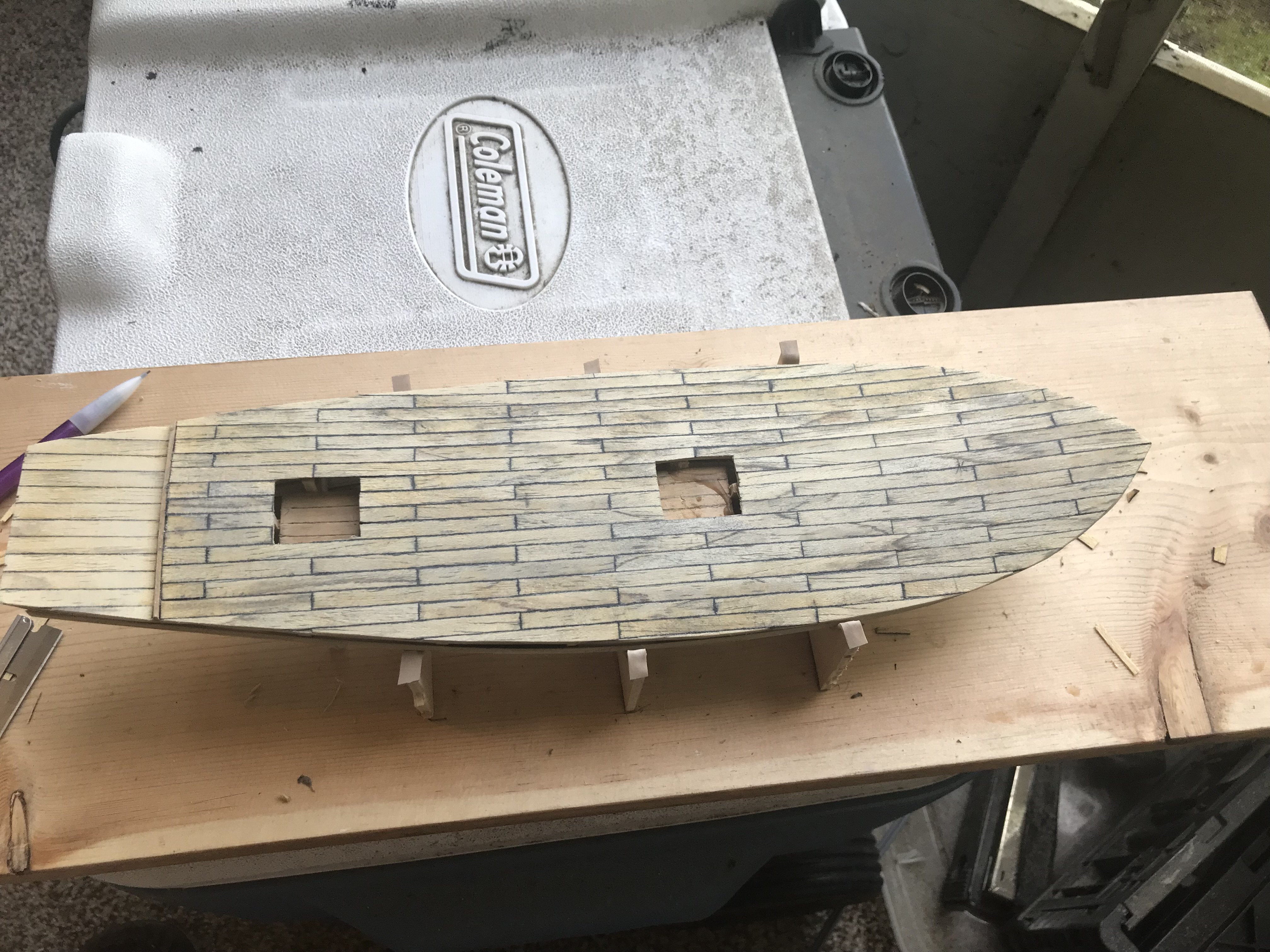

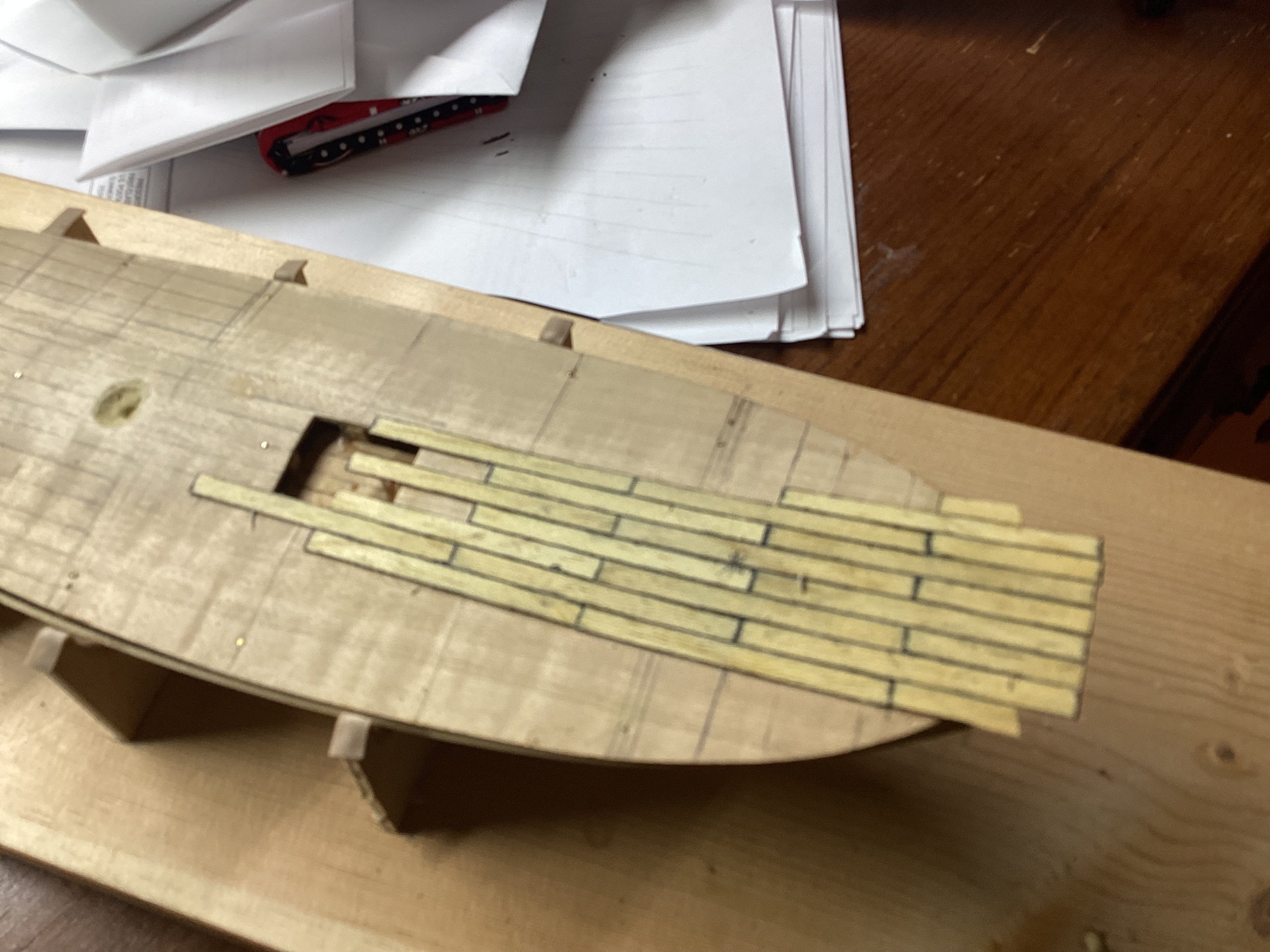

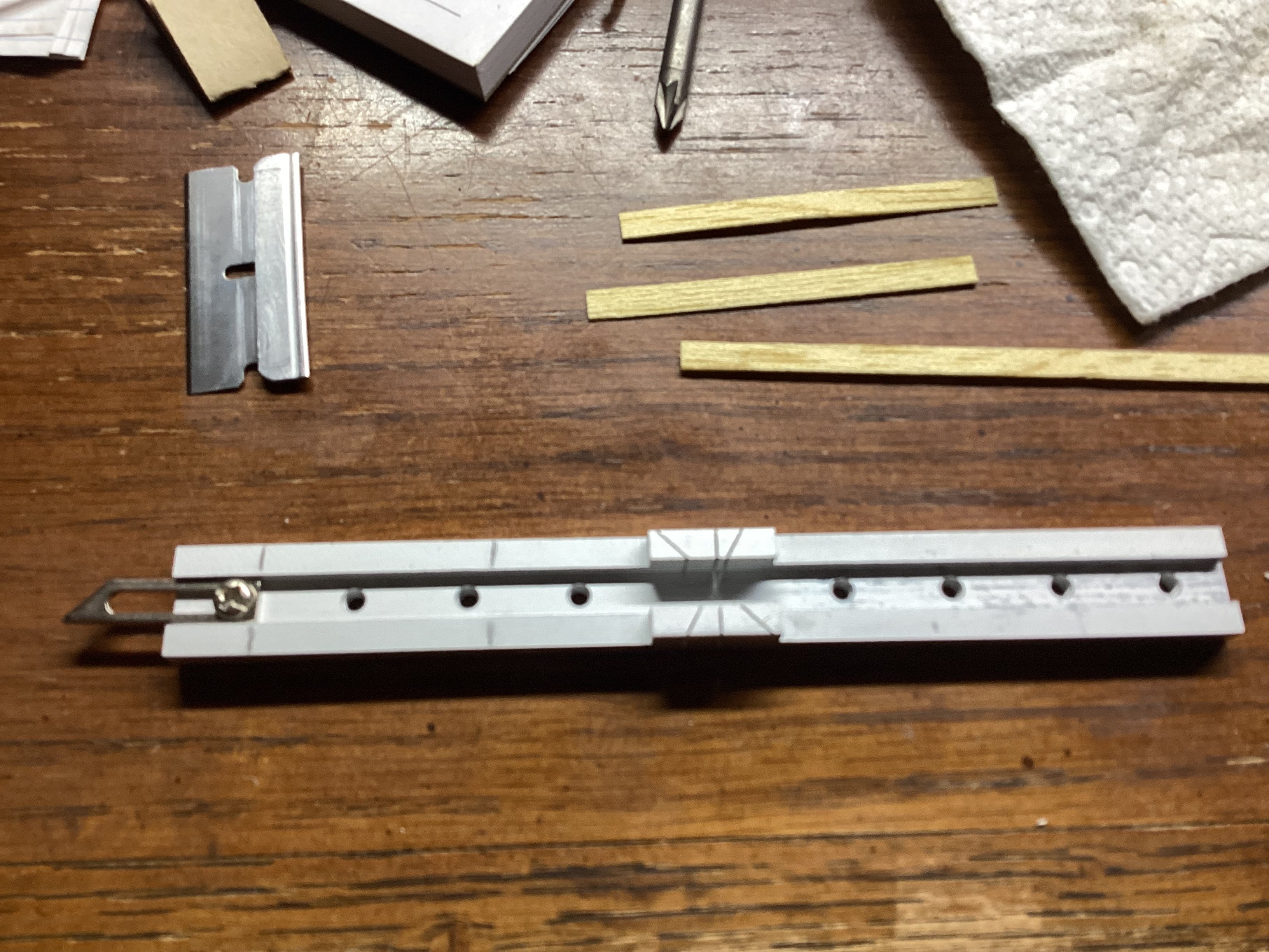

  10. This micro miter box was a life saver. It cut my time by at least a day. I discovered something while planking. Sharpies are great, but either they need to dry for a good while OR wood glue dissolves the ink. When I started laying the planking, I made an inky mess. I tried to sand it off and you can see the results. I kind of like it though. It looks weathered.

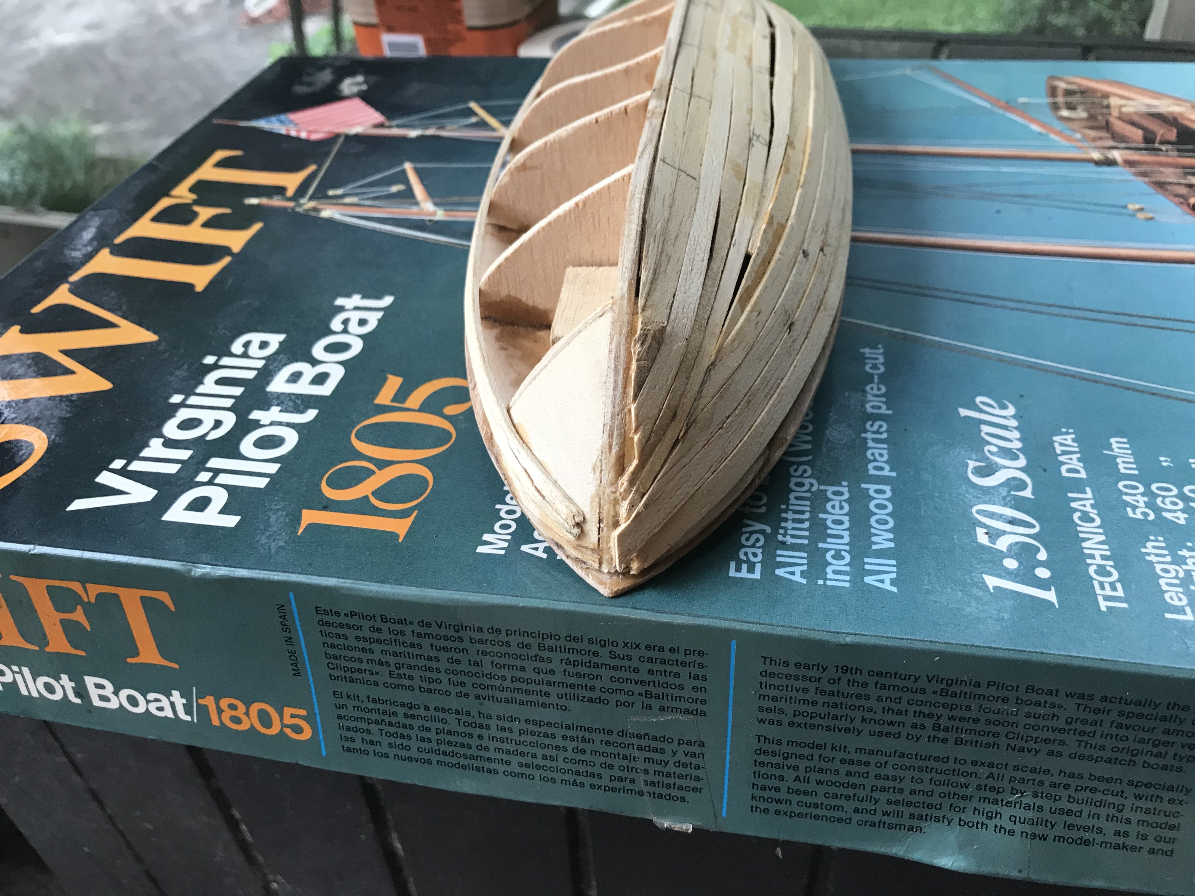

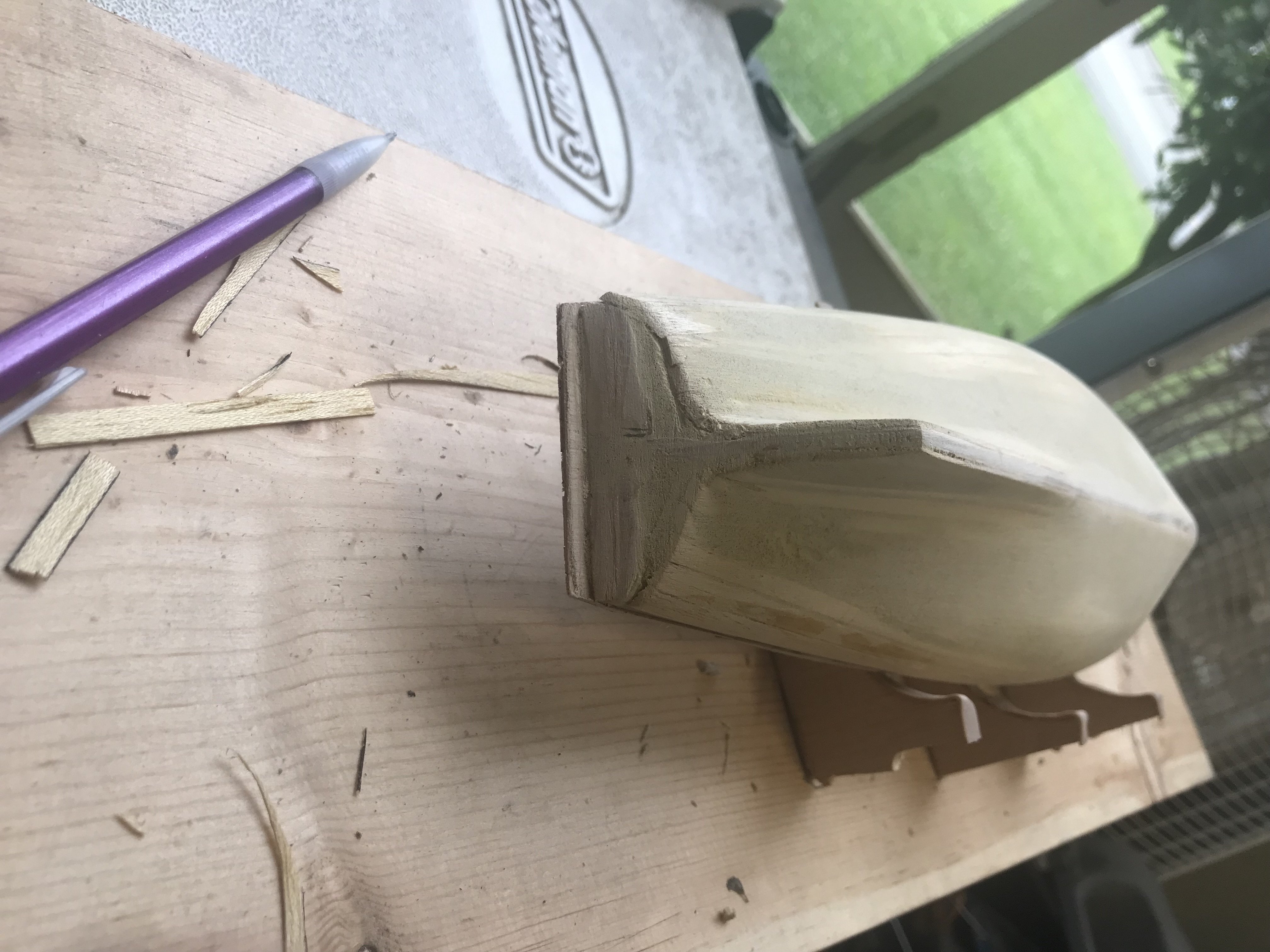

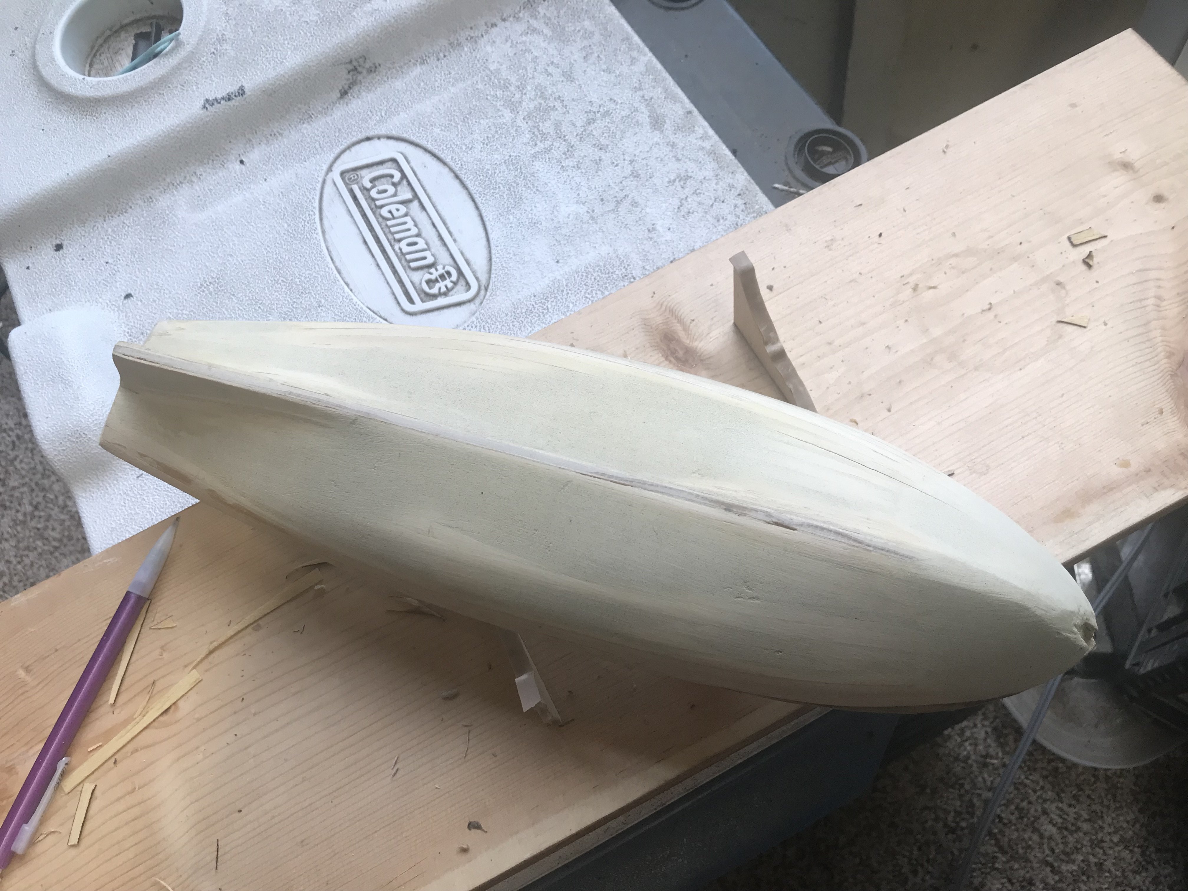

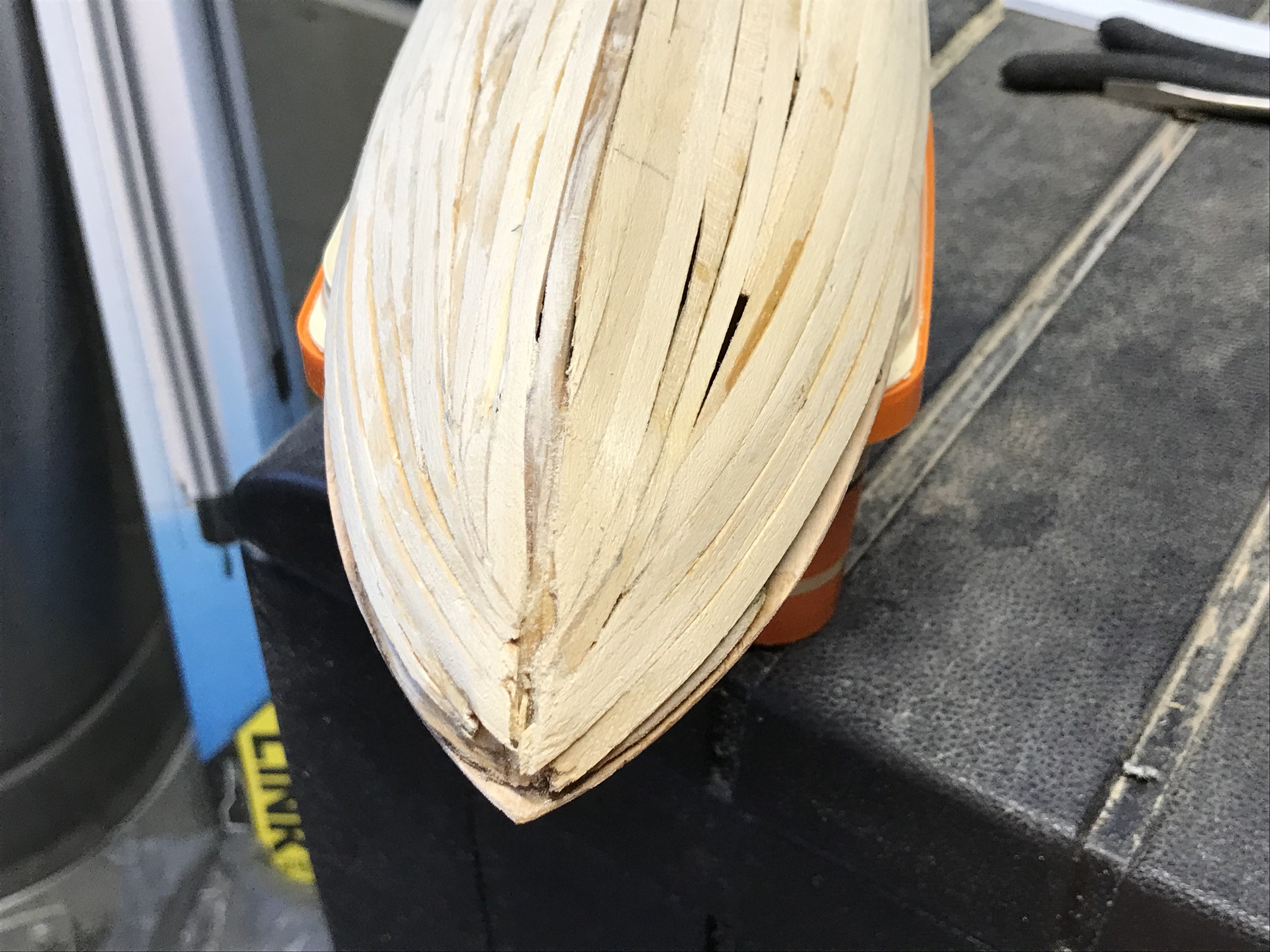

  11. It is an understatement to say that I have never done this before. I found the model at a flea market for $20. it sat in my basement workshop for 6 months before I even opened the box. Having never worked on a wooden model, I’m sure I’ve made every mistake possible. It wasn’t until I hit my first snag that I started looking online for help. I still think the instructions were written for a master builder. Too many important facts left out. I didn’t know to bevel the hull planks, so I improvised with Gorilla wood filler.
