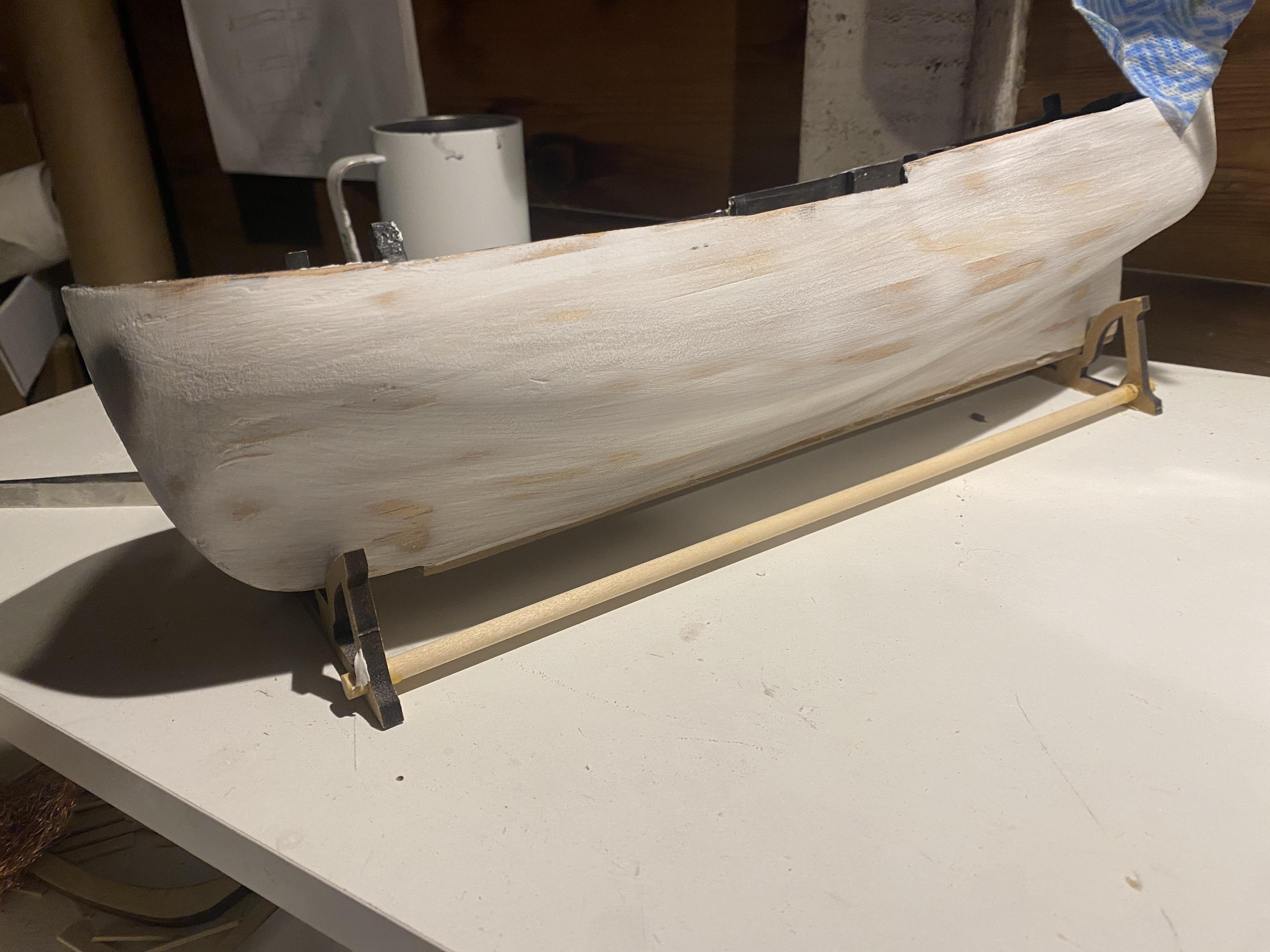

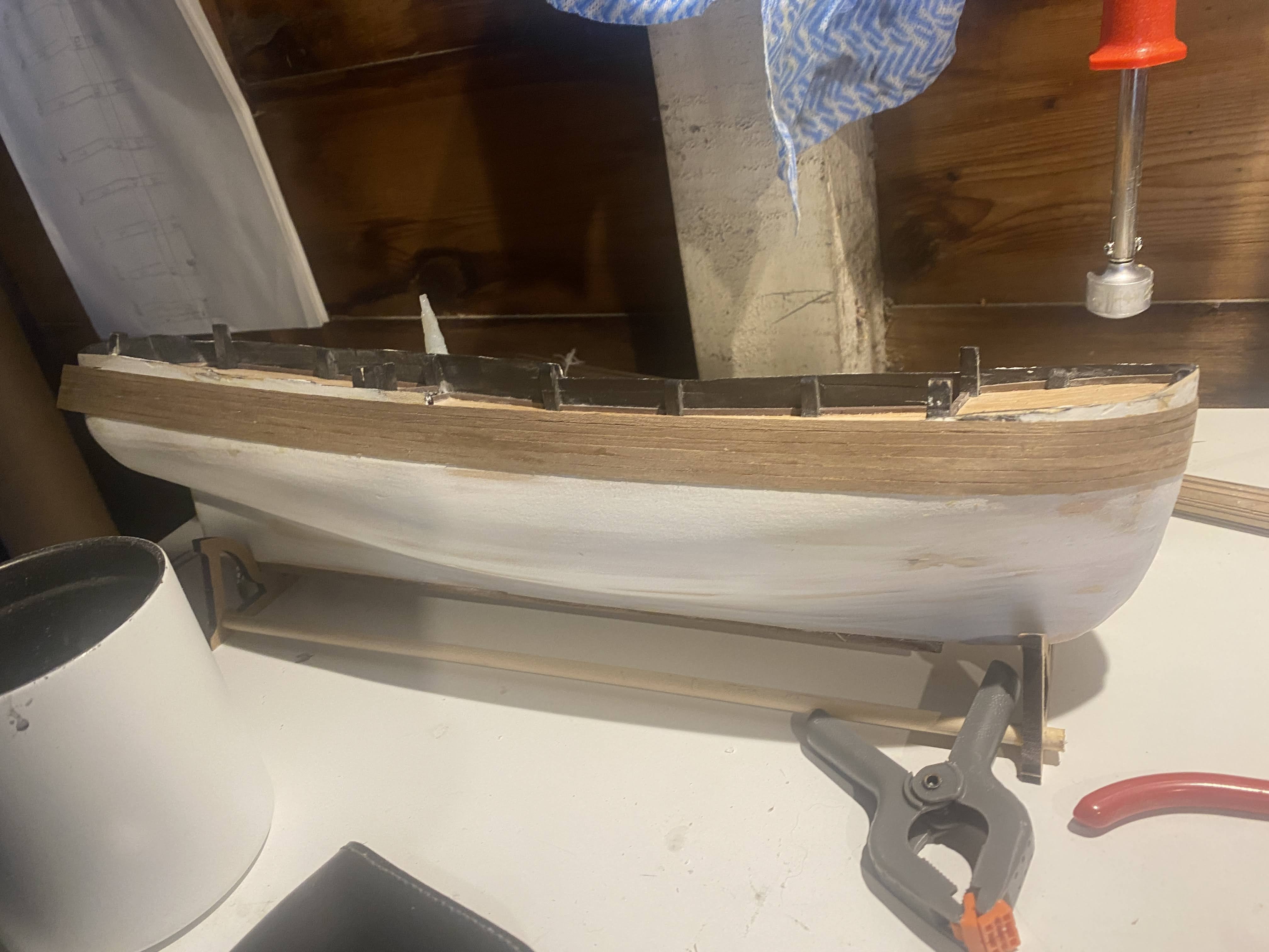

  1. Following Frank Mastini's advice, I coated the hull using modeling paste and sanded it down. I ended up using a little bit too much paste so the layer was thick and required a lot of sanding. But it created a very nice and smooth layer for my second planking. I used a copper wire sponge to score the surface so that the glue would adhere nicely to it and started my second planking. I'm really happy with the progress here. I also bought some Titebond Quick Set glue which is more viscous and dries quicker and I love it. Following Mastini again, I'm supergluing a plank at the stern to hold it in place, then brushing on wood glue a few inches at a time and using the plank bender to heat it up so the glue dries faster. I've gotten about 1/2 of on side done so far and very pleased with the results. I'll follow up when the second planking is done.

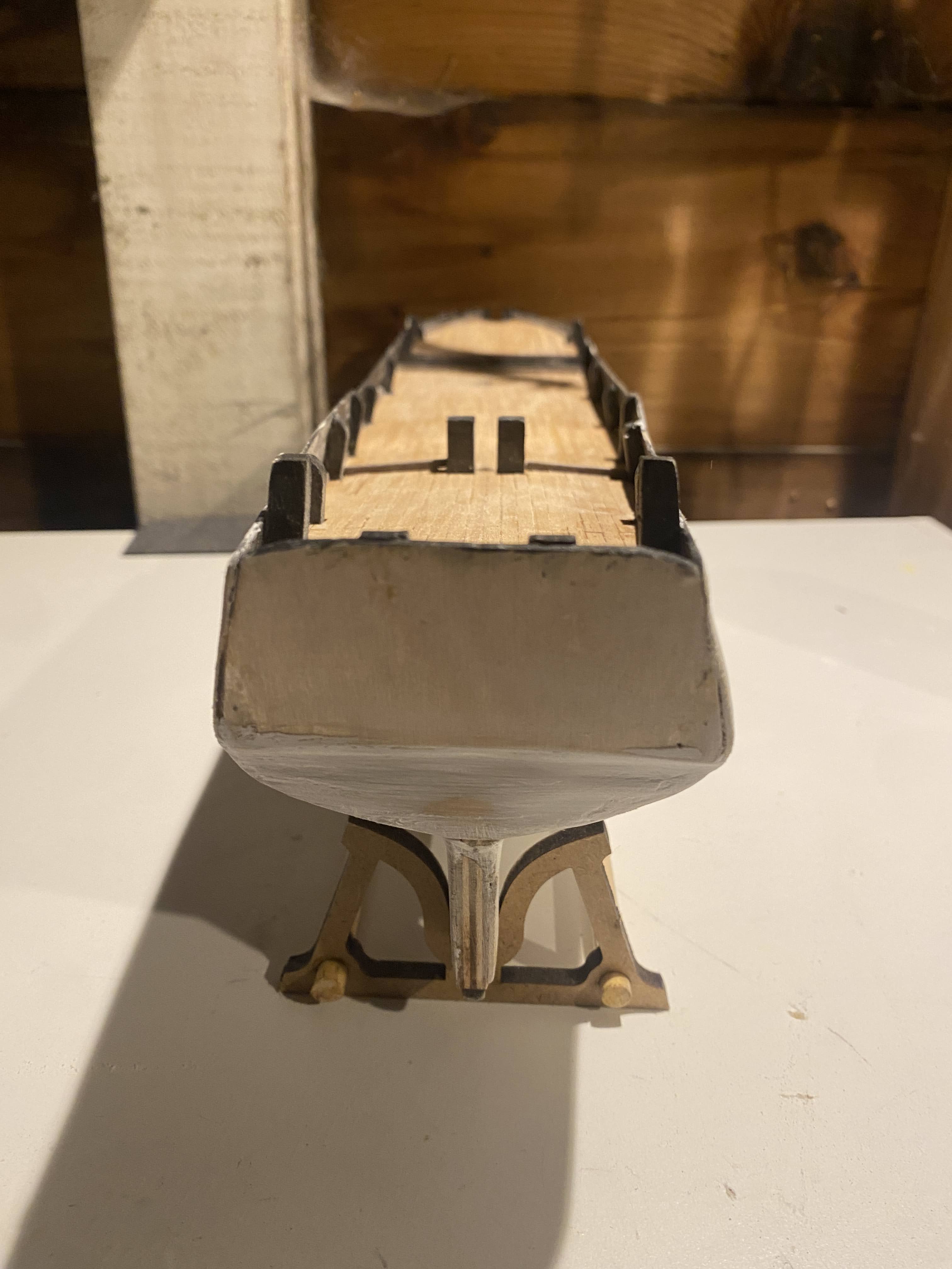

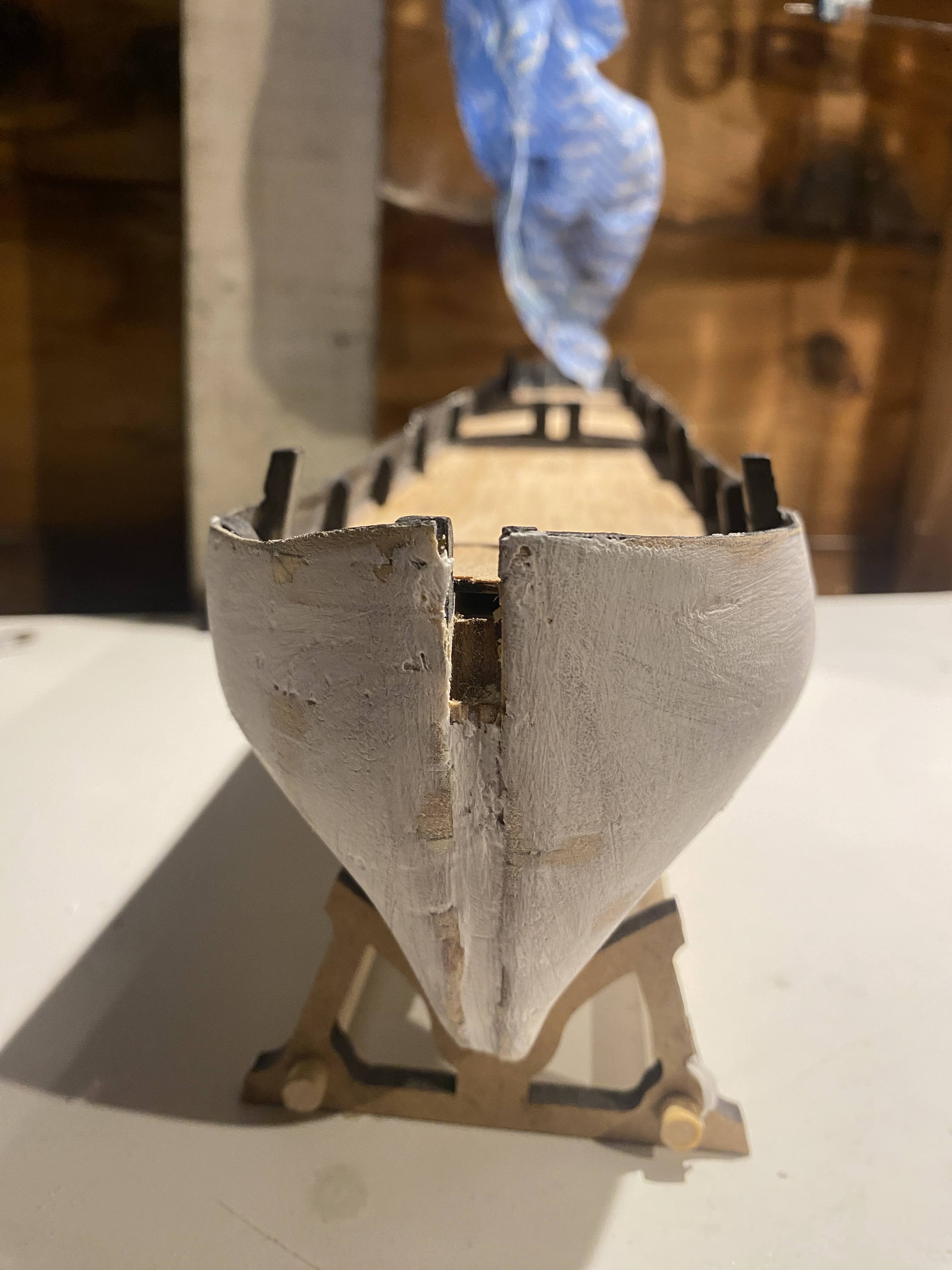

  2. I finally go through the rest of the planking. For the second half I used my planking fan to sand down the planks at the bow section. I'm much happier with this section but realized after-the-fact that I hadn't properly sanded down my bow filler so the planks 12-15 were warping at the end bow portions. Some difficulties I ran into that I could use advice on: How do I get the curved planks to be flush with each other? As I'm going down the bulkhead? My solution was to be generous with super glue and hold them in place. It seemed to be a workable solution but I ended up using a lot of glue. You can see it in the photos with how shiny it all looks. I'm not sure how that will impact the sanding that comes next. Using the planking fan correctly. I created strips of paper for each bulkhead and marked on that paper where each plank would be, and used those markings to transfer on to each bulkhead. But what I found was that mid-way through the markings it was beginning to look a bit off my 1mm or so and I think it was because of the thickness of the lines from my pencil. Any advice on how to get super precise here? Mechanical pencil? Use my exacto knife instead? Advice on sanding. I'll be starting the sanding tonight and worried about sanding through these planks as they're quite thin.

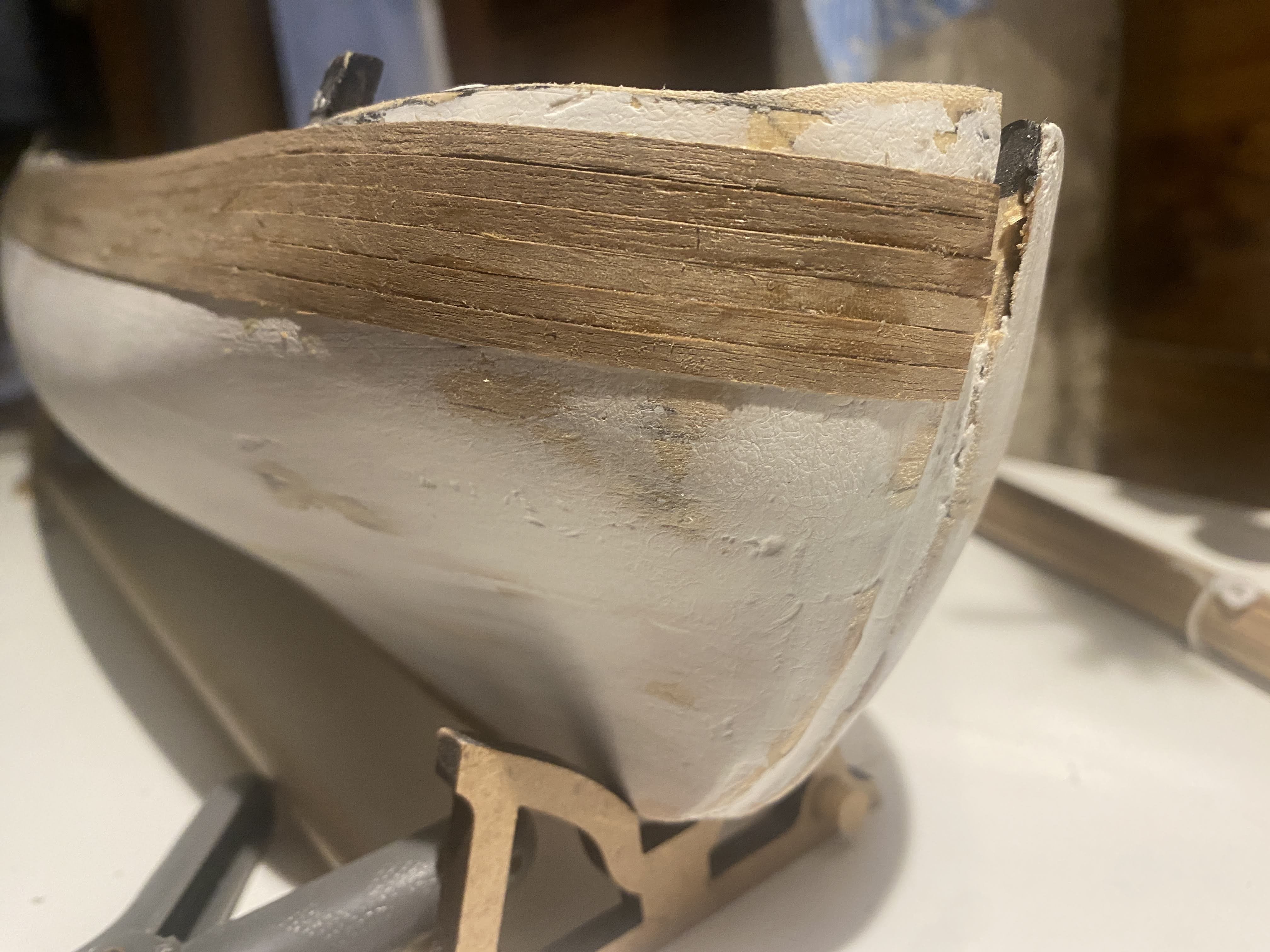

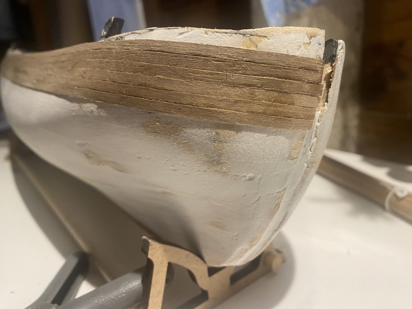

  3. Thank you Loracs for the suggestions! I actually had a plank bending iron on hand for this but found that I wasn't soaking the wood nearly long enough. For some reason I thought 5-10 minutes would be good enough but after letting them sit for 1-2 hours I found it made all the difference. I was finally able to finish the first half of gluing the first planking. It's still quite rough but I feel like I've learned a lot from my first pass. There are still some gaps and bumps but I'm going to accept that and try to improve the second half. The main thing was adding bow fillers. It was a lot of work sanding them down into shape but it made a huge difference. I'm wondering if it's worth adding fillers for every bulkhead... There's also a glaring mistake on the plank at the bottom that is very clearly overlapping. I don't have a good excuse for that...
