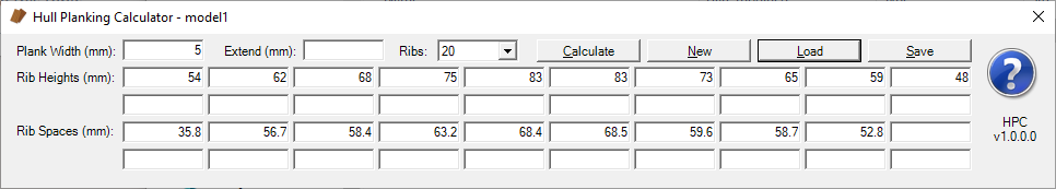

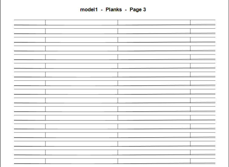

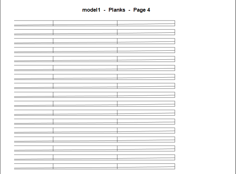

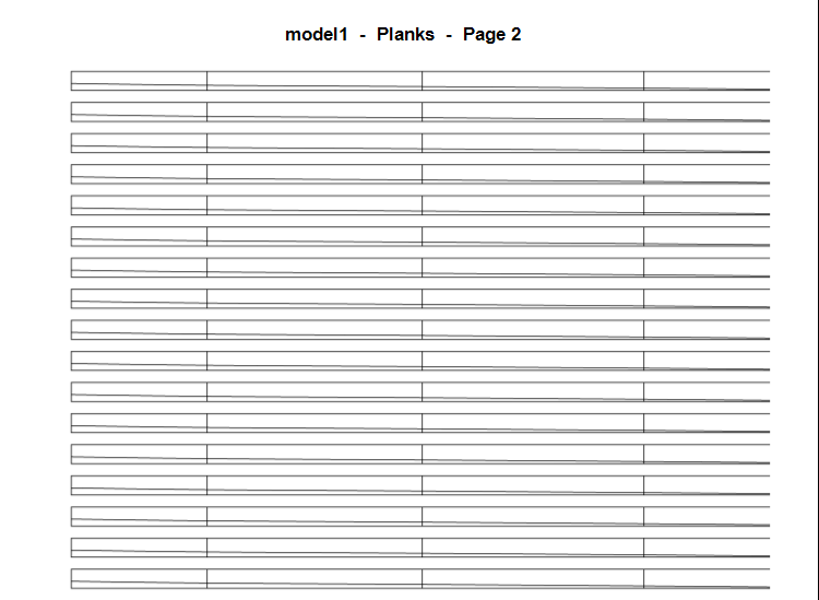

Version 1.4.0.0 is live and can be downloaded from the link in the first post. 1/21/2026 Updated DXF export for compatibility with a greater number of applications. Fixed field tab order. Updated documentation. Comments: Feedback is always welcome.- 23 replies

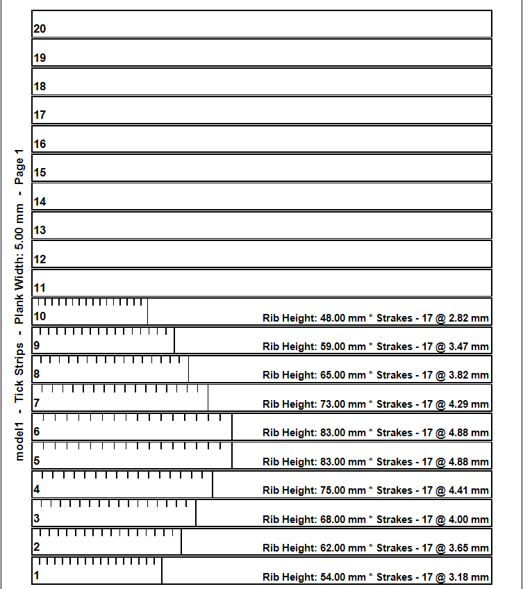

Version 1.3.0.0 is live and can be downloaded from the link in the first post. 1/18/2026 Added support for exporting CSV files - exports both metric and standard - calculated tick strip widths for each frame Added support for exporting DXF files - exports a DXF file of the plank for use in CAD/CAM software and CNC/Laser milling operations Updated documentation. Comments: You'll find the export buttons on the print preview screen at the top: Feedback is always welcome.- 23 replies
