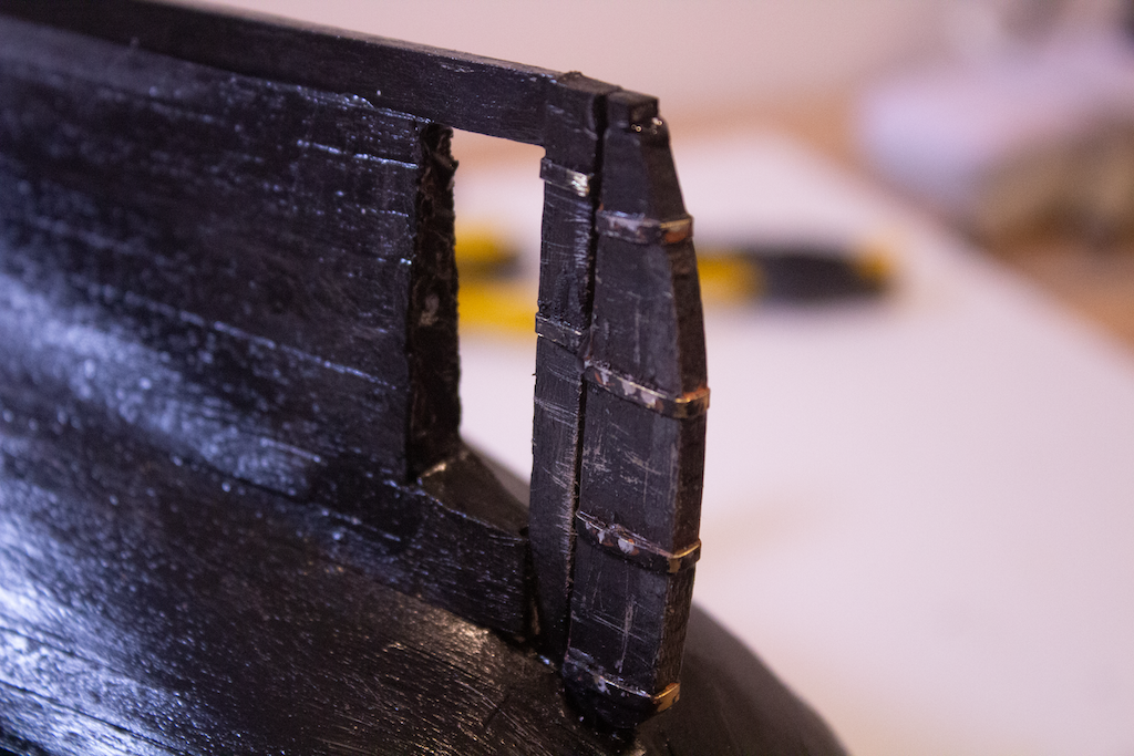

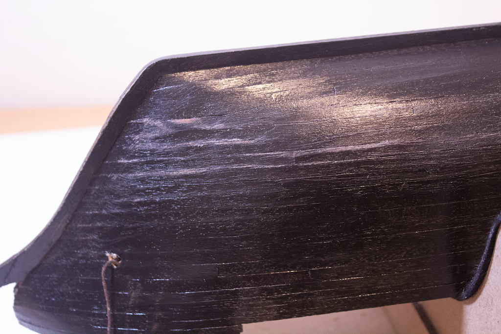

  1. I tried to replicate a bit the wear and tear of the hull and rudder as the ship was navigating through thick ice. I put on hold the propeller because the Endurance had a two blades propeller and the kit provides a 3 blades propeller. I ordered one from Bluejacket.
  2. @GeneralNuisance you are right, the picture shows a difference. After months at sea and being trapped in the Antarctic pack ice, the black hull underwent significant physical deterioration. Multiple effects could be represented: Mechanical Abrasion - As the ship rammed through ice floes, the ice acted like coarse sandpaper. Constant friction from "pancake ice" and slush created a horizontal band along the waterline where the paint was thinned or removed, showing the yellowish-brown timber beneath. Salt Crystallization and "Defibration" - In the dry, freezing Antarctic air, salt from the seawater would penetrate the paint and crystallize inside the wood fibers. Frost Wedging - Moisture trapped in the seams between the planks would freeze and expand. This caused the paint to crack specifically along the horizontal lines where the planks met. Solar Fading - Even in the Antarctic, the UV rays are extremely strong due to the reflection off the snow. I am thinking of going with this:

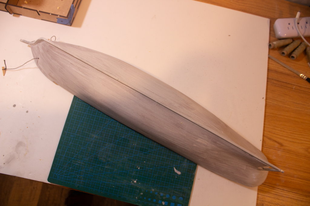

  3. Second layer of planking, a bit of sanding and first layer of grey primer. I am now debating on the color of the hull, should I go all black or red "anti-fouling" paint under the waterline, as suggested in various build logs? While many modern ships used red "anti-fouling" paint containing copper oxide to prevent barnacle growth, however it appears the Endurance followed a different path due to her specific mission in the frozen South. When the wreck was discovered in 2022, the 4K underwater footage confirmed the entire hull, from the top of the bulwarks down to the keel, was painted solid black. The cameras panned down the side of the ship, past the waterline and down to the seabed, showing that the black paint covered the entire surface of the hull. There was no transition to red or any other color. Why not red paint? There were three main reasons Shackleton and the Norwegian builders opted for an all-black hull: Ice vs. Barnacles: Anti-fouling red paint is designed to stop organic growth in warm or temperate waters. In the Antarctic, the water is too cold for most barnacles and weeds to grow on a moving ship, making the chemical properties of red paint unnecessary. The Greenheart Layer: The outermost layer of the ship was greenheart wood. This wood is naturally resistant to water, fungi, and boring insects. Because the wood itself was so durable, the paint was more for aesthetics and visibility than for chemical protection. Thermal Absorption: A black hull absorbs more heat from the sun. In the sub-zero temperatures of the Antarctic, a black hull can become slightly warmer than a white or red one, which can theoretically help "loosen" the grip of thin surface ice against the planks. I think this answers my question. Hopefully it is correct 🙂
  4. Thank you @Snug Harbor Johnny. The period I am looking at is right before getting stuck. I want to challenge myself with a diorama showing ice around the ship. I wanted to get the hull above the water line right, the one below shouldn't be visible. Since I am quite new to this fascinating world of ship modeling, I take new opportunities to learn new techniques 🙂
