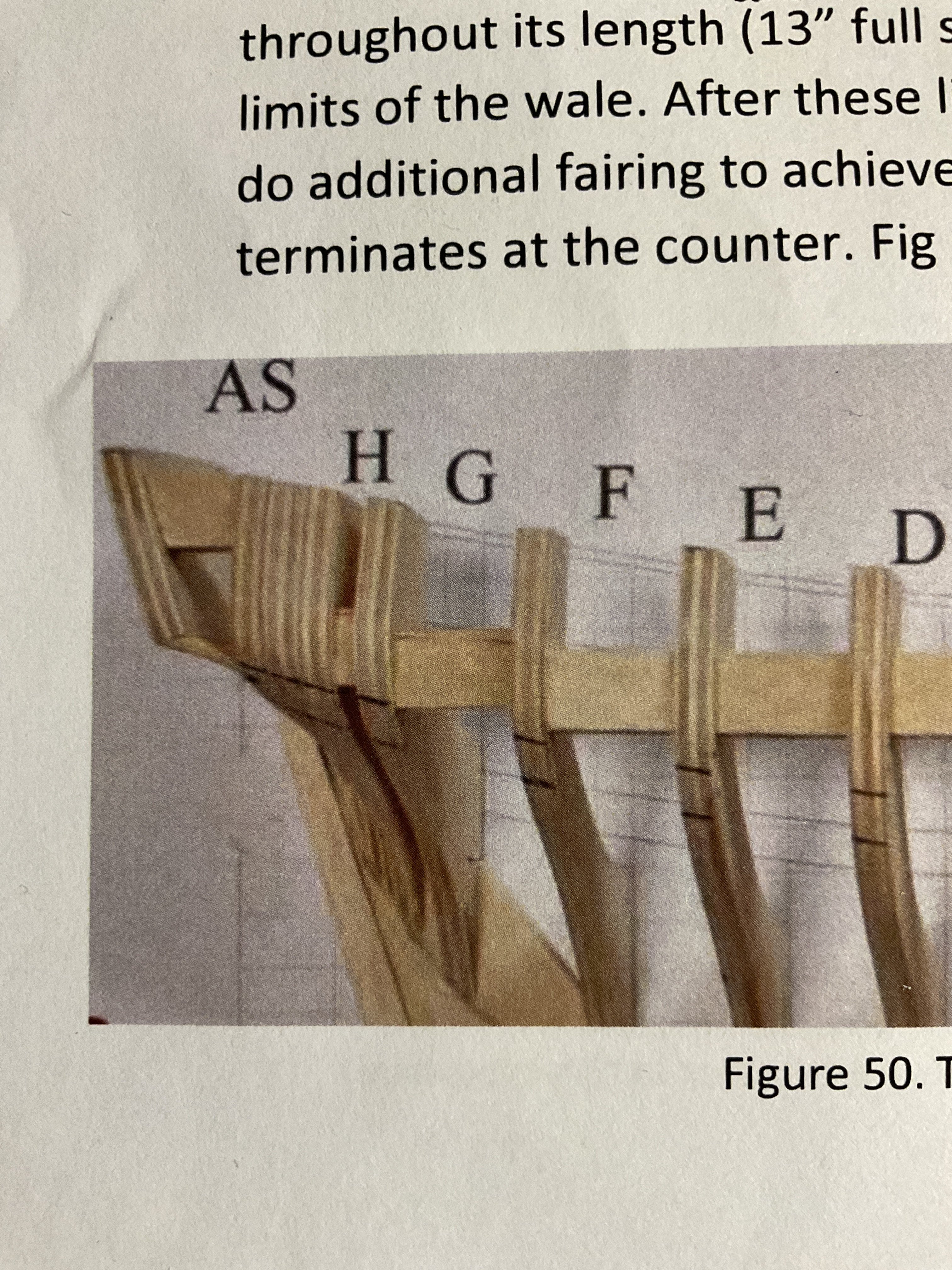

Next I marked the wale which did take a little bit of creativity to get it accurate, but I managed! I need to fix it from G back to H, I might not be understanding how the planking will look that high up yet, on Figure 50. it looks like it is facing the keel more whereas on mine it looks a little different. I don’t know if that is because I need to do further fairing or remark the wale? Here’s photos of mine compared to figure 50 for comparison:
