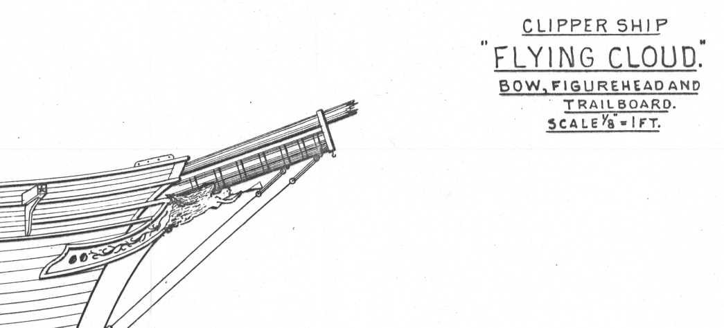

for what its worth - this is what W.A .White came up with in 1933 - no reason to think that he had any more information that we have
but note that he includes a trail-board which McLean said the FC did not have so this might have been pure guesswork

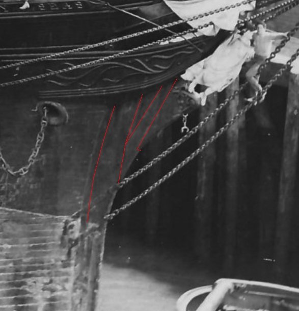

10 minutes ago, rwiederrich said:
Not one image I provided of clippers bows have these *external* wooden hoods.
I don't think that anyone has suggested that the 18th Century type of navel hood had a place on a clipper (as in "clipper ship", not so sure of the Baltimore clippers). At least one contemporary commentator used the term for a quite different structure on the bows of Flying Cloud and you have extended that into a term for a modified version of that same structure on Glory. But neither conforms to the older dictionary definition.
1 hour ago, rwiederrich said:
I'm still chewing on this...   If McLean says, ""where the line of the planksheer and the carved work on the navel hoods terminate, she has the full figure of an angel on the wing".
Terminate...?  that means the two intersect and become one. Or they simply end.  If the plank sheer on McKay's drawing (both McKay's), is at least 3~4 ft above the so called *Navel Hood*, which Scott claims is slightly above or around the Howes Holes.  for them to bisect...they must protrude beyond the hull.  If not...then by both of those drawings the figurehead must be right up against the stem at the line of the strakes.  For that is where the planksheer and hood terminates on their drawings.  However, if one were to follow the McLean description and use the Glory profile....the description makes far more sense.
I hope we can agree that understanding some long-ago document requires that we both follow its words and understand its context. From what I can see, McLean was extolling the virtues of a particular ship, for an audience who understood ships, but not providing instructions to shipwrights who might build a similar vessel. Hence, he did not have to be fully precise.
He wrote that the angel was "where the line of the planksheer" terminates, not at the end of the planksheer itself. I take that to mean that extending the curve of the planksheer would lead to the location of the angel -- which makes complete sense and fits with such other evidence a you have presented.
It is less certain what McLean meant by "navel hood" but the paintings of Flying Cloud (unlike the photographs of Glory of the Seas) suggest that the carved (and gilded) work on those "hoods" dropped down as it flowed aft from the feet of the angel. My guess (though there's plenty of room for disagreement) is that the lower, after end of McLean's "navel hood" surrounded the hawse hole (as the old, original type of navel hood had on other ships), while the upper forward end stretched out meet the forward reach of the stem structure, where the latter bore the angel.

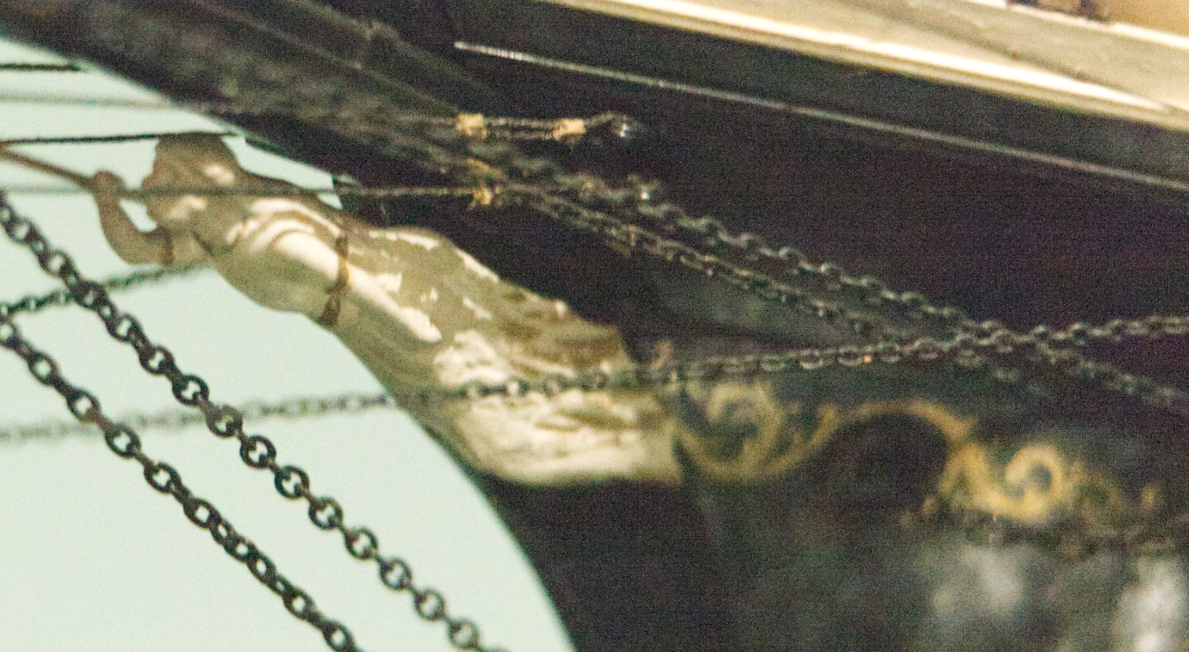

1 hour ago, sob said:

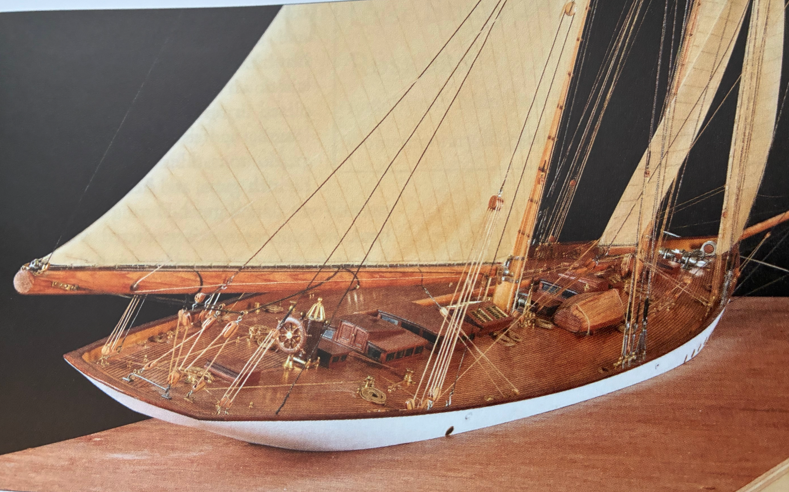

this is also for what its worth - this is a picture I took of the 1916 model of the FC by Boucher in the Boston Museum of Fine Arts
it is hard to see but it basically conforms to what McLean said (also not, relating to a different discussion, note that the base of the figurehead is quite large and would provide good support without needing a hood over it to help hold it in place)
it is hard to see the planksheer but if you follow the line of the main rail it likely hits the figurehead just about where the gold carving that surrounds the Hawes hole hits the figurehead - this model does not show any obvious navel hood which would be behind the carving
Just now, ClipperFan said:
@sob Scott and @rwiederrich the large 1900s Boucher Flying Cloud models are my most favorite replicas. The realistic, lifelike depiction of her billowing sails is the most impressive I've ever seen. The second one is in the library of the Addison Gallery, Phillips Academy, Andover, MA. There are slight differences in the sail arrangements. Still, typical of all models, she has a few mistakes. Starting at the bow, there's no navel hood, practically no cutwater, her trumpet bearing angel figurehead, besides lacking wings is out of scale too large. The hawse hole is too high. She has no accommodations for crew in her forward forecastle which has a windlass stuffed in an area that's unworkable. Further back she has a rear portico which doesn't match that of Stag Hound described as a small square portico. Basically a simple entrance way to stern apartments below. Finally, she has dual poop deck capstans which were not mentioned by McLean.

ps the Boucher models were made for show & impact (and that they have) - Boucher had a factory in NYC that made models and accurate detail was not one of their hallmarks - but they sure do look nice  (their are some more of his models - full sales and all - in the NY Yacht Club
@sob Scott, if you have any pictures of those other models, I'd love to see them. Meanwhile, I tried to lighten up the Champion of the Seas daguerrotype to make some details easier to see. This is the only other bow photo there is of a McKay clipper. Rob and I see a great similarity between this 1854 vessel and Glory of the Seas launched 15 years later. This tells us that, while he constantly revised his hull profiles in pursuit of improvement, Donald McKay was remarkably consistent in his bow treatments.

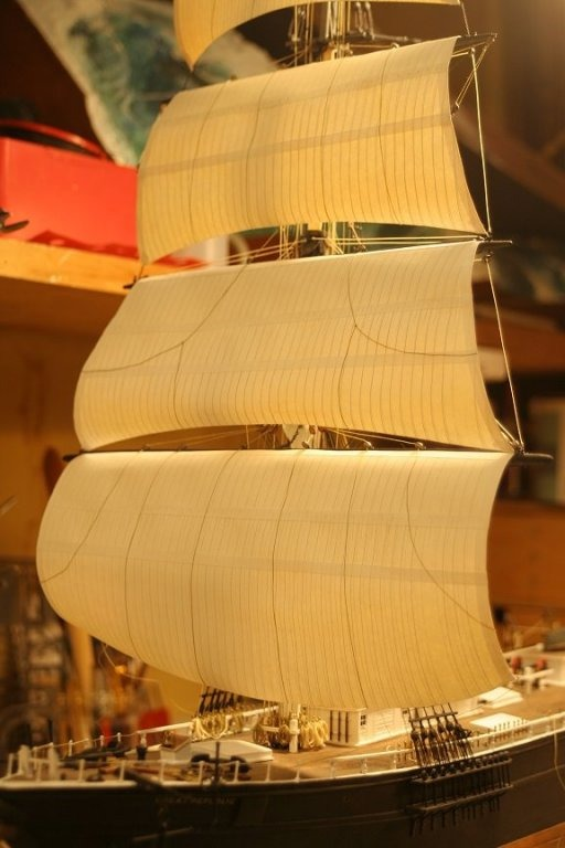

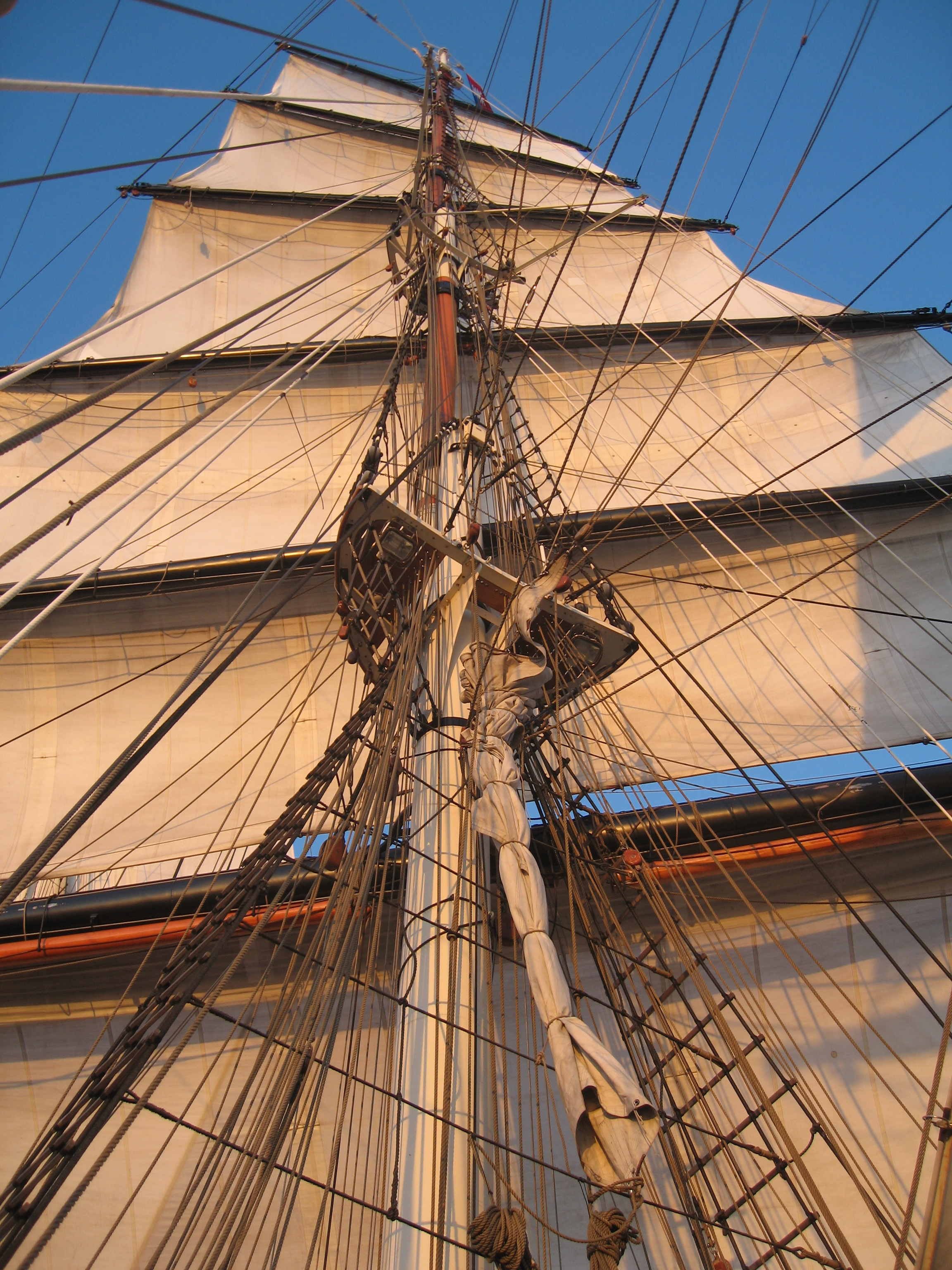

For realistic sails, there's nothing to equal the real thing 😀
Sails2.thumb.jpeg.3cd4e8888188657ed9431225bee7b42e.jpegSails.thumb.jpeg.d05d2eaf254d6ec3d079f842a0dc2e17.jpeg
That's Stad Amsterdam, with a sailplan close to a 7/8 copy of Cutty Sark's, so not a Yankee clipper but not so very different either. The image on the left was taken with a wide-angle lens, which has messed with the perspective.
Trevor
Trevor
I tried to attain that with my Great Republic.

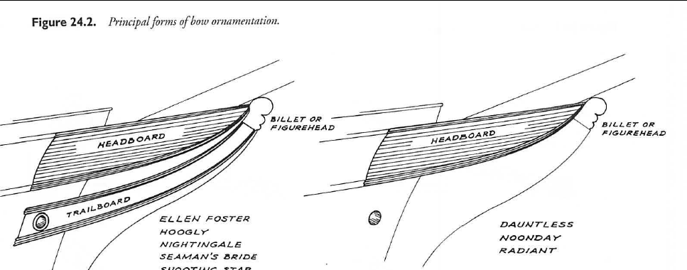

I got to wondering if people who spent the careers studying ships said anything about the structure you point to on the Glory
the first ting I found is fro Crothers' The American Built Clipper Ship 1850-1856 (1977) - this is the go-to book for most things clipper ship
this is figure 24.2
it looks a lot like the Glory structure
sad to say, the book does not include the Glory so I cannot be sure
in any case, Crothers does not think much of the structure he calls a "headboard" but he does list a number of ships that had headboards (p 361-368)
some of what he says:
Between 1850 and 1856, the bows of the clippers generally became plainer as each year went by. The cumbersome headboards, which were subject to destruction at sea, and the graceful trailboards, with their expensive carvings, were diminished for pragmatic reasons, as described in Chapter 24.as described in Chapter 24.
Headboards
The headboards, illustrated in Figure 24.2, were the only
exterior planking remaining to be fitted in the ship. They did
not constitute a part of the structural hull, even though, due
to their exposed position on the bows, they required sufficient
substance to enable them to withstand the heavy battering
of rough seas. Their structure, stoutly supported by
transverse timbers called cheeks, which were anchored into
the stemhead, was heavy and cumbersome, even though
their appearance to an observer was graceful and pleasing.
They served no purpose other than to ornament the bow and
render the forward endings of the planksheer and the main
rail more pleasing to the eye. In general, the upper rail projected
forward in a line which continued fair with the sheer
of the main rail while the lower rail continued as an extension
of the planksheer, sweeping forward and upward in a
graceful curve until the two rails converged immediately
abaft the figurehead. Between these rails, the transverse cheek
timbers supported suitable framing to which the headboarding
was fastened.
Detailed information on the subject of headrails and
headboards in merchant vessels is very scarce and difficult to
find. This, as is the case with much intimate detail concerning
commercial ships, is due to the fact that, in early days,
such ships were constructed as individual enterprises. There
were no precise rules in place, so each shipbuilder followed
his own initiative and inclination. With no central policy or
control, it was inevitable that there would be great variation
of detail among merchantmen. However, the general rules of
construction were followed by all shipbuilders and thus, at
any given period, all ships being built were constructed in a
like manner and they all took on the same general appearance,
adhering to the same general details.
About the year 1815 a new feature appeared at the ship's
head, namely headboards. A new straight rail, uniformly tapered
from its after end to the forward end, was installed between
the catheads and the figurehead. The space between
this new rail and the old upper rail was boarded in. This detail
is very apparent in the United States ship of the line
Columbus. The ship's head had finally received a very small
improvement.
By 1840 the old individual, graceful headrails were superseded
by more predominant boarding. The topmost rail was
an extension of the main rail and the lower rail was an extension
of the planksheer. By this time, foremasts were located
abaft the forecastle and the ship's head was moved under cover.
In 1850, headboards were regularly built into the bows of
large merchant vessels. However, it was a time when shipbuilders
and owners, pressed by demand and economics,
looked for ways to speed construction and reduce costs without
sacrificing a ship's seaworthiness. By decreasing the structural
work required to install headboards, they saved both
weight and labor, which, along with the elimination of excessive
and useless structure, fitted nobly into the design of
the dipper ship.
And so began the demise of headboards, particularly in
dippers. Of the vessels included in this book, only twentytwo
are definitely known to have been built with headboards.
Between 1851 and 1853 the number of ships built with headboards
declined uniformly until they disappeared entirely. After
1853 the only dipper ship built with headboards and included
in this list was Noonday, launched August 25, 1855.
(he says much more)
since he does not list any McKay ship as having headboards this may not be related to the structure on the glory but it does look basically the same
McLean mentions a few ships with headboards so he know the concept (Shooting Star, Antelope, & Silver Star)
maybe, if ay did come up with a strengthening structure he used the old headboard design as a cover
Scott

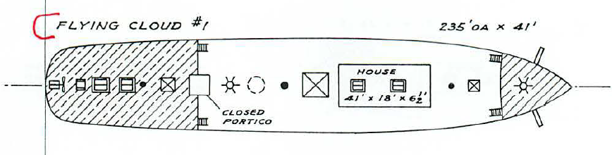

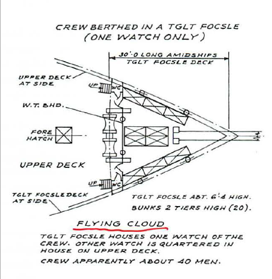

ps - this is what Crothers has for the forecastle plan for the Flying Cloud
note he has windlass behind the deck & in another drawing shows a capstan on the forecastle

The second result was that of achieving headroom under the
topgallant forecastle deck. This allowed for housing one watch
of the crew, handling of ground tackle, installation of the anchor
windlass, and location of the hawseholes totally above the
weather deck, a very practical accomplishment. Sufficient
headroom beneath the topgallant forecastle deck was required,
as it was an important working area.
with a sheer of 3 feet the FC would have quite a bit of extra headspace under the forecastle (as noted in the Crothers diagram where
he says the headspace was 6 4" - quite enough when the average height of a full grown mail was about 5 1/2 feet)
And you did a great job! Your fore topsail is a very nice, subtle approach towards the way that older sails set. Not many artists captured it but, in rather light weather, the weight of flax/hemp sailcloth made the sail hang down from the yard, then balloon forward near the foot, where the force of the wind overcame the lesser weight pulling down. You have captured that shape, though not so extreme, hence better suited to the cotton canvas of a clipper.
But I don't see how a forecourse can be well modelled. There's no way to reproduce the way that the wind lifts the sail, against its own weight, when the only solid connection is along the yard. No criticism there. I just don't see how, mechanically, it can be done.
Edited by Kenchington
Yep...I'm fully aware of these drawings.  I don't agree.  I see, you too disagree with them.  You didn't model the skylights on the main cabin, as he depicts.  See, this is the entire point Rich and I are so adamant about the Staghound and FC forecastle and stem/hood issues.   Our conclusions are in opposition to what is commonly (as you put it), accepted.

Sorry about that image! It was intended for a different post that I have abandoned.
True..the main course is more difficult.  Since the clews are not hard pressed to a yard...they tend to fold inward as the sail is filled and the main tack retract back and in.
Ummmm...This image and your red lined don't seam to apply?

well, common wisdom is sometimes (but far from always) wisdom
one other citation about headboards - this time from Campbell in his China Tea CLippers
McKay's clippers, although keeping to
the clean bow as on the later New Yorkers, tended to retain a longer stem
knee and featured a form of decorative headboard which was built flush
with the hull without exposed timber supports, and looked very
handsome.

Stad Amsterdam is a quite lovely scaled down clipper replica. I really appreciate seeing how the yards have been stepped to take better advantage of the winds higher up.
Rob said: if you have any pictures of those other models, I'd love to see them.
I've seen pictures & have seen one of the models (an America's cup type craft) but do not have any myself
and I do not see any on-line
I did find one in a book by Rob Napier - Caring for Ship Models (highly recommended) - can not see the top but still very impressive visually
