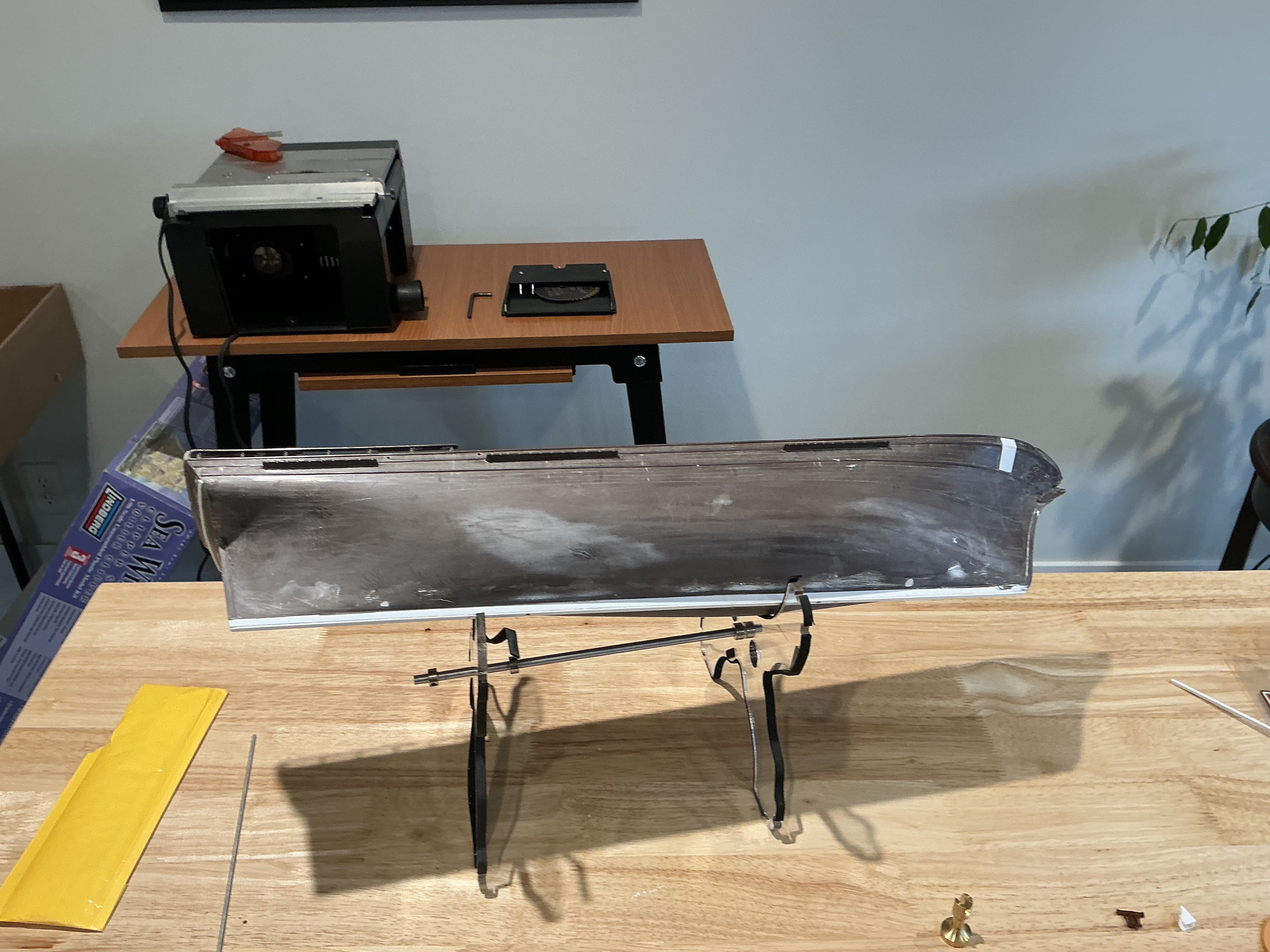

Attached are photos concerning my current status on the Sea Witch.

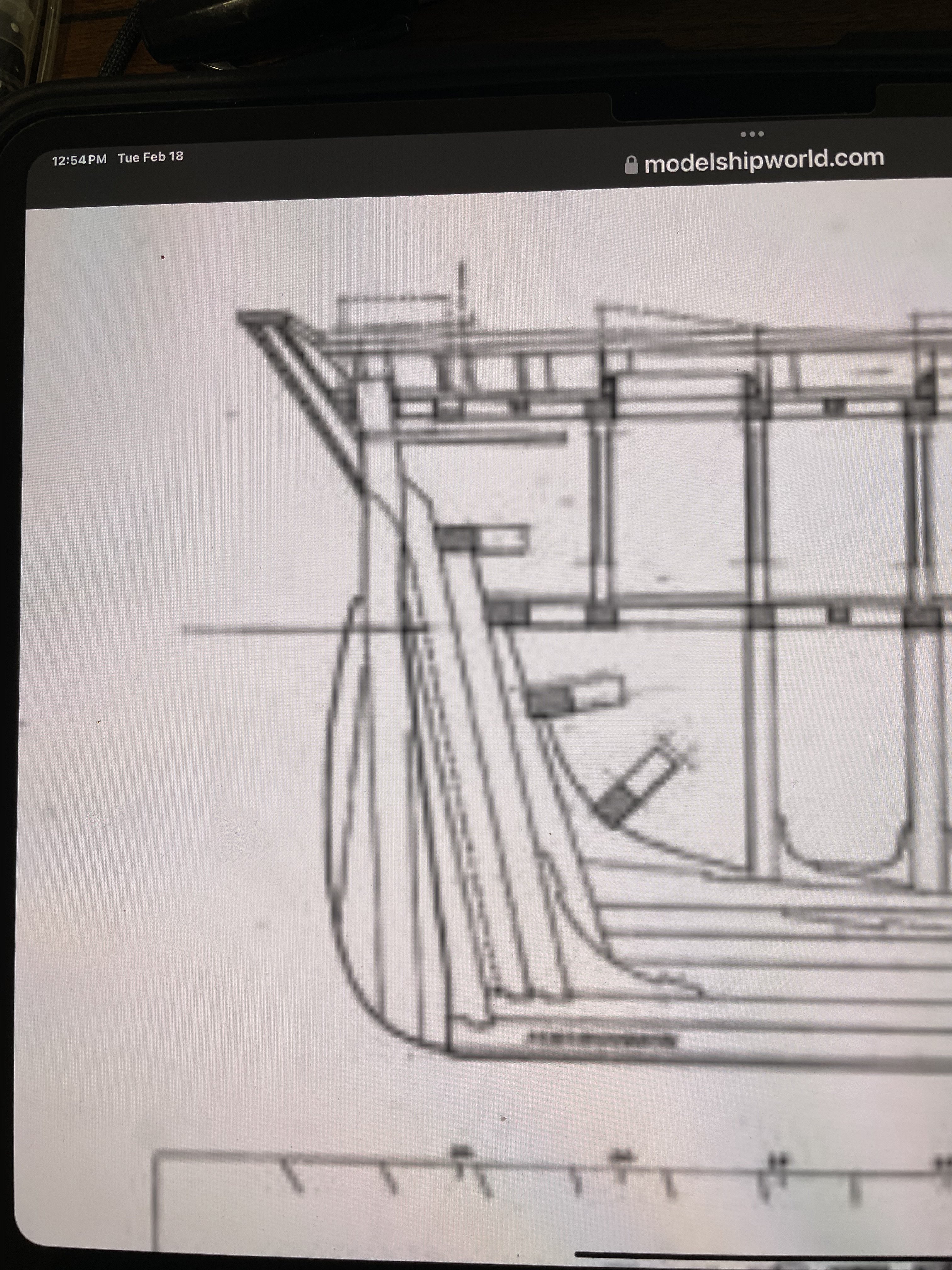

the hull was glued together and reinforced with epoxy and epoxy putty. The kit rudder was removed. Billboards for the anchors were added. Most of the holes in the hull were filled. This  process includes the aft bumpkins as they will be installed higher on the hull.  Eyebolts of metal were installed in the bow. The unrealistic fish tail  on the figurehead was removed from the hull,; it will be replaced with a dragons tail similar to the one depicted below. The figure head molded into the hull looks like a dazed dolphin with cherub wings and a  fish tail. The goal is to provide a Chinese black dragon, which is the symbol  of commerce.
It was necessary to remove the sharp steps along the keel and it proved need full to face the keel to get some extra width for the pedestal screws. I will be using a M3 all thread rod in lieu of screws. I am putting together some interior blocks to allow me to install a temporary handle and add a baseboard and pedestals later.

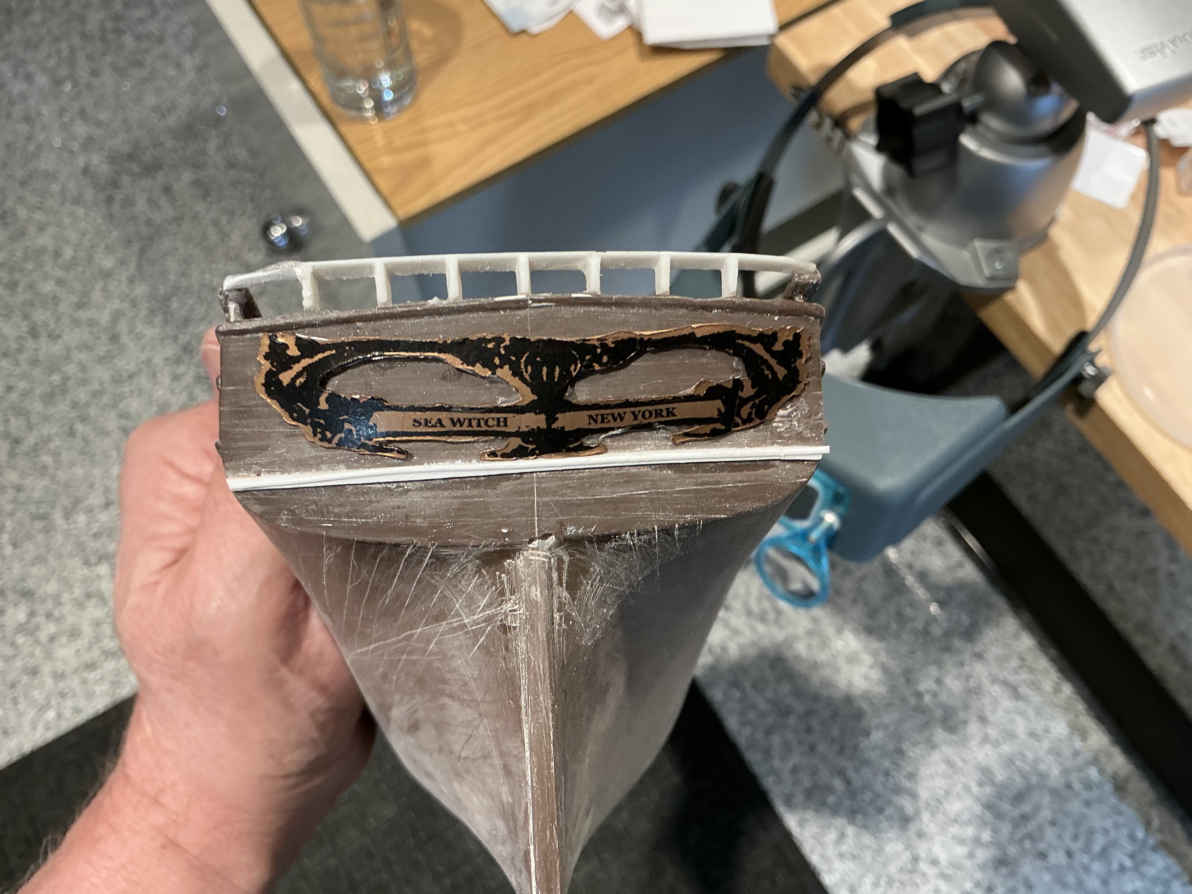

A new  rudder was fabricated  similar to what is shown in figure below. I am fitting the pintles and gudgeons mow, but I cannot install them until the rudder is coppered. The hull was scored to represent planks on the upper hull. The bottom will remain smooth. It will be painted a copper and copper tape will be applied over it. I made a a detailed transom decoration and test fit it in a photo below.
