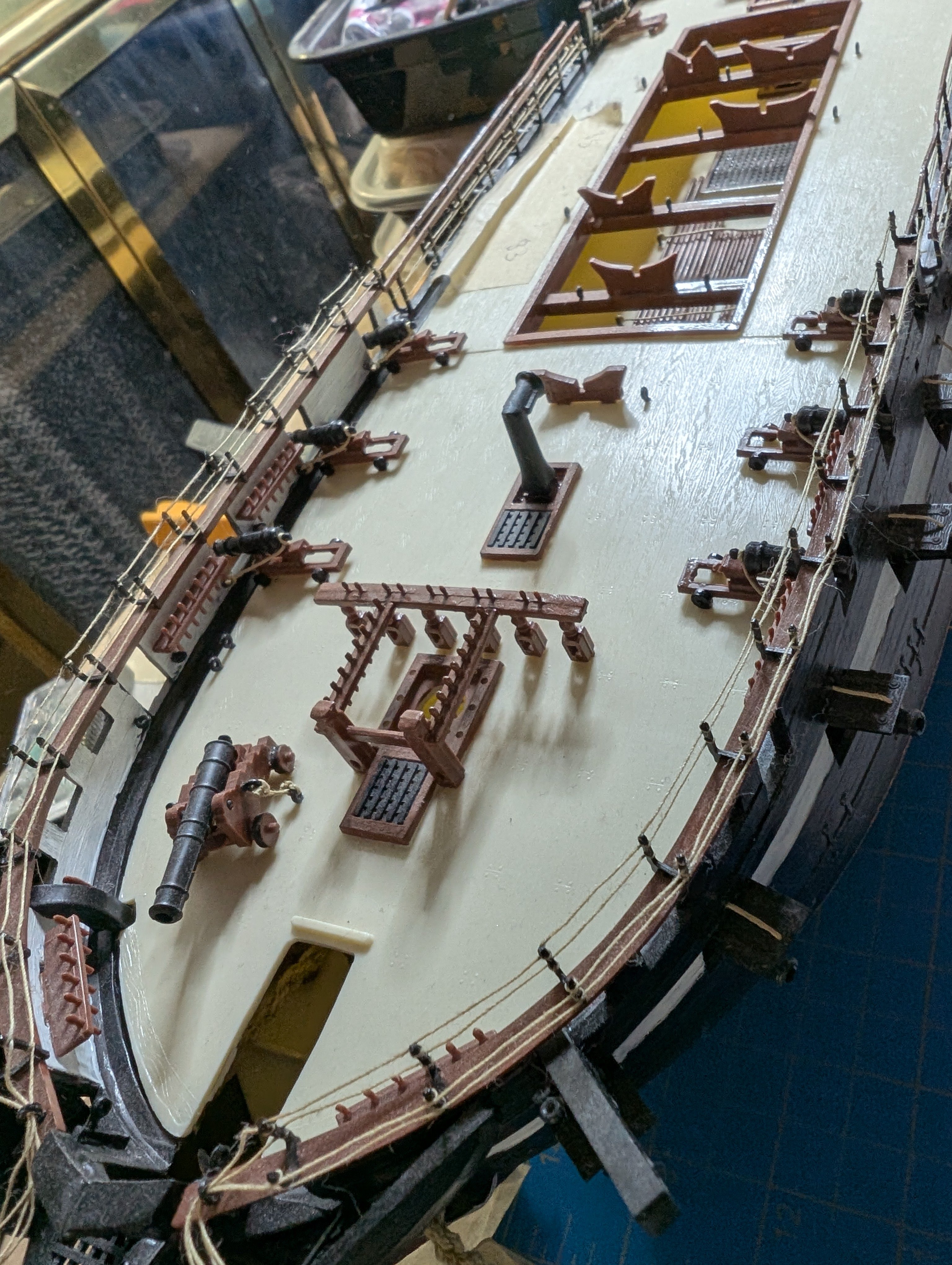

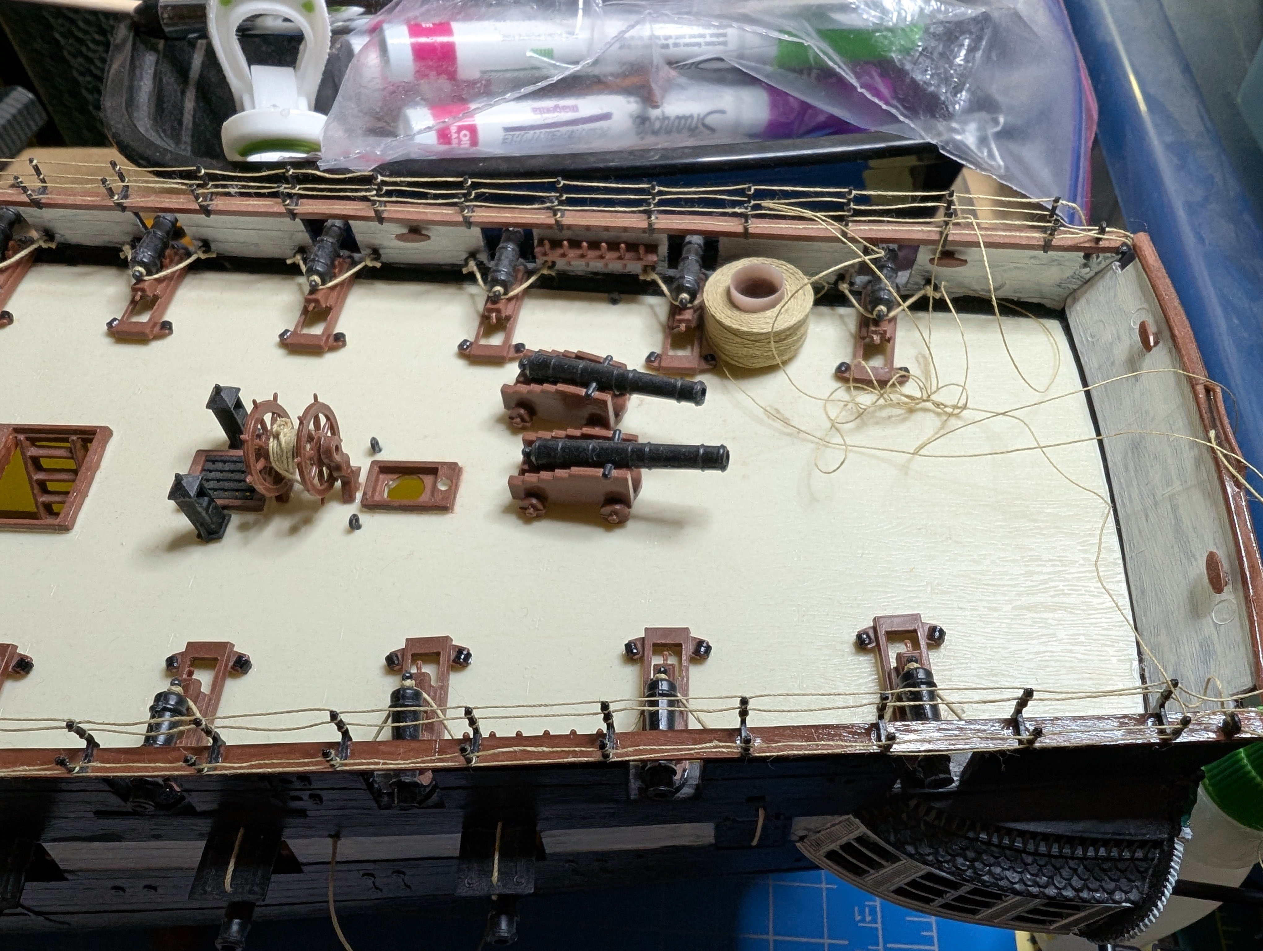

I acquired the kit at a yard sale when I was a teenager. I slopped some white paint in the general vicinity of the gun port strip, then put it back in the box. I carried the kit with me for various moves (including across the country) for approximately 30 years. In March 2020, I found out I was going to be stuck at home for 2-6 weeks or so, so I set up a folding table in our living room and got started in earnest.
The current state is: The hull is assembled and I am working on the masts. I should get to the rigging soon (for some definitions of soon).
I will post some pictures I took over the years soon (hopefully for a different definition of soon).
