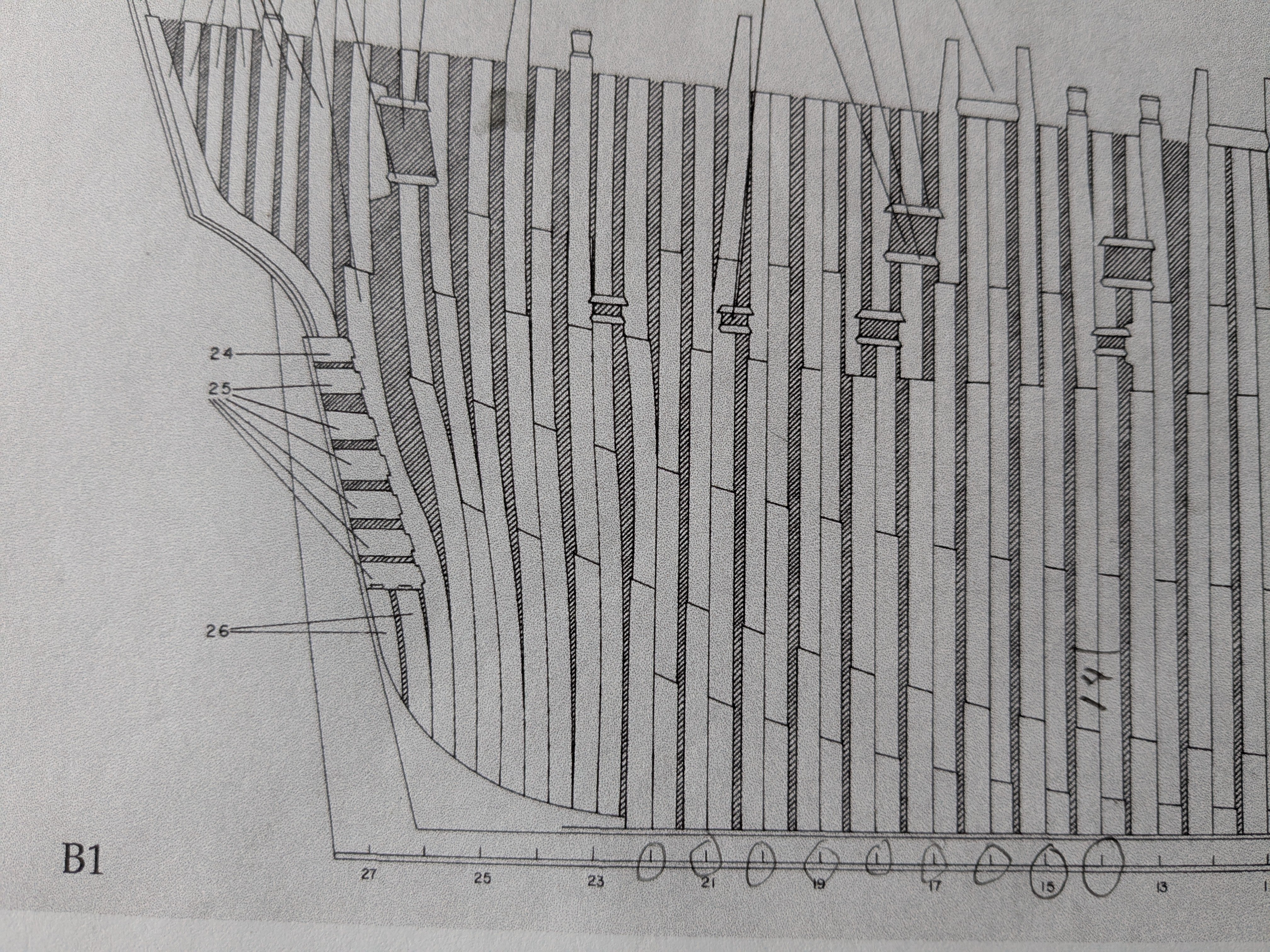

Here is the stern framing layout for HMB Endeavour (1764), according to KH Marquardt. Notice that many of the upper timbers are independently spaced from the adjacent futtocks that they would customarily be laminated with. This seems weak, with these timbers secured only by the planking, clamps or lodge knees. I can see that this arrangement allows for the needed spacing of windows and ports, etc. But it seems that many of the frames could only be laminated by their lower members, with the other timbers added after all were in place.
Also, the stern-most timbers seem to curve in two dimensions - perhaps they are cant frames, likely at that point.
Any observations would be appreciated!

This is normal.  The frames you are referring to as floating are simply single frames vs. the other frames which are doubled.  Keep in mind the futtocks are still bolted to the one below with chocks or scarphs just like all the others.  Surely this is not as strong as a doubled frame, but it gives 2 advantages.  Firstly lighter weight high in the ship where weight isn't desirable.  Secondly the gaps between frames were meant to help keep the wood dry.  Keep in mind these were still enormous pieces of wood in real life.  Those frames will be more delicate when you are building the model, but you will find the assembly to be plenty strong once combined with the various wales, planking, etc.  You can find lots of examples on build logs on the site including the various Swan class models.
I suspect the frames become cant frames starting at station 23, but I couldn't say with the information in the drawing.
Adam
I don't know what evidence there is for the frame of Endeavour specifically. Perhaps she had as many timbers in paired bends as that illustration indicates but in that era many another ship, built following English methods, had far fewer -- and not just high in the hull but from the first futtocks upwards. (The French, in contrast, had long-since adopted the 19th-Century approach for their warships, with the timbers in each bend fastened to one another. That gave more strength for the same amount of timber but at the cost of needing more weight in iron bolts.)
Yes. But that was how boats and ships had been built for centuries and how the smallest wooden ones still are (unless they are glued together with modern chemicals).
Into the mid-18th Century, the practice in English Royal dockyards was to get all of the floors bolted in place before any futtocks were added. At that point, there was no way to drive bolts between adjacent floors and futtocks, as they were far too close together. All connections between them were via the planking and footwaling. To anyone familiar with later ship structures, that looks weird. But it is how it was done.
Of course many timbers curved in three dimensions. But there should not have been any cants in the after parts of such a ship. Cants were needed where the bow curved around towards the stem -- a curve in the design waterlines (not that the waterlines were drawn out in that era). There was no similar curvature in the stern, though there were sharper bends in the sections and what would now be the buttock lines. Canting the timbers would not have helped with framing those.

The attachment of the head of one timber to the heel of the next above is a bit of a vexed question. There certainly is evidence that some 18th-Century vessels were built with scarphing chocks, which were presumably fastened to the timbers above and below. Then there is mention in contemporary sources of eking pieces, used where the main timbers didn't quite curve enough, leaving a gap that could be filled by something that looked a lot like a scarphing chock but was an infill in low-cost construction rather than an expensive strengthening of a high-cost ship. And there were plenty of vessels built with the heel of one timber not even reaching to the head of the one below, let alone fastened to it.
High-end warship construction produced relatively neat and regular structures but many a smaller vessel had framing that was decidedly irregular. The textbooks didn't show that, of course, but archaeological records of how real ships actually were do -- if the archaeologists took the time to study what was in front of them.

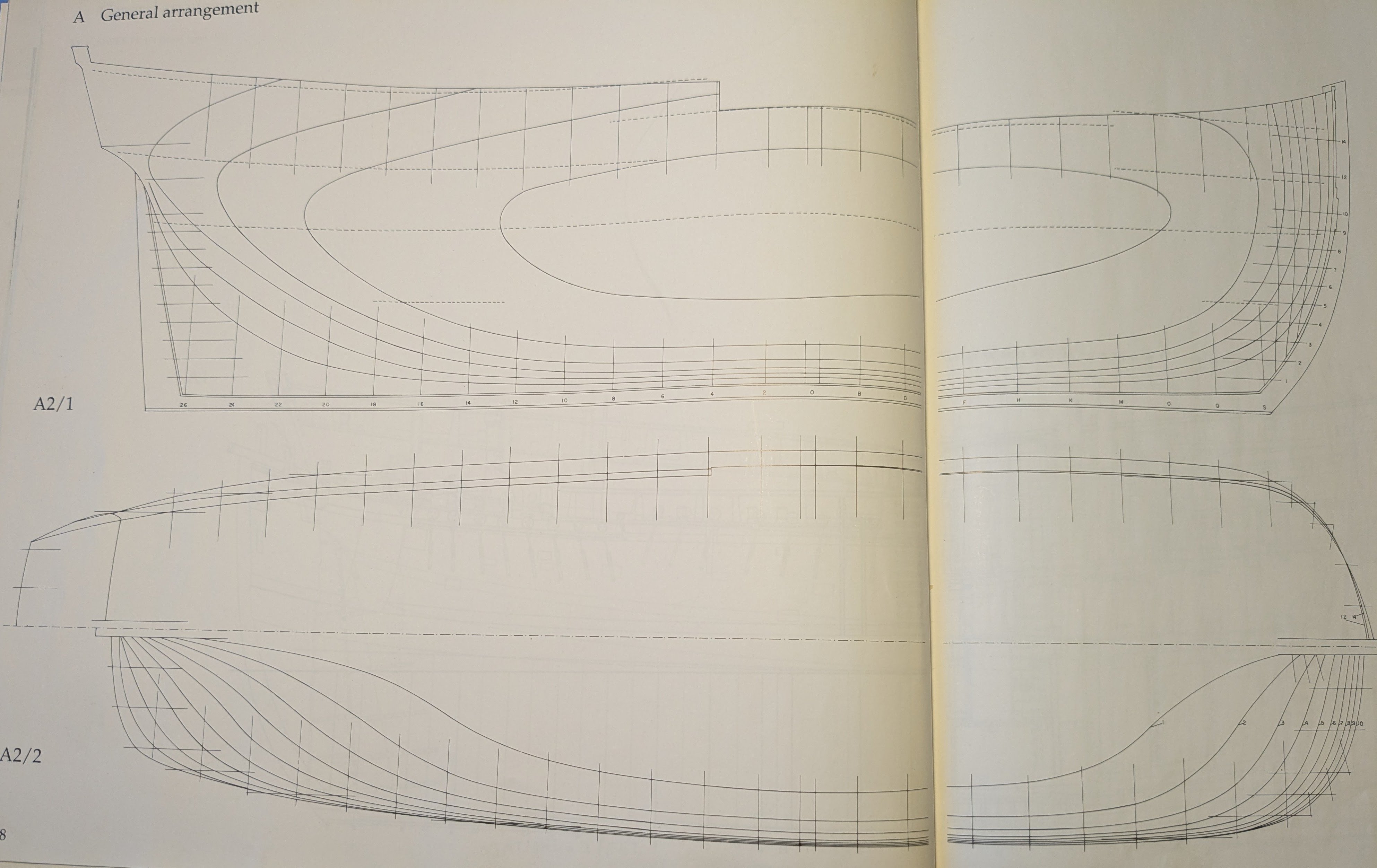

Regarding aft cant frames, I've included the lines for Endeavour, showing that as a Whitby coal cat, she was essentially a barge with stern lines quite similar to those in the bow below the waterline. Trever - considering that, would you still think aft cant frames were unlikely?
