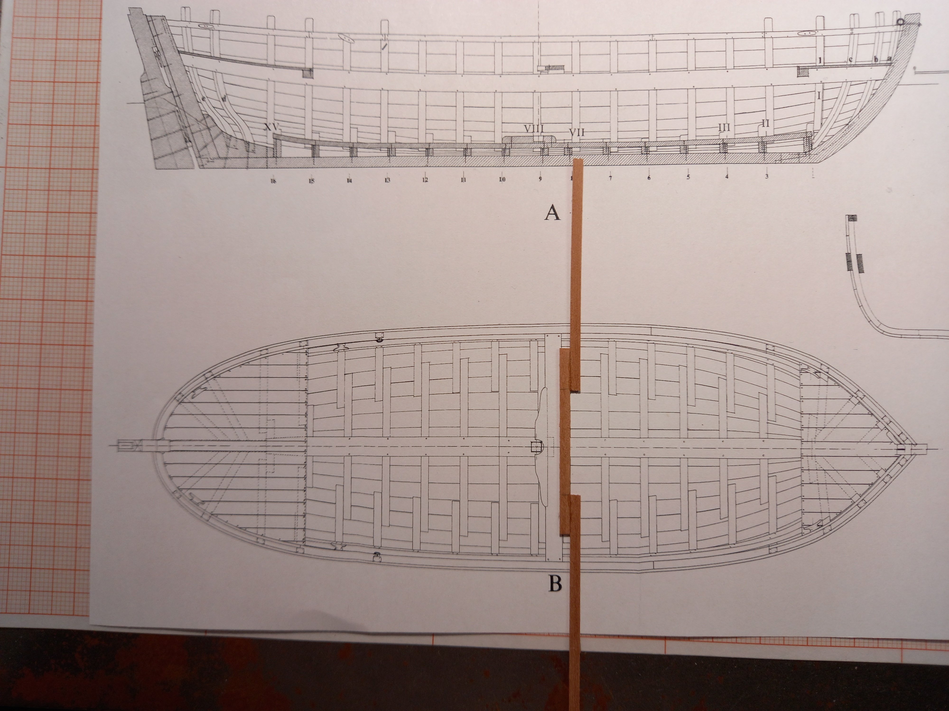

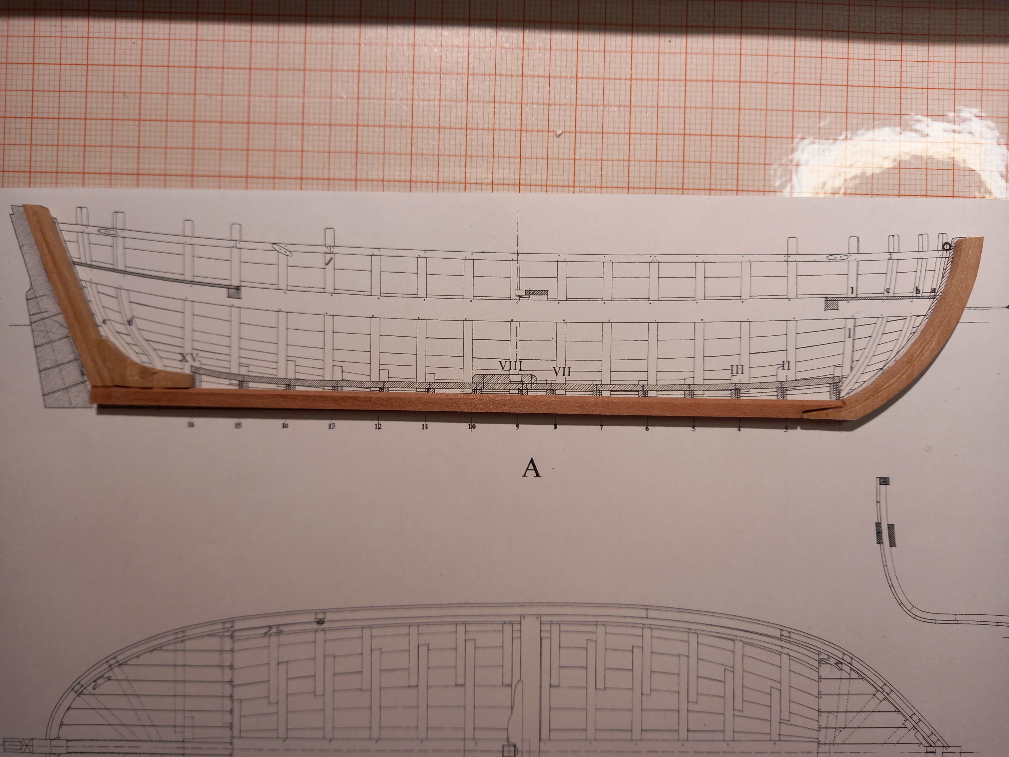

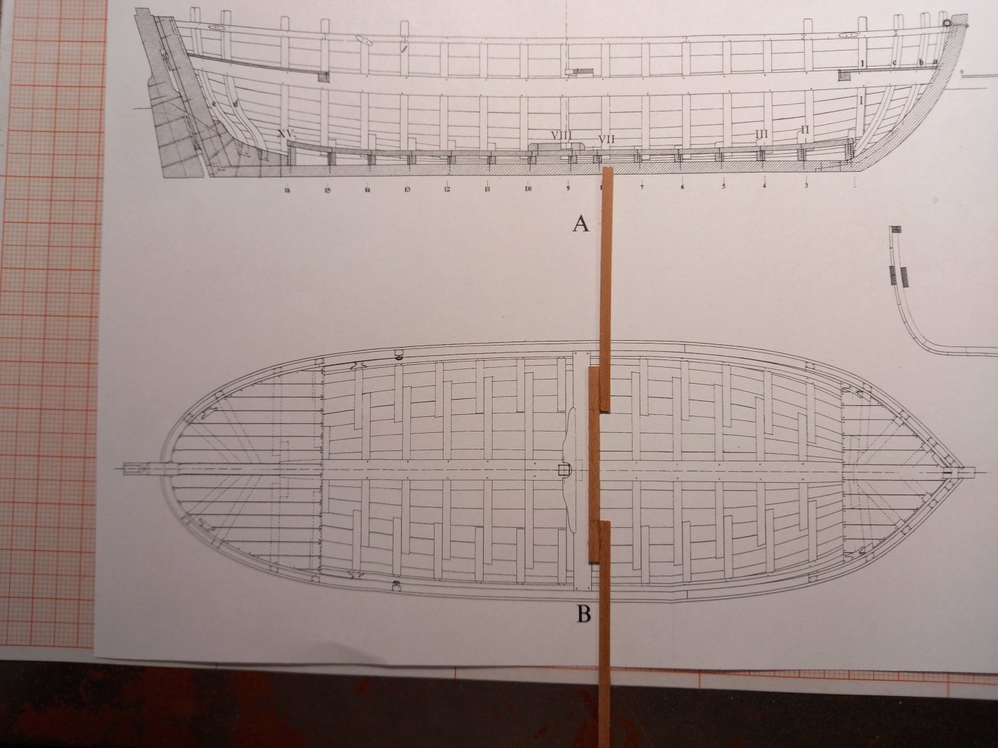

The scale of the project is 1/72, for several reasons. First, it´s my preferred scale, many other of my modeling projects are made in this scale. Second, a wide range of modelling stuff is avaiable in this scale, especially figures. Third, most of the plans fröm Ancre are made in 1/36 scale, which is exactly double of 1/72, so the only thing to do is to reduce the original size to 50 percent.

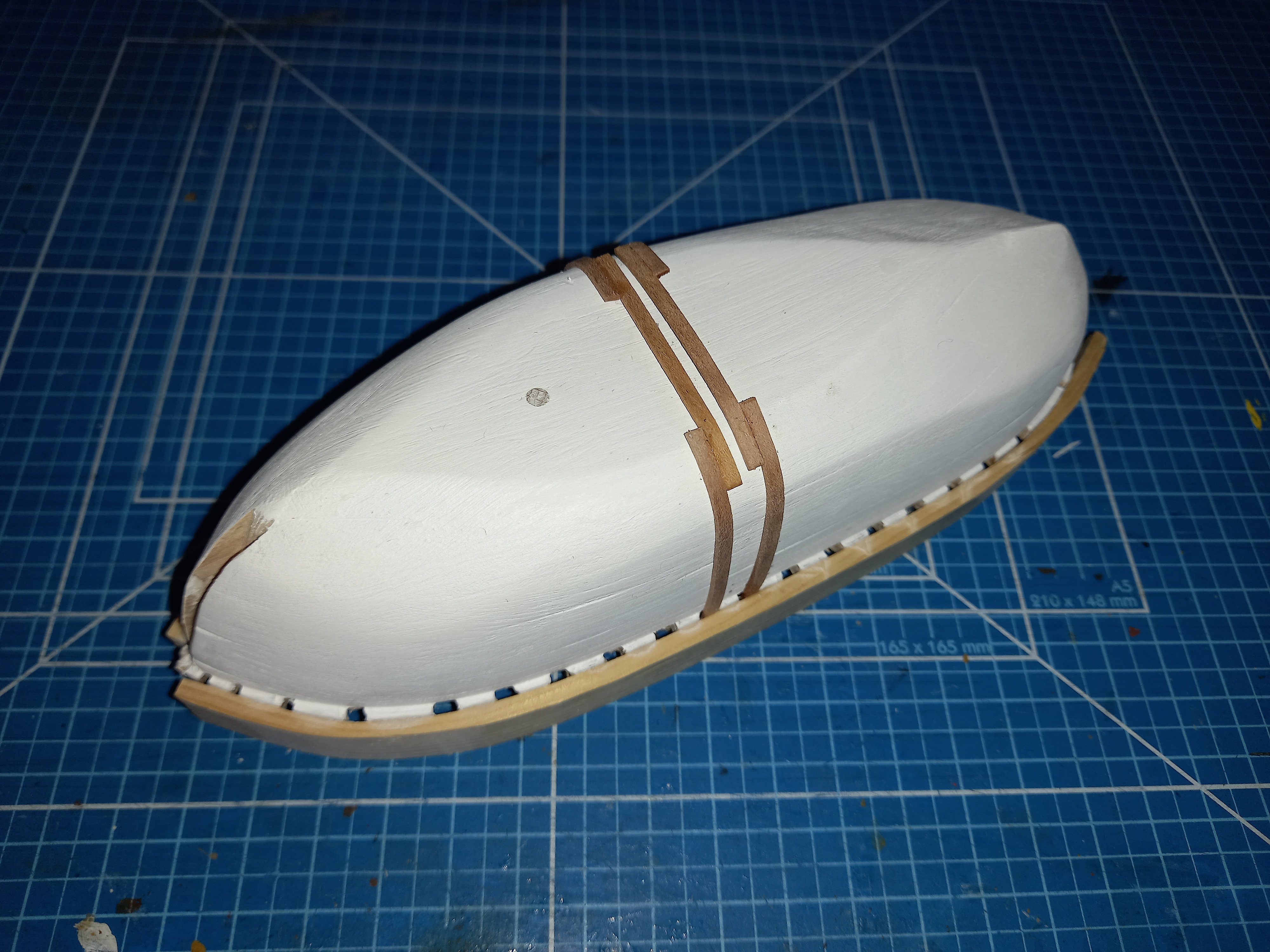

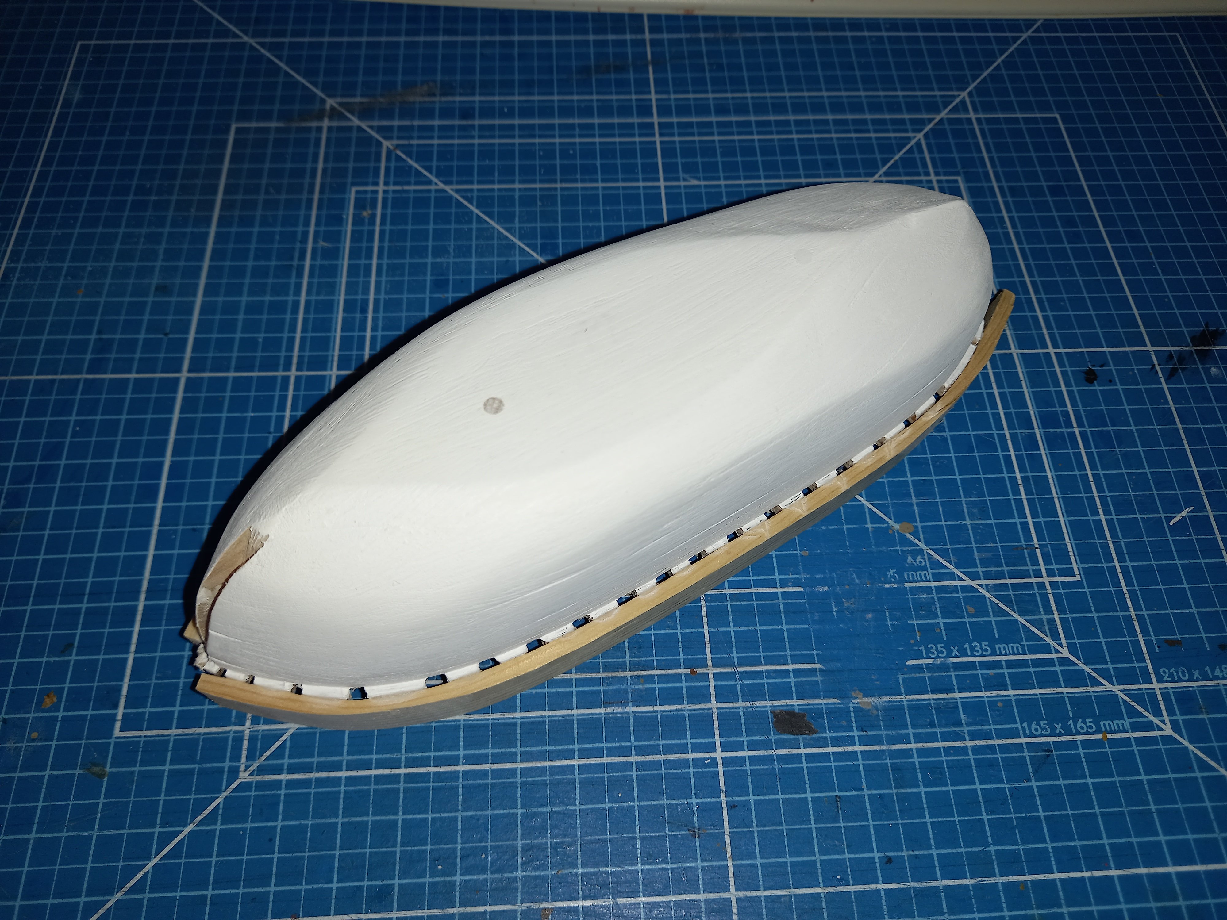

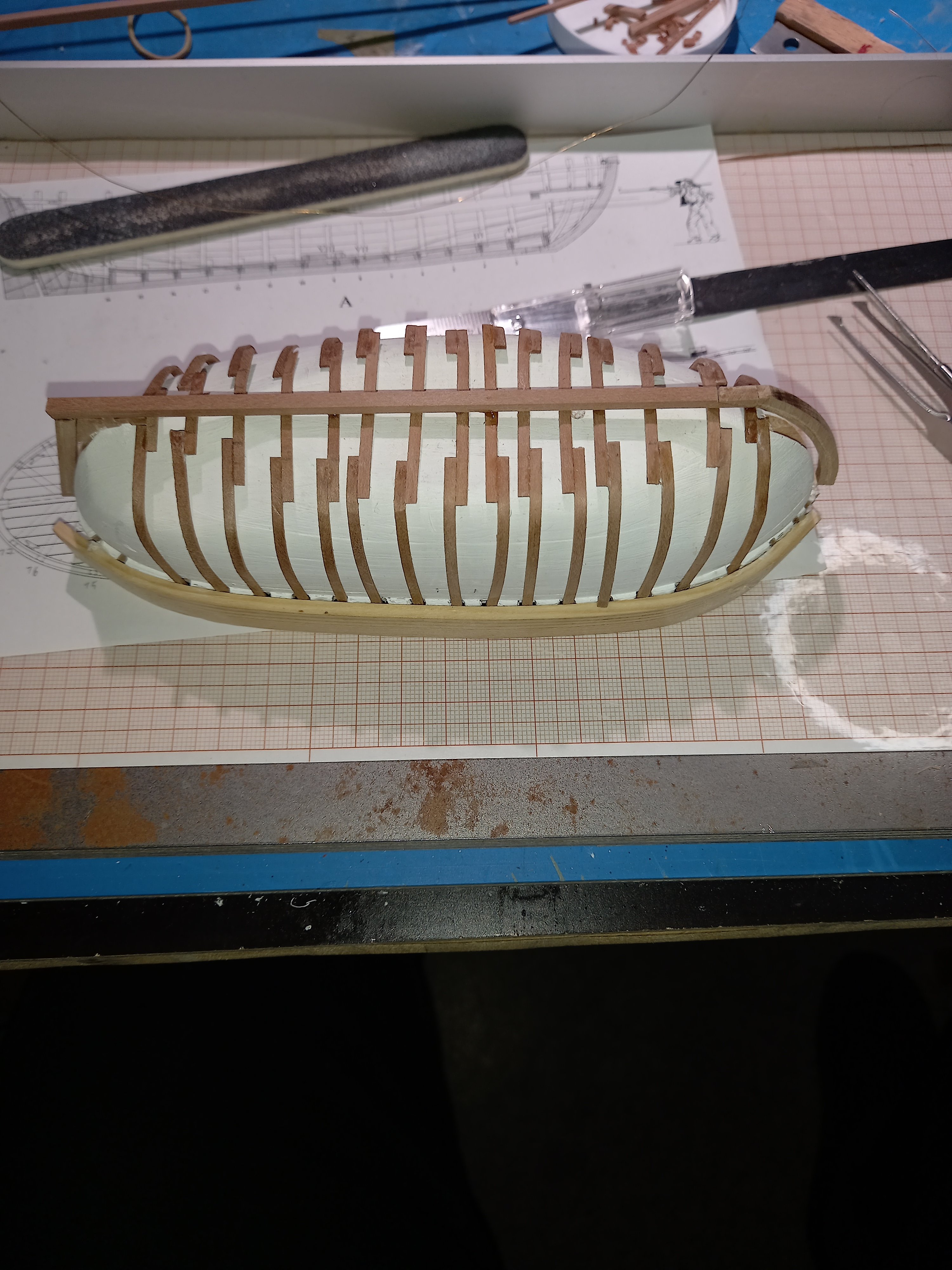

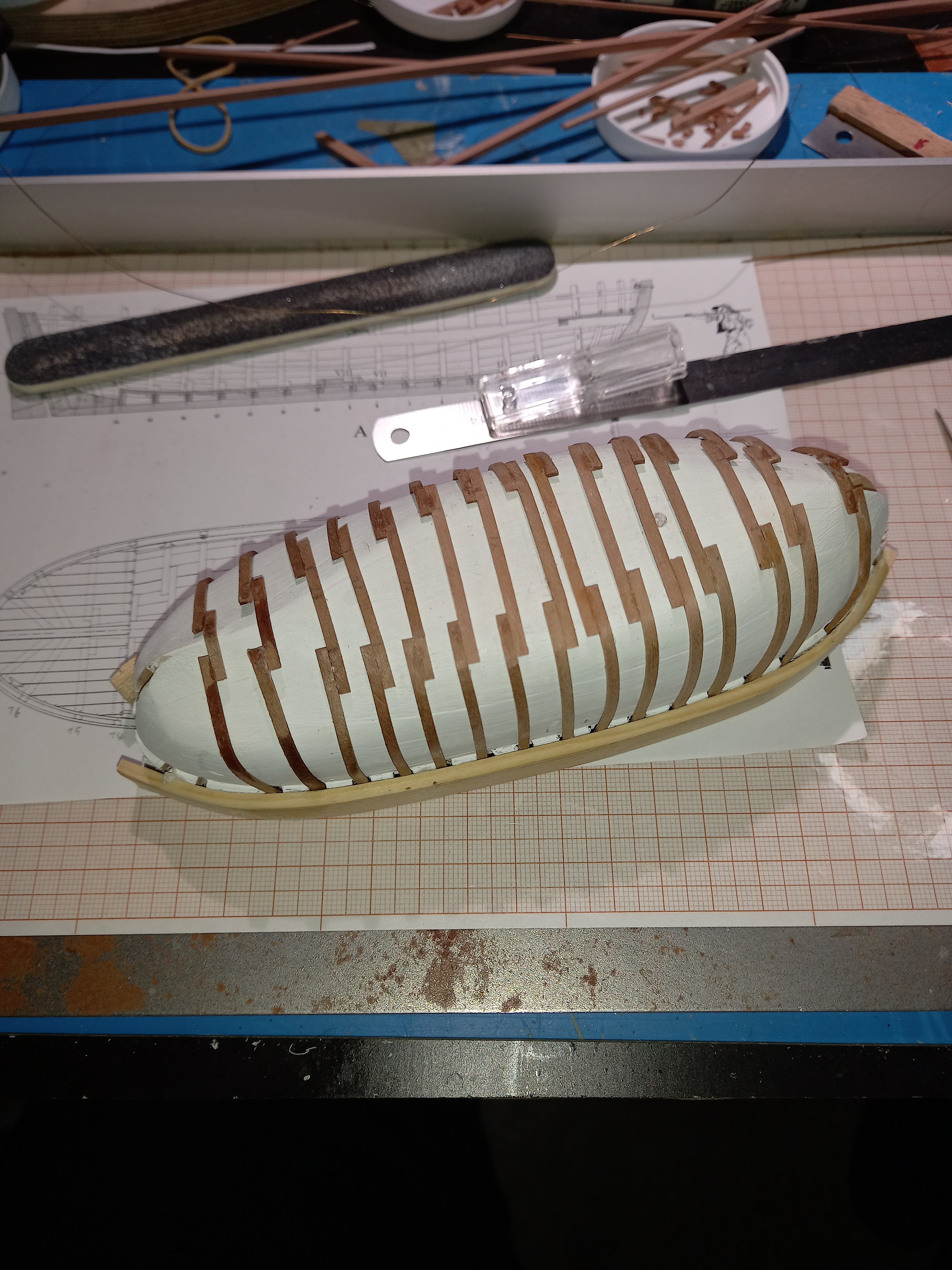

Work has just started. First, a plug was made to bend the frames. Thes are made of floors and overlapping futtocks.  Normally I relinquish to make frames from several parts and make them in one pice because this detail is almost completely covered with the inner floor planking and not visible on the model. But because of the fact that this vessel doesn´t have any floor planking, this detail is clearly visible on the model, I have to show this and so the frames are made of three parts.

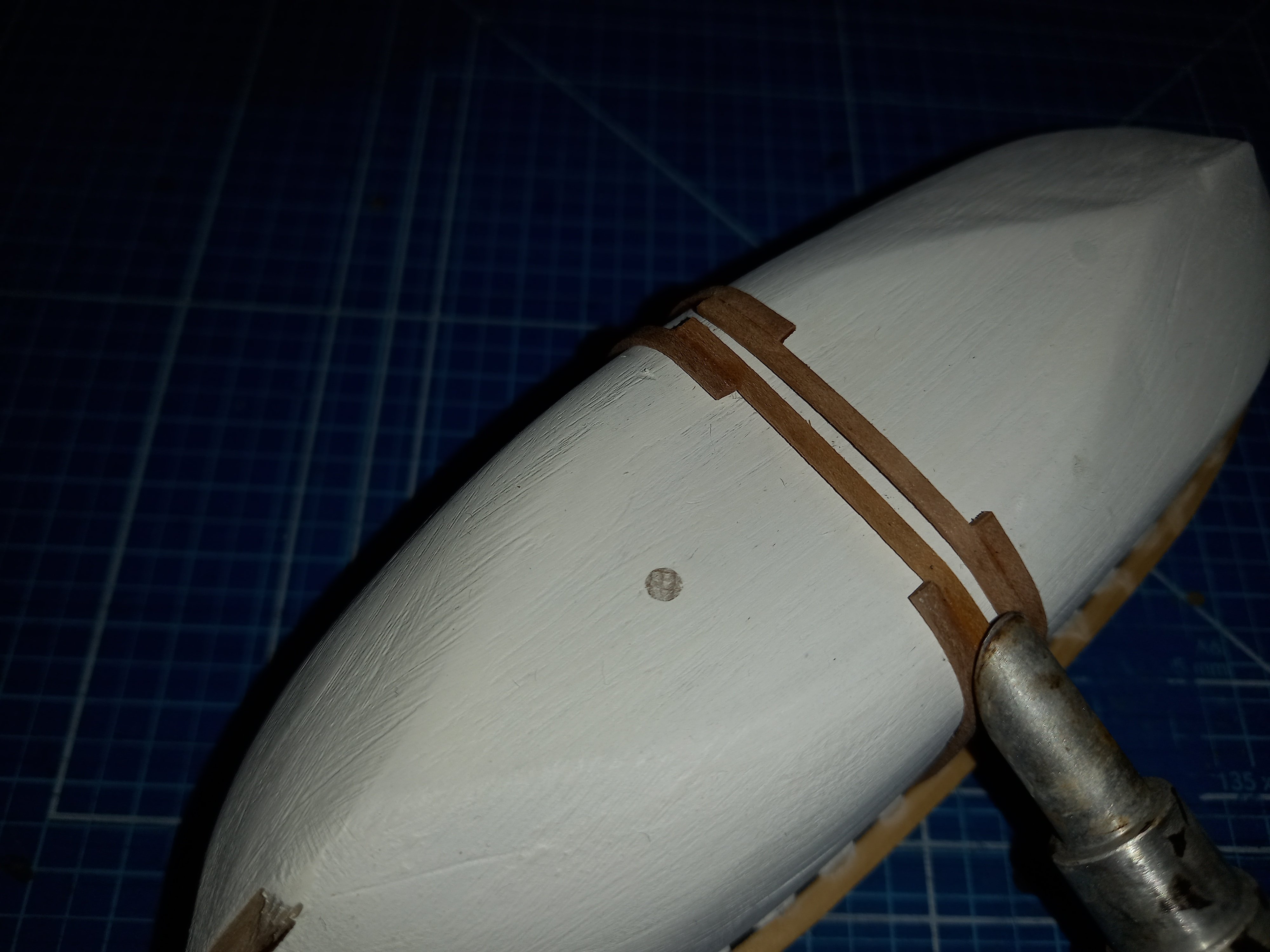

Bending wood is quite difficult? Not really. the only thing you need is water - and a soldering iron. First, the frames are soaked into water for approximately half an hour. It is important, that the wood is not absolutely wet but good moistened. After removing the frame from the water, it is laid on the plug and carefully bend with a temperatured soldering iron. Guess that not the tip for soldering is used for the job, you need a special tip to do the job. In this case you can see the tip, made from aluminium. This material absorbs heat from the iron but is hot enough to evaporate the water within the wood without burning it.
Nice start! I'm looking forward to following your build, and am especially curious to see how the bent cant frames turn out--I'm in the middle of building this same model in 1:32 scale and the cant frames have given me some trouble.
