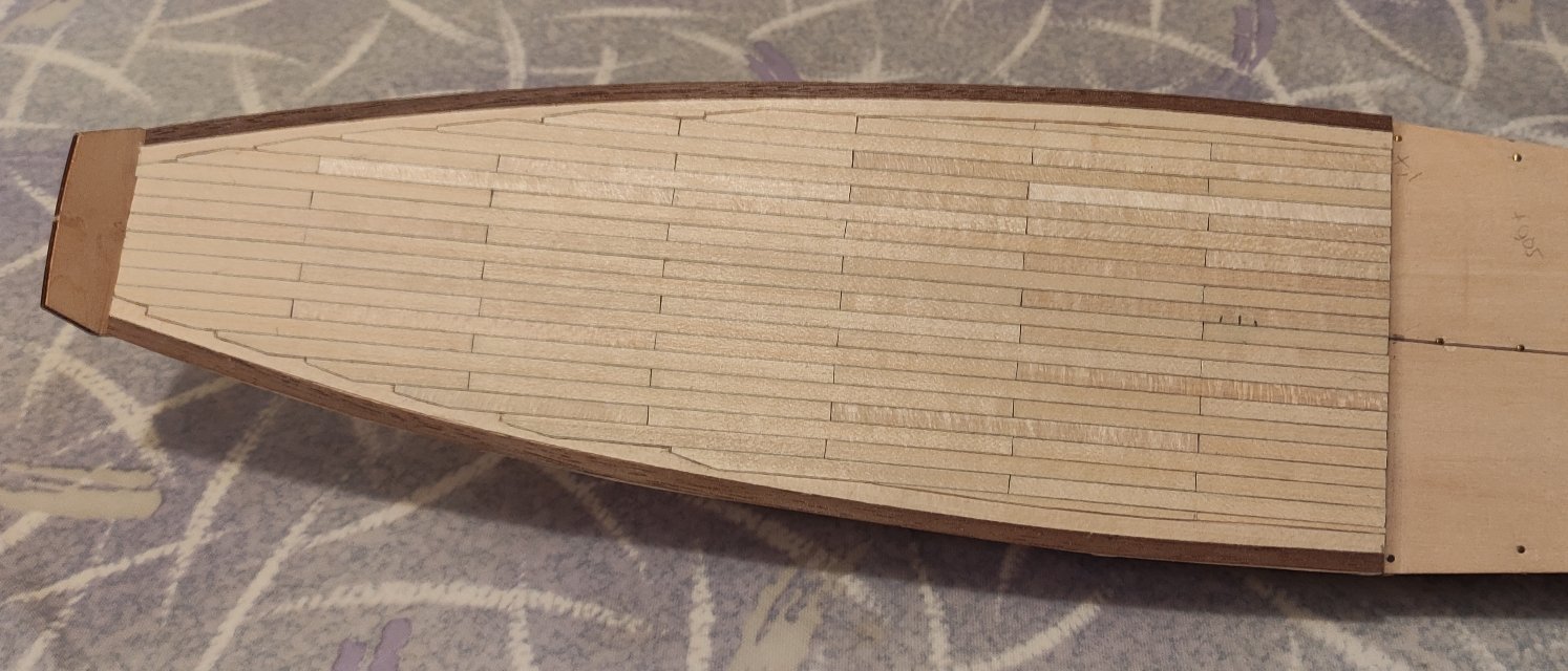

Today, I encountered the first part that I really struggled with!
I am still pretty happy with the result, given that almost every task in building a wooden modelship is new to me, but this is something I still need to get better at!
I was adding more planks on the deck, but as per manual, I have to make some cutouts in the curved outer plank. And that part, I did not find easy.....
okay, still room for improvement, but with every new plank, my skills are growing a tiny bit!
And maybe more important: I like doing this! I can’t put it aside, it’s addictive!
Edited by bnw
Nice joggling of the planks!

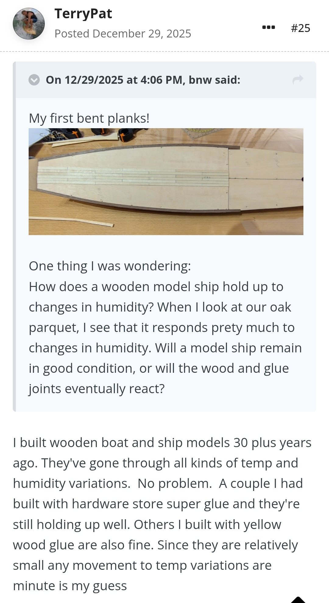

Did this ease your mind a little? As in no worry regarding shrinkage? Or even expansion?
Yes thank you! It would be a pitty if you put a lot of effort in it and the planks would curl up in dry times!
Right.. My dad was in process of planking a plank on frame kit and a water pipe above his workbench sprung a leak and ot soaked his model. It made a warped mess of it when it dried. He threw away in disgust.  That is of course extreme

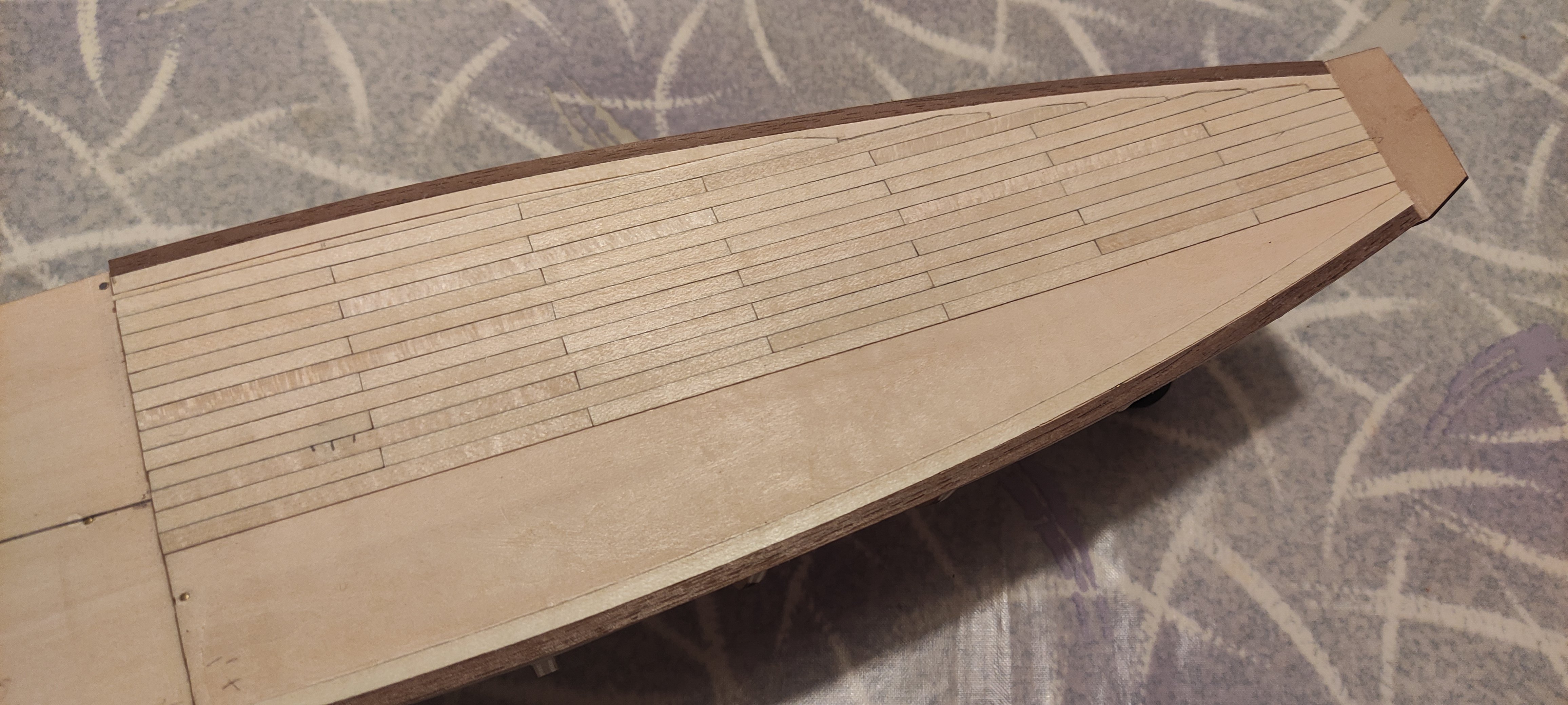

Thanks! To be honest, if you take a closer look, it can be done even more precise as what I did, but as said, this is all new to me, so I am quite happy with it.
When I will do the front part of the deck, I may take some pictures how I did this.
But actually I did it as per instructions.
First I cut the plank as in this image:
After that I placed it in position (no glue yet) and with a sharp pencil I drew the outline on the glued plank, which has to be cut.
After that I cut the part away, using a steel ruler and a sharp knife.
This part I found difficult to do as precise as needed, so when looking closer you will find some narrow slits, but overall not too bad.
Maybe someone has an idea how to nicely fill these slits?
I was thinking about a wood filings/glue mixture, but because I have blackened the sides of the planks to simulate the caulking, I am afraid that it will be worse than when I leave it as it is now.
Edited by bnw
