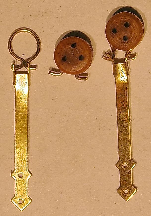

I am trying to figure out how to assemble the Amati chainplate assembly #4090/05.
I am stumped can any one help?
I can not figure out how to get the dead eye into the loop and then into the mount.
I bought the Amati 4090/07 to replace the fiddly chainplate assembly included in the Sergal SOS kit. I hoped it would be easier to assemble. I assumed wrong.
I have concluded that is impossible to get the dead eye into the brass loop. The brass loop is simply too small/string too short for the dead eye to fit.
I resumed using the assembly included with the kit.

This is my problem. How do you put this together?
Some where in the past I got the assembled unit. I cant rember where.
Now when I order the part I get the pieces.
Even the picture on the web site I ordered from shows the assembled piece.
I would first put a deadeye into the loop and then, with a pair of fine long nose pliers try to wiggle the unit into the holes of the chainplate, one end at a time. Trim the ends flush afterwards.

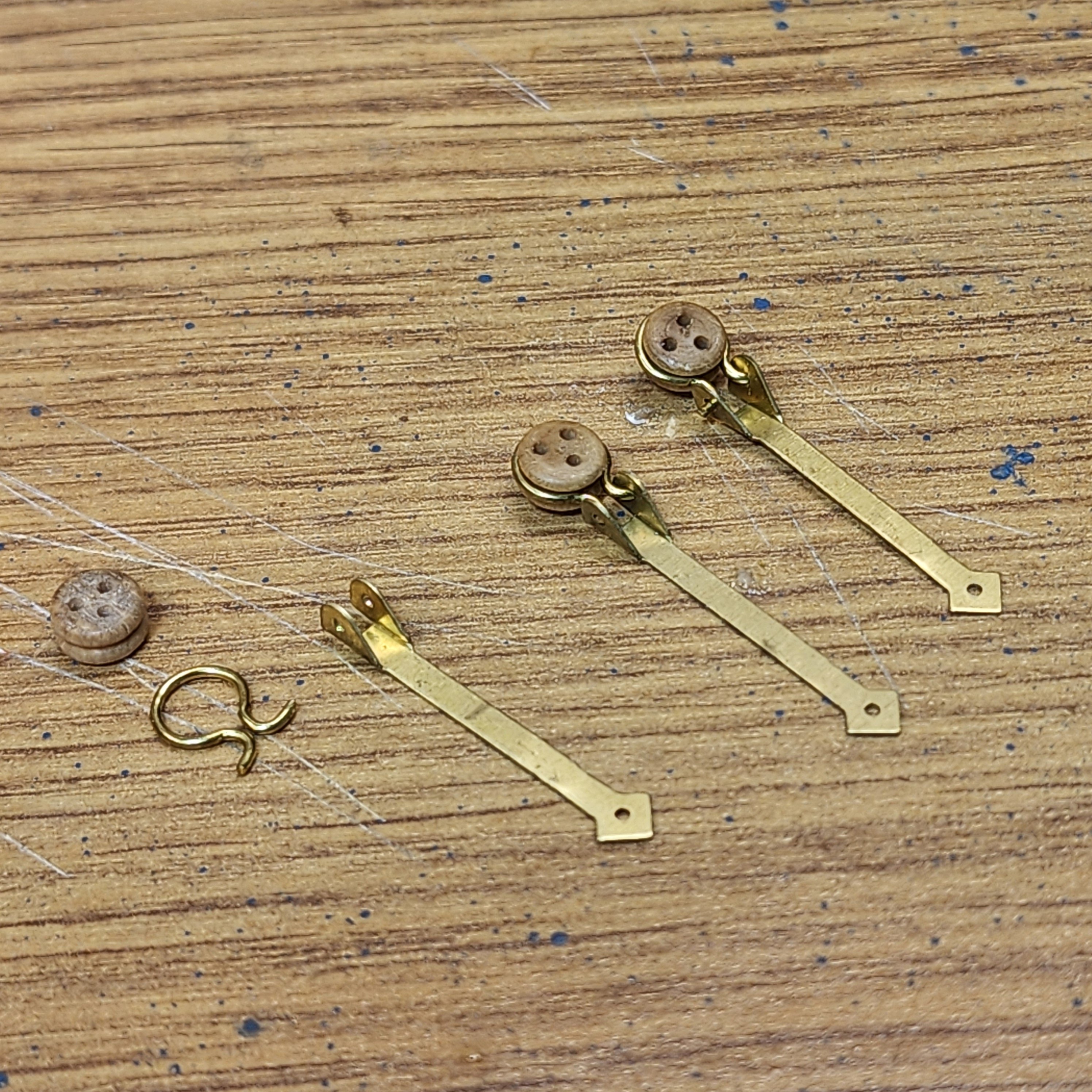

However, it can be done (just did it). Not by using the copper string provided for in the assembly; it is too short, but by using a bit of copper string cut to proper length. Quite fiddly - I used abot ten minutes and everything involved deforms quite easy while handling it.
From left to right: 1) Original assembly without deadeye You cant fit the deadeye in the loop. 2) Deadeye with copper string provided in the assembly. 3) Assembled unit using a longer string and cut to size.
