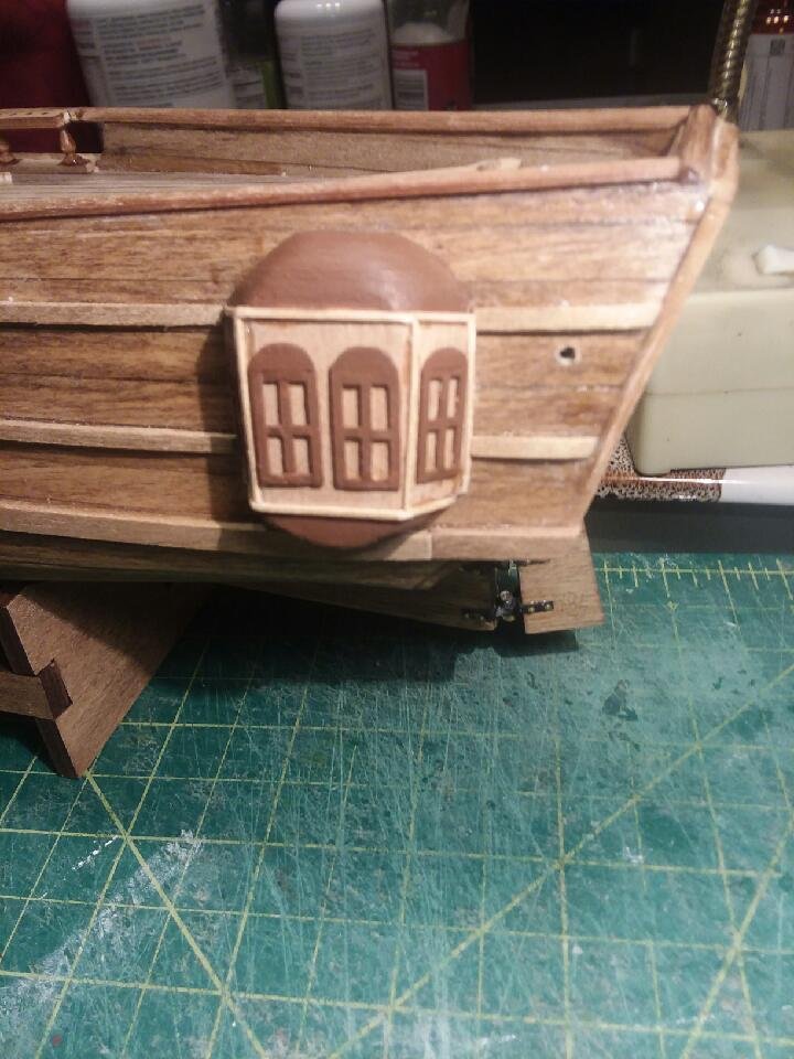

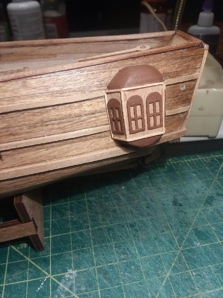

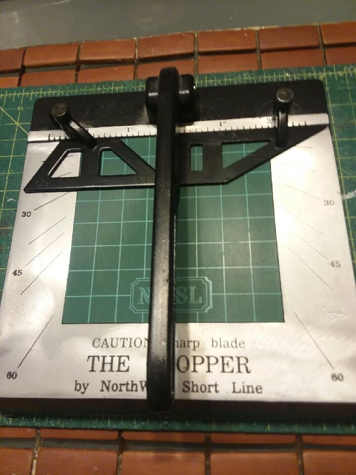

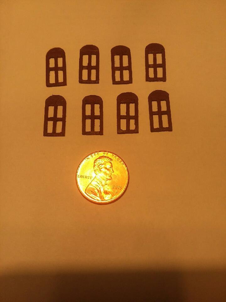

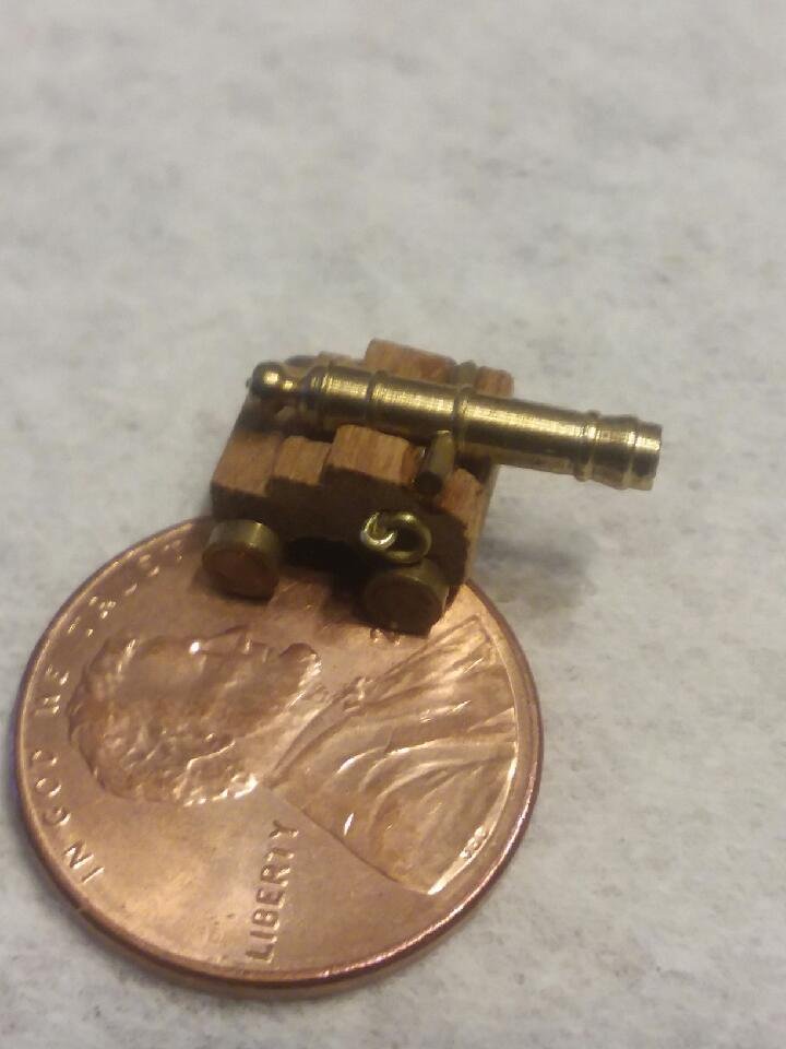

  7. After I do my limit of 4 planks, I work on other parts of the model. I decided to work on the cannons because they looked so nice. The barrels are very nice, very small brass turnings. As a former self-taught tabletop amateur machinist, I'm always impressed by this kind of work. The cannons went together with no problems, even as small as they are. Later in the build I kept looking at the solid pieces of wood that were supposed to represent the windows in the stern galleries and finally decided I had to do something different. I pieced them together from small strips of basswood. This took a while but was made easier by using a tool I saved from my years modeling in O scale. It's made by North West Short Line and called The Chopper. It's one of those tools that you don't use all that often but is a terrific time saver when you need it. Cutting multiple pieces to the exact same length is easy using it. Mine is pretty old, and is an earlier version. I checked eBay and found slightly updated versions, along with the very first version, which I also have. It's rather pricey, though, and probably not a necessary tool for most ship modeling. At this point I had finished the hull and was ready to start on the masts and work on assembling deadeyes. That will be next.
