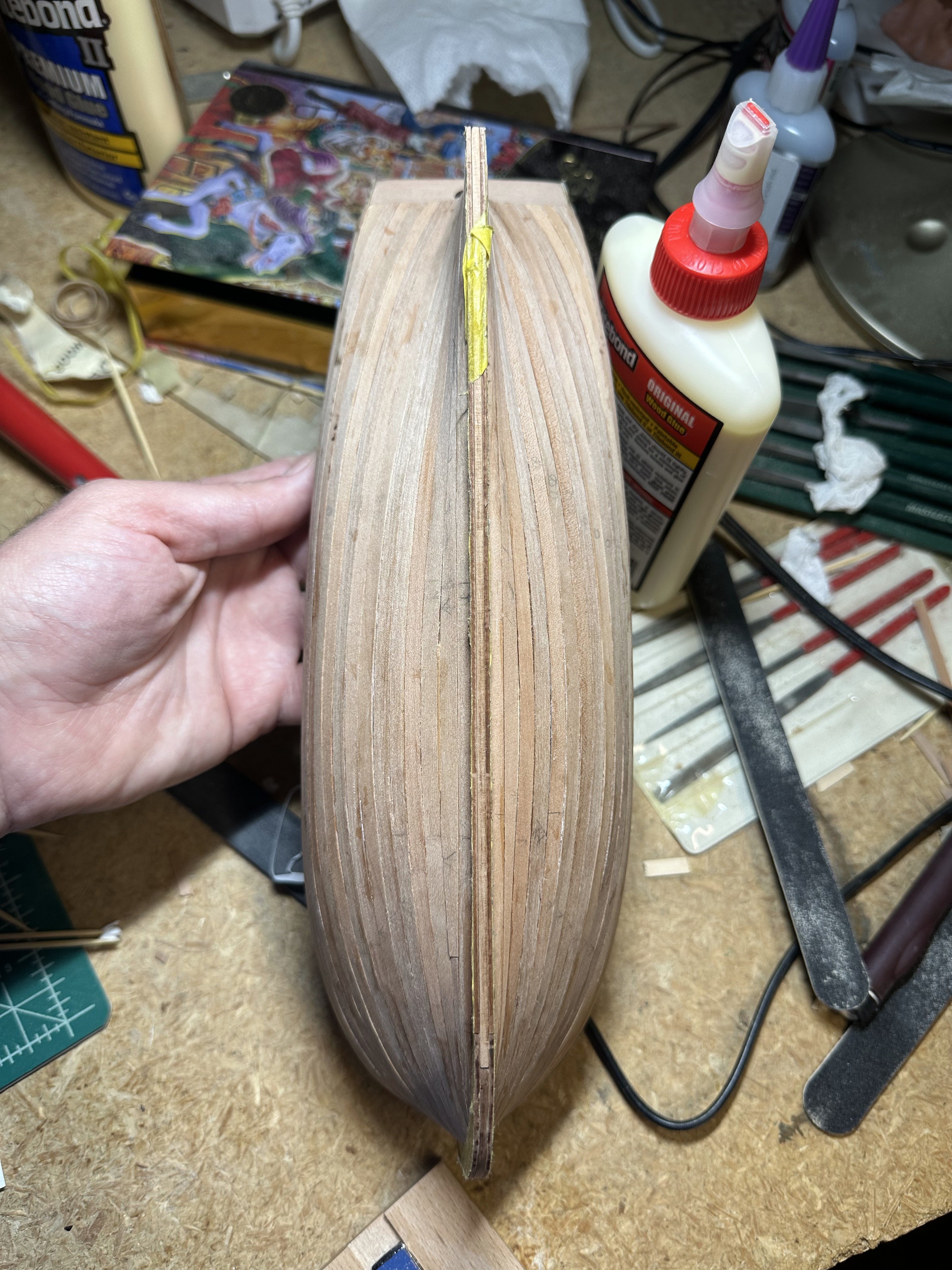

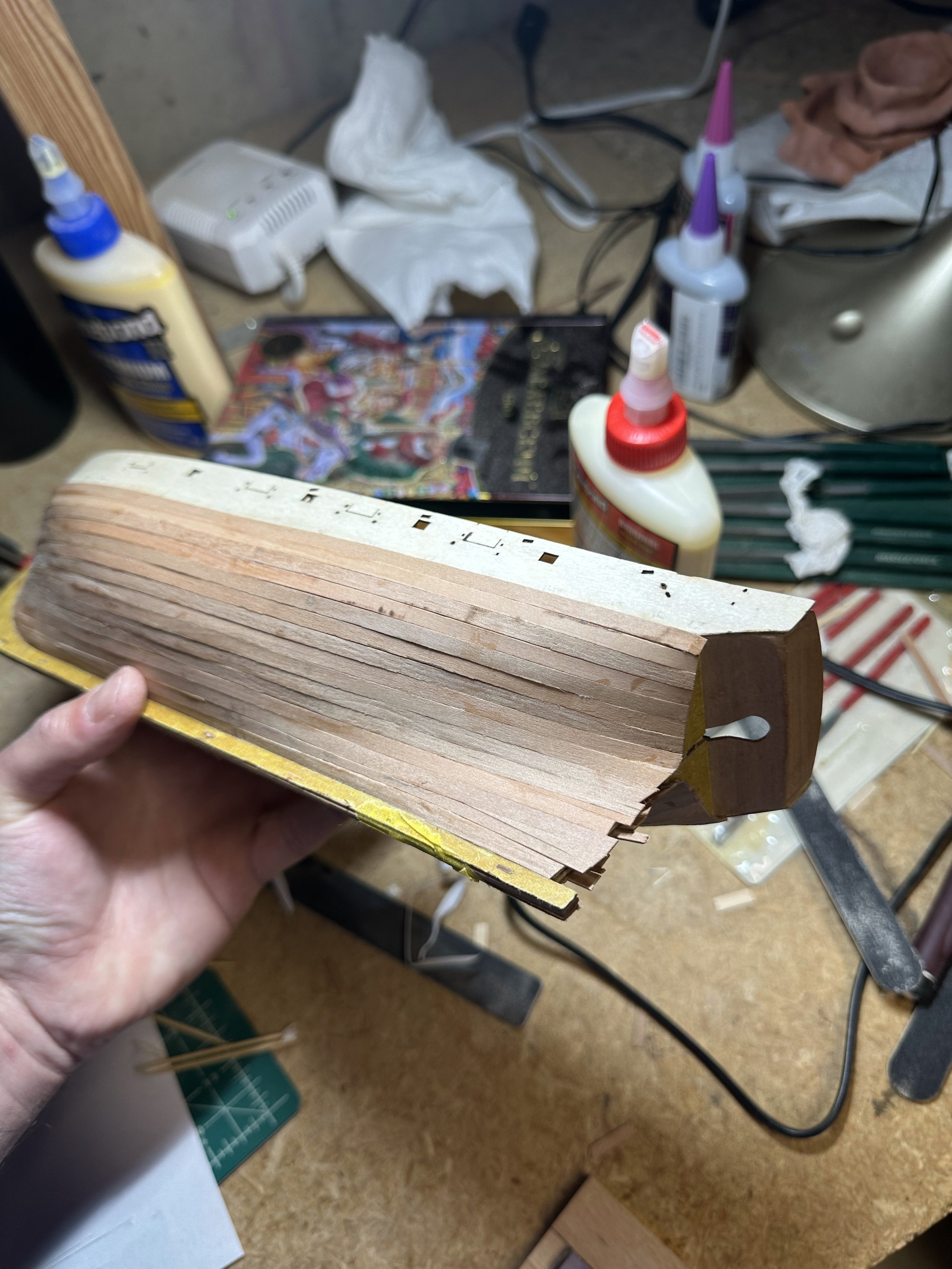

Run into a problem looks like... (few but one is more than the other...) was a bit overzealous with sanding and had the first planking layer showing. Attempted to mix together a mixture of dust and yellow glue, masked sides with masking tape, and added created filler - but when sanded looks like it did not go away that much.. Are there any methods to solve this that anyone is aware of is it just better to leave as is and put it as a learning experience?

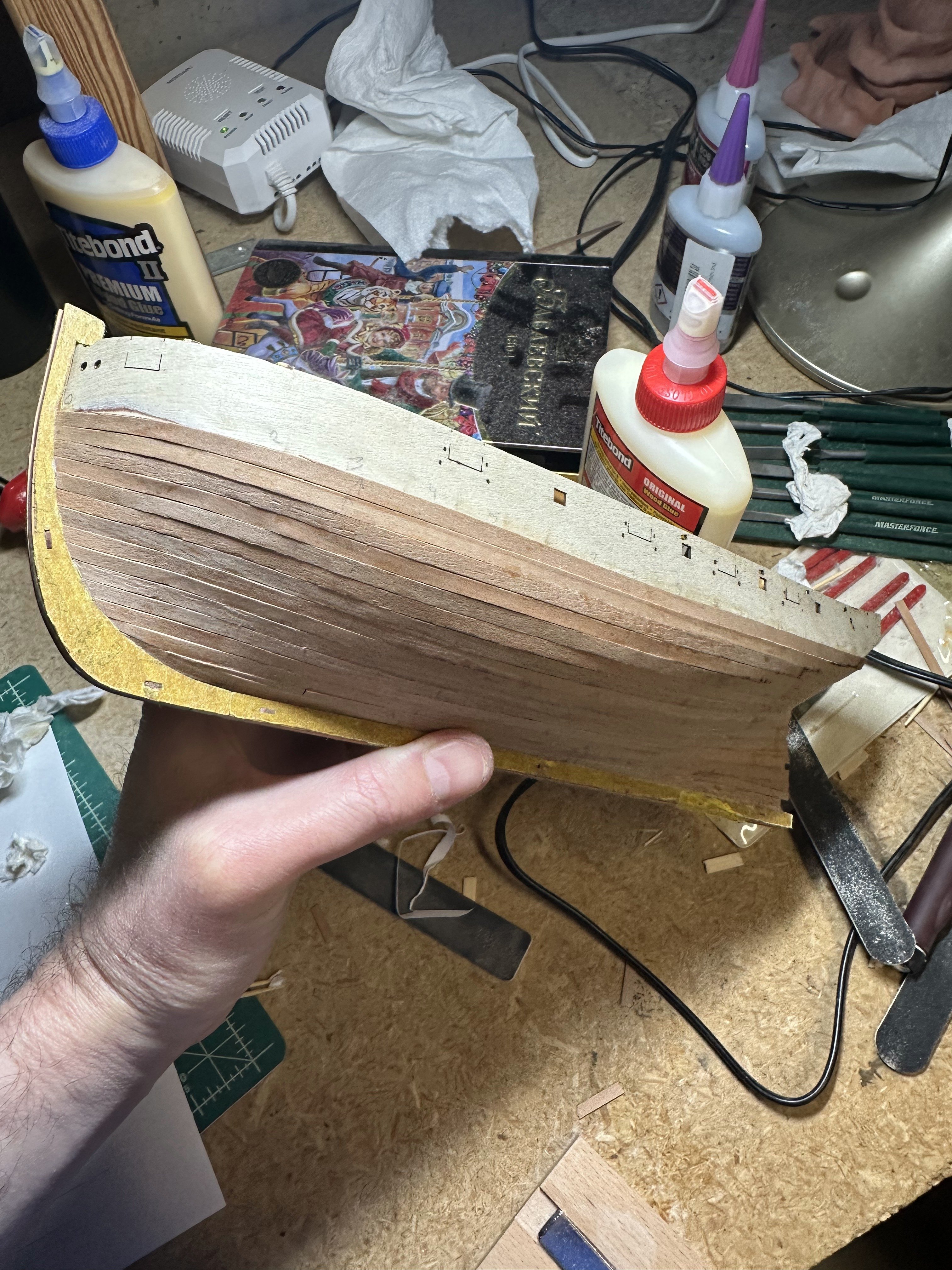

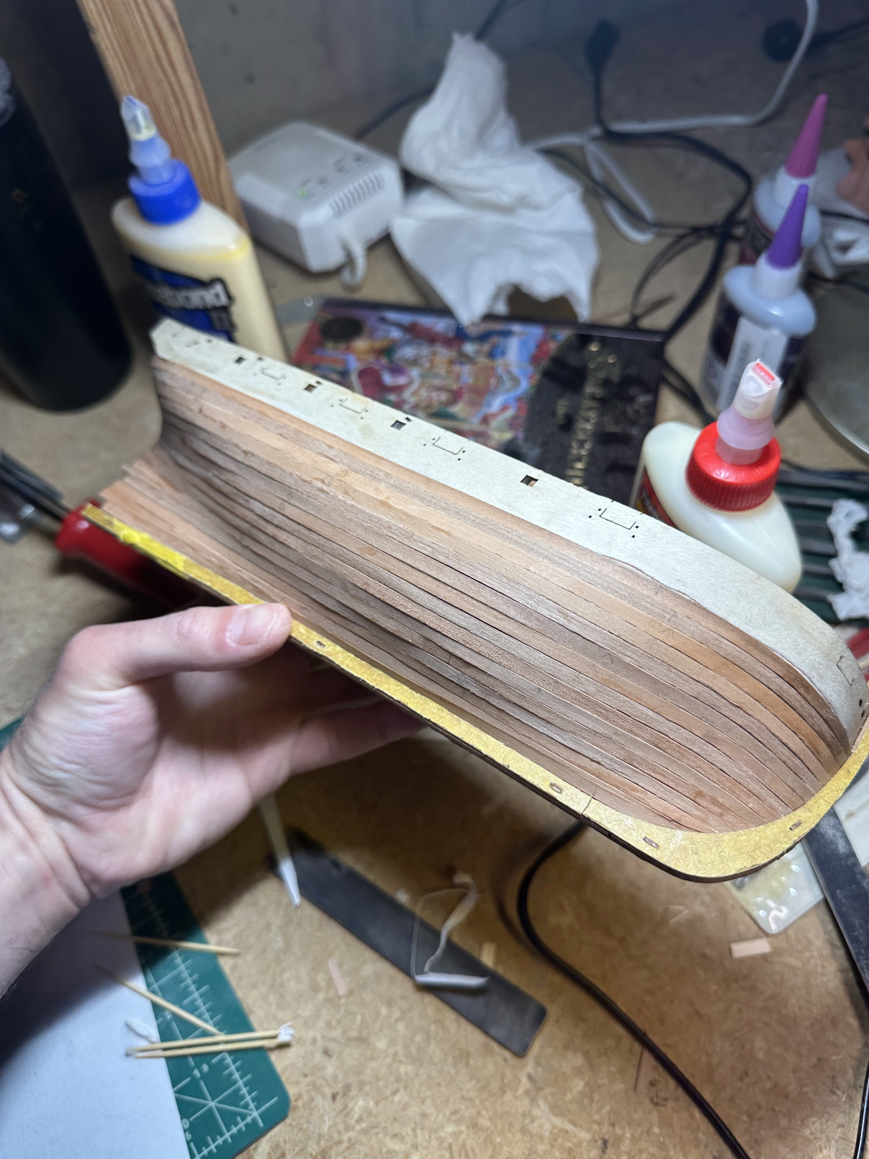

Second planking is done... Last plank turned out to be very tricky on both sides, spent a lot of time sanding and cutting it to fit the opening... Now need to figure if it is better to paint the hull white or leave be in natural color...

Slowing getting second planking on using the advice - thank you! It might not apply to this one since it will be painted but will accidental drops of super glue be visible if the model is left unfinished/i.e. is there a specific way to get them off? I wonder if others have run into this problem...

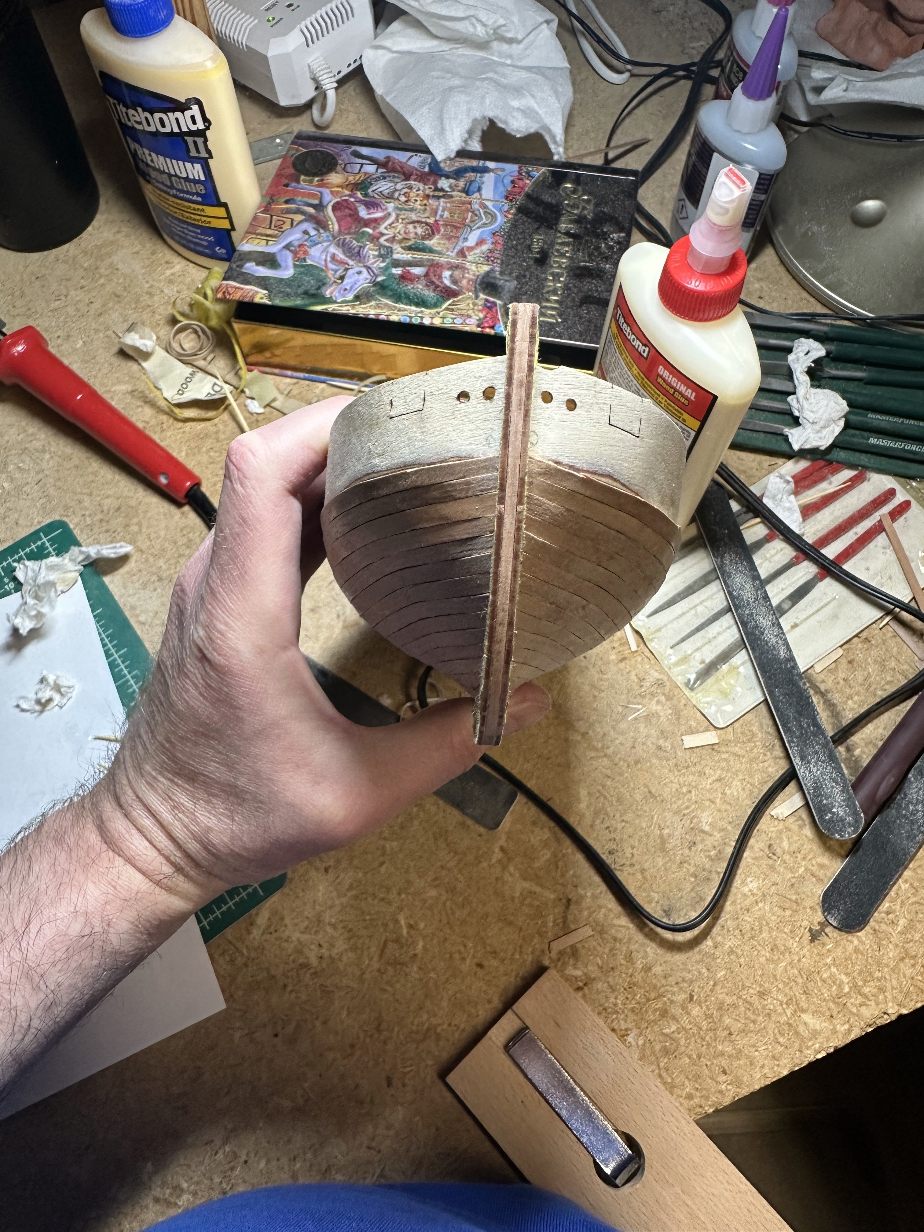

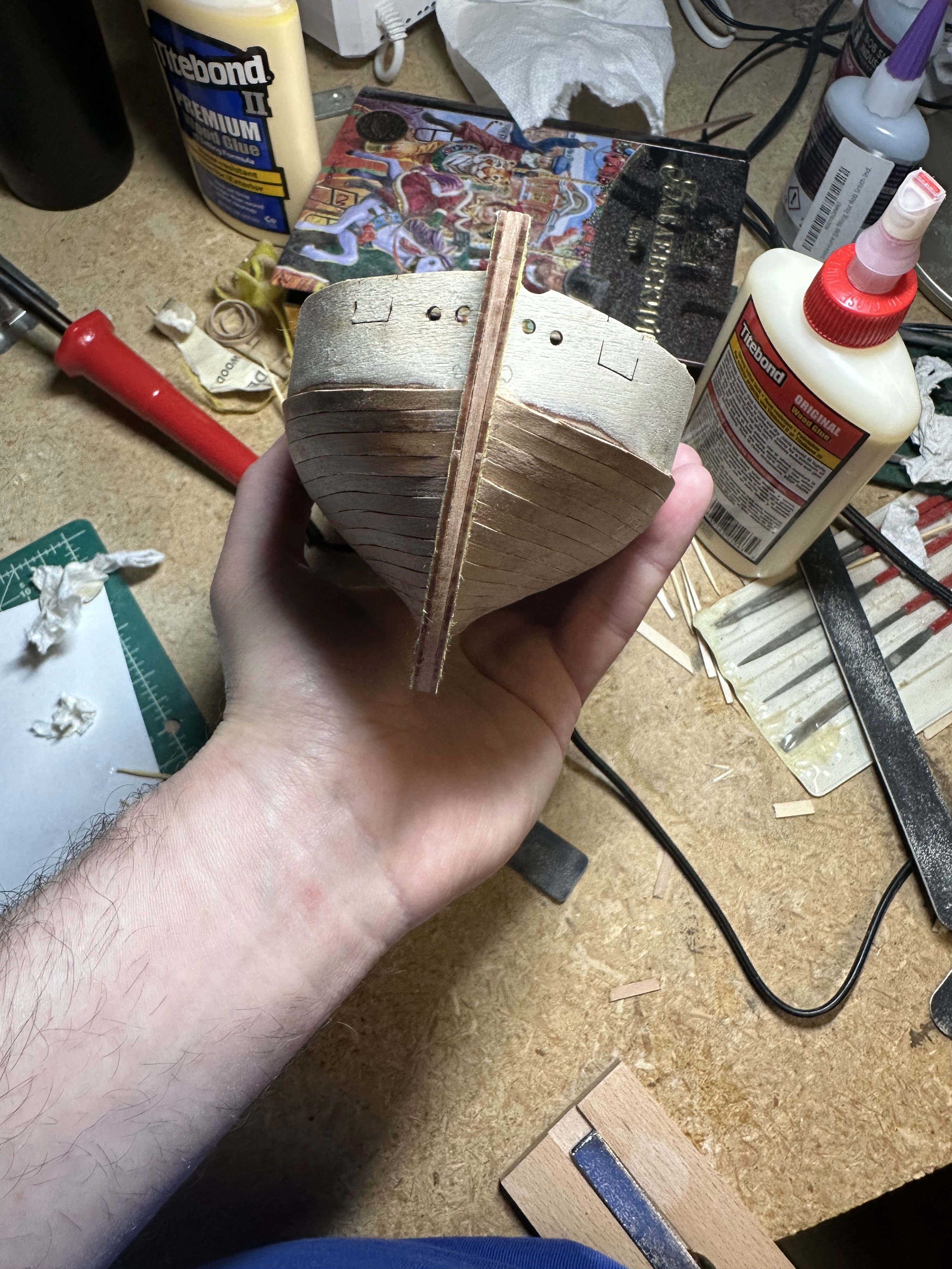

First planking is done!! Thank you so much for the suggestions! took a bit but the method of bending planks vertically helped - i had to do this in multiple pieces and took a while before i had a hang of it.. I was holding the plank at 2 places on the table with big clamps and then moved the 3rd point of the plank up in the direction of the bend twisting it a bit to not break it - and then went over with the hot planking tool to get it into shape with a little of water. Now need to figure out how to hold the second layer of planks in place while glueing since nails on the finished layer don't appear to be the best choice.. i was thinking to use regular push pins but they seem to be too big/thick to go in.. What would be the best method? I am considering perhaps using the nails on the small pieces of the spare plank but it would take a bit to create them all plus not sure if will hold well...

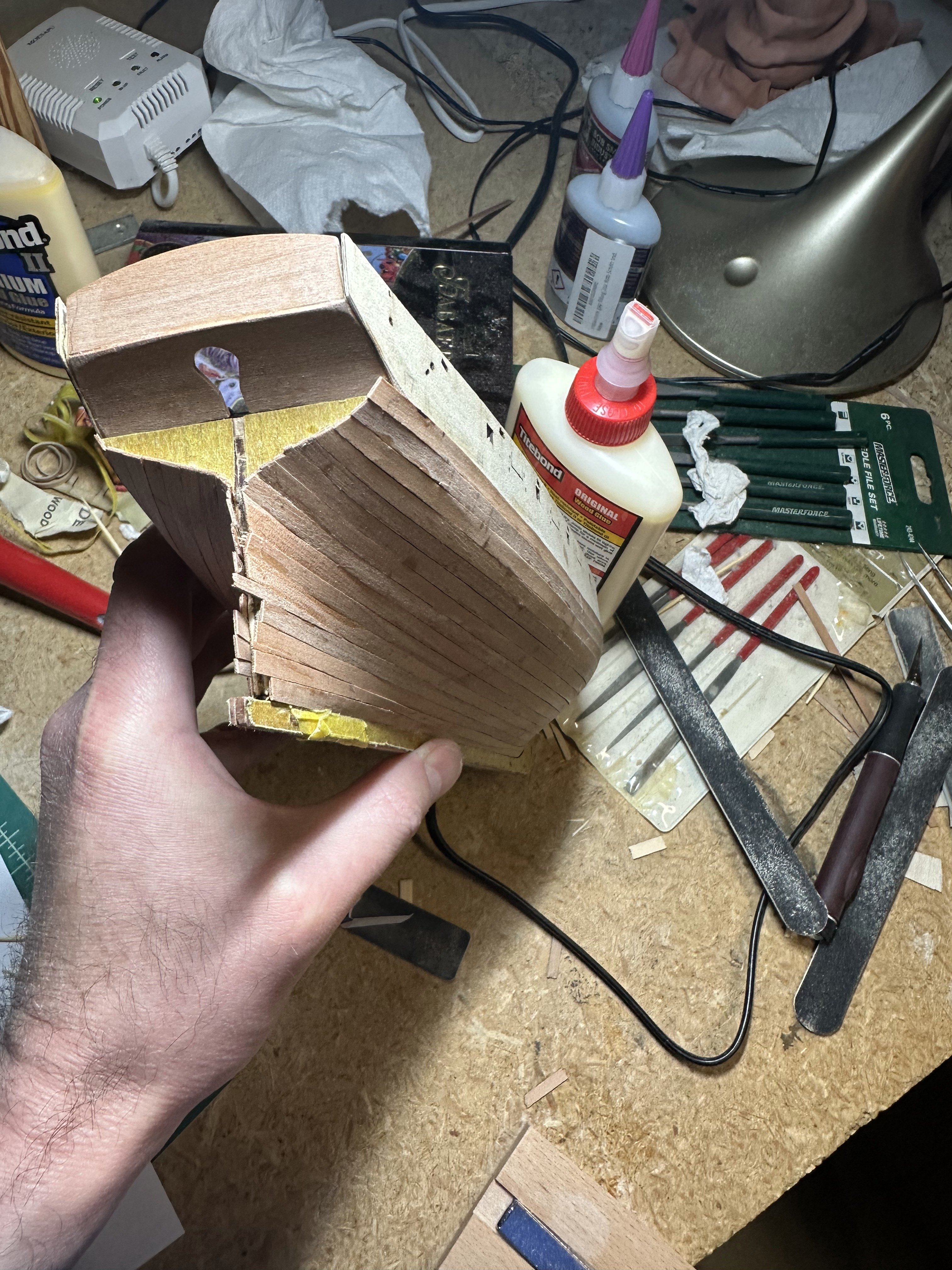

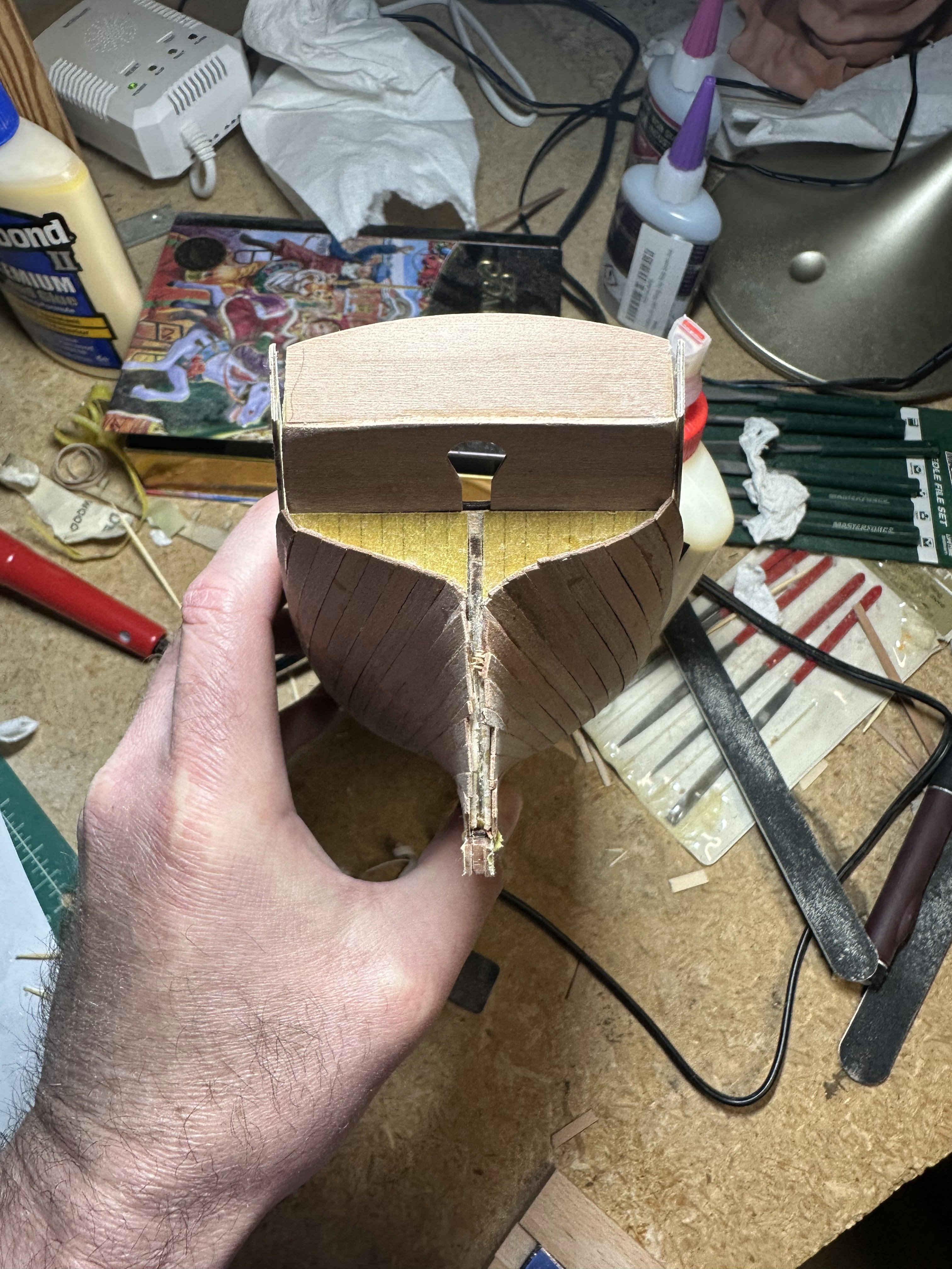

After really long pause with all kinds of life stuff in there back at it... Finally semi-fixed the overzealous sanding issue on the keel from before by inserting a strip of wood; re-attached and glued again the starboard side to be more aligned with the height of the transom... and then did the step I dreaded the most - first two planks, one on each side. One part of the starboard that was holding on with the very thin layer of glue has come off again while pushing the pins through the planks... will need to be glued again. One had to be redone since broke off during bending.. hopefully the first and the last.
