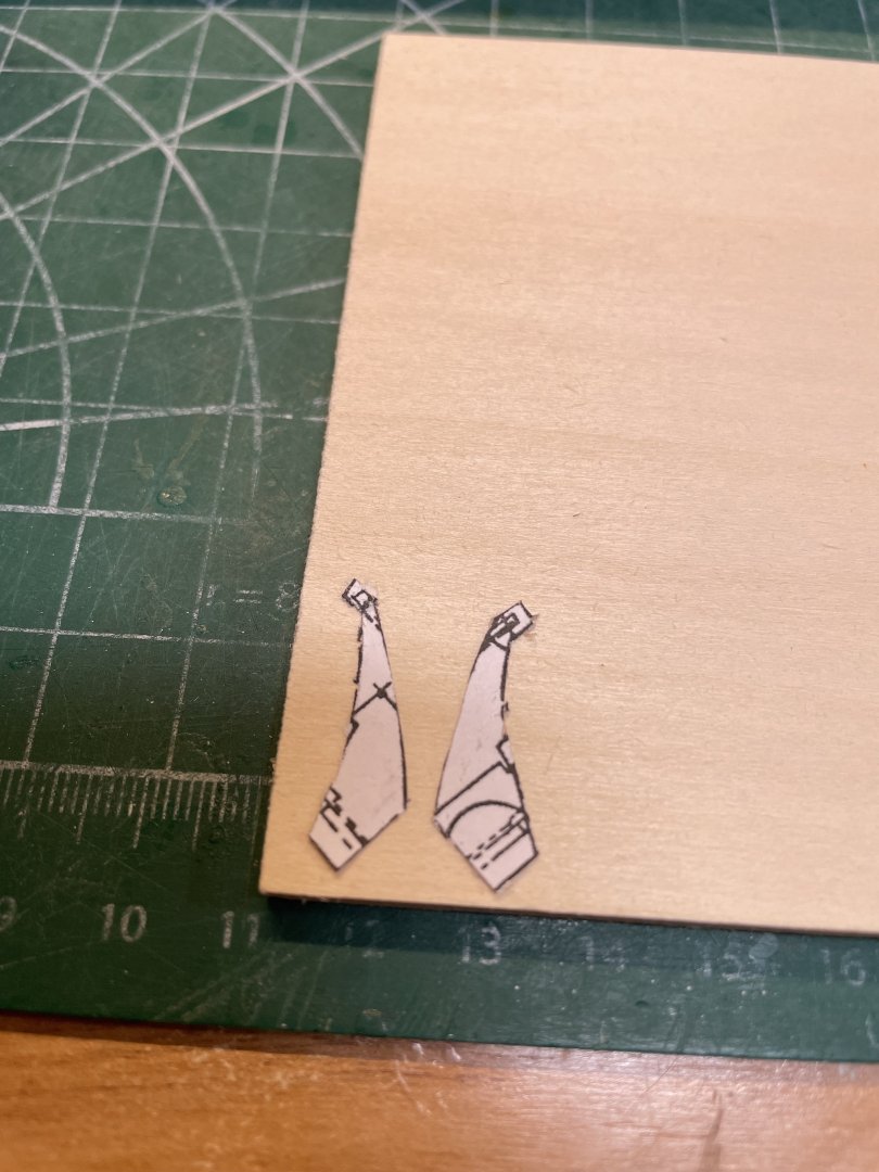

Thanks Jon and Frank for the encouragement. I have a couple dozen fly hooks in my old fly tying stash. I’ll raid those, then check out Temu. I have been trimming the knees for the gun deck. I’ve got about 25 and I need about 60. I am completely brain dead from this exercise. But, what is there to do,but keep cutting and sanding. Happy New Year to you both and all the other guys struggling with the Constitution. Jim

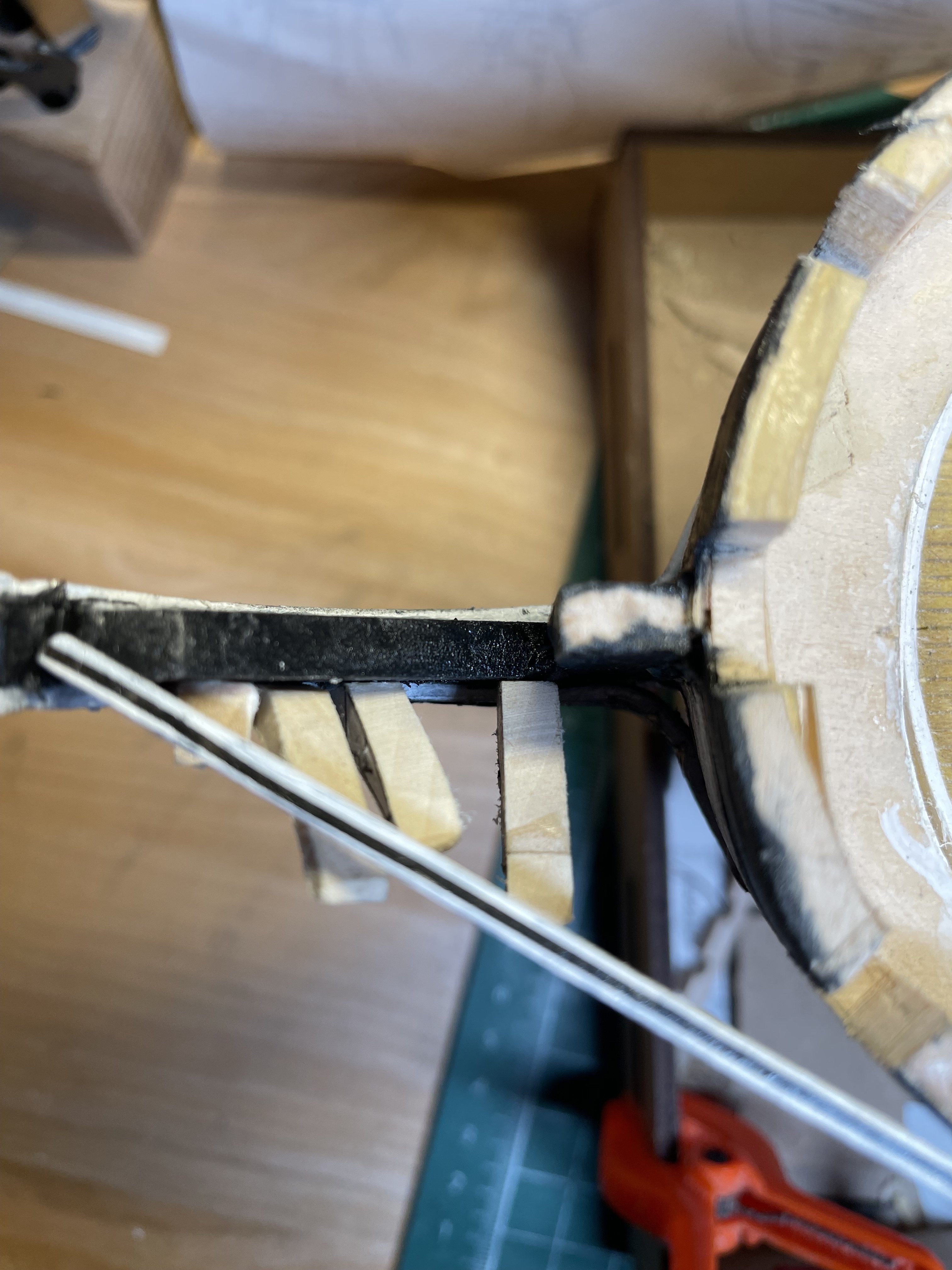

Progress continues on the gun deck. My plan is to finish the catheads but not glue them in until I add the spardeck. Then add stairs through the hatches to the berth deck. Next up was deck furniture, then knees and finally cannons. Those steps should complete the gundeck. Catheads I’m pretty sure the lower rail was not supposed to abut the supporting knee, but I learned too late that this configuration was added later in the ship’s history, but I like the way it looks. I added the fittings. The eyebolts seem out-of-scale and I’m dreading the possibility that I may have to run rigging through the blocks. The lion head was an after market purchase from China ( it arrived in less than two weeks. ) I used my new Proxxon milling tool to cut the sheaves. I also made and painted the capstan and hand pumps. None of the pieces have been glued. I’m going to make and install the knees first. That’s about it. Please feel free offer suggestions, advice, and feedback. Semper Dienceps Jim
Bowhead Structure, part two I stripped the misshapen bowhead timbers and started experimenting with different timber shapes that would support the cross timbers and fit the middle rail. The new design was less vertical but provided a better base for the cross timbers and grates. After getting a shape that I was satisfied. with, I painted the pieces and used 1mm art tape to define the outline. Then I added the cross timbers and shaped the head grating. It made more sense to cut the grating and create a step down to help the shape. Then I modified the seats-of-ease to fit against the bow. Finally, I used some scrap sail cloth to fabricate the canvas covers. The fabric was dunked in water then painted with a mix of gray and black acrylic. Two coats made it stiff but flexible for shaping between the top and middle rails. So, I’m pretty satisfied with the results, even though it wasn’t according to the instructions. Next up, the catheads. Semper Dienceps Jim
Bowhead Structure The bowhead assembly poses some challenges on the Bluejacket model. There are no images (I’ve found) that show the superstructure; the images all seem to have vertical timbers that support the rails; and the details to support the grating are hidden; and none of the current modelers have tackled the assembly. And I’m not good at reading the plans. This became a multi-step/ revisionist approach. In other words, I was making sh*t up to get to a reasonable look. The first step was to add the top rail, then trying to use the templates in the plans to create the supports that attach to the stem. Ideally this would create the vertical structure. I shaped the supports and spot-glued them to the stem, keeping in mind where they will butt against the second rail. Didn’t work the way I thought. Needless to say, the supports will need almost a complete overhaul to fit. Semper Dienceps Jim
