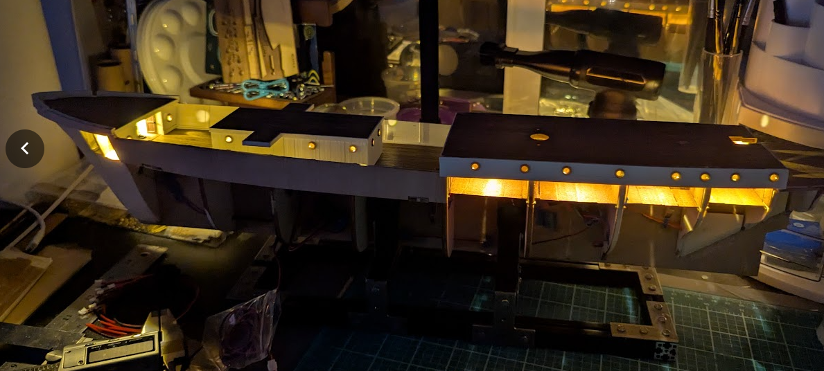

Thanks for the likes and visits! That's good info Dr PR. Thanks! I hadn't intended it to be this long between updates. It's mostly due to indecisiveness at various stages. I knew adding lighting was going to be a challenge and I had to do a lot of experimentation and rethinking. I'm finally 95% done with the lights! I built out rooms using mahogany planks I got from a doll house supply store. The wood was slightly reflective. Using white paint was too bright and this gives the impression of a finished room when seen through the porthole. This increased the luminescence just right and kept it a warm tone. I used CA to attach all the light fixtures to the ceiling. I tested every time I added a new wire. I could have soldered the wiring harness but I was worried about changing my mind repeatedly, so I got a power distribution strip and connectors. To manage the wires, I used small pieces of painters tape that I put a thin coat of CA on. The main harness started with 18 AWG wire but I took it down to 30 AWG. After getting the lower deck lights working, I had to figure out how to get power to the companion way lights without having to attach it. I found small connectors that worked perfectly. I opted to remove the walkways from the companion way and build them separately so they were more like the actual ship. Lighting test looked good: To get the main power line in, I cut a notch in the keel. My plan is to drill a hole in the bottom keel piece and then using that location for the mounting pillar. I haven't figure that part out for sure yet. Showing the wire passing through the hull planks: The final thing I needed to solve before I could plank the hull and block access to the wiring was the skylight. I thought about this one for a few days before deciding I would try and cut a hole in the deck and see if the ambient light from below would be enough to illuminate the skylight. It was not and in the end I added a specific LED. I didn't think of cutting out the middle until I'd already assembled it. That made it a little tricky. First, I had to pick a stain. After trying a few, what I liked was a mix of the Sapelli stain from OcCre and a stain called English Oak. I mixed them 50/50. Also, I didn't not like the look of the scratched plastic, so I bought some 7 mil milky white sheets off Amazon. The LED by itself was much to bright, so I build a light box to diffuse the light. I ended up using 3 layers of plastic for the light box and 2 layers for each window. Finally, for the hinge on top, I'm using a polystyrene rod. Easier to work with and takes black paint well. It's not quite finished but this is the work in progress. Dry fitting: Jewelers saw (disconnected one end and passed it though the hole). Cutting the hole in the deck was much harder. No good: Light box: That's all for now. I'm going to finish the skylight trim and do one final lighting test for starting on planking the hull. I will be adding a mast light along with port and starboard running lights. My plan for those is to feed electricity off the companion way using white 40 AWG wire. I'm hoping it is fine enough to look ok. ~Giddy~ Fair winds and following seas.
