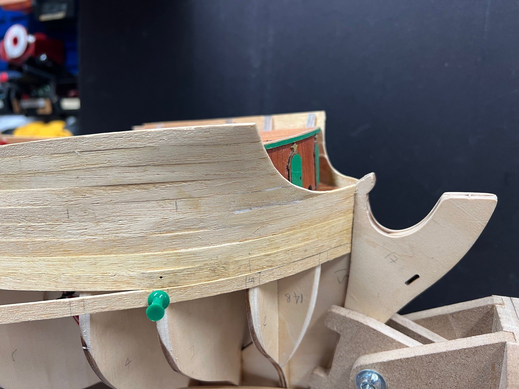

  1. Answer to lack of planks. The instructions don't say what size planks to useso I can only assume other builders used 5mm planks and not 7mm. Thinking about it, this would give a more gradual curve around the knees.

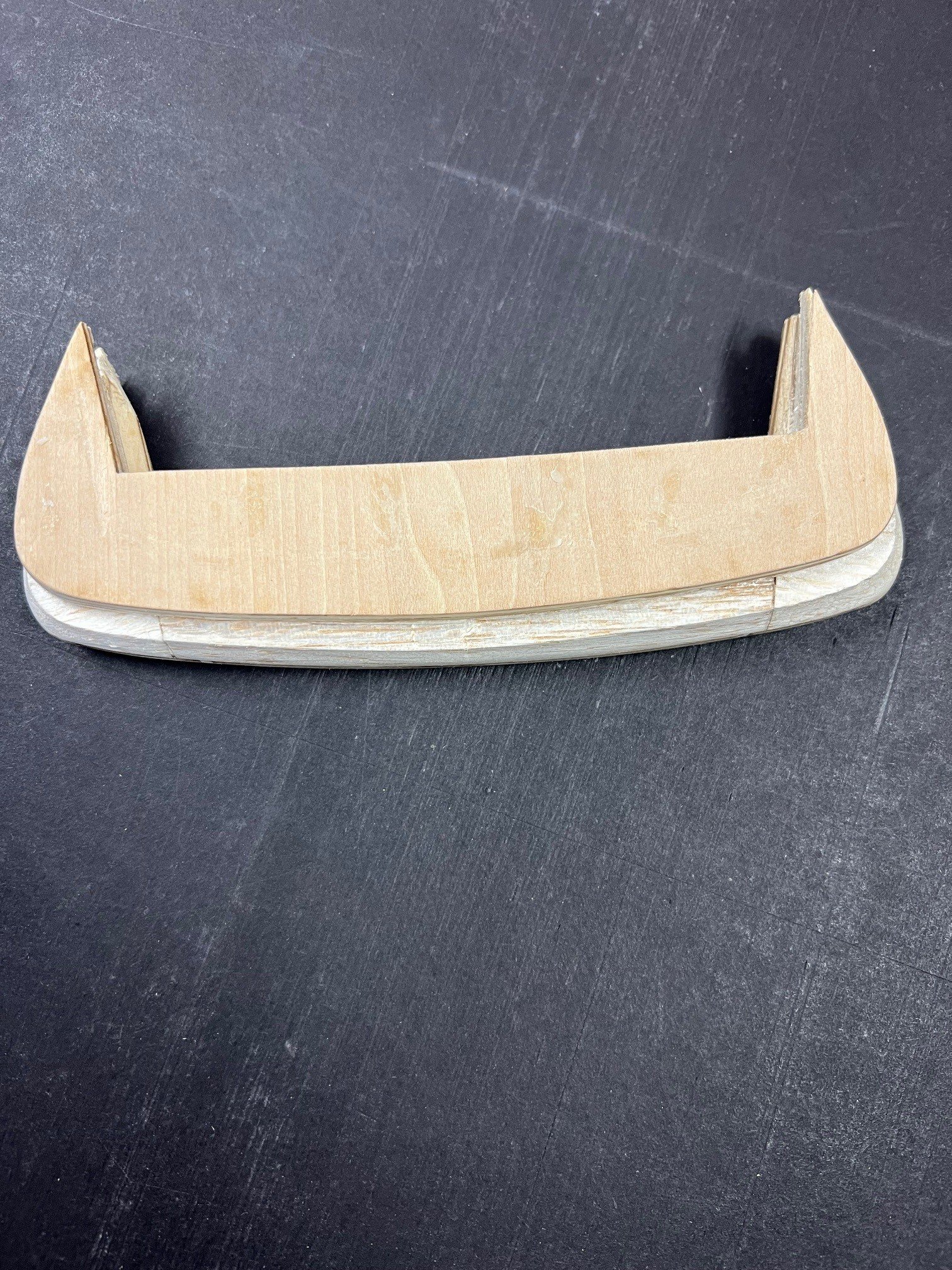

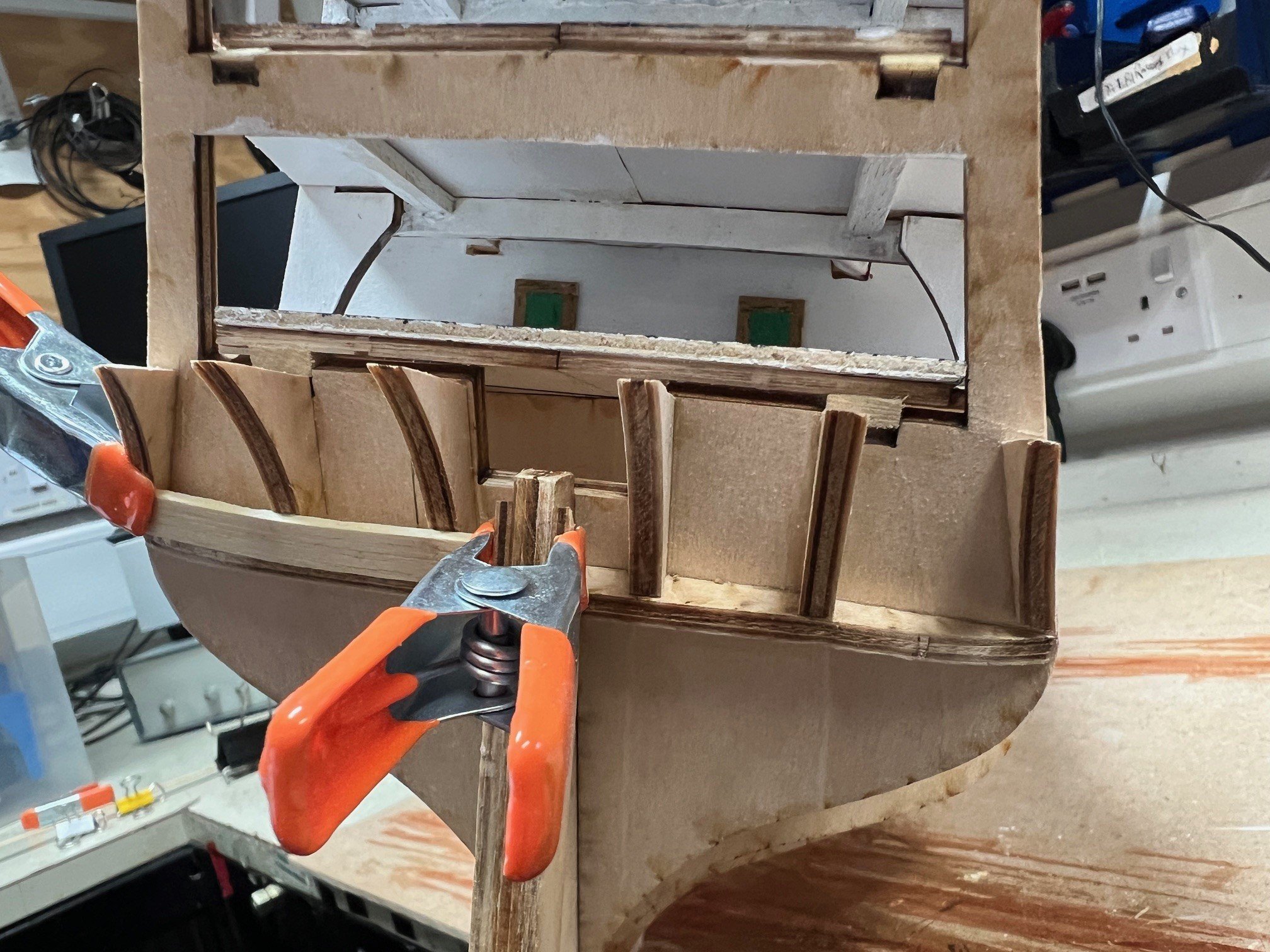

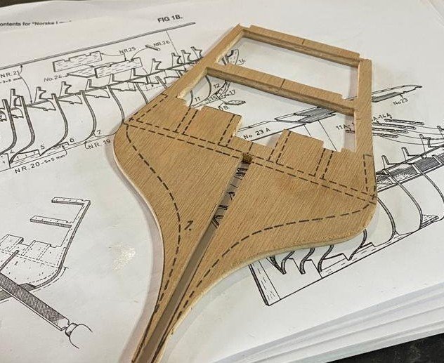

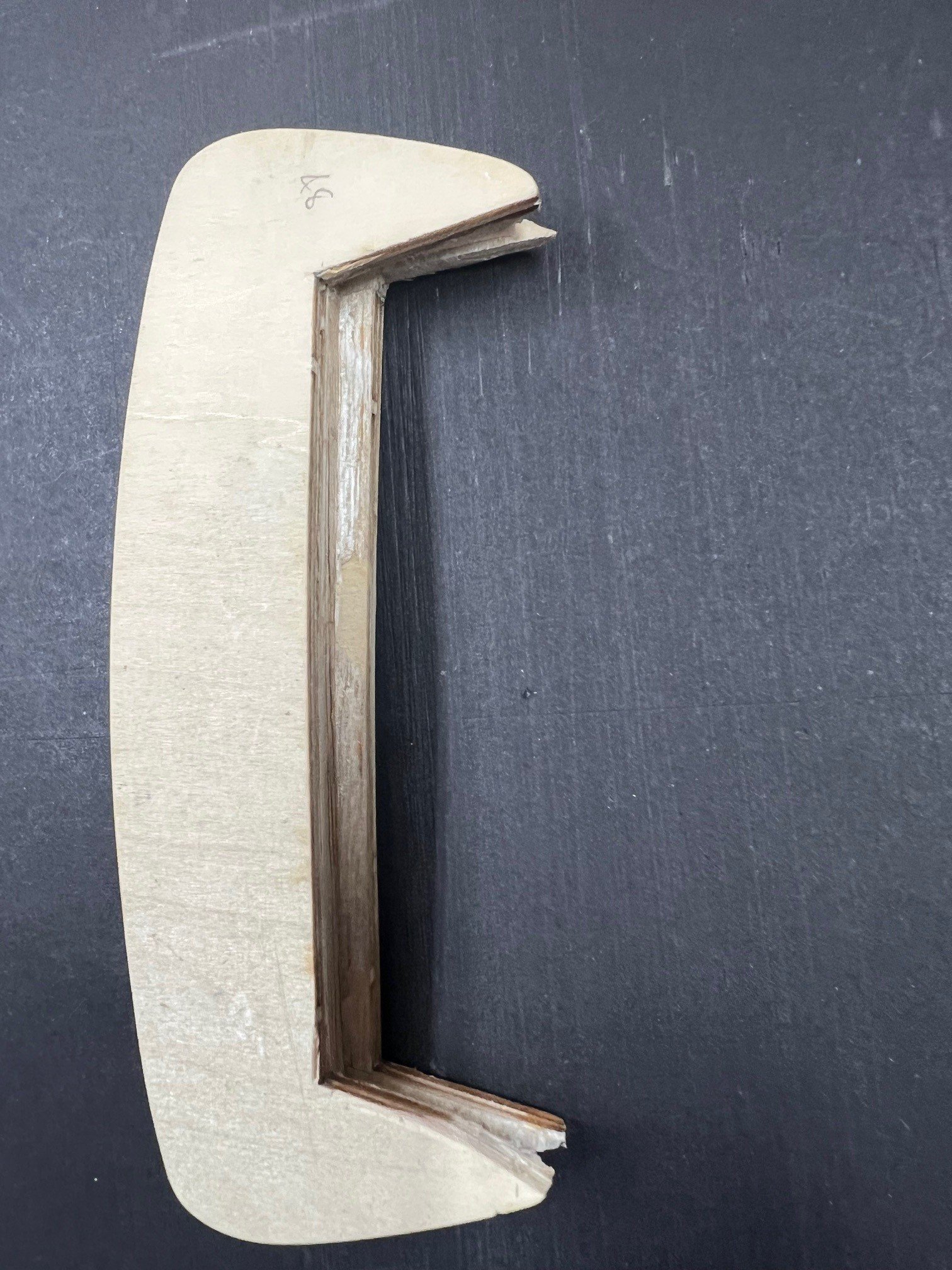

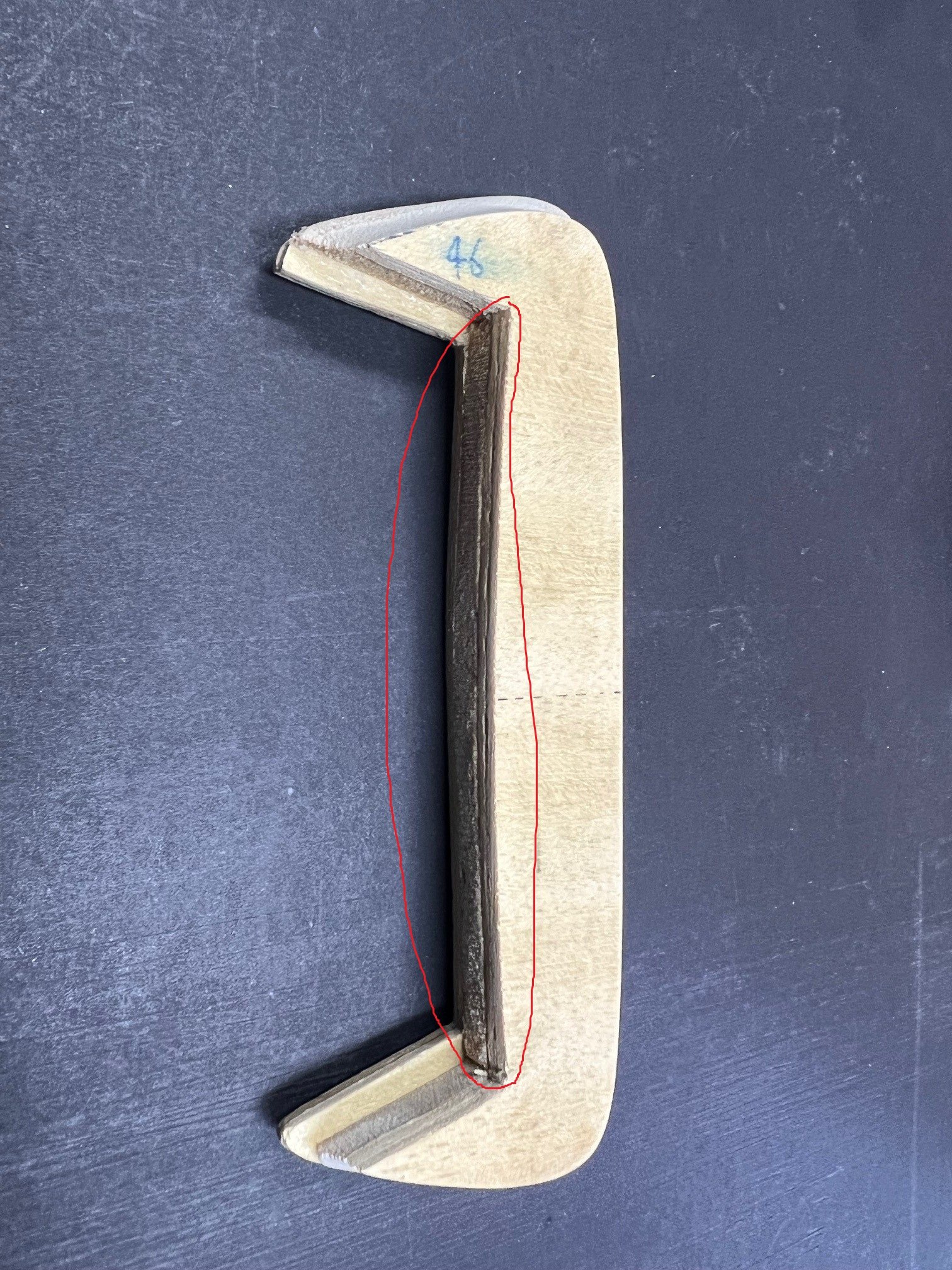

  2. I have also made an error in fitting the balsa centre #47 and top #48 flush to the back of #46. The frame #2 is angled, therefore these parts need to be offset to retain that angle. Will have to remove the whole section, take it apart and rebuild. Obvious now but damn these instructions. Before I continue and try to see where it went wrong, I will carry on with planking the hull.

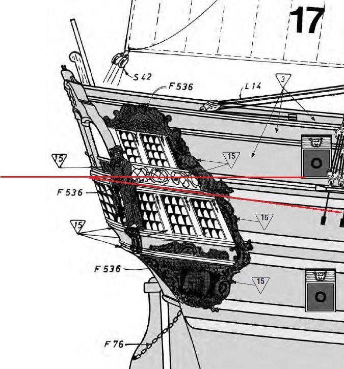

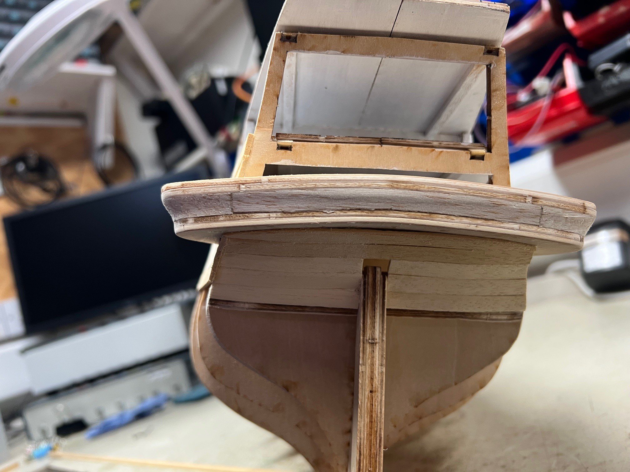

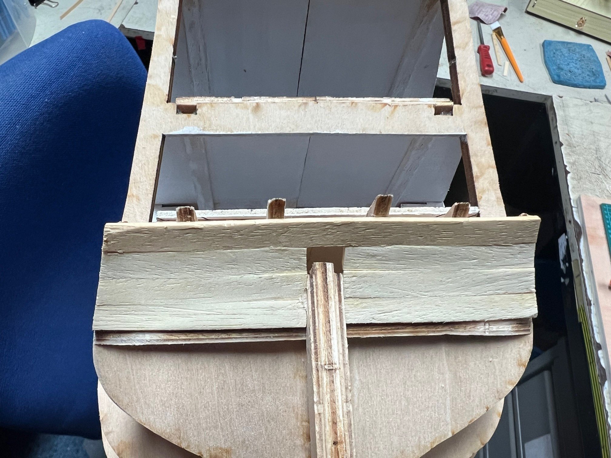

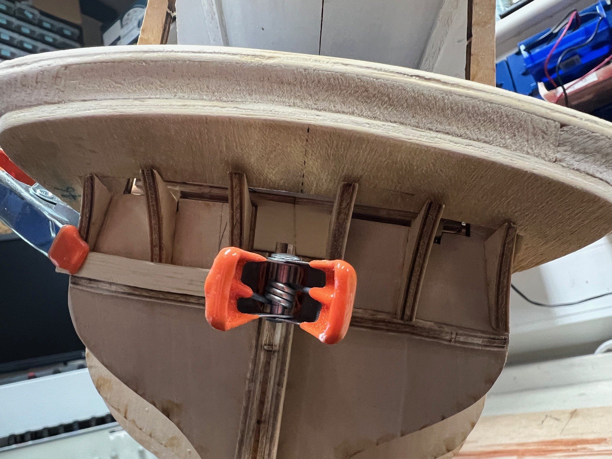

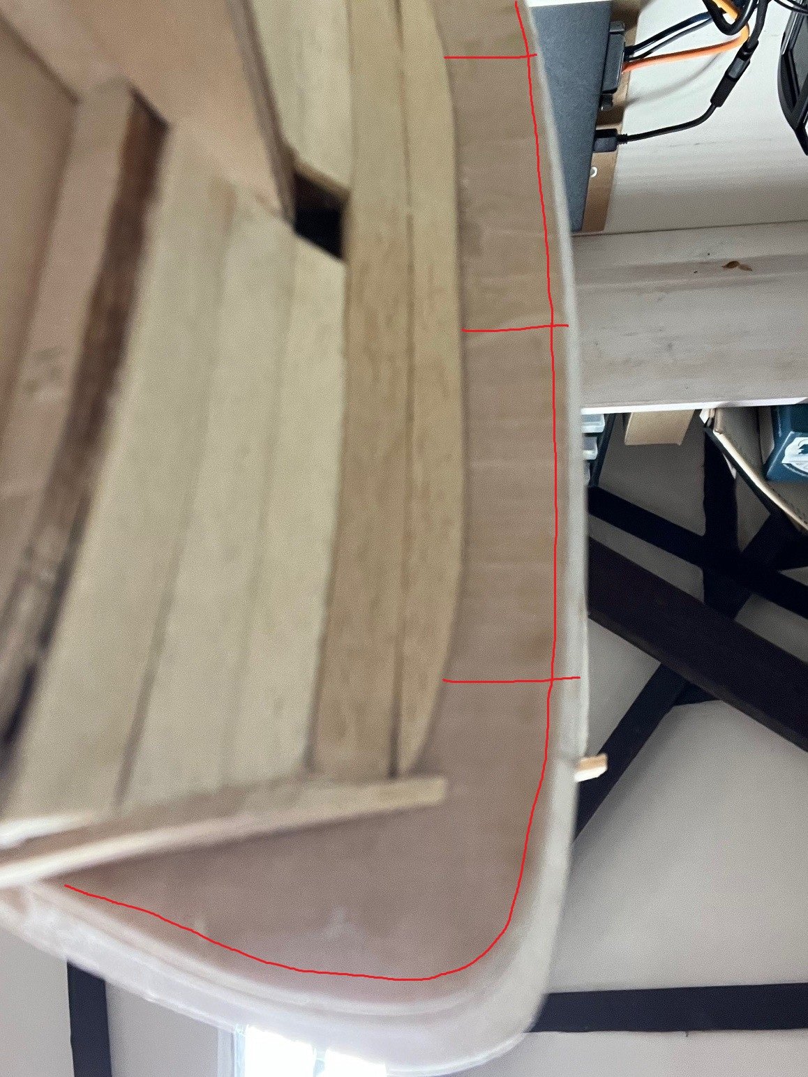

  3. Have hit a problem. The planking should meet the galley board on the edge, not 1/3rd down. By leaving it like this, I am guessing it will make fitting the window frames impossible. Looking at other build logs, there are 6 full planks and the part plank filler have been used. I only have 4 and a filler. Without starting the planking lower (which is wrong as the knees give you the start point) or adding more to the top beyond the knee edges (which will raise the board too high and make fitting the rest of the rear galley impossible), I can’t see how this can be achieved.

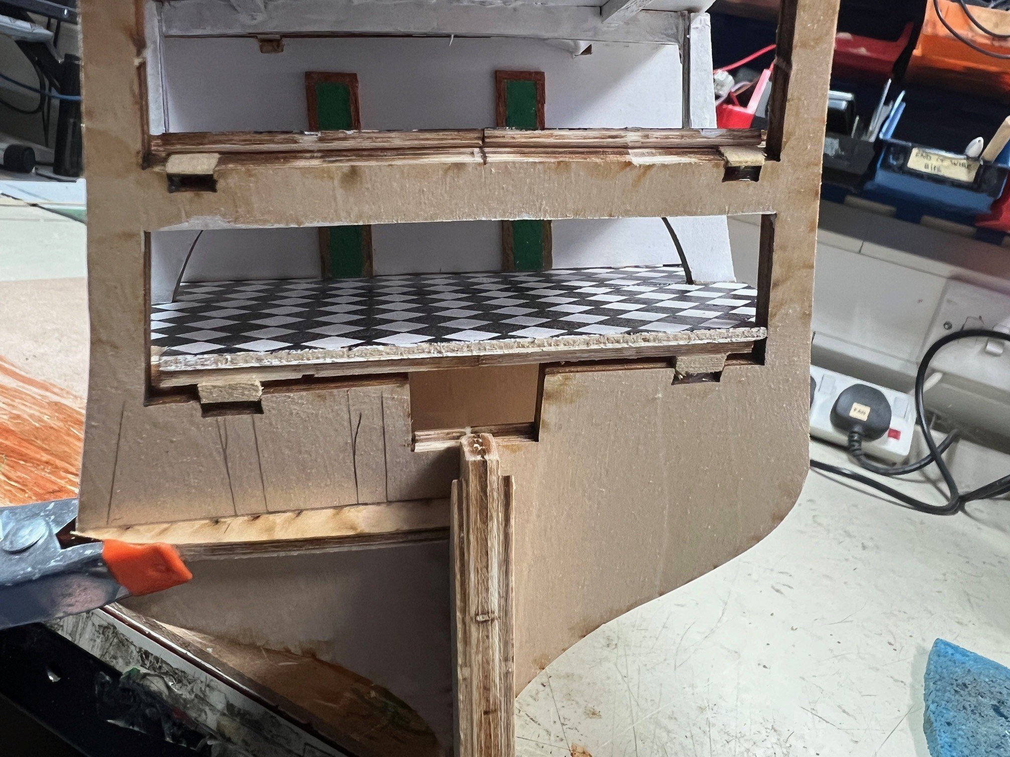

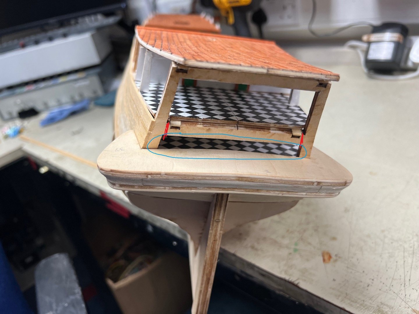

  4. Fitted the galley board to the rear and completed the planking. Shaped the last plank to meet the Galley board. Not brilliant, but should be ok with some filler and a bit of sanding. The gap through to the lower cabin is very small and as I want to light this cabin up, I may need to remove the support between the red mark. Will use a small metal rod to keep some support there.

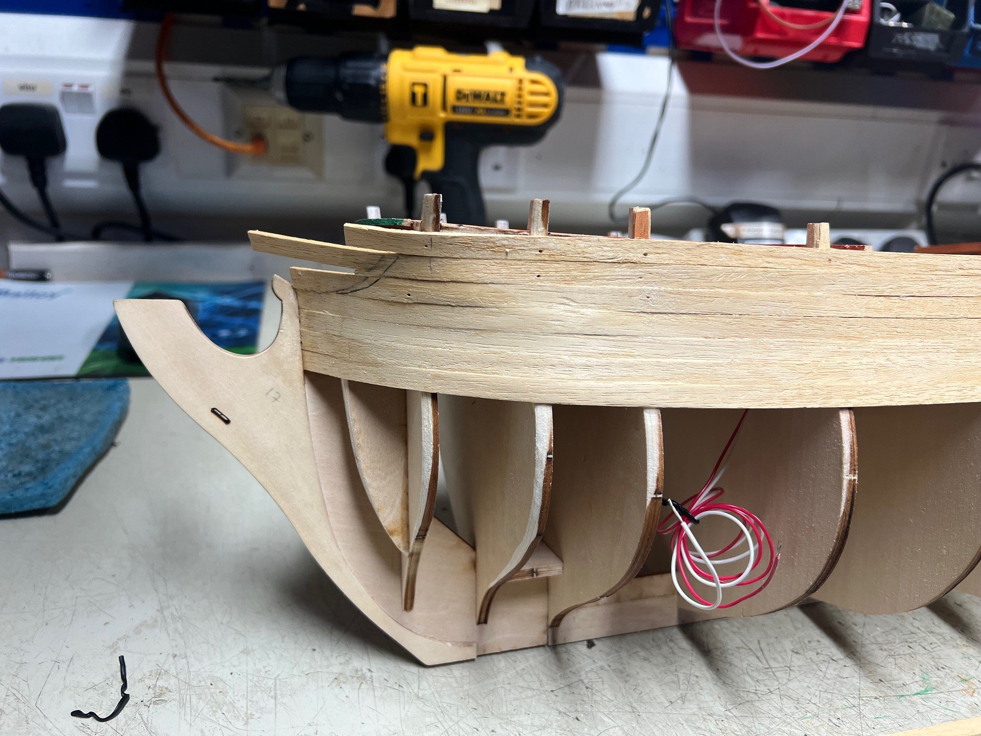

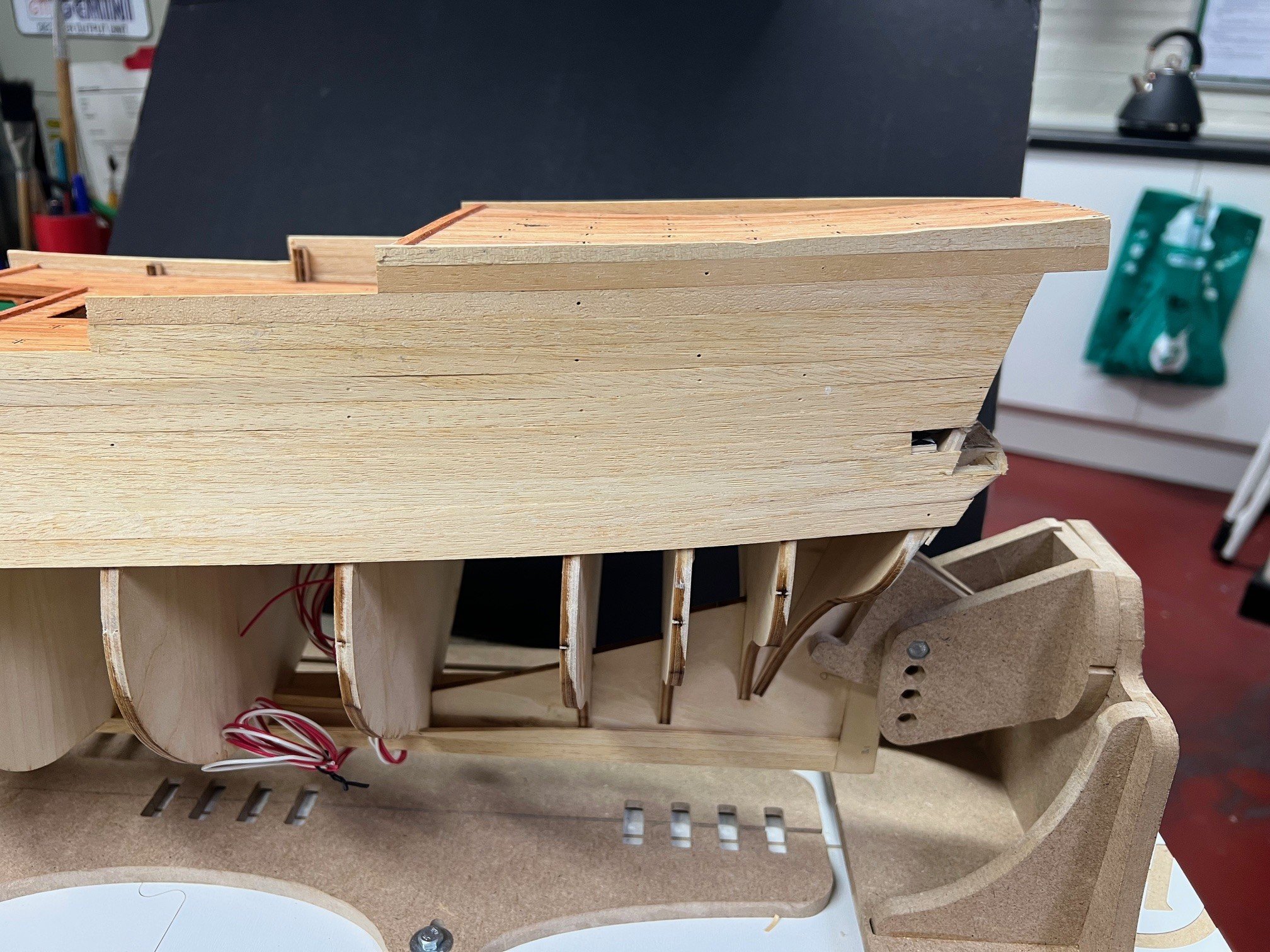

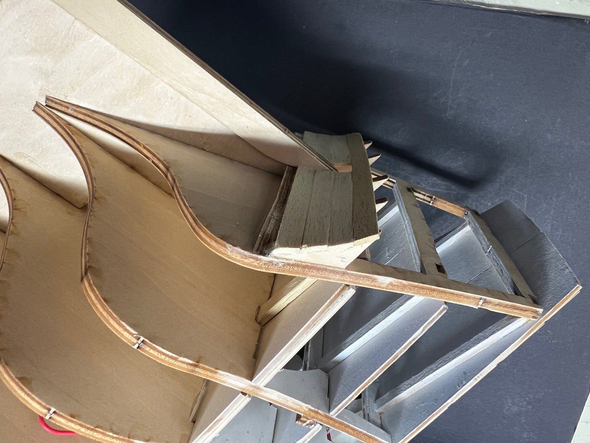

  5. Moving on to planking the hull from the lower deck upwards. Fairly straightforward but needed to bend the front section in multiple directions. Didn’t quite get it right so used a small fillet rather than over bend. Shaped the front using the template supplied in the drawings.
  6. I decided to build the bottom galley board first, #46, 47 and 48 so I could achieve the correct shape for this and the knees. I used the parts from the original kit just in case I made an error. Once happy with the angles, added the back planking except for the last top piece. This needs to be shaped so it meets with the underside of the gallery board so will wait until I am ready to fix these parts permanently.

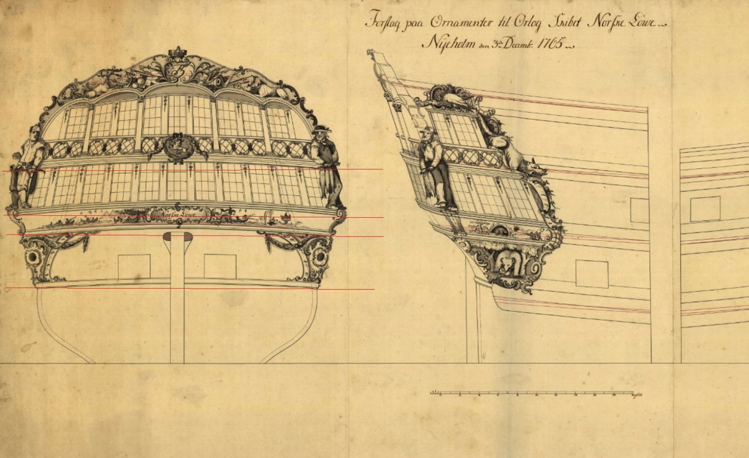

  7. Rear Gallery. This is highlighting my inexperience with these type of kits but in my defence, the supplied instructions are sadly lacking any real detail. This part seems to have caused others problems in the past so I am going to go into a little more detail with this to assist others who follow. Apologies if this is too deep for a build log and should be shown / discussed elsewhere on the site. Referring to EdS build and PeteB’s help, the gallery is not flat but curved (window frames #54 and 56 give you the correct curves required). Not only does this apply to the gallery boards and windows, but seems it also applies to #31 the support former. See picture 028b, the lowest red line. Courtesy of PeteB. Rather than try to bend and shape this, it’s 4mm thick, I plan to put a curve on #114 to achieve a visual bend. But…..on the earlier kit I have, there are dotted lines on former #1 indicating where the knees are fixed. This intimates that #31 is straight and not bent. See picture 028d. If this is the case, parts 27, 28 and 29 do not give the correct upward curve. In fact they give you downward curve. As a result, you need to shape and adjust these parts to give you the required upward curve. I also fixed #27 to the far edge of the former which will give solid fix for the hull and gallery planks at this meeting point.

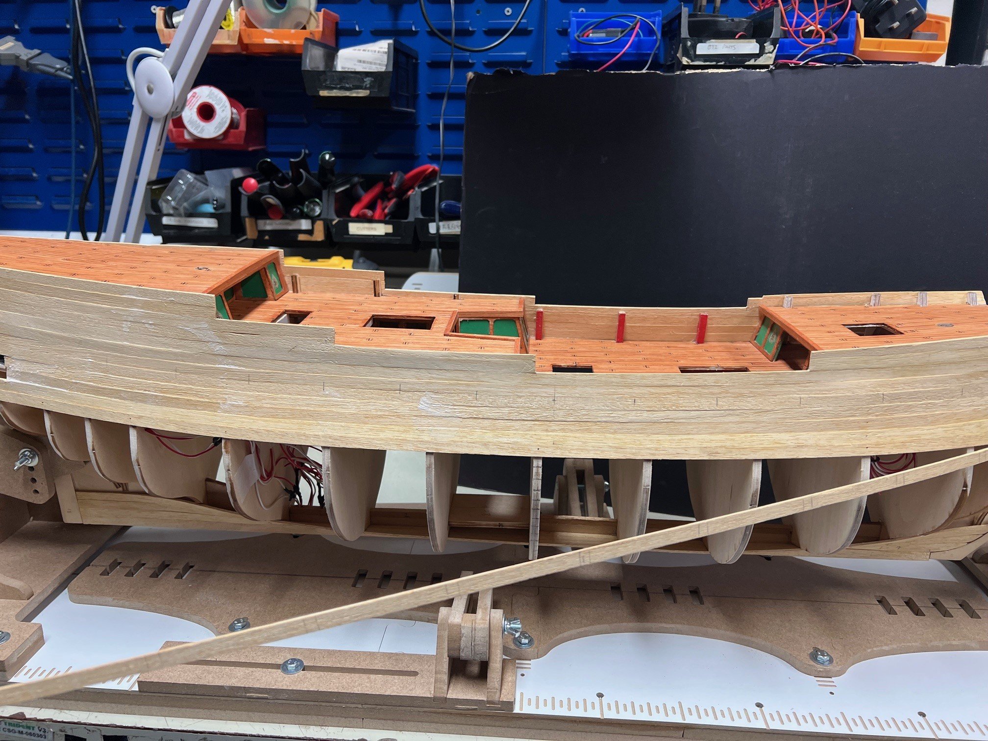

  10. All planking now complete along with both gangways #45 (placed but not yet attached). Also completed deck edges which have been faced using the same deck plank strips.
  11. Also built the hatch covers and a couple of ladders. Used large 3mm hole hatches as that will allow better viewing and light from the LED’s. Went for black to give a bit of contrast to the mahogany deck. Made a little jig for the ladders to keep them straight and stained them dark oak.

  15. Planking well under way but need to order some more supplies. Made up two more bulkheads. 1 for the Quarterdeck cabin and one to go under front deck. Not sure how far back this will go and if I want side bulkheads. Hoping to add another LED and open 3 cannon ports but on checking the plans, 2 of the ports protrude into the frames. Not sure moving the ports is going to work as they will be out of line with the others and look like a dogs dinner. Back to the original build to see what can be done. Will also see if I can open up the rear cabins in anyway by removing some planking behind the stern gallery.

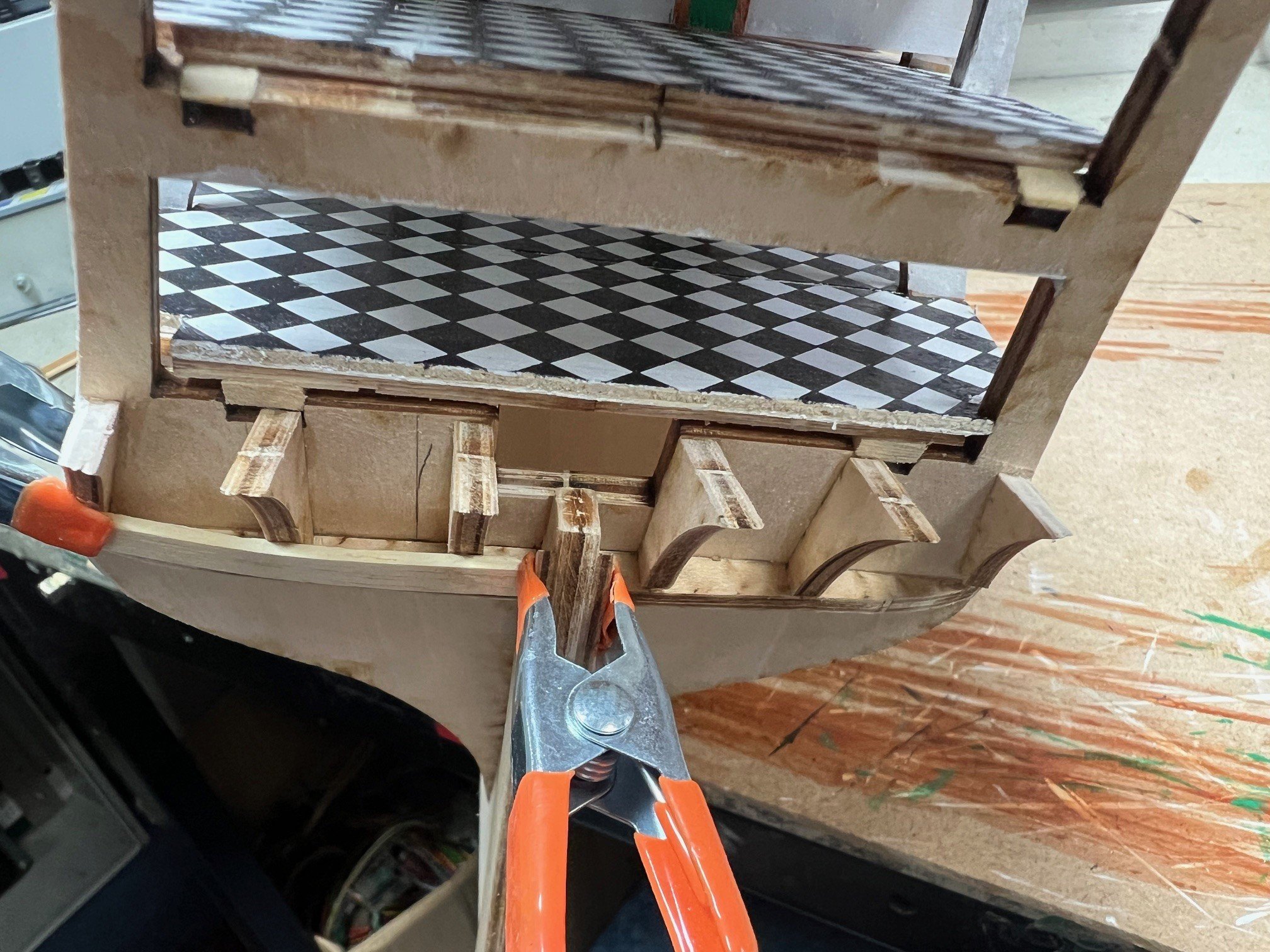

  16. Next up, the quarterdeck. Attached a back bulkhead to the lower deck cabin and checked it fitted before fixing. As with the lower deck, it was slightly out but after a little filing, all was good. Glued and nailed in place which is when I realised the deck didn’t quite reach the end of the rear frame #1. Added floor diamonds and started preparing the planking.

  18. As Ed stated in his build of this ship, not sure how much of the rear cabins are going to be visible so went for black and white diamonds. Cheated a bit on this. Painted the white base then marked the lines with pencil. Overdrew them with the Staedtler and inked them in. Did find some vinyl dolls house flooring which was the exact size I wanted but decided I would get more satisfaction from doing it the other method. I am hoping to open up light into the cabins if I can later in the build so in hopes that I can, I have added LED lighting under the cabin roof.

  22. Cut distance strips (#20) using 1:1 plan. Attached frames starting with #7. Worked forward and then aft using distance strips and double-checking plans for spacings. Unsure what angle frame #1 should be. Using the plan, it seems to touch the bottom edge of #2.
