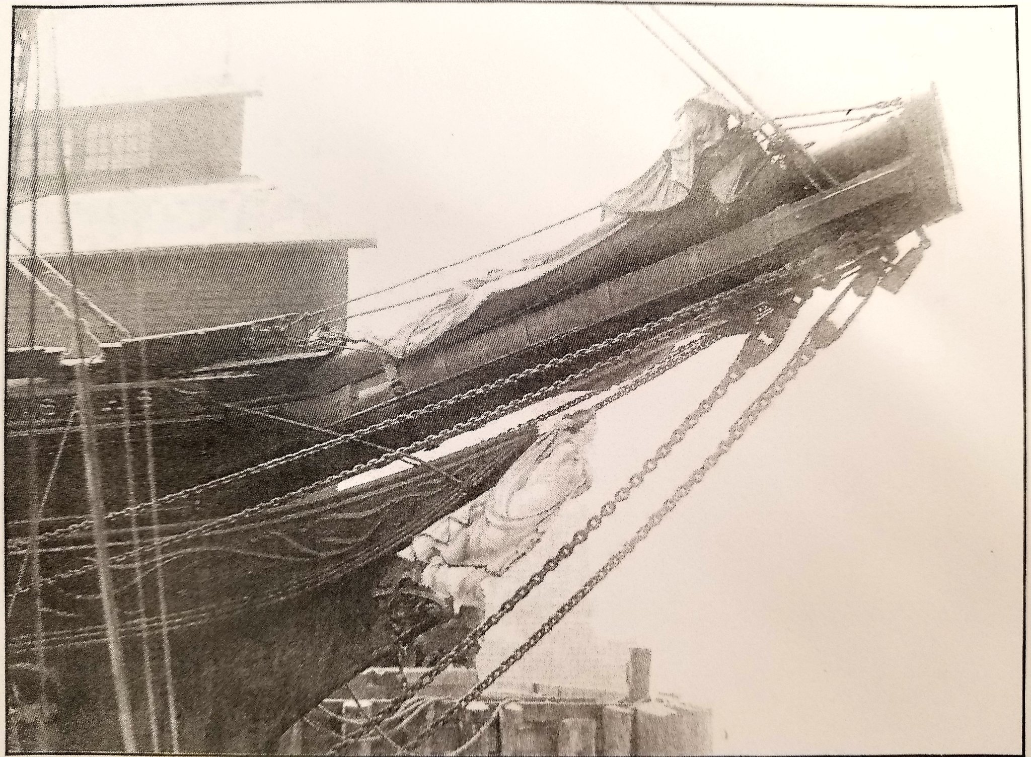

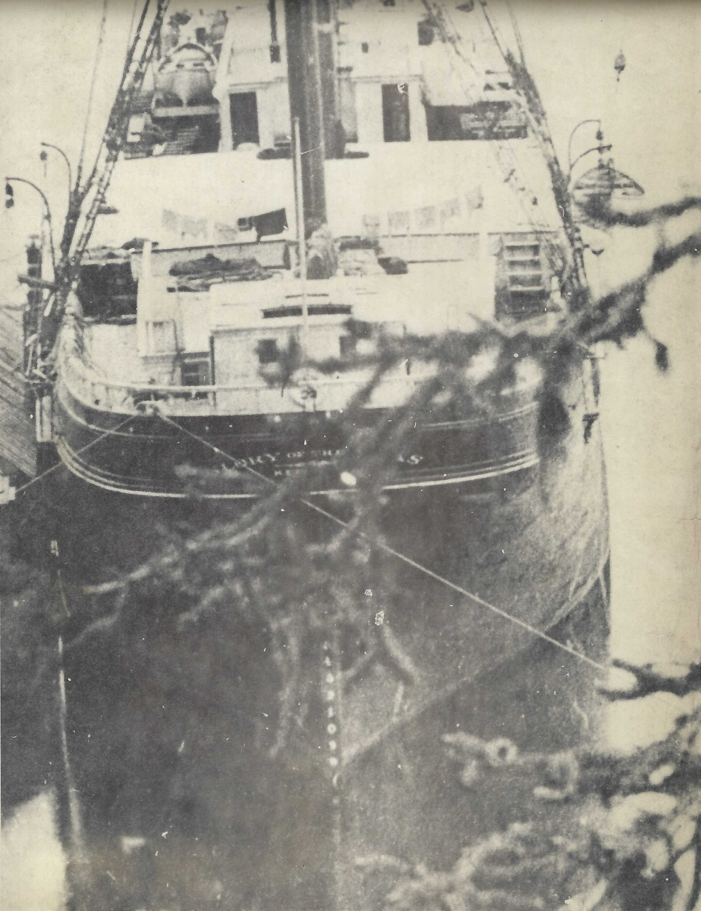

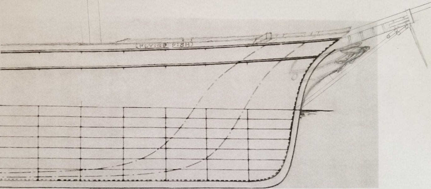

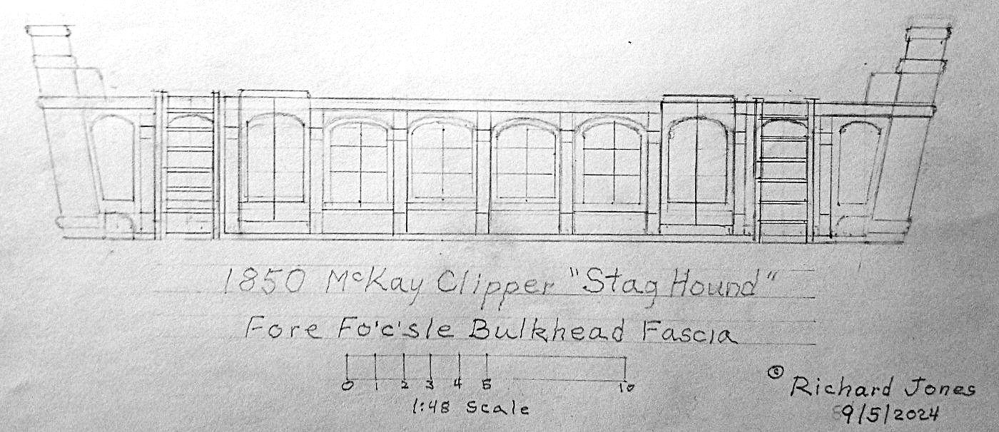

@Michael Collins I was asked to, as it were add my 2c to this conversation regarding what @rwiederrich and I now refer to as the unique McKay bow construction. Reading the in-depth Boston Daily Atlas write ups by Duncan McLean (a Scottish sailor and friend of Donald McKay) led me to discover that compared to his historic descriptions, not one of our modern McKay clipper ship models are accurate! That's because the only part of a prow they model is a bare stem. Both the cutwater extension of the stem and twin navel hoods which overlay and protect the cutwater have consistently been left off. Photographic proof of these very rugged devices are now clearly evident in multiple, crystal clear images of McKay's final clipper Glory of the Seas. In a way, Donald McKay has been so successful in hiding his secretive prow that he's become a victim of his own jealously guarded secret. From the beginning, in his first description of the vessel Stag Hound, McLean mentions a cutwater and hood ends but it's easy to overlook. However, in his write up of the famous clipper Flying Cloud McLean gets more descriptive and for the first time refers to these devices as navel hoods. To be clear, these prow extensions are nothing like naval hoods which essentially protected anchor hawse holes before advent of iron rings. Rob and I have concluded that since this unique McKay prow design was present in his premier extreme clipper and is clearly visible on his final medium clipper that this was a practice he incorporated in all of his clippers. One exception was his 4 decked 4 masted clipper-bark Great Republic. It stands to reason, since she had an entire additional deck, her height made need of the navel hoods unnecessary. I've attached all 4 pages of the Boston Daily Atlas which brings up another issue that model plans have gotten wrong. Main rail height of 4'6" on Flying Fish was one of the lowest for a McKay clipper. This required accommodations for a watch of the crew to be arranged below deck. This is actually described in the Boston Daily Atlas article. It describes 2 companions in the wings of the forecastle, leading to quarters below where there are 2 water closets (WCs) ahead of the stairs. These quarters are described as lofty, well-lit and ventilated. Since the height of the forecastle deck was set at the main rail height, that means the underside of the fore deck would have been just under 4'3".... little more than a crawl space. This means the windlass also would have been mounted below. The forecastle bulkhead would have been fully enclosed with windows, similar to those seen on the aft coach house, as illustrated in the Buttersworth piece.  In the order I attached images: first 4 are the McLean article, then is an actual tracing of Flying Fish from a museum in Norway, my scale overlay of how McKay's original bow would appear, a more realistic ornate flying fish figurehead, then 2 historic scenes of Glory of the Seas, 3 details of the Buttersworth work. Note: the coach house front facade is more ornate then plans treat this area which is consistent with photos we have of this coach house, the prow in the artwork is more pronounced than the bare stem in the plan and finally is my reconstruction of the Stag Hound forecastle also attached for reference. We also know for a fact that the aft coach house narrows to match the outer hull, the rear coach house companion is offset to port and lubbers holes are much larger than plans show.

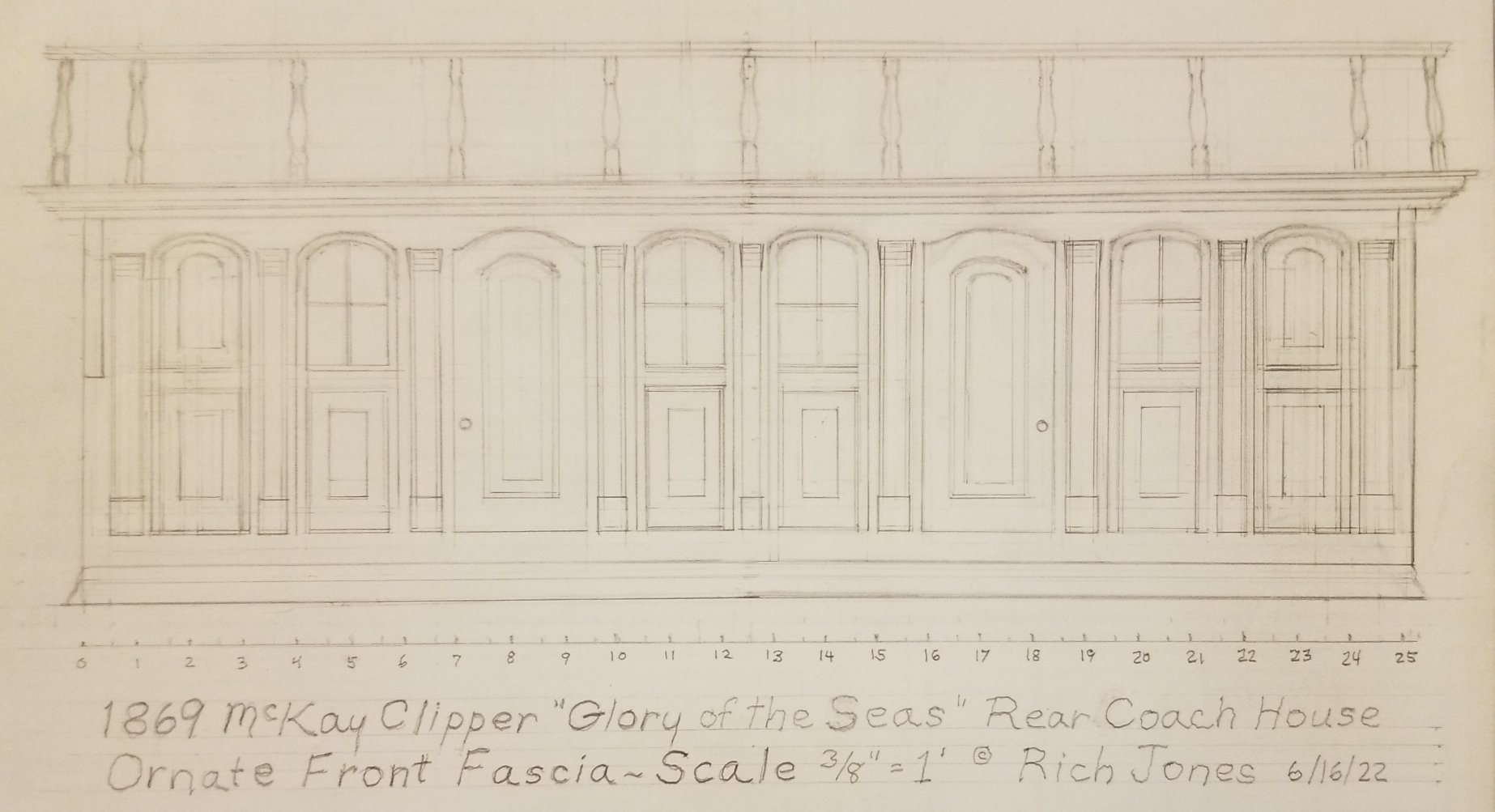

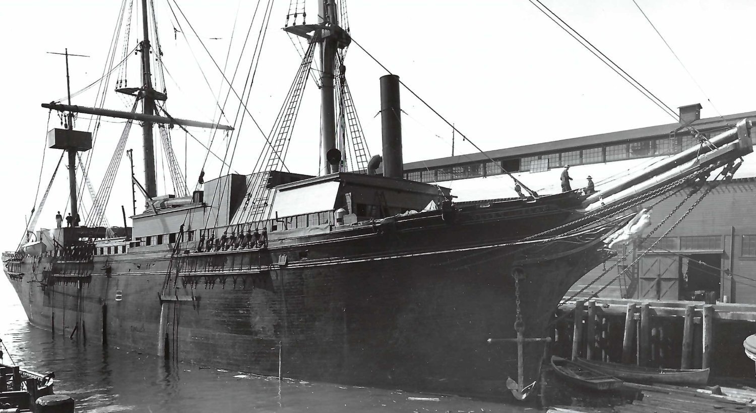

Wow! Impressed by the knowledge is an understatement. As shown in great detail the hood of the Glory of the Seas. There is ample photographic proof that this is how she looked after working for years. No room for dispute. I had wondered about some glitz on the bow of the Fish. Plain - but that's all I could find and...... Not like you're hiding bling on one of the Prima Donnas of the ocean.  Cover up trade secrets?
I like the interpretation of the extended prow and hood.  Bad enough when you try to find the truth and it's hush-hushed 174 years ago. Kidding.

@Michael Collins reconstructing Glory of the Seas was an incredibly informative experience. We couldn't have possibly proceeded as far as we did without the invaluable contributions of our spiritual mentor, author Michael Mjelde. I particularly feel like McKay's well documented final clipper is "the Rosetta Stone" for all of his clippers. I have more accuracy for his clipper Sovereign of the Seas too. The Currier print is a copy of this beautiful Buttersworth piece located at the Old State House Museum, Boston, MA. The original framed image is from Wikipedia, 2nd is my corrected one, 3rd is an unframed one, 4th is the only copy of a hand drawn plan of the clipper Lightning by Donald McKay himself. Note: open space at the bow where her cutwater and navel hoods would be. As I said before, all models of Sovereign of the Seas are also inaccurate, for more than one reason. Butterworth's and the Currier print both repeat the same mistake. There's no way the merman's tail would extend horizontally across a vessel's bow like this. 6th, I did a conceptual sketch showing how Neptune's real figurehead's tail would have more likely followed her cutwater extension with the upper torso being attached to the navel hood above. The other major error involves a misinterpretation of the size of her rear coach house. It's ridiculously small. In reality, the coach house occupied the entire rear poop deck, narrowing like the one on Glory of the Seas did, leaving 5' walkways on both sides with sufficient space aft for working the ship. Spurling gets this area right, including a safety rail that surrounded the roof with a rear companion offset to port. A 5th image from Wikipedia has a port stern broadside of her. Her rigging now reflects conversion to Howes split lower and upper topsails.

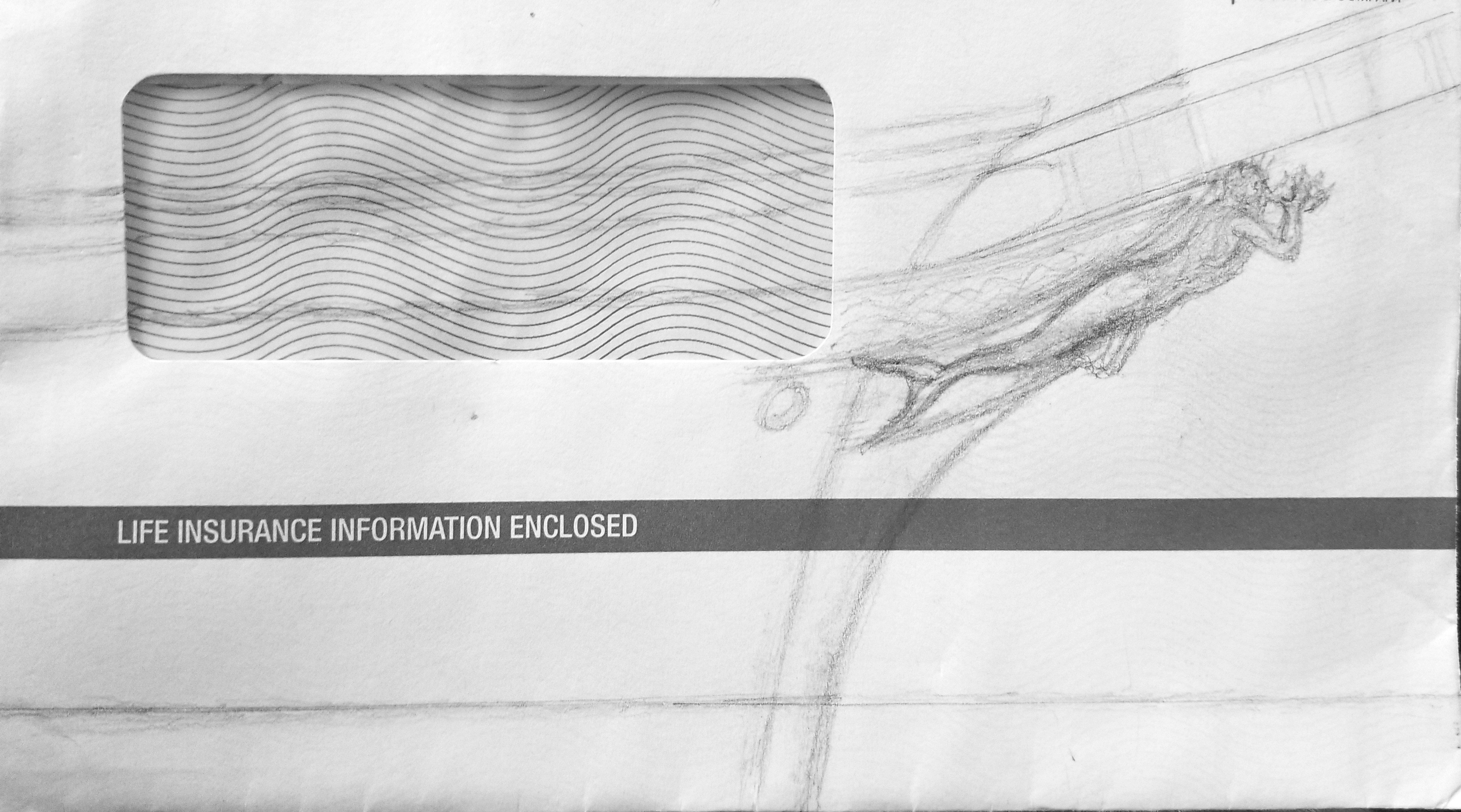

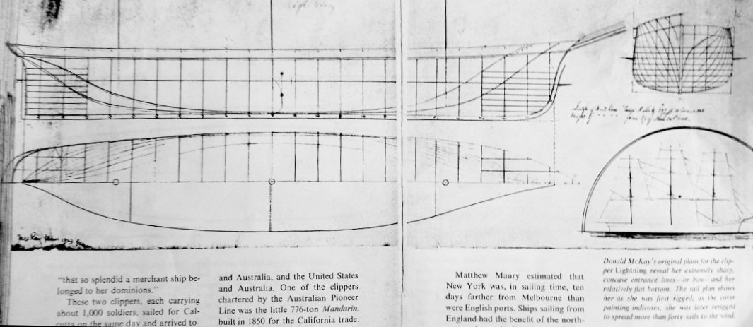

Your presentation is customarily informative Rich.   Getting folks to realize that McKay's final clipper embodies the entirety of his clipper design.  Apart from her hull proportions and deadrise....the bow/cutwater/hood ingenious design was a common structural feature On all of McKay's clippers. The initial statement of Duncan McLean declaring that Staghound(McKay's first clipper) exhibited a unique design feature never before seen on such models and was a precedent setter.     McKay never included this feature on any of his design drawings to protect it from being copied.   Every other clipper made...by every other designer/builder...lacked this unique structure(Hood).
