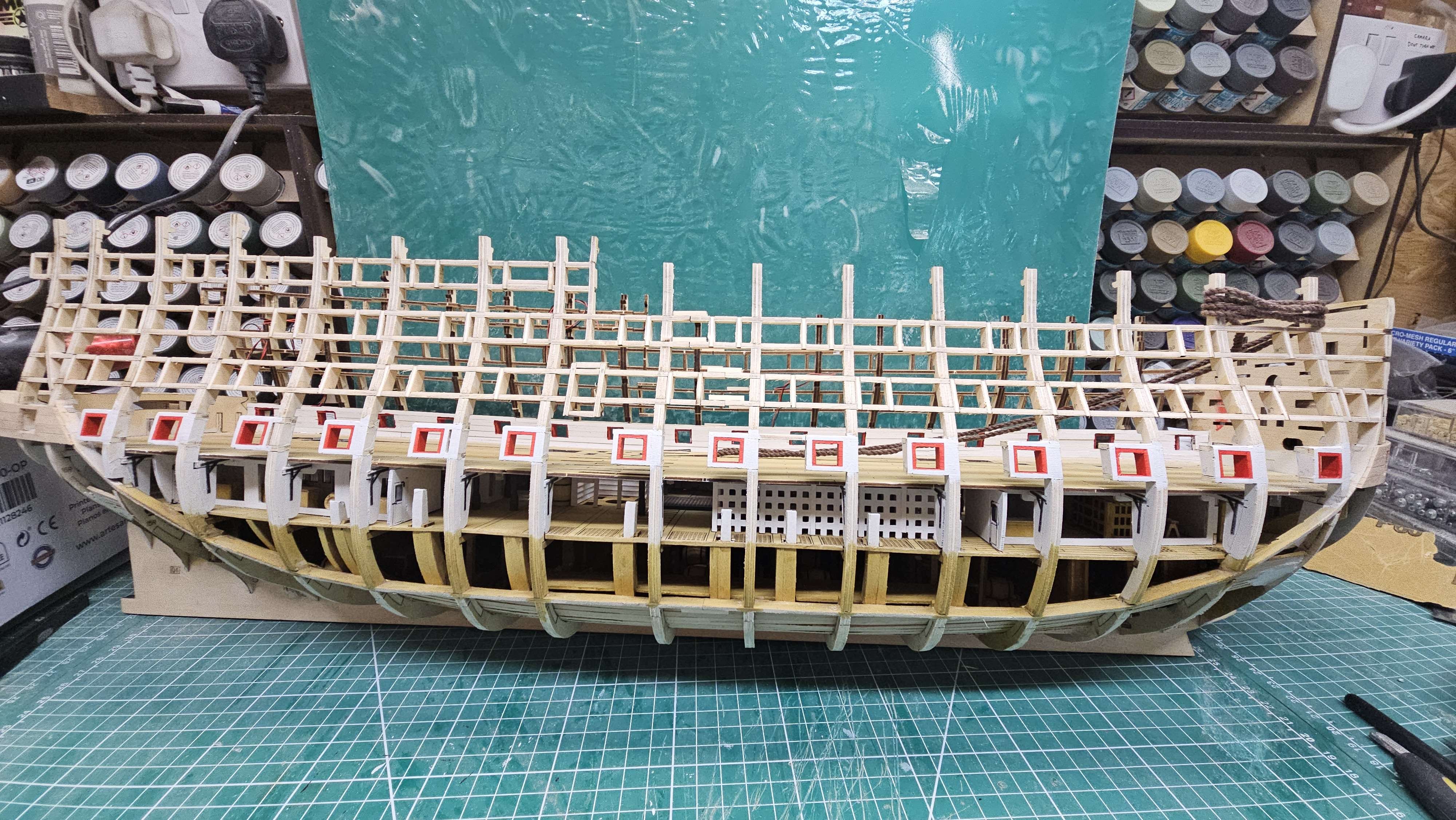

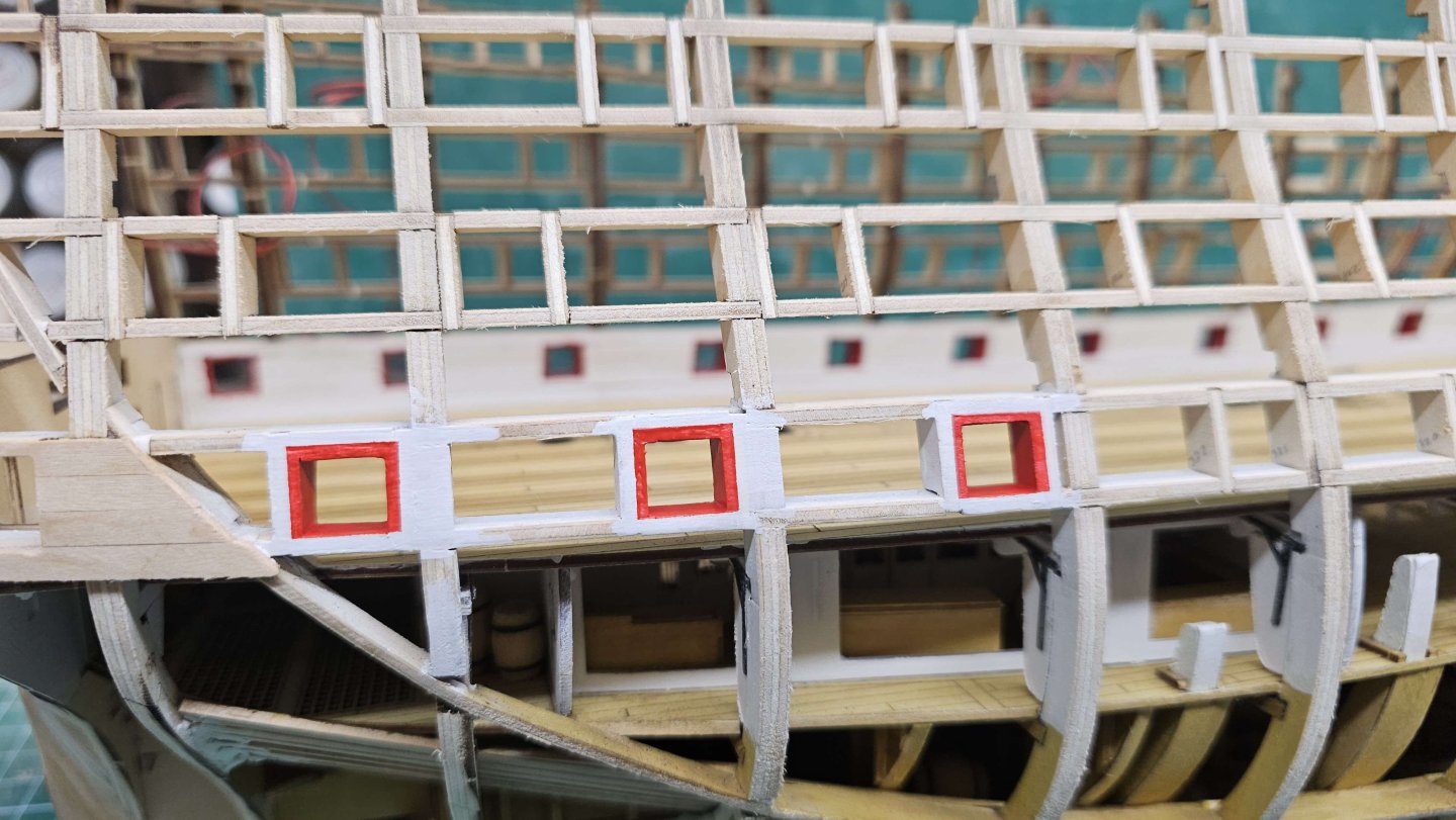

  1. Video #17 Complete Lining of the gun ports is done. Not the neatest works, insides were difficult to paint due to access, but by the time it's finished will be very difficult to see.

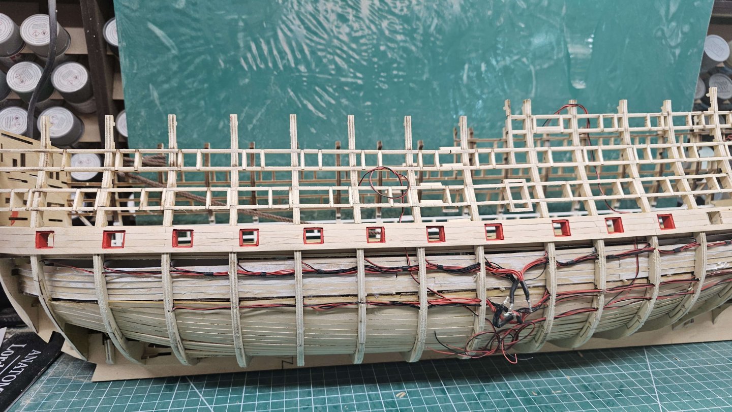

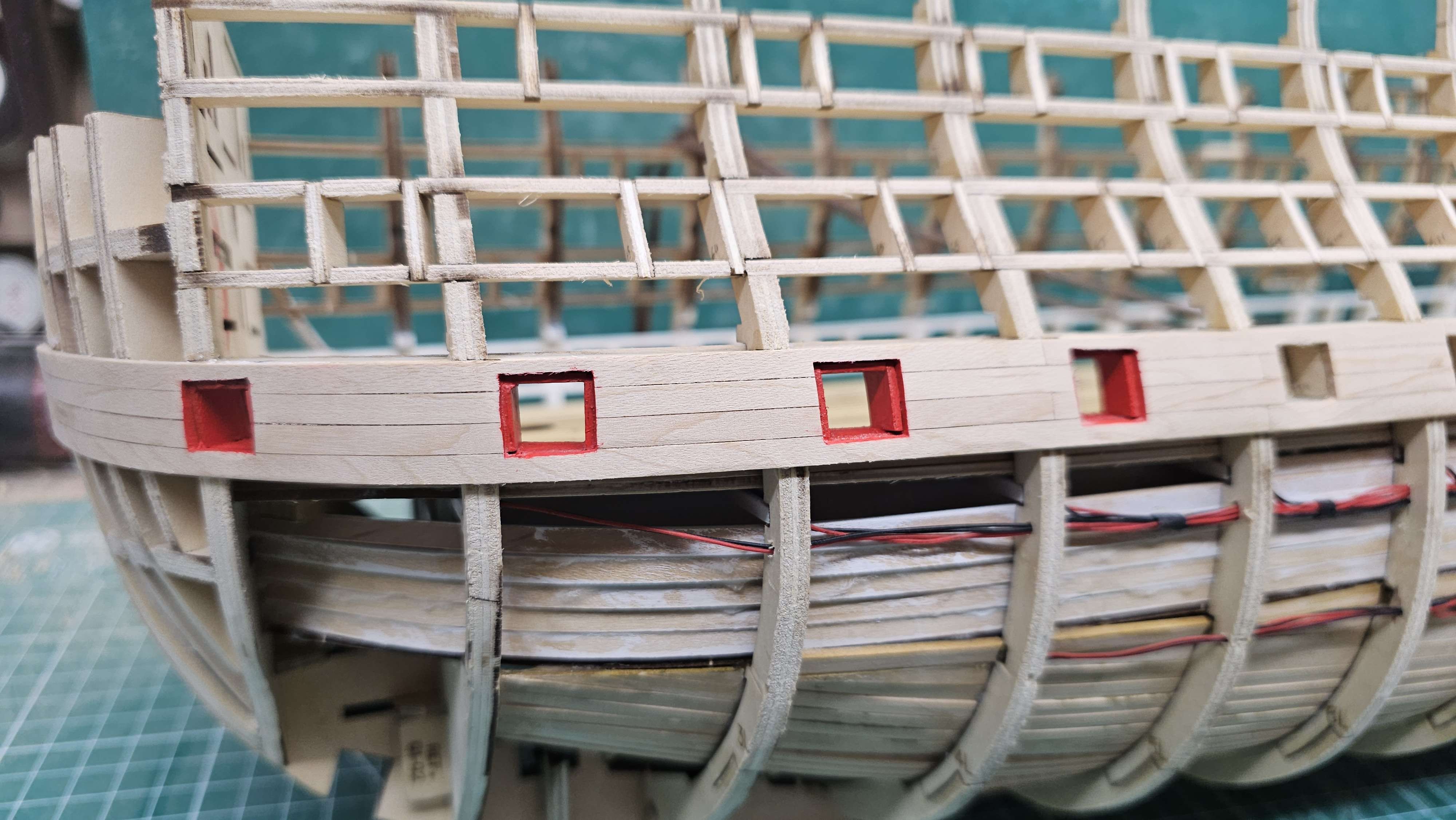

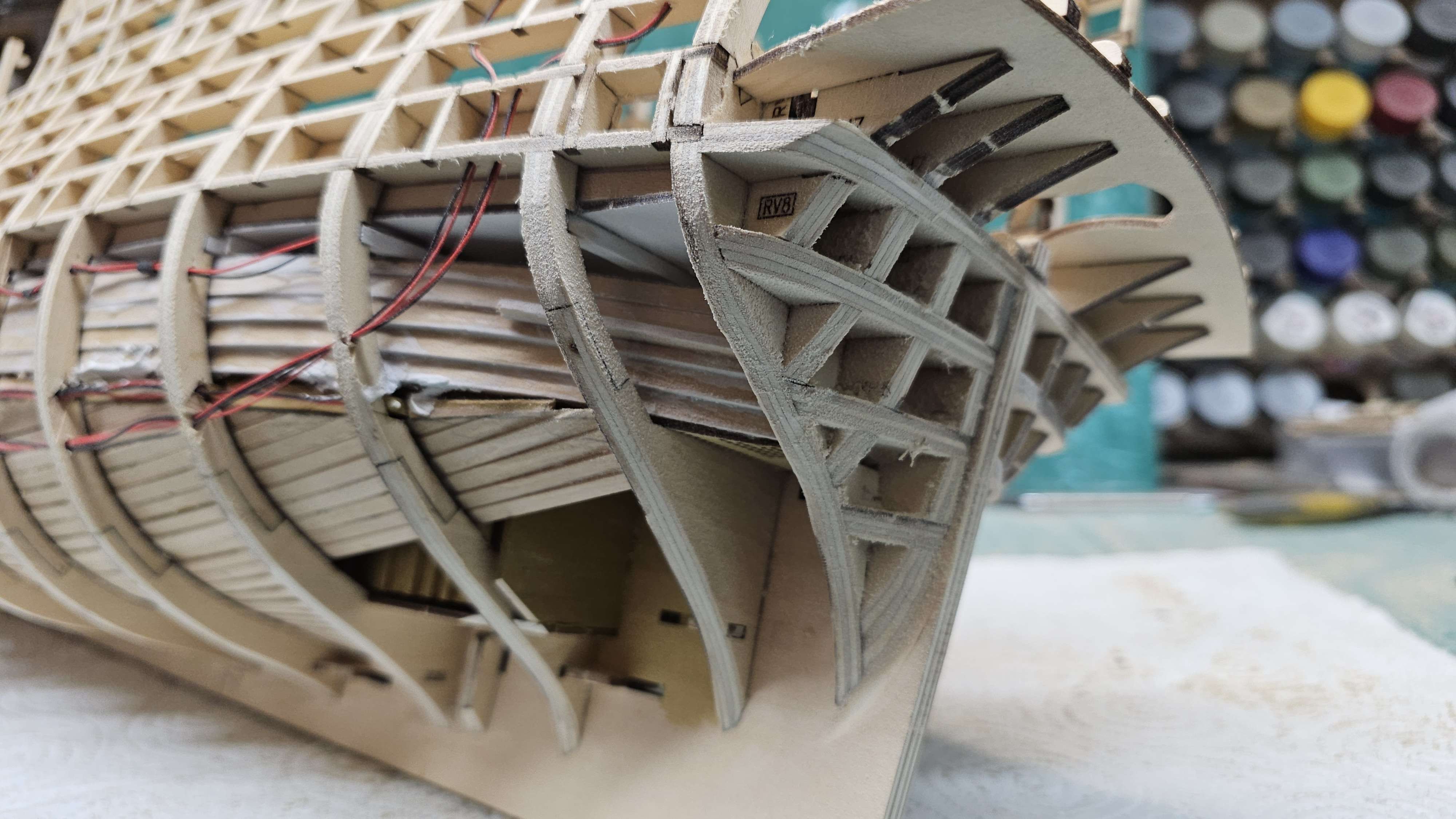

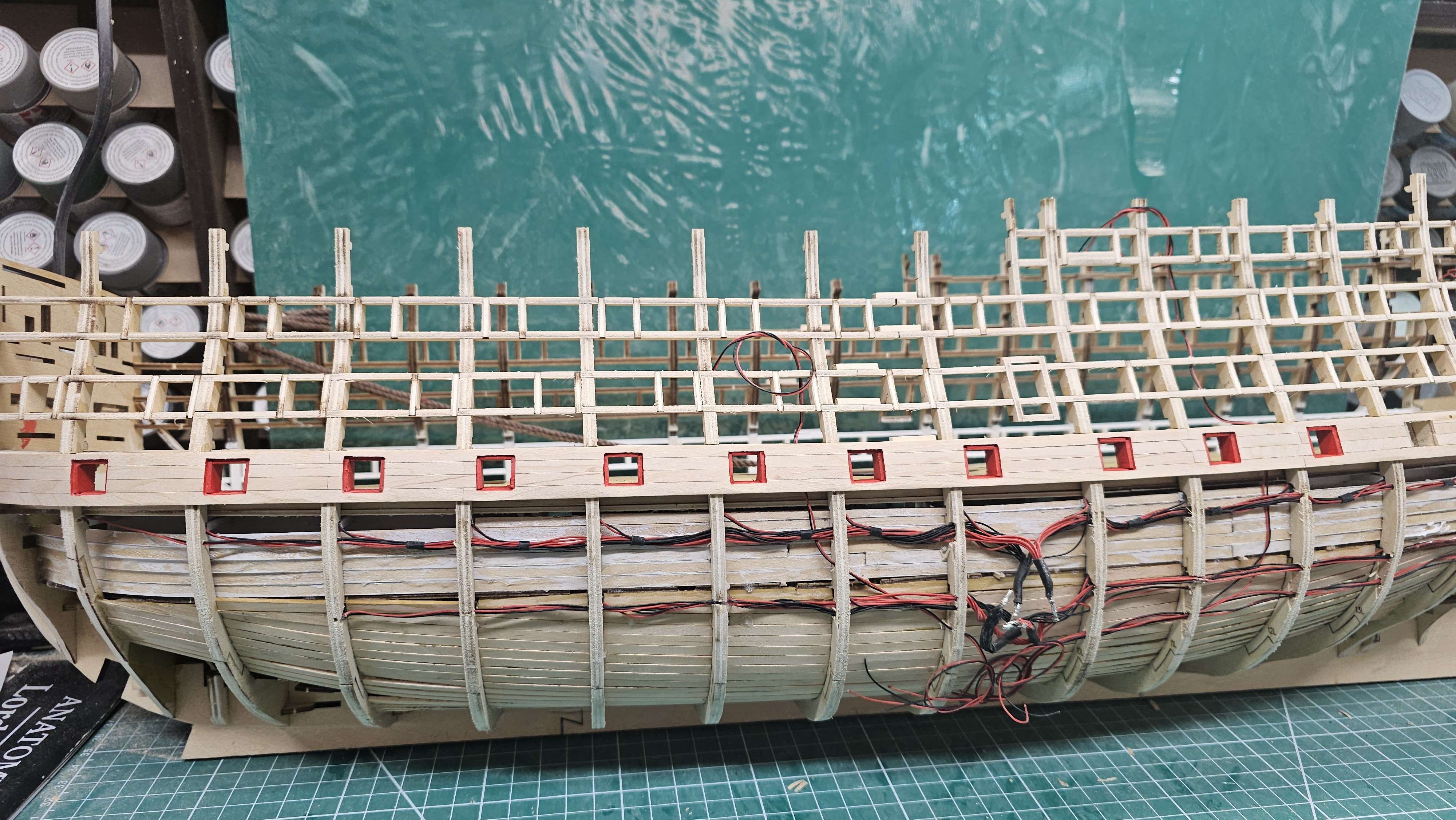

  2. Video #16 Complete Hull frames are now faired ready for planking. Was probably the easiest one I've done to date. I used an orbital mouse sander to do the bulk of the work, and switched to a Dremel with the EZ-Clic sanding disc for the stern area and anywhere close to the keel. Then the first 4 layers of hull planking on each side. The wood supplied is amazingly pliable. I've not had to use a single plank bending method anywhere on this build yet.

  5. Because unlike most builds there is no internal structure to support or add strength to the ribs.
  6. I have the same concern. I really dislike working on any internals prior to fairing the ribs, but with this build it's unavoidable. Any dust ingress I will probably deal with via my airbrush after fairing is finished. Dealing with any after sanding the planking is going to be a bit trickier...
