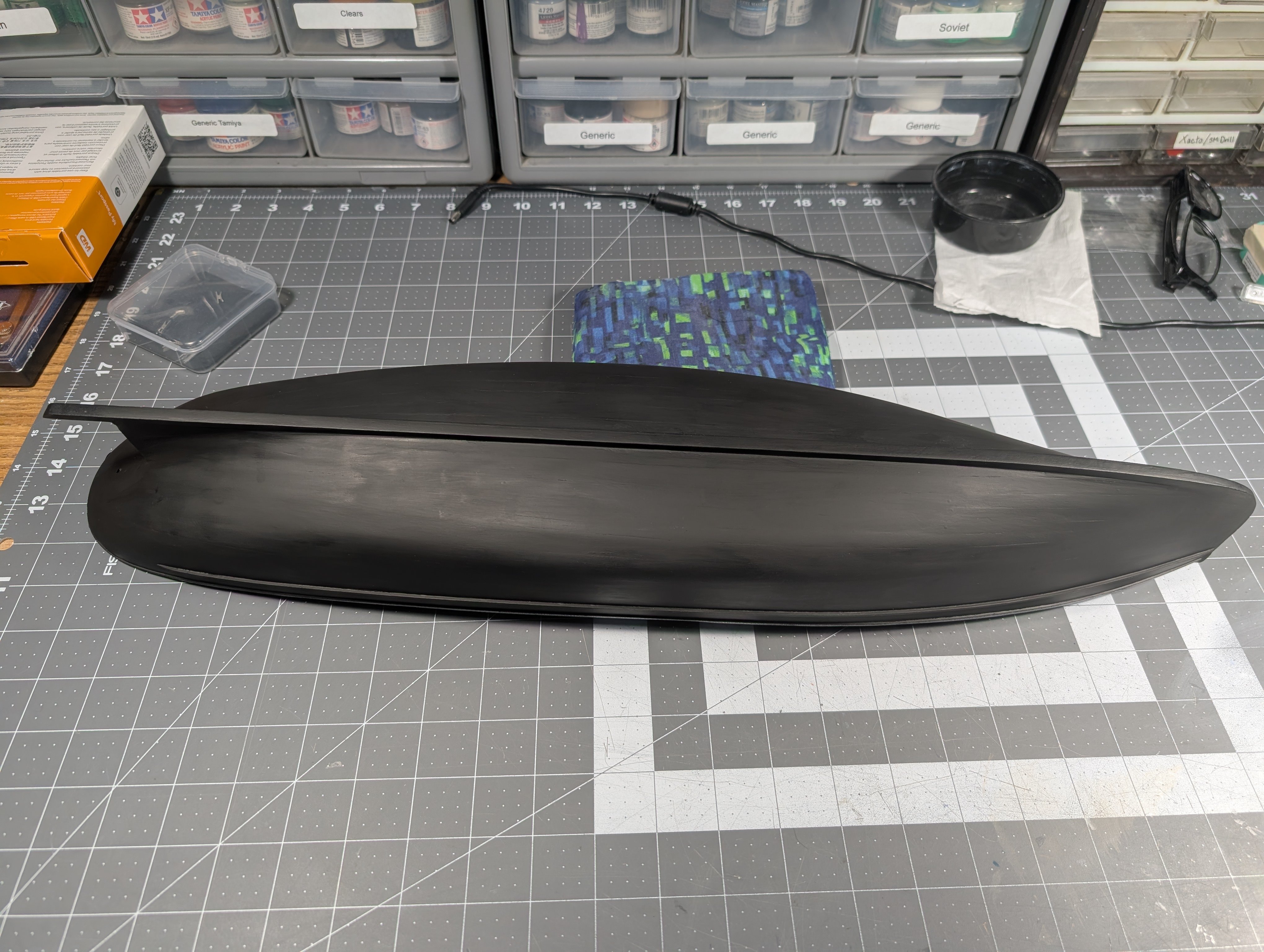

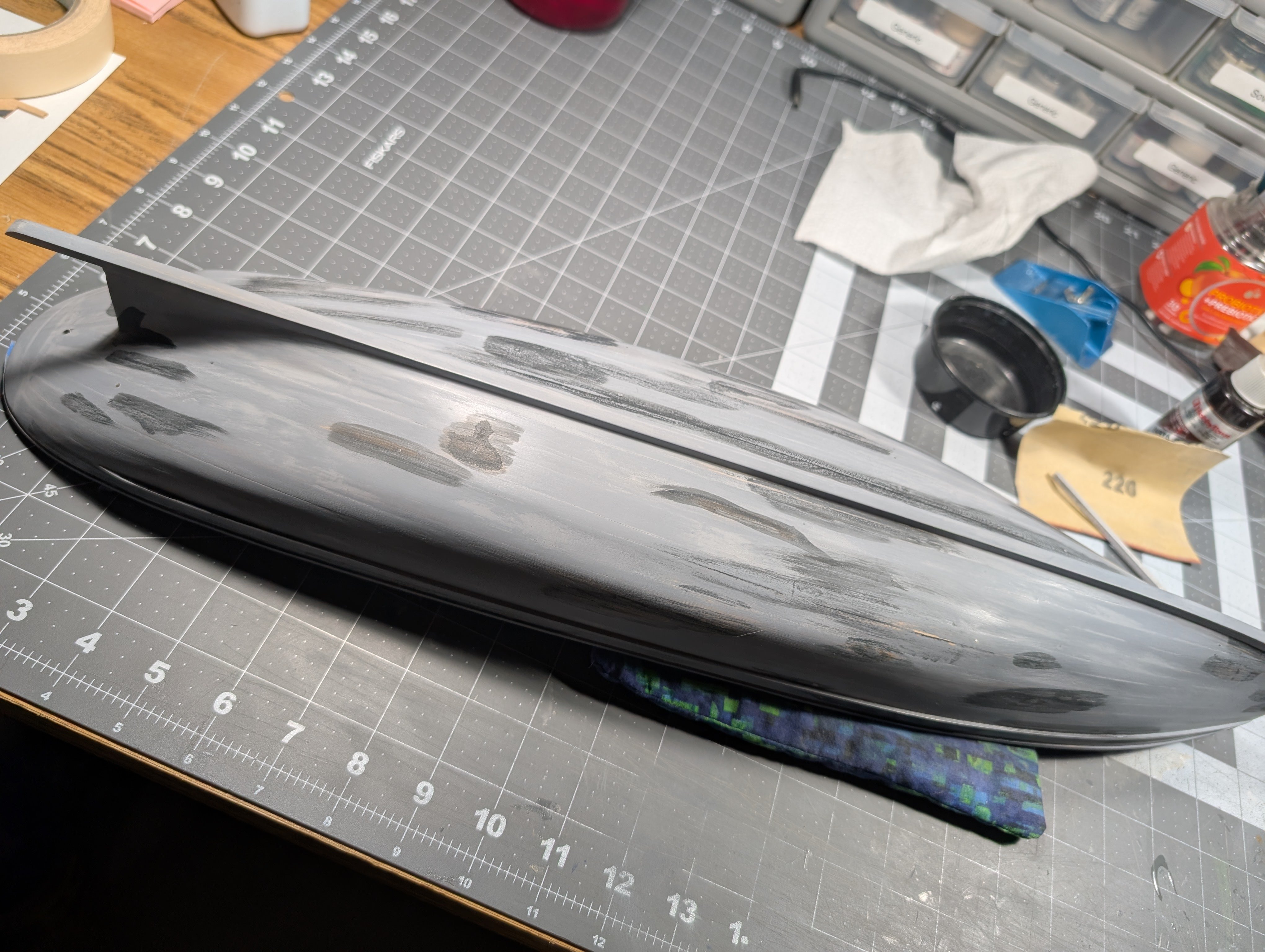

Quick update that got me through painting of the hull. First I completed touch up of the stain and Grey on the inside. Highly recommend folks write down what color paint they used before they out it away and have to find it later. Then we primed the hull then filled the low spots and sanded down the high spots. Primed again and repeated the process. I haven't done much other work for the moment but I have done some of the pot metal items seam clean up.

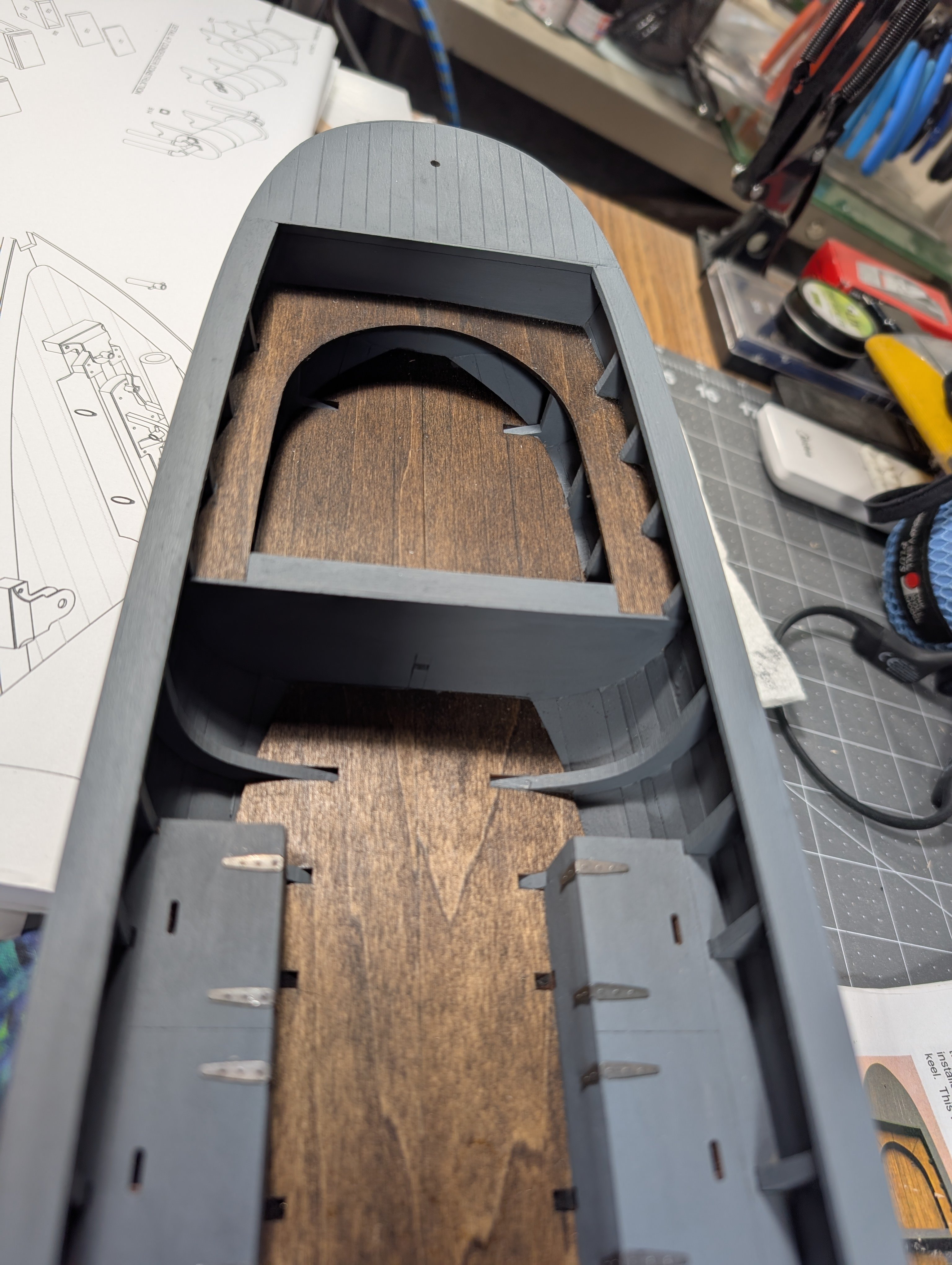

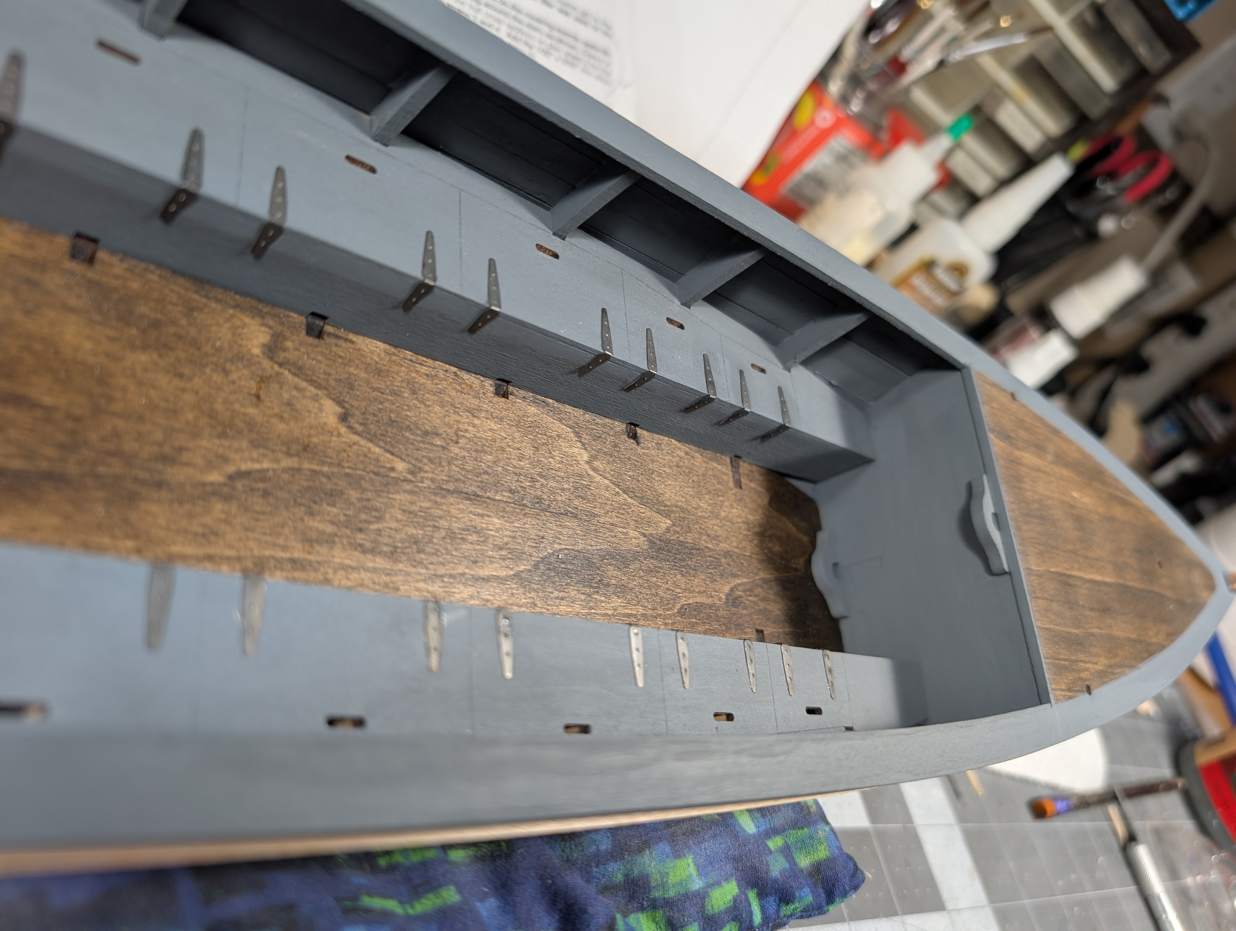

Good session today of building the bulkheads and benches. Small annoyances with instructions and figuring out there is a "right side" to pieces and a not so right side with the slightest bevel on the edge. To start the day i completed the fill piece next to the rudder shaft passage at the stern. I ended up using section from the plywood sheet instead of the 1/8 square strip stock. It was the right thickness and trimmed it to the right size. In the process I definitely cracked the stern clean off. Thankfully the supporting structures around it were solid and I was able to glue it back in place but that was a rough way to start. Then I identified the floor and seats and remaining bulkheads. Per instructions I decided to paint and stain before installing. Due to the note about the bulkhead pieces being fragile i opted to sand and paint with them still in their sheets. Then i used knife to cut the tabs close and used a small file to remove what was left. I made an error in staining the floor and benches of stern by staining the wrong side. Figured that out after going to install. Restained, checked fit and glued. I made a decision in this placement noticing there was a gap if you line the seats up with the bulkheads. It looked like moat people half the gap but I will end up doing a gap fill once things dry. I pointed it out here. I also glued everything togather in this section and placed file and my small metal planer as weight for the dry time. Lastly for todays session I completed the install of the rest of the bulkheads gluing even numbers first usinf the floor to help position and checked for 90 degree off the keel. Half hour later I installed the rest (odd numbers) and put floor back in. Next time Ill pull the floor again, stain, and then glue into place.
