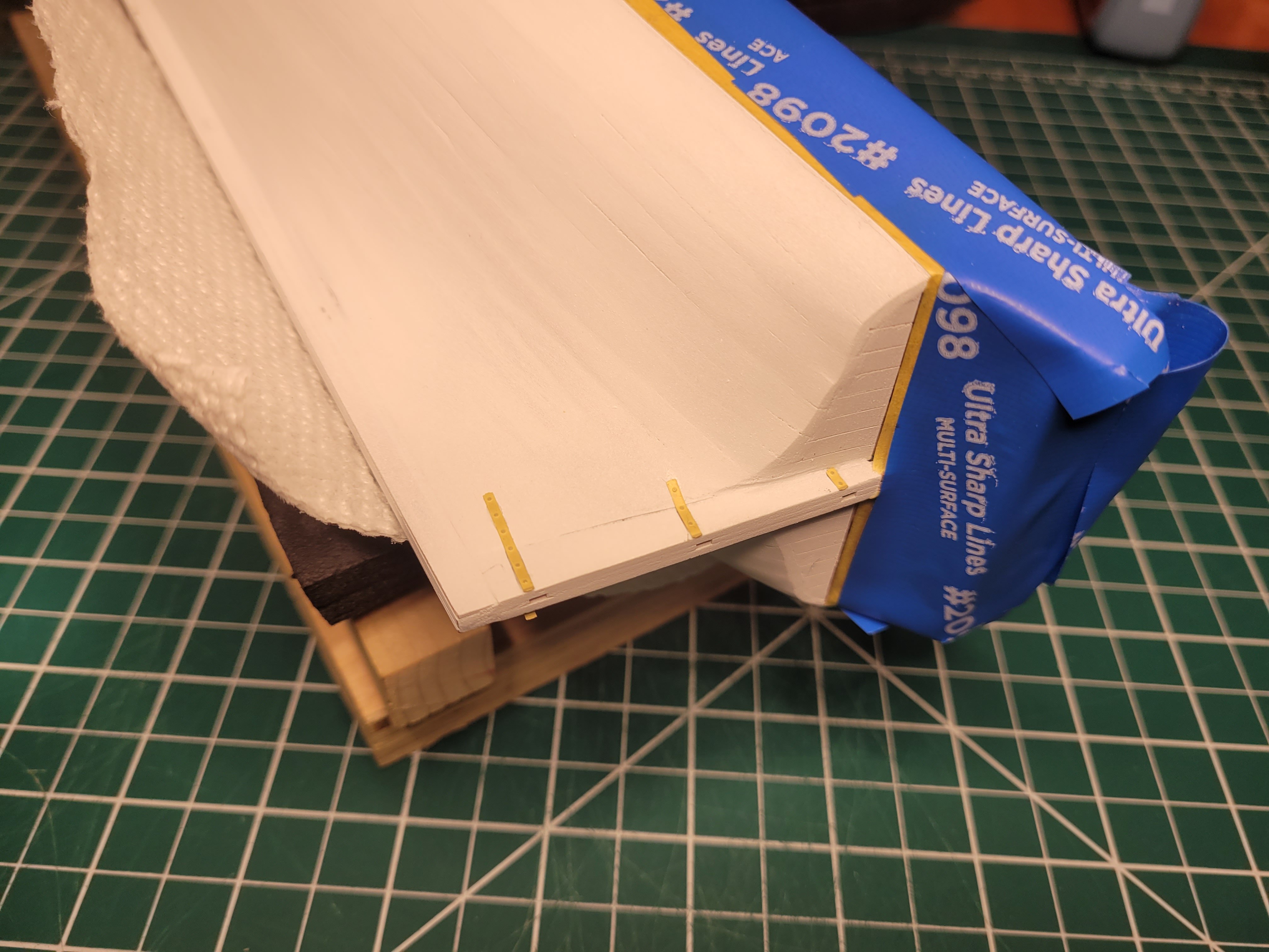

Here's an update; I went a few weeks without getting in any work on the model and then was away for a while. Next up was dealing with the pesky/tiny PE depth markings. I chose to paint them, and used the Vallejo Copper. They looked far too orange but when on the hull, look ok imho. I managed to clog up holes etc, but some finicky work with a drill bit and hobby knife cleaned them up ok, although I'll probably have to do some minor touch-up after they're on the hull. I started with the horseshoes. After glaring at them for a while, which didn't really accomplish anything, I fiddled with various ways to put them in accurate position, and glue them. Picking them up as such with the wax pencil works great, but since the wax pencil obviously sticks, I couldn't keep or manoeuvre them into correct position. There ensued multiple tries, with the cussing increasing exponentially, no luck. Then I had the idea of using two metal rods of the same diameter as the holes to use as guides to slide them down into position. A few tense moments but it generally worked well, here's a pic. Putting on glue with the PE parts is a beast, particularly as you're putting the glue (I used superthin CA) on a finished surface and don't want excess glue to show. Putting some tiny dots of glue on the hull seemed to be the answer versus trying to put it on the part and then trying to slide the part down the rods. I had a bit of excess glue squeezed out, but not too bad. It's only when i went to do the numerals that I figured things out. I didn't take a pic but there wouldn't be much to show. I started by just placing the part on the hull, with the stem horizontal as per the above pic, then twiddled it into final position using the tip of my hobby knife. Then, very carefully, so as not to move the part, I put on a mini-clamp just catching the outside bit of the part. With the part solidly held in place, I used the smallest applicator I could find to dab on some CA at the interface of part and hull and get the capillary action to draw the glue in. That has worked pretty well on the whole. Then the clamp could come off and the other side of the part glued. This has worked ok through the first two numerals, but I have left off for the time being in favour of switching to the following. But I will have to go back to the depth markings to finish them before installing upper work stuff. Waiting off-camera are a bunch of parts that have been prepped, painted and ready to glue in place. These include the spirketting, the gunwales with installed swivel gun posts and timberheads, stern board strip, stern side timbers, stern transom rail, channels, hatches/gratings, rudder/tiller. Basically, except for steps 79-81, all parts are ready up to step 85. So I'm on the verge of a frenzy of installations. But first, I need to do some cleanup on gunports and oar ports so that the plywood middle layer of bulwark won't be seen. The idea was to tape over the outside of the ports, and then paint the insides. But experimenting with a piece of inner bulwark from my messed-up original build just confirmed the obvious, which is that paint would bleed through the external pearwood like crazy. Here's my dummy test: So I figure the best way is to put filler on the inside of the ports, sand that flush, and then WOP to seal. I don't think I can just go with filler, as that will soak up paint and possibly bleed through to the outer bulwark. So here's the work with the filler. I used a small palette knife for the gunports, but it was too big for the oar ports, so I made a palette knife out of some plastic strip held in tweezers. I used a just-damp sponge to wipe the bulheads right after applying the filler to remove any excess; that worked really well. The end result, which is where I'm up to now: Sanding/cleaning next. Finally, before I glue on the gunwales, I'm going to have to get rid of some excess glue that I hadn't noticed that's in a couple of the upper rail slots, pic below. I've previously hacked away at these with a hobby knife, but the wood glue is touch as old army boots. I'll resume hacking away, but if anyone has a suggestion, much appreciated. More soon. Nick

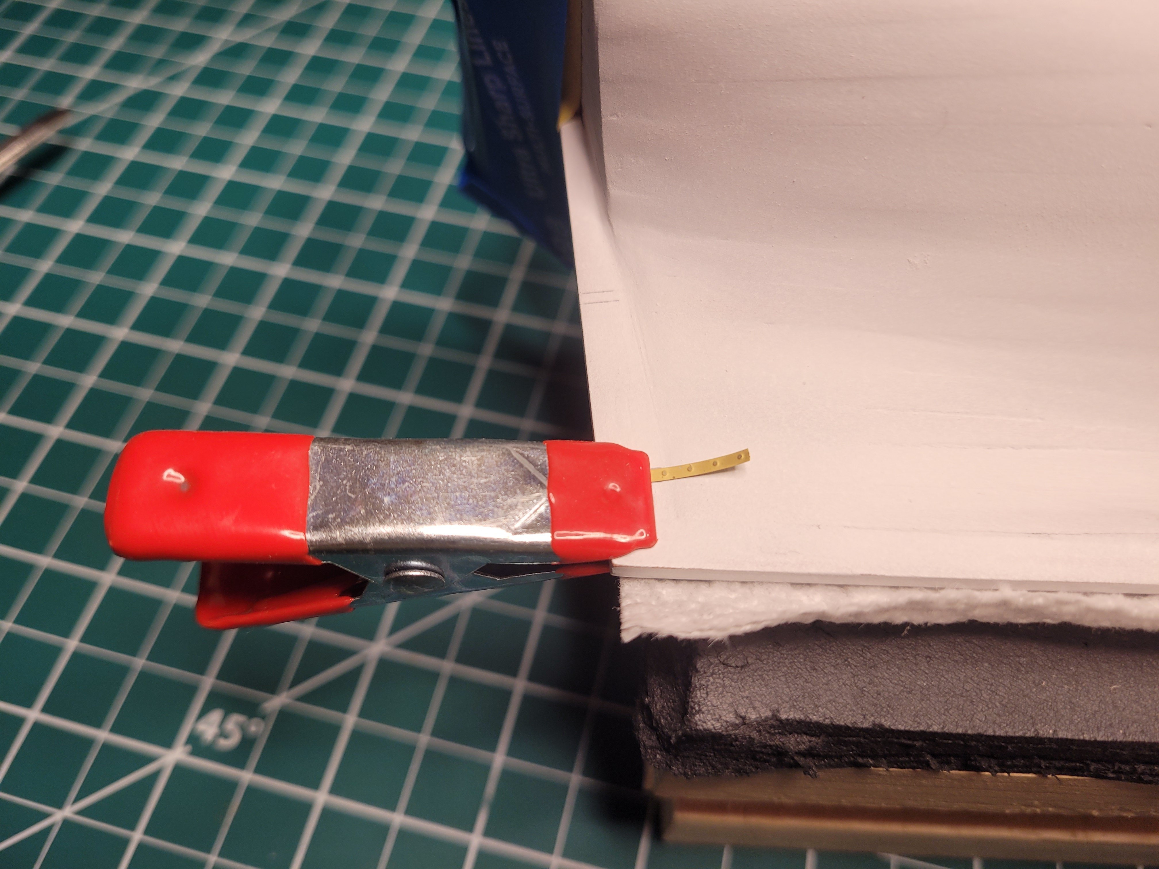

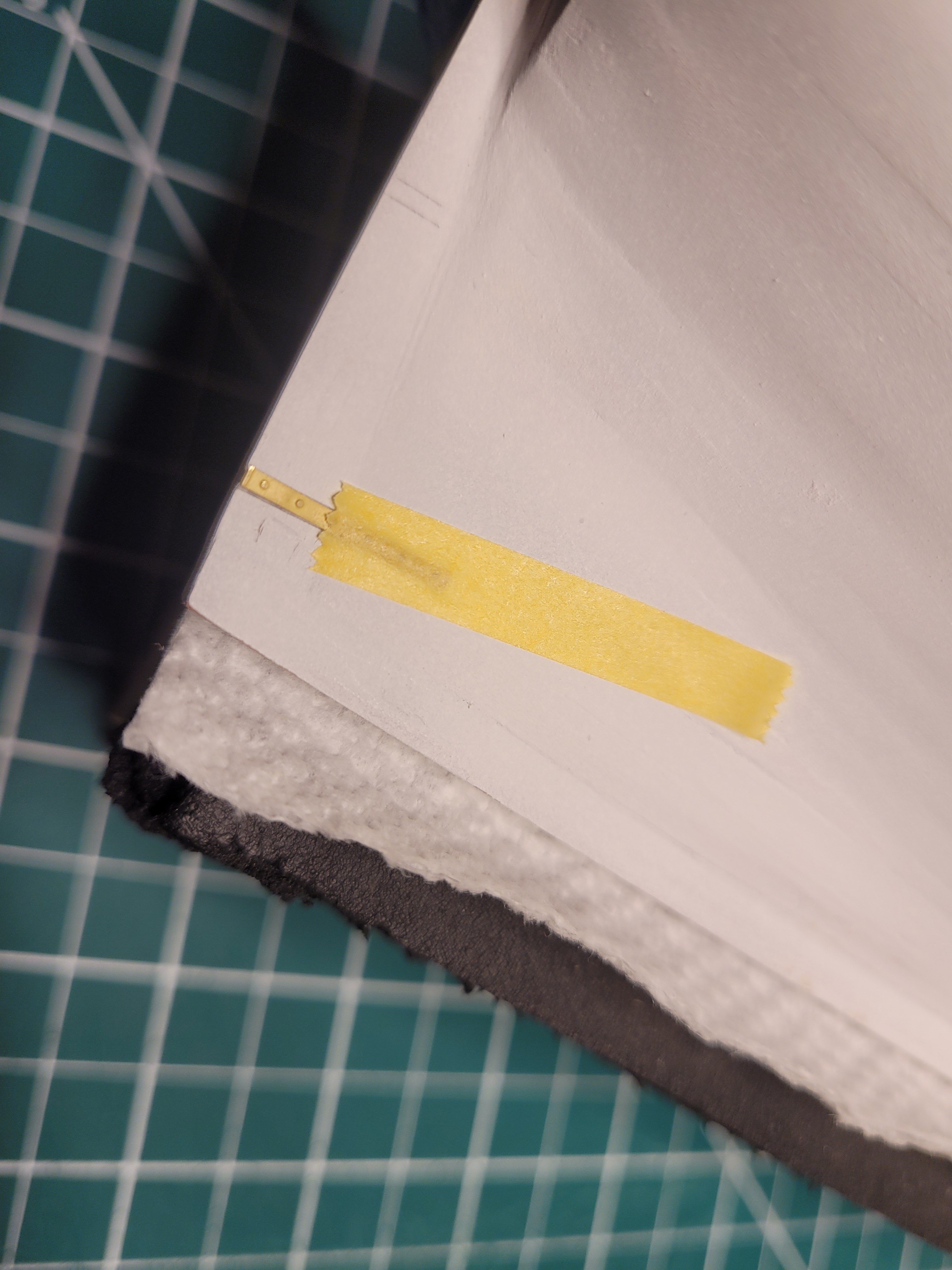

I'm finding as I say that picking up the PE parts with the wax pencil is a breeze, but getting an accurate placement is tricky because the wax pencil has just enough resistance to coming off that the part won't always stay where you want it, so doing it with glue is dicey. So I'm putting a length of masking tape on the part and then using that to get the right position and stick the tape down to hold the part in place. Then I'm putting a clamp on the other end and removing the tape, making sure to remove it starting with the end of the tape that's on the part to be sure not to move the part. Then I can gently lift up the exposed part, put some glue on and press it down. Then the clamp comes off and I repeat with the other end of the part. That's working well, although only for the lower two parts; there's just not enough space to do this for the upper part. So that's placement/glue with just the was pencil, which is a bit nerve-wracking, but one down ok and one to go. The rudder parts should be easy as it's not installed and is more accessible. I decided to use medium CA glue; the extra-thin is just too runny. I load up the microbrush, but smear off the glue so that there's a minimum left on the brush, and then apply it to the part or the hull. Nick
