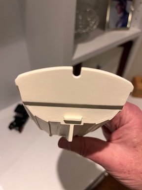

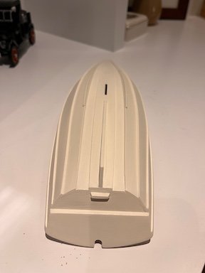

Post 8 - Painting the hull, Part 1. I gave the hull a sanding with 400 grit paper inside and out. Any suggestions on how to get sawdust off the model? I used a brush and a microfiber cloth. Finding a room temperature, well-ventilated space in New England in the winter for spraying painting is always a challenge. I backed the cars out of the garage, left the doors open, and laid some newspaper on the floor. I cut a portable painting booth out of a cardboard box, and kept it, the model and the primer in the house. I used a rattle-can wood primer. When ready, into the garage, and after finishing, everything back into the house to dry. While I was giving the hull a light sanding, a saw gaps at the bottom of the gabard planks that I hadn't noticed before. Also lots of other little dings where the planks met the transoms. I used Occre putty, which sands easily, and after touching up the primer, I started bruxh painting. When I painted my Dory I didn't dilute the paint, but after perusing the painting forum hear, and reading posts online, I decided to thin the paint. I did a 6:1 ratio. I endednup with 3 coats of the Warm White. It looks good in normal room lighting, but there are still some brush marks. The only real wooden boat I'm familiar with, a Wianno Senior that my in-laws sailed, had some brush marks on her hull, so I don't feel too bad. However, I'm wondering if I should dilute the paint more and use more coats when I paint the interior tomorrow. Does anyone have any suggestions?

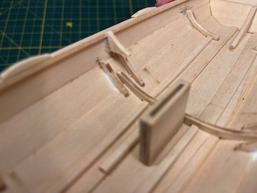

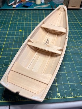

POST 7 - The Thwart Knees After my last post, I realized the stern sheets were too tight against the shear planks, and therefore weren't sitting level. I made cardboard templates of the two pieces, and used them to obtain the fit, scribed them onto the stern sheets and used that as a guide for sanding. Finally got them where they needed to be. The final result: The midship thwart knees needed a little sanding on the bottom to allow the thwart to slide in and out. I used a stick to ascertain that the knees were parallel to each other. The biggest issue was that they didn't touch the shear strakes. I decided to try the sawdust/diluted glue technique to fill in the gaps, rather than putty, figuring that would also re-inforce the attachment to the hull. I wrapped the thwart in wax paper and put it in place so the filler wouldn't get too low. I used the handle end of an Xacto knife as a trowel. Worked pretty well, but left some gaps: After the filler dried, I use putty to finish it. All the thwarts temporarily in place: I then drilled the holes for the traveler. The instructions indicate the line used is 0.7 mm. I drilled 1.2 mm holes. I used a short piece of scrap 3/32' square basswood layed along the transom and then the outer edge of the knee to locate the holes. I also removed floorboard #1 from the fret so I could make sure the stern transom knee wasn't too high. It was. I reshaped the curve so the floorboard sat flush on its cleats. I also needed to shorten the sides of the floor board to get it to fit. After that, I final sanding inside and out; I should be ready to prime the hull tomorrow. My main lesson from these steps is the need to continually check the fit of pieces. I thought I was finished with the stern sheets, but when I looked at the model from a different angle, I realized they were'nt seated properly. I also learned the benefit of using cardboard templates. I liked the sawdust/glue filler, but I think I made mine a little too thick.

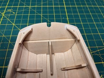

I spent the last 2 days (when not gathering with family and friends) working on the inwales and quarter knees. The inwales wnet on easily. I taped the quarter knees in place and used a small stick to trace the angle of the bevel, to use as a sanding guide. Despite being careful, or so I thought, there were some gaps, but some Occre putty helped with that. I also realized that one of the bow knees was sitting higher than the other, so I unglued and refitted it. In the end, I think they look OK. That's it for 2025!
