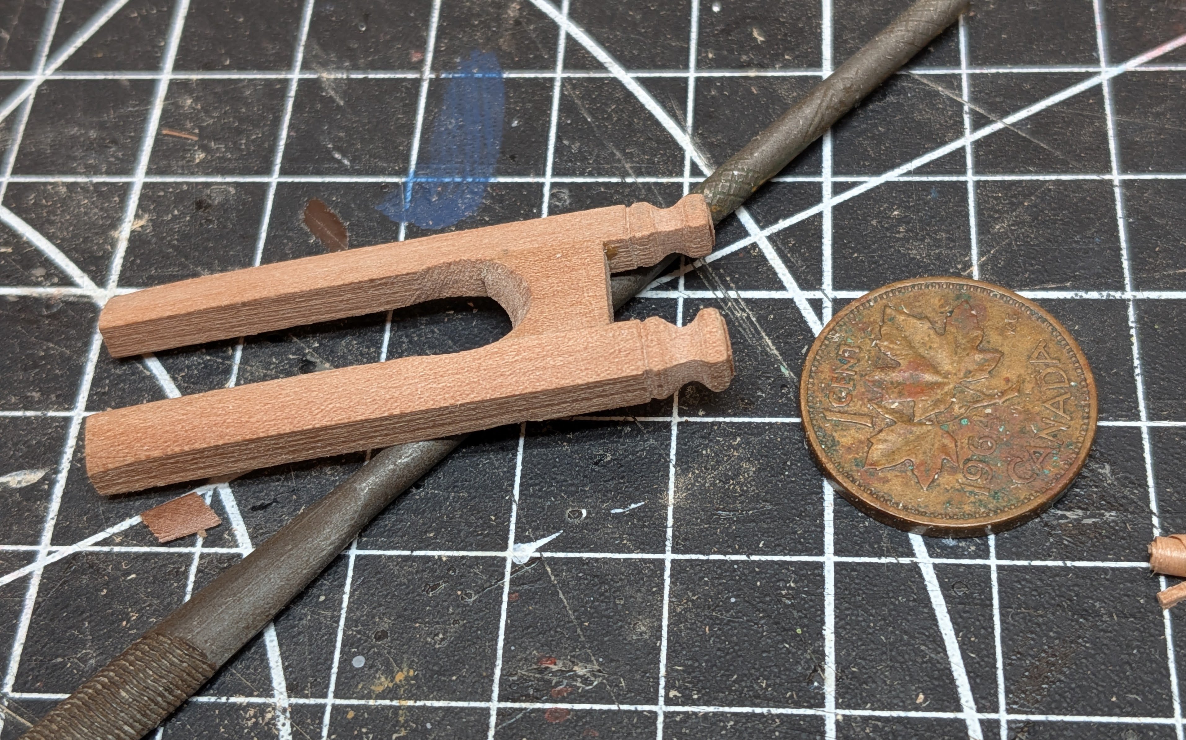

I am currently working on the bollard timbers / knight head and I have run into some confusion. I am hoping that someone has some insight to share
