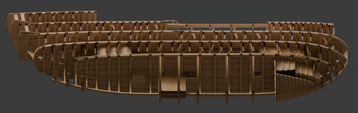

Added some more detail to the hold, as well as some sheaves and bitts. Also added are some of the lantern rooms. From now on, I’ll be going deck to deck doing the final detail passes. The hold needs a major one, as does the orlop; then it’s to the screens of the upper gundeck and quarterdeck. Last will be the furnishing, and then off to rigging. Then, Substance Painter materials!
I may need to revise my base hull mesh and add more polys beneath the waterline, as faceting is visible on the hold interior. Same for the lower gunwale. While I’m not aiming for low poly, I also don’t want to go too high. More detail is warranted, however. In my below image, I deleted the “non-visible” faces; I think I will add those back where they’ve been removed (support knees also) as I want to showcase the different layers of the ship. Thus, they will be visible. I’ll also construct the frames, in this case. Again, not going 100% accurate, but that will likely be the case for my next model.
