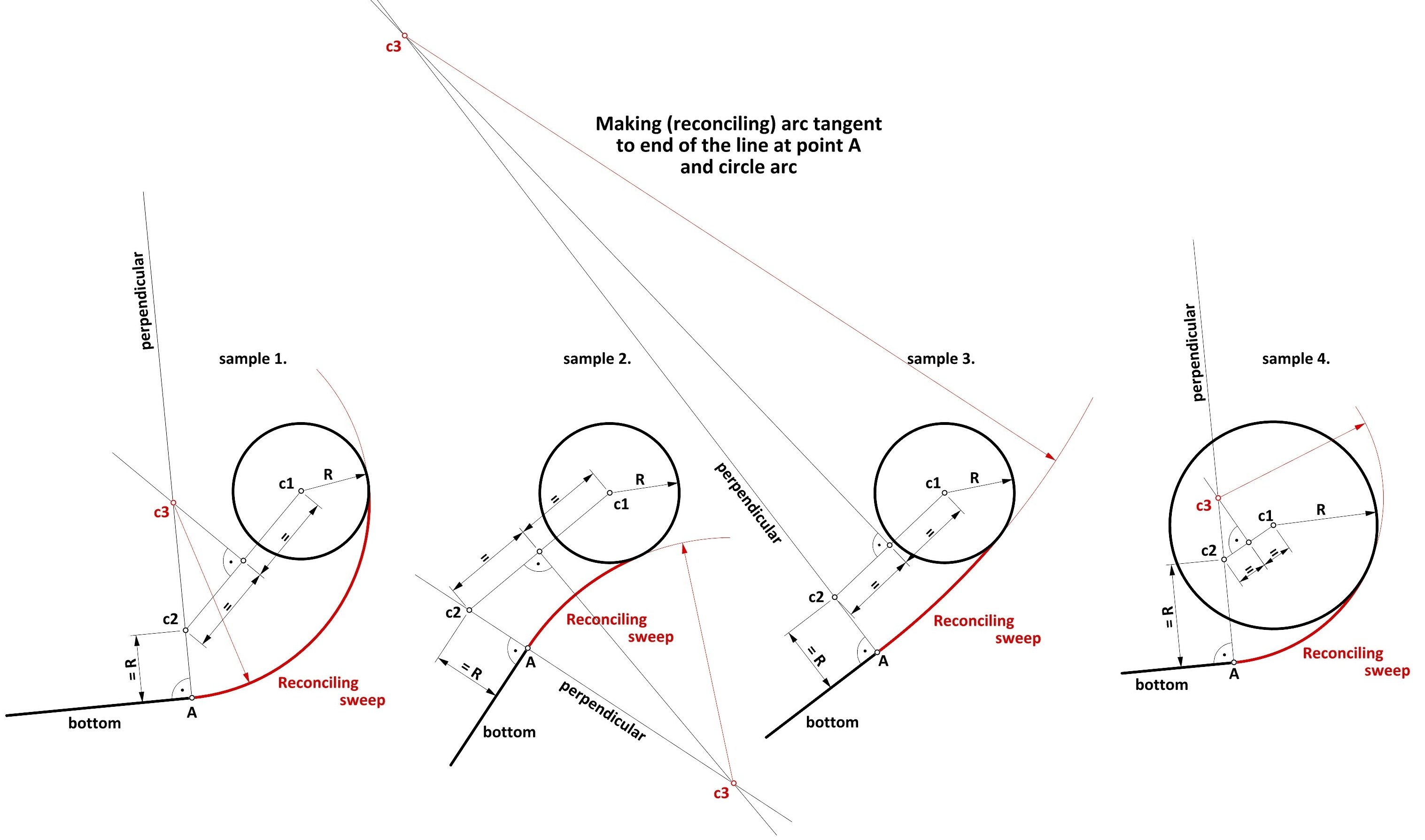

On 5/27/2025 at 8:23 AM, Alvb said:
Only the reconciling sweeps—circular segments that connect tangentially to given arcs—should be easy to find using graphical methods, but no!
Could you perhaps briefly explain to me how to find these sweeps?
It occurred to me later that one could still show a geometrically rigorous way of determining the reconciling sweep tangent at both ends (that is, to bottom line on one side and to lower breadth sweep on the other). Although the method is extremely simple, it is highly doubtful that it has been used in practice, and especially at actual scale on the mould loft, as can be seen particularly well on sample number 3, where the auxiliary lines extend far beyond the contour area of the frame.
The method using a flexible instrument, shown previously in the entry #40, is by far the preferred one, not only because it is hassle-free, but also gives excellent results in terms of the precision of the contours obtained, and this is true even allowing for the minor inaccuracies of handling such a flexible instrument.
Be that as it may, below is a method employing formal geometry:
1. make a perpendicular to the line of the bottom at point A,
2. mark point c2 on this line at a distance R from point A,
3. connect points c1 and c2 with a line,
4. find the midpoint of the line c1–c2 and make a perpendicular at this point to line c1–c2,
5. the intersection of the two perpendicular lines (described in steps 1. and 4.) yields point c3, which is the centre of the reconciling sweep.
@WaldemarThank you very much, basically its clear, but your drawings make it much easier to find the connecting arches.
Edited by Alvb
