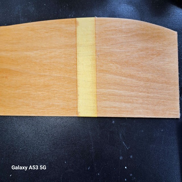

 Here is a piece of basswood, sanded and pre-stain applied to the right side. While the right side is a bit lighter, a second coat could be applied. But much nicer looking grain.

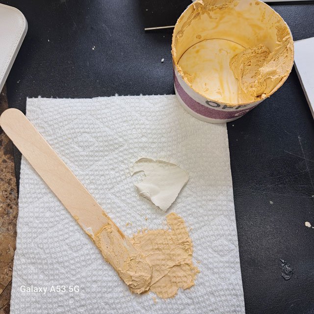

I'm using a warm oak oil stain to fill some small gaps on my hull. Placed some filler in a paper cup and used a pipet to add the stain and mixed well before using. While this wood fill will take stain as it comes, I find the tinting works even better. The filler is pure white.
