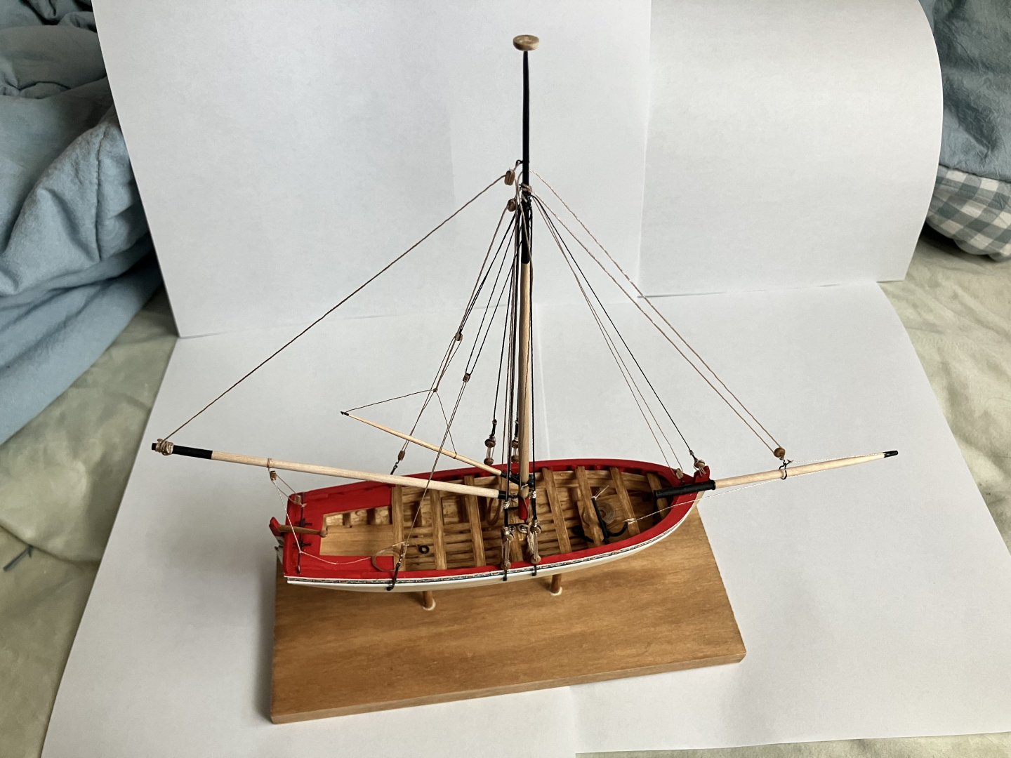

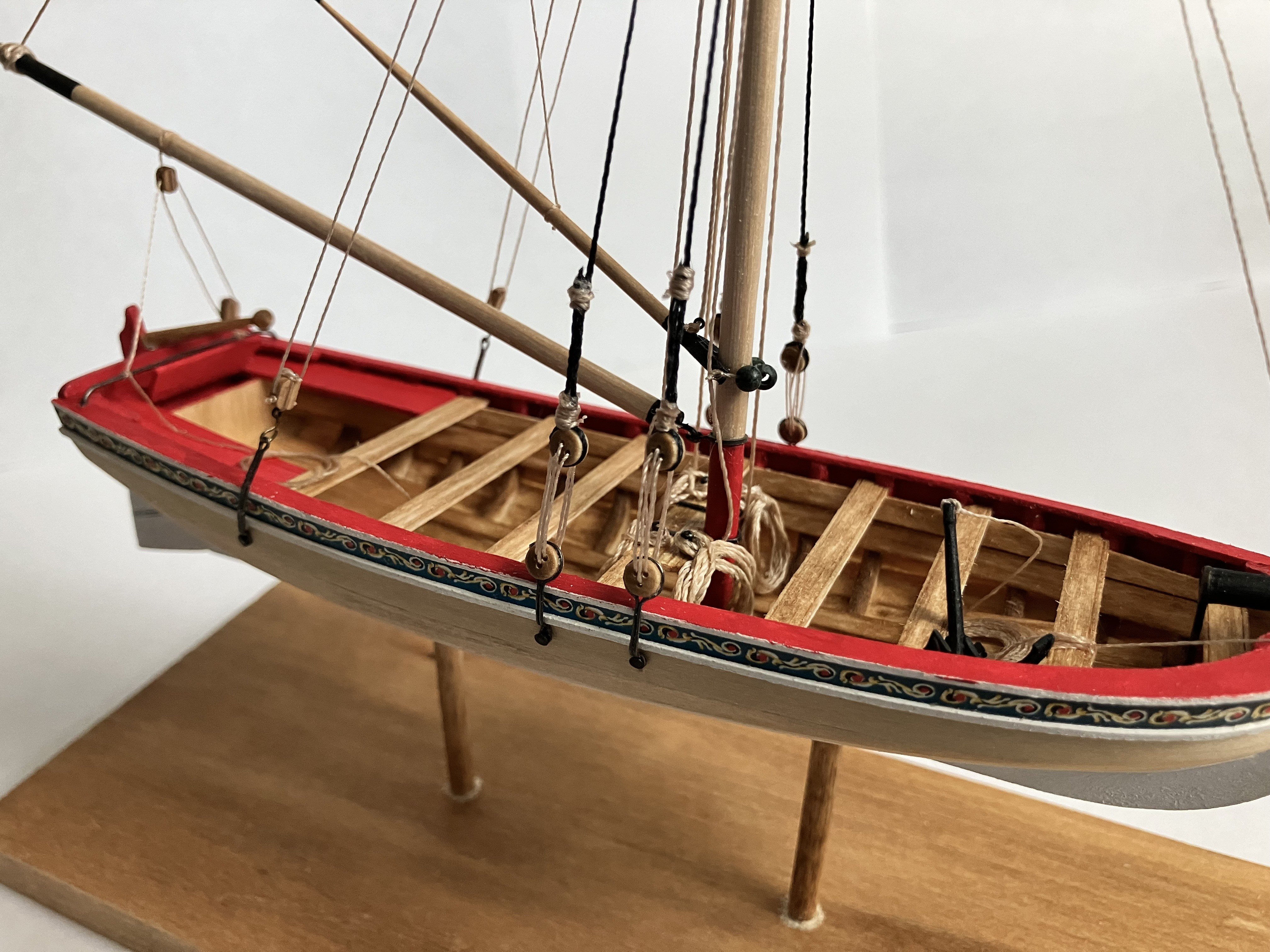

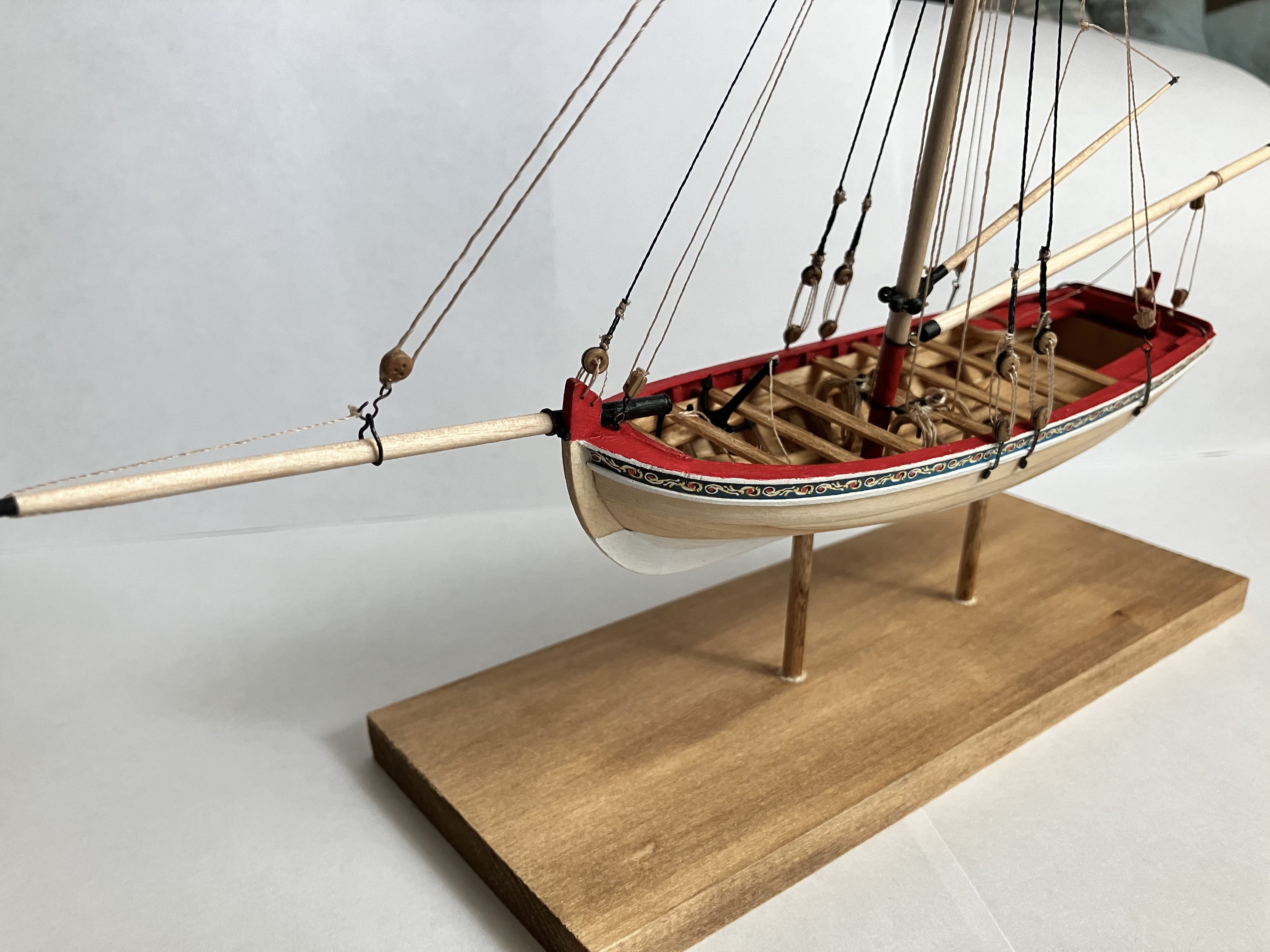

Thanks for the reply, I have finished the rigging using your suggested build log and the 1/24 armed longboat kit instructions. (can be found here MS1460_18_Century_Long_Boat_Assembly_Instructions.pdf) I ended up using a combination of halyard hitch, clove hitch, and overhand knots to finish the riggings. I originally wanted to try my hands at heaving line knots but found it too hard to tie at this scale.IMG_2310.thumb.jpeg.587a994af31f5f4650a0c0a88b64f98a.jpegIMG_2309.thumb.jpeg.c1327c49a594cdeaa9eb2a73fd626792.jpegIMG_2308.thumb.jpeg.5376d106191b88b744b7dffc75152641.jpeg
