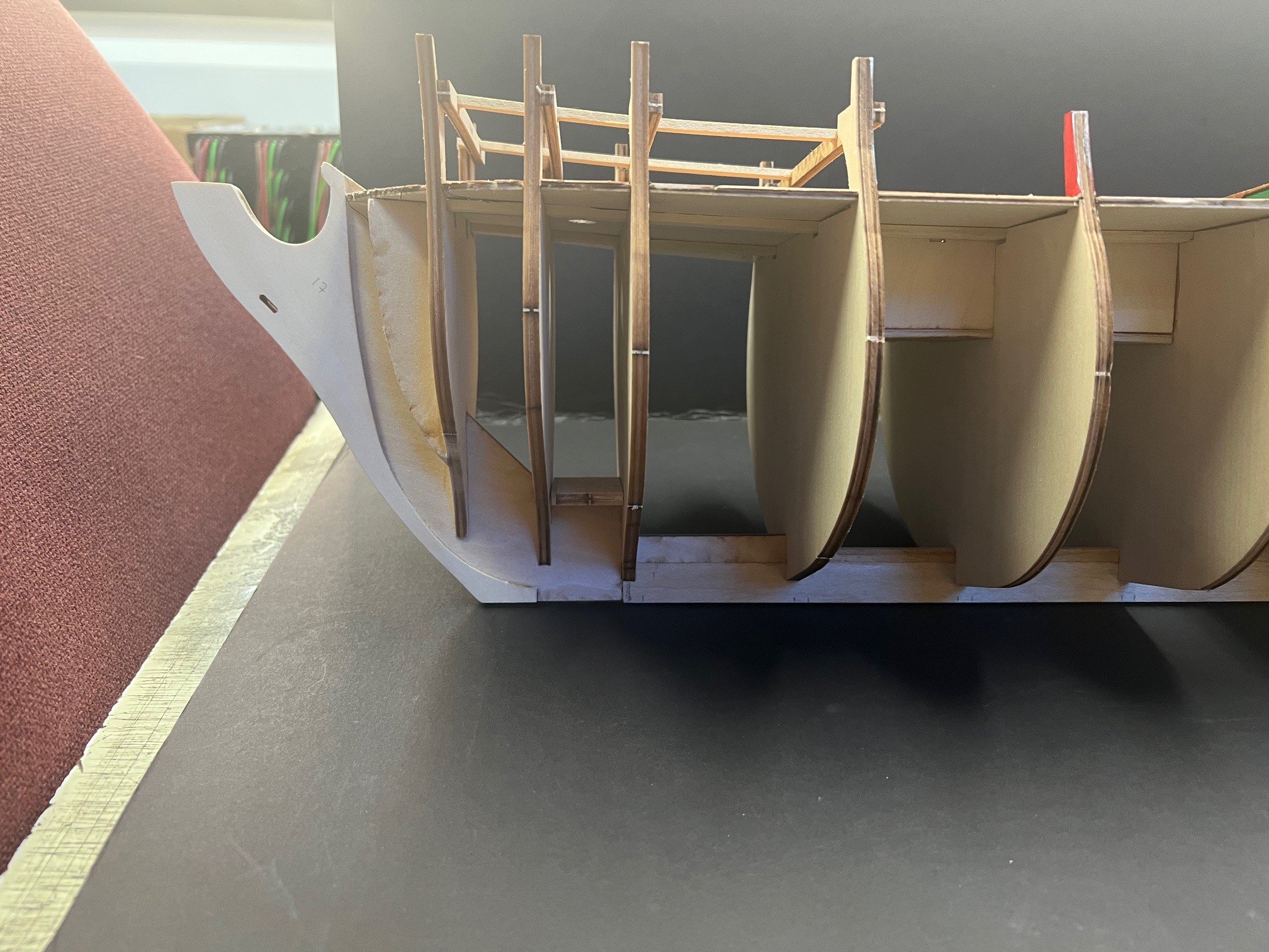

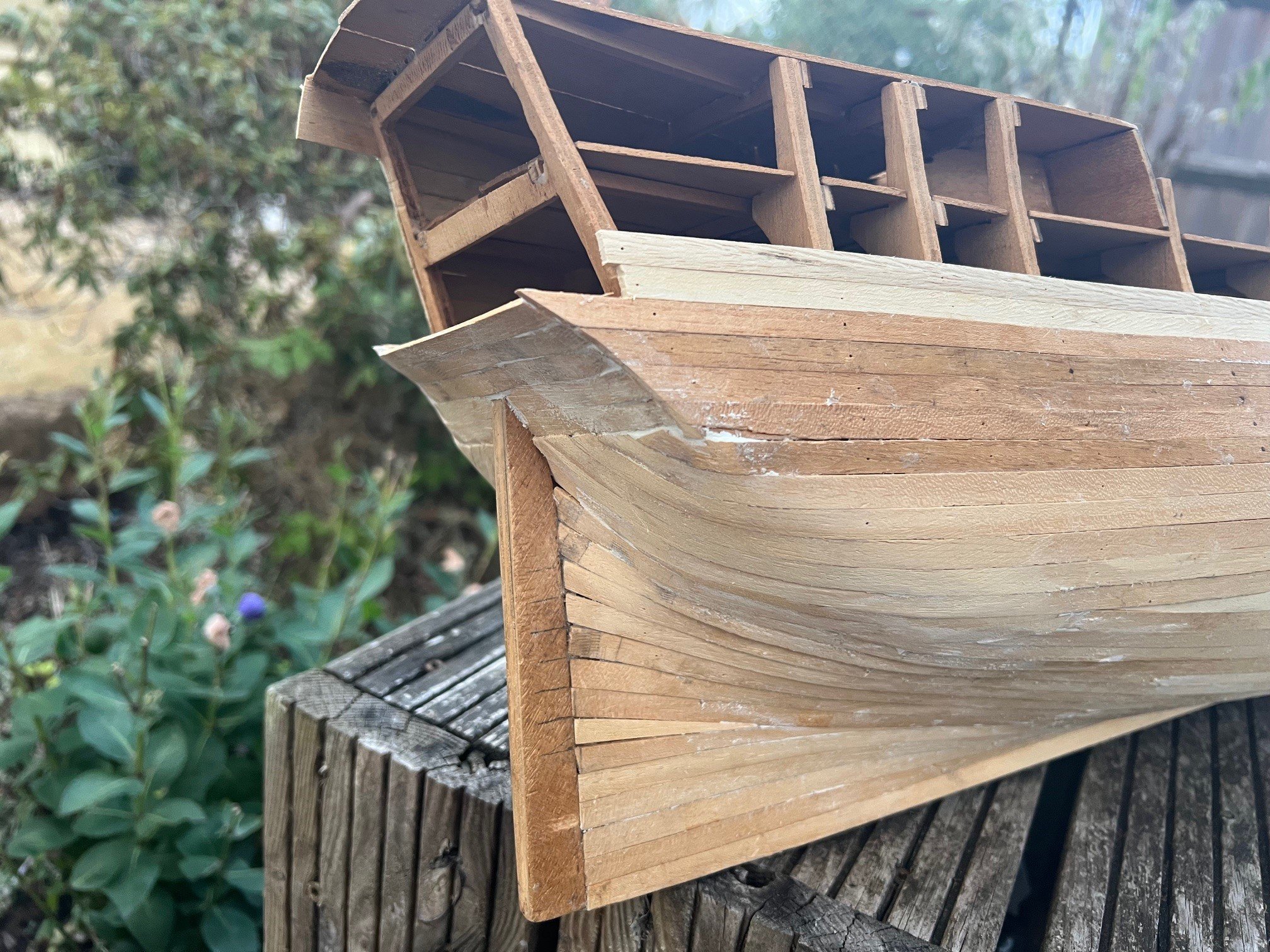

As mentioned above, I started this kit 35 years ago and decided to pick it again in March this year. I had contemplated purchasing the kit again but decided to continue with the original and see how it went. If nothing else, it was going to be good practice for any future builds.

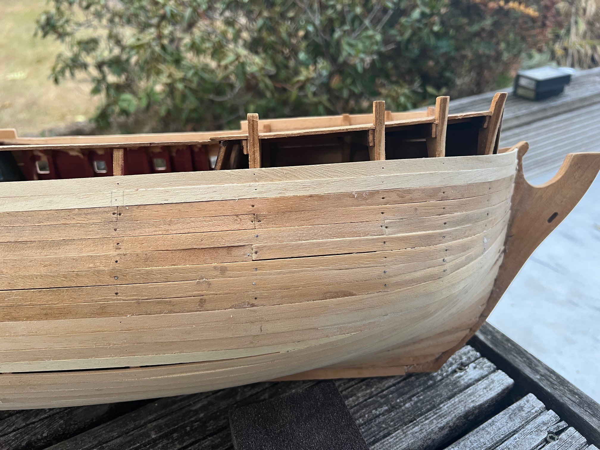

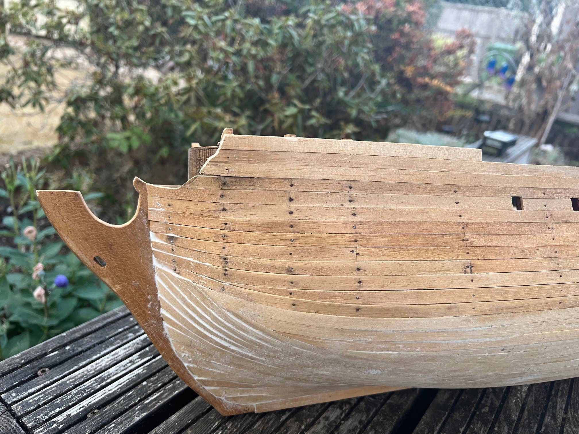

I continued with the planking, despite my original effort having gaps (darker planks). From memory, I soaked the planks, bent them into shape and attached them immediately using glue and pins. As the timber dries out, it shrunk and left gaps. Lesson learnt.
I didn’t like the pins, so this time I glued the planks and held them in place temporarily with larger removable pins. I steamed the planks, bent them into shape and then left them to dry before fixing them on. This was relatively successful but still had some gaps and planks that didn’t sit flush to the bulkheads.
Note: Make sure you file the bulkheads to the shape of the hull before fixing planks.

Keel laid, Bow and Sternpost attached. Minor error. Should have attached Rabbet (#17x2) and Stern Rabbet (#18x2) before attaching to keel.

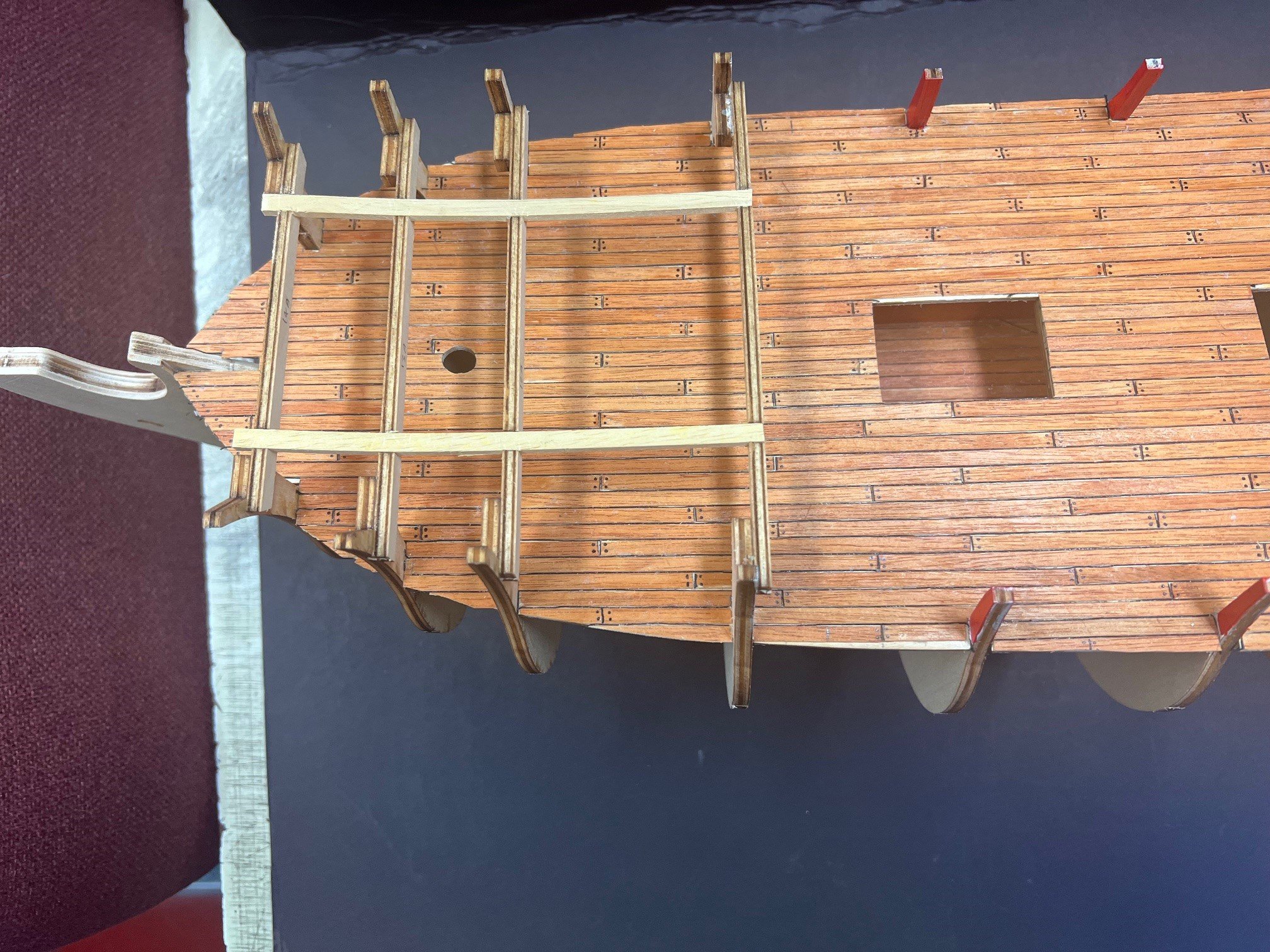

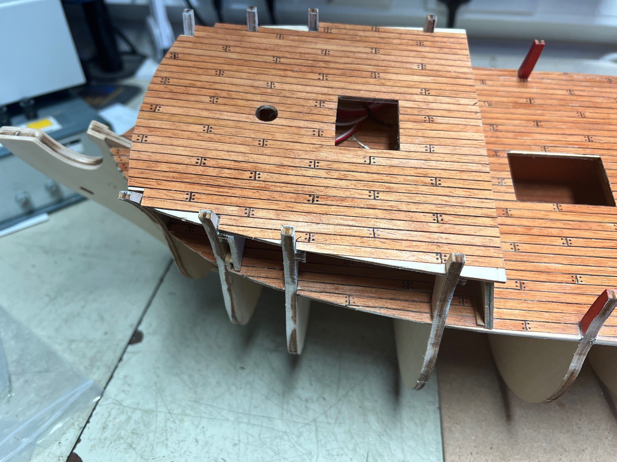

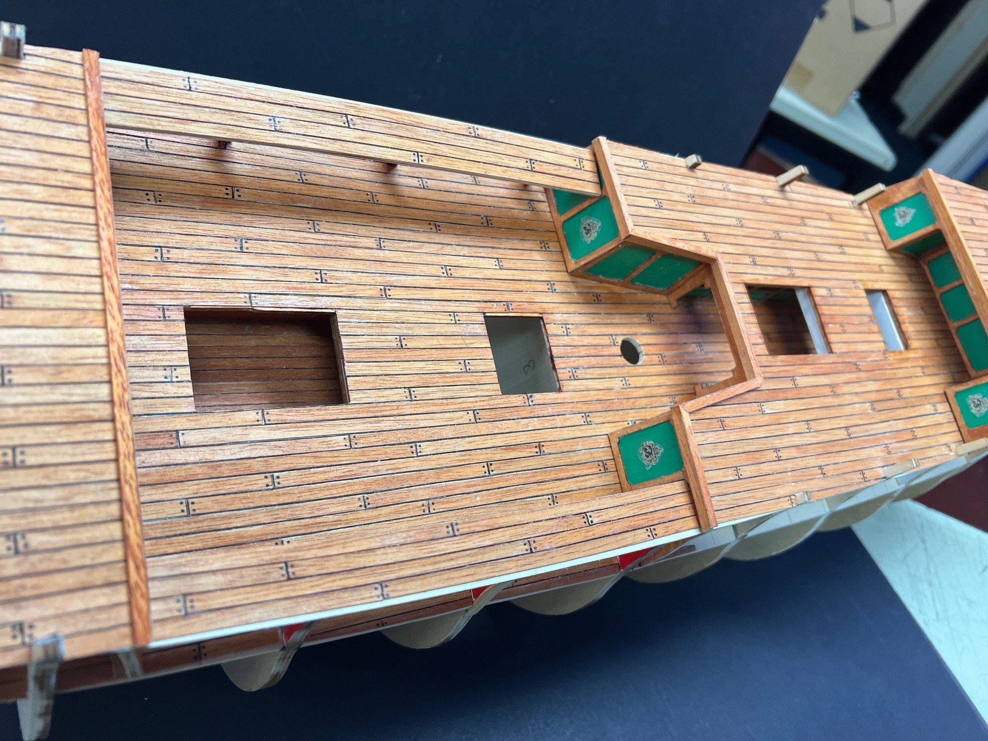

Added hatch box but first added planking to the base. This was going to be a trail for adding decking so used kit supplied mahogany strips and stained them mahogany. This was too dark so decided to use Tanganyka strip 0.5 x 4. See next post.

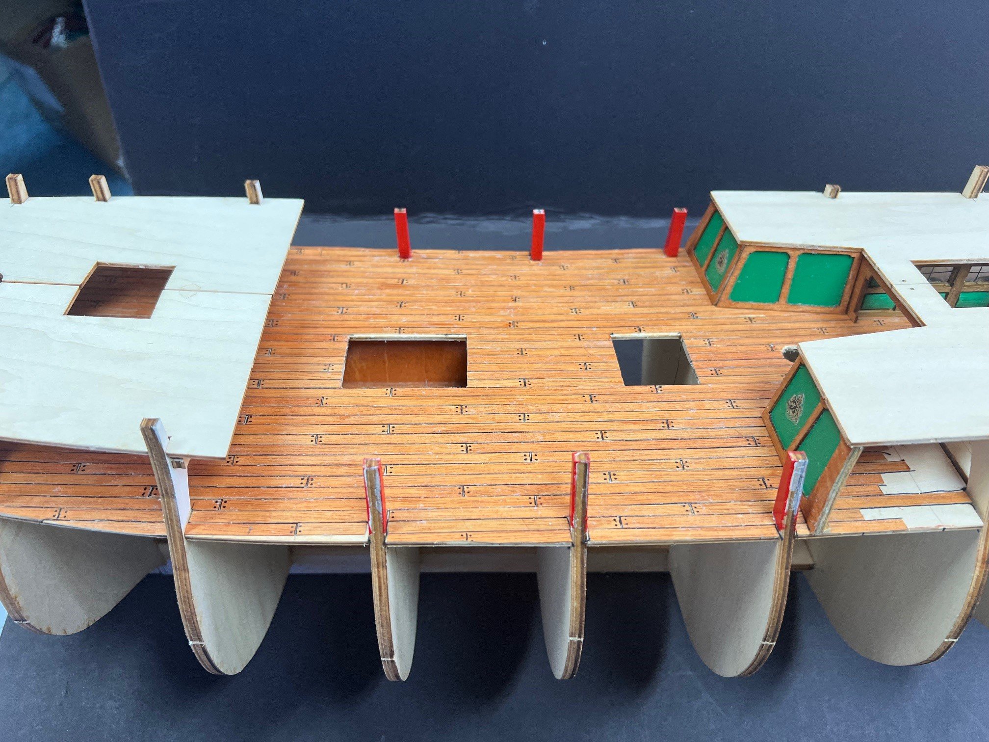

Attached main deck 23 and 23A. Formers all lined up well, but it didn’t sit straight down the centre line. Filed out a couple of former notches and all was good.

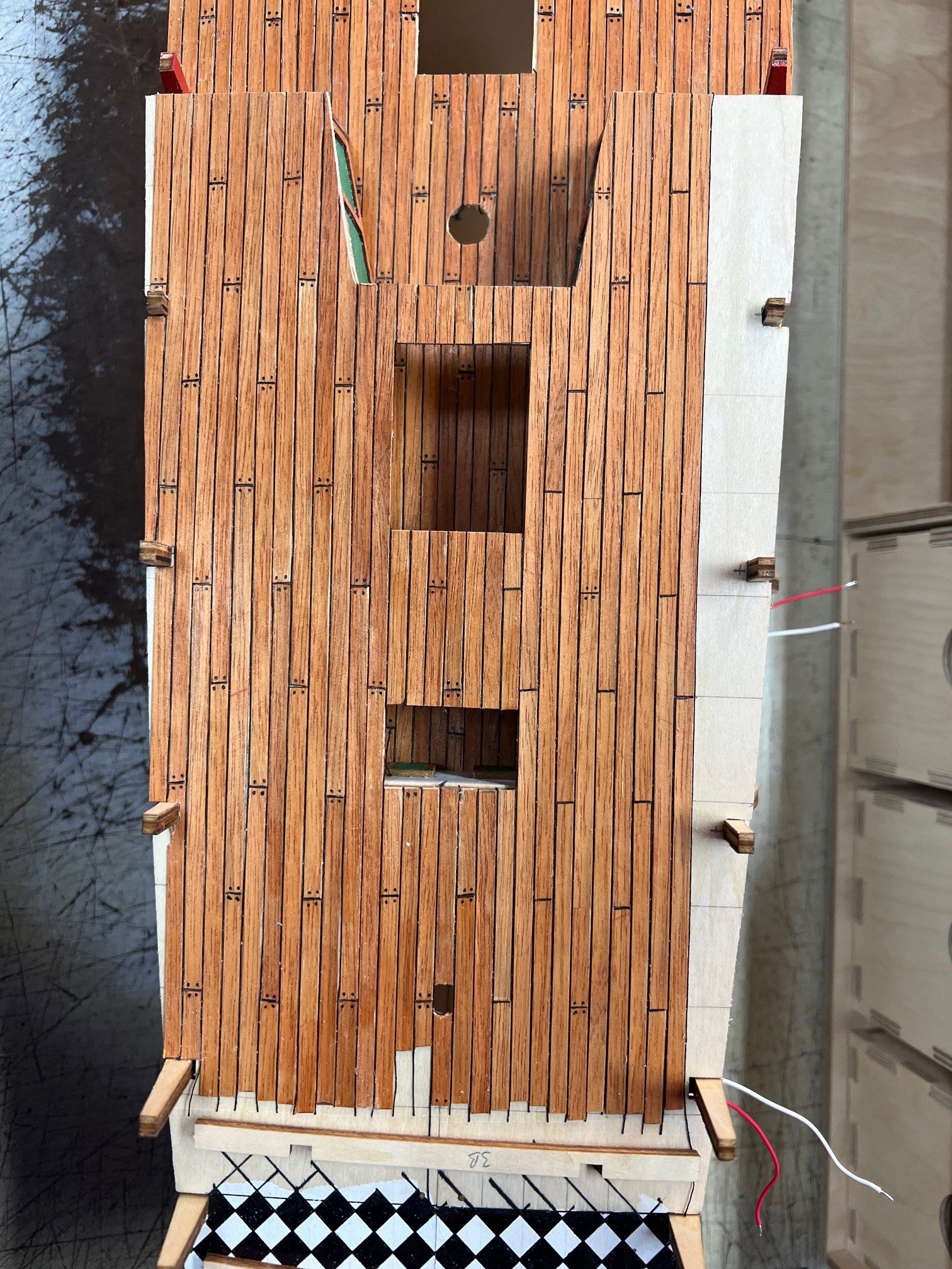

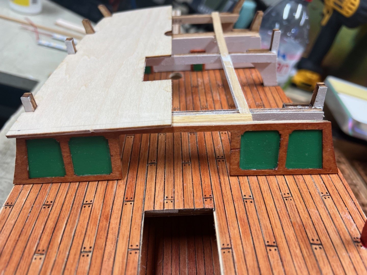

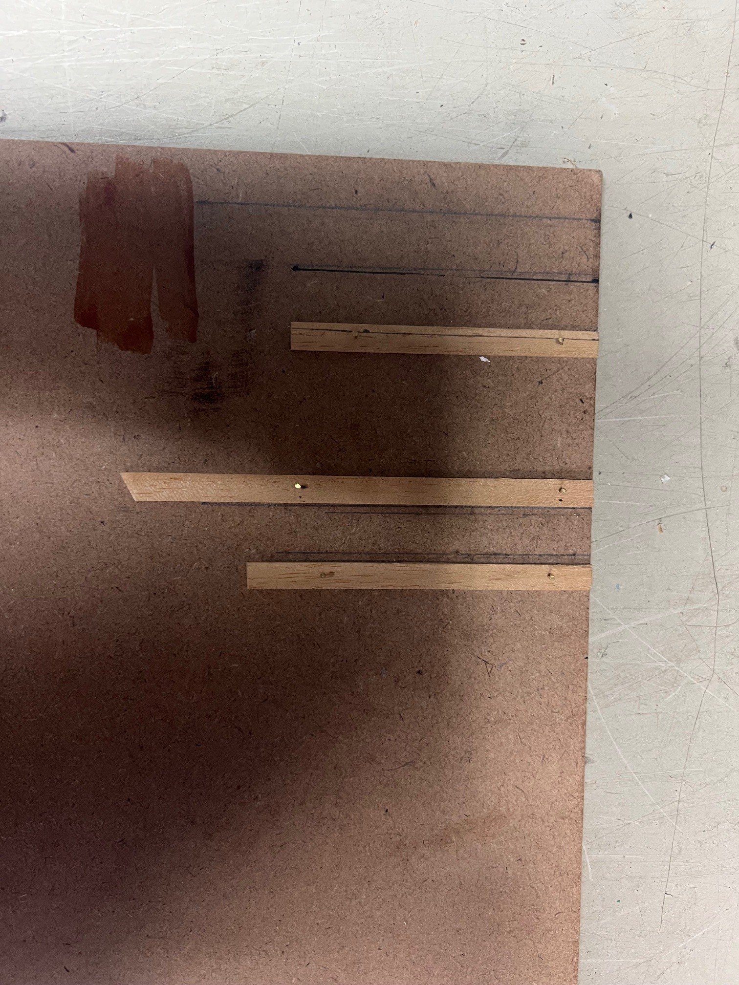

The instructions say to mark deck planking with a pencil, but I wasn’t keen on this method. On the older kit I had, the deck was marked with black lines, but this wasn’t brilliant either. Decided to lay individual planks using a 3 butt system. Saw on a video that someone had used black cotton to imitate caulking. This seemed a good idea so practised on the hatch box first. Results were ok so went for it on the main deck. I used Tanganyka strip 0.5 x 4. The kit did have 62 unspecified mahogany strips which I could have used but after staining, these were too dark. Billings later confirmed these strips were for decking but no mention of it in the instructions.
Cut the planks to 10cms and stained them dark mahogany (Billings 006). Should have noted a previous build log by Ed, saying it may be a little dark. It was but got around it by brushing the laid planks with a cut down brush. This gave a “weathered” effect which looks ok now. Laid the King plank down the centre line and went from there. I used a fine tip Staedtler permanent pen to mark the plank joins and nails. Apart from a silly error of not wiping of excess glue with a damp cloth (resulting in a few hours of cleaning afterwards), happy with the result.

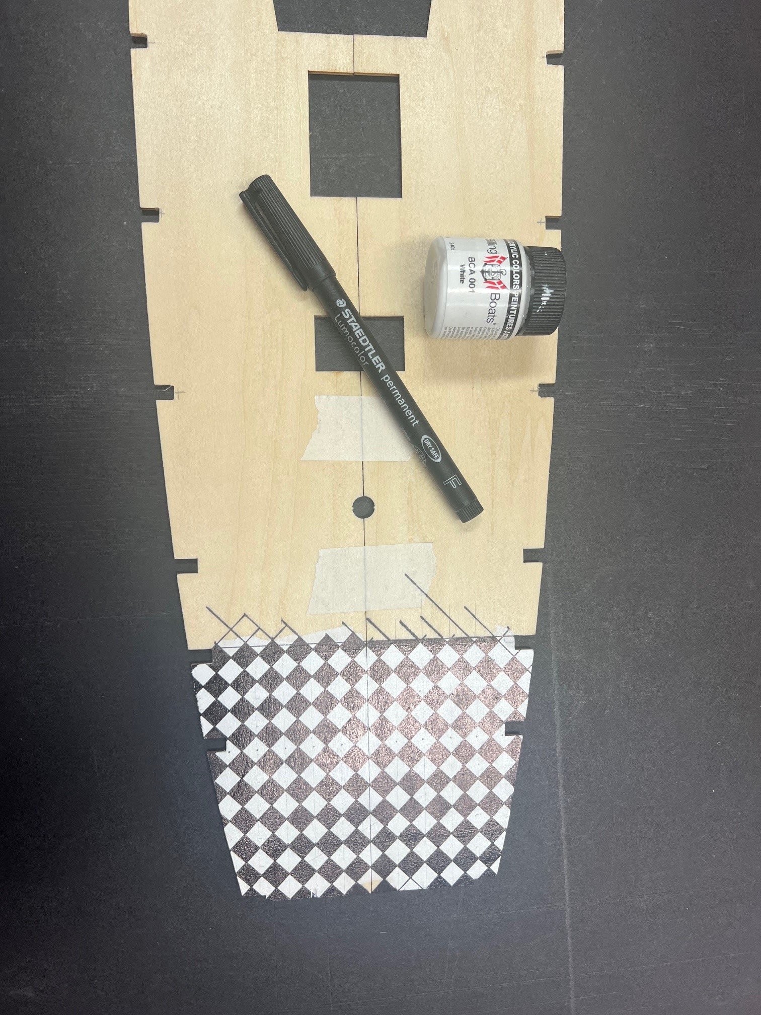

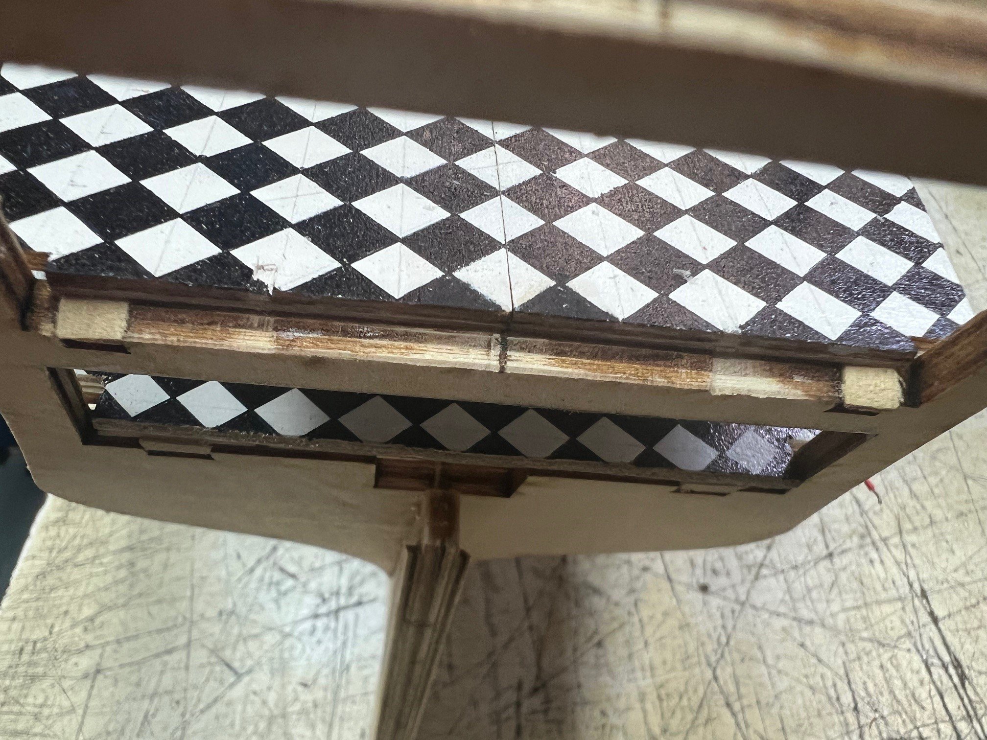

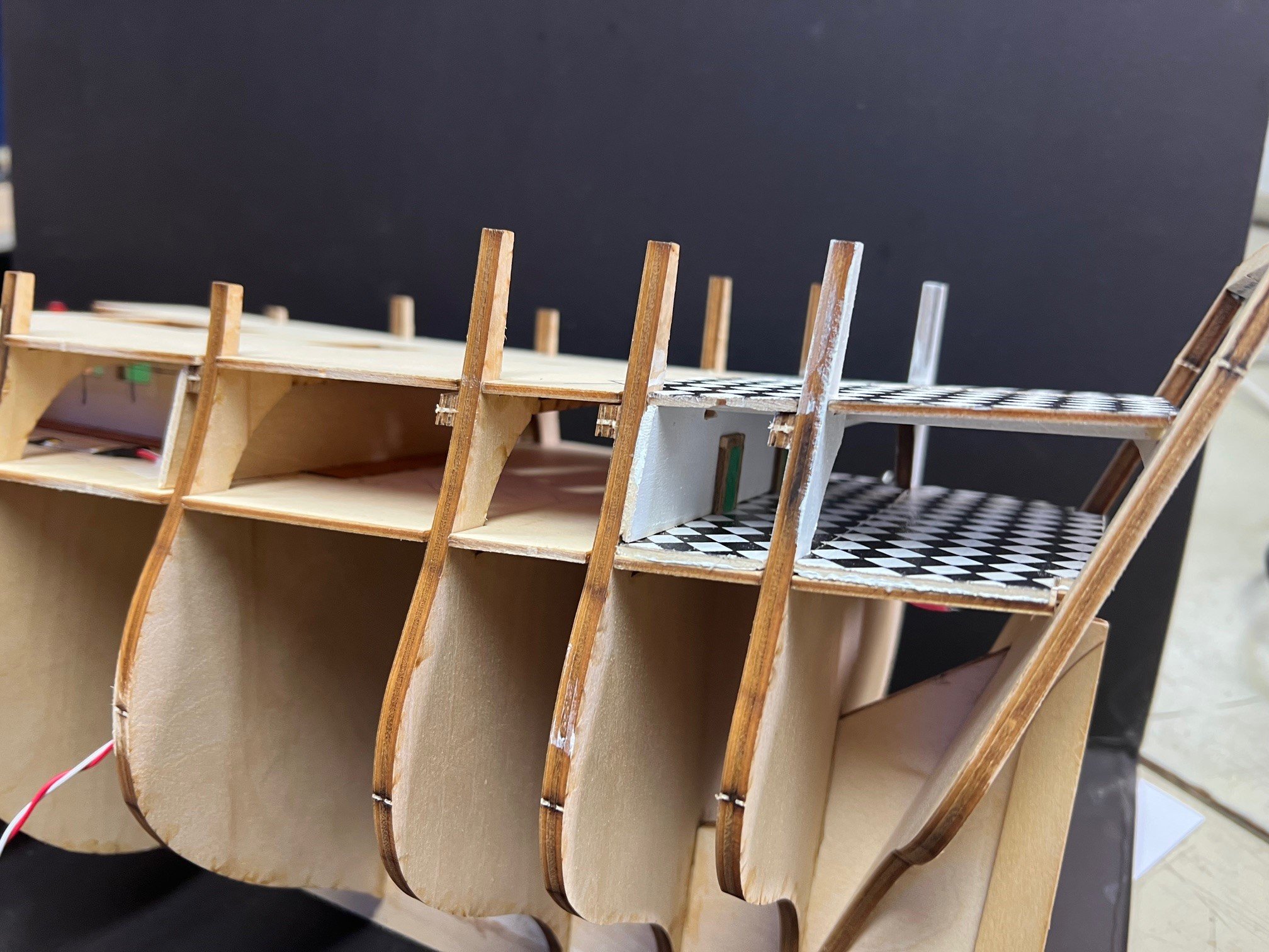

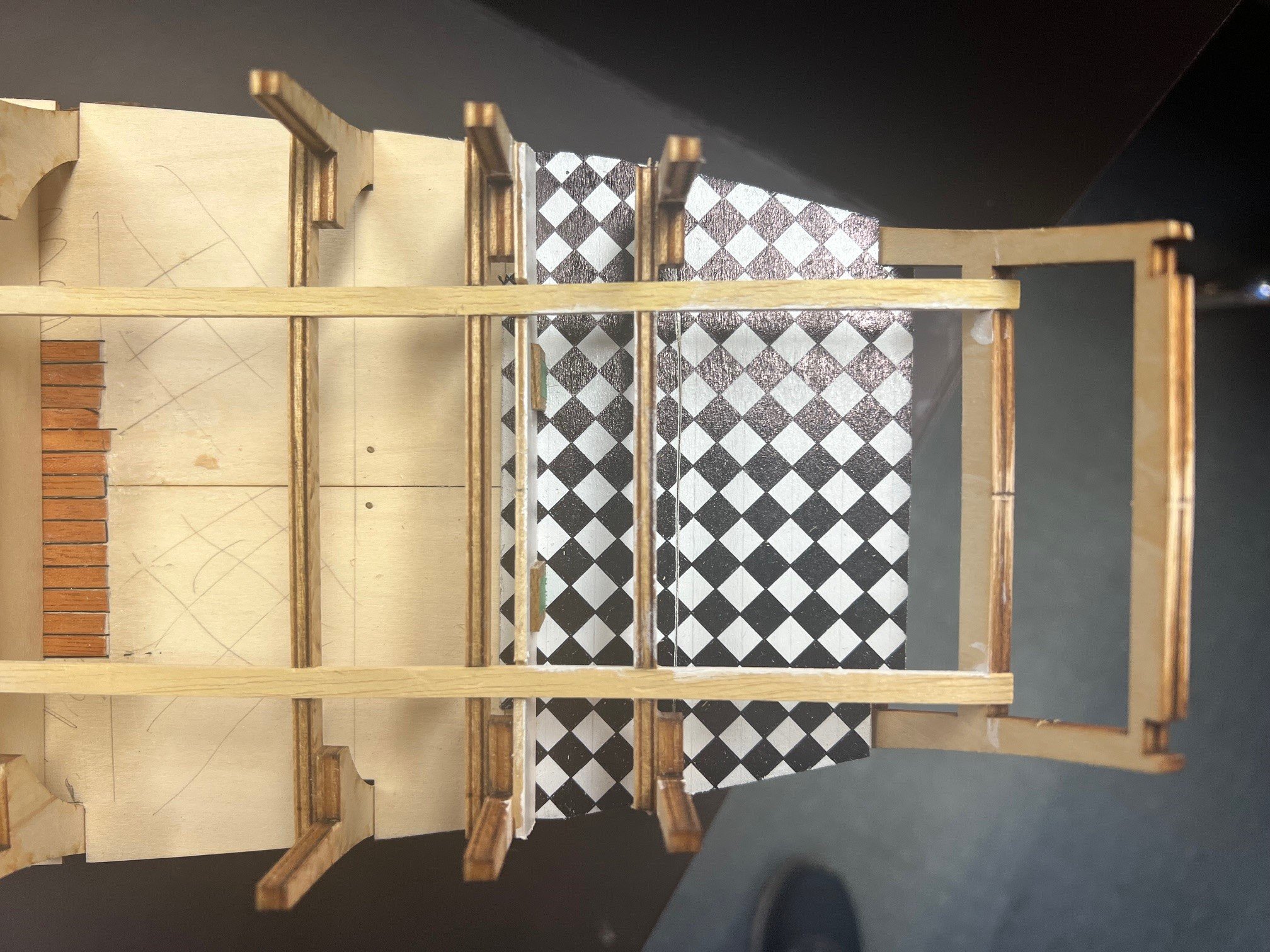

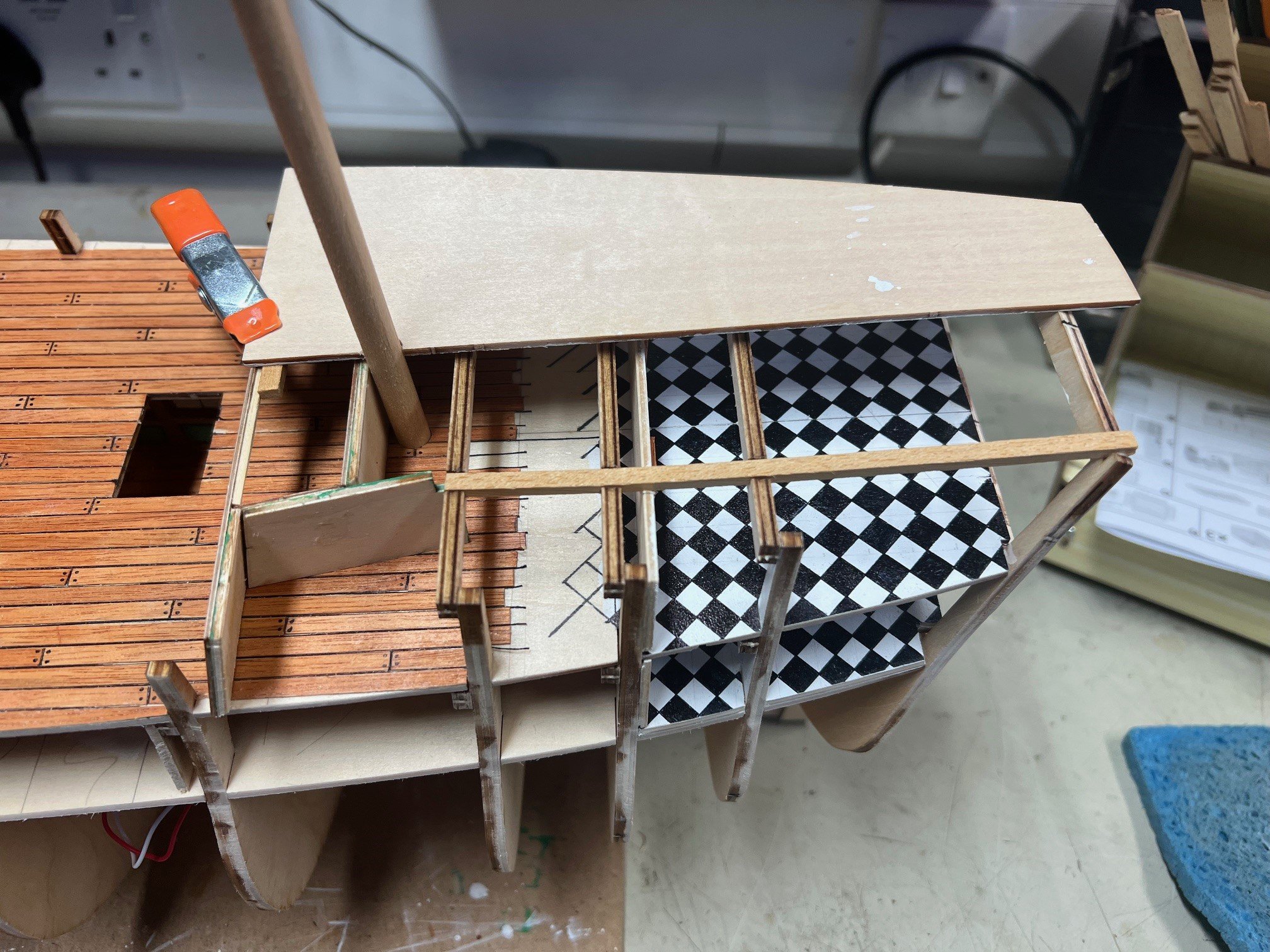

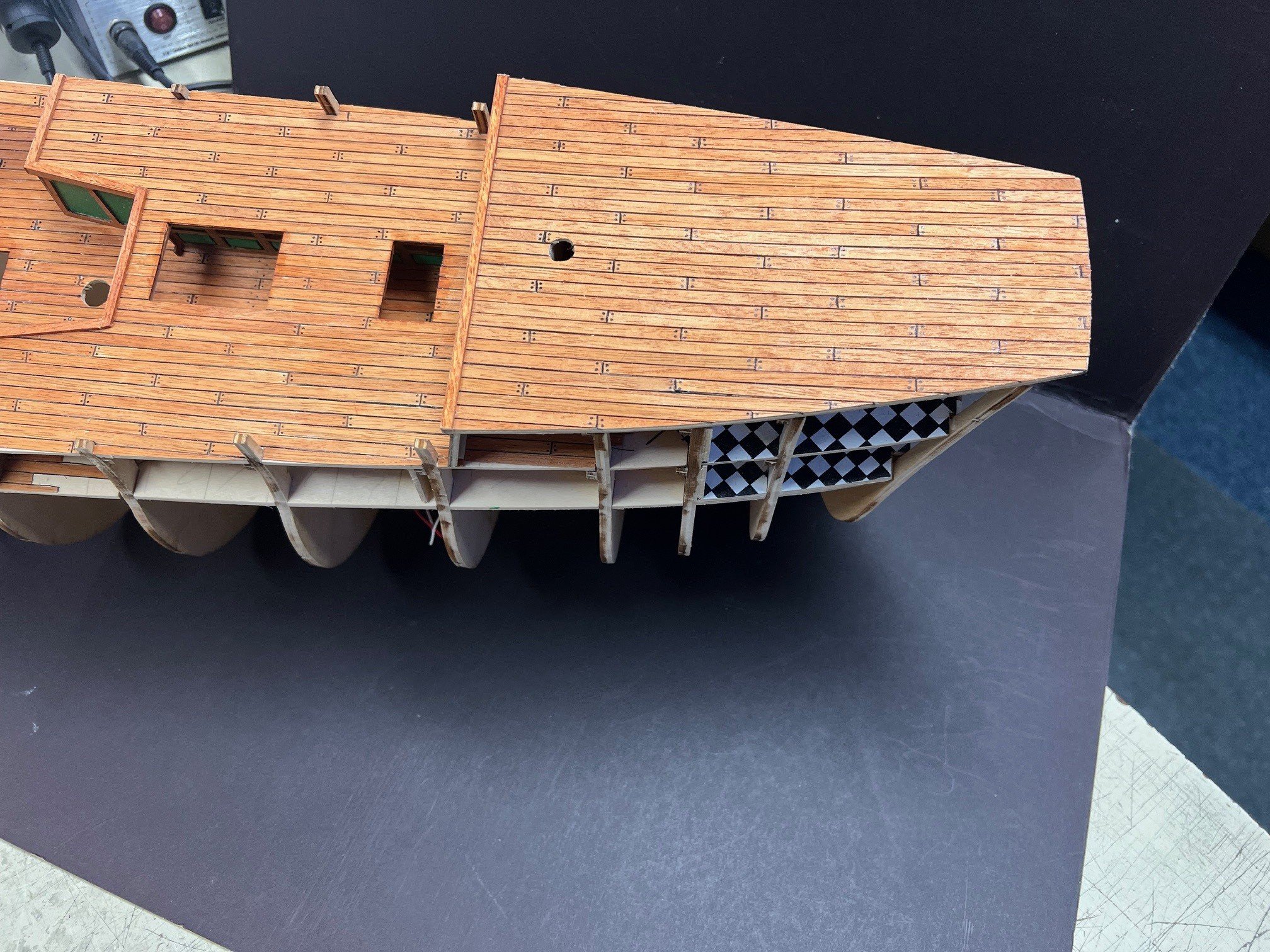

As Ed stated in his build of this ship, not sure how much of the rear cabins are going to be visible so went for black and white diamonds. Cheated a bit on this. Painted the white base then marked the lines with pencil. Overdrew them with the Staedtler and inked them in. Did find some vinyl dolls house flooring which was the exact size I wanted but decided I would get more satisfaction from doing it the other method.

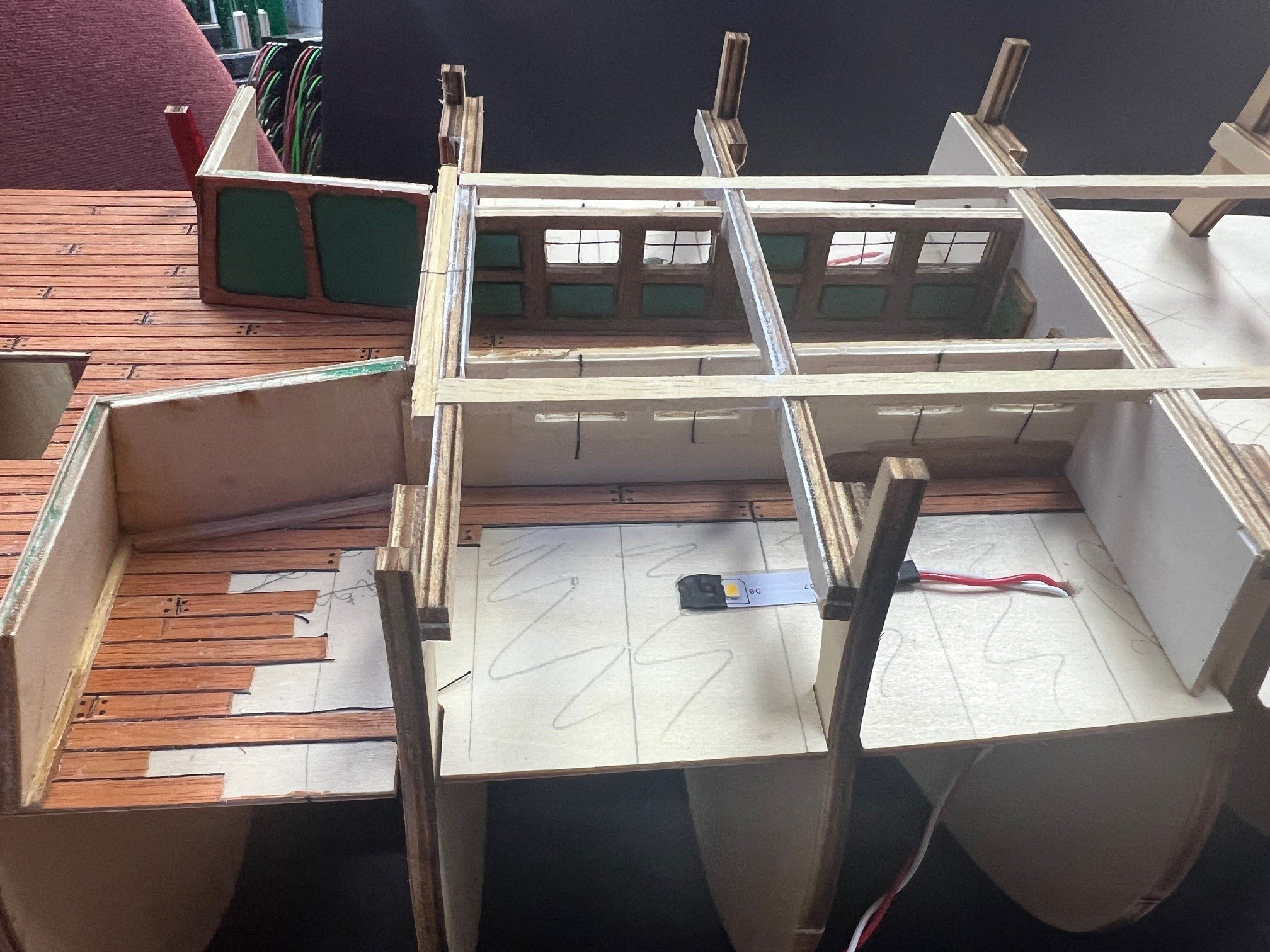

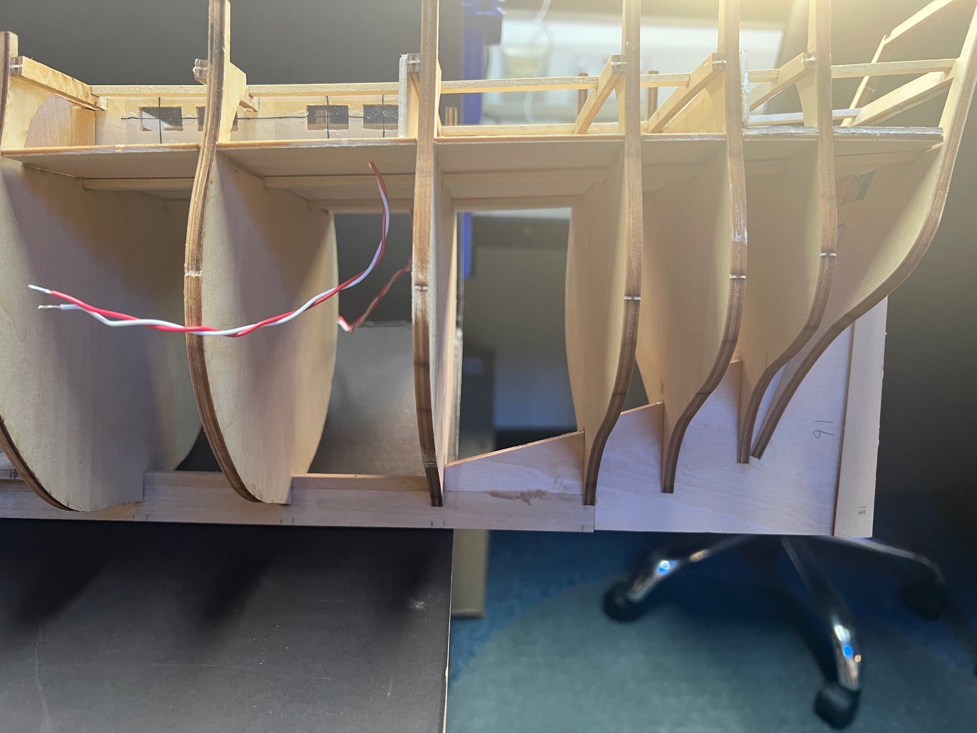

I am hoping to open up light into the cabins if I can later in the build so in hopes that I can, I have added LED lighting under the cabin roof.

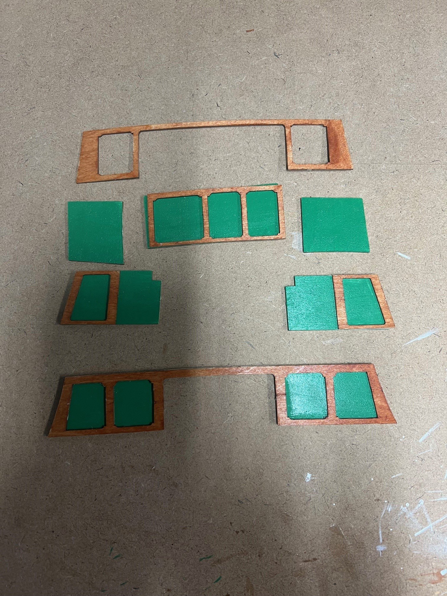

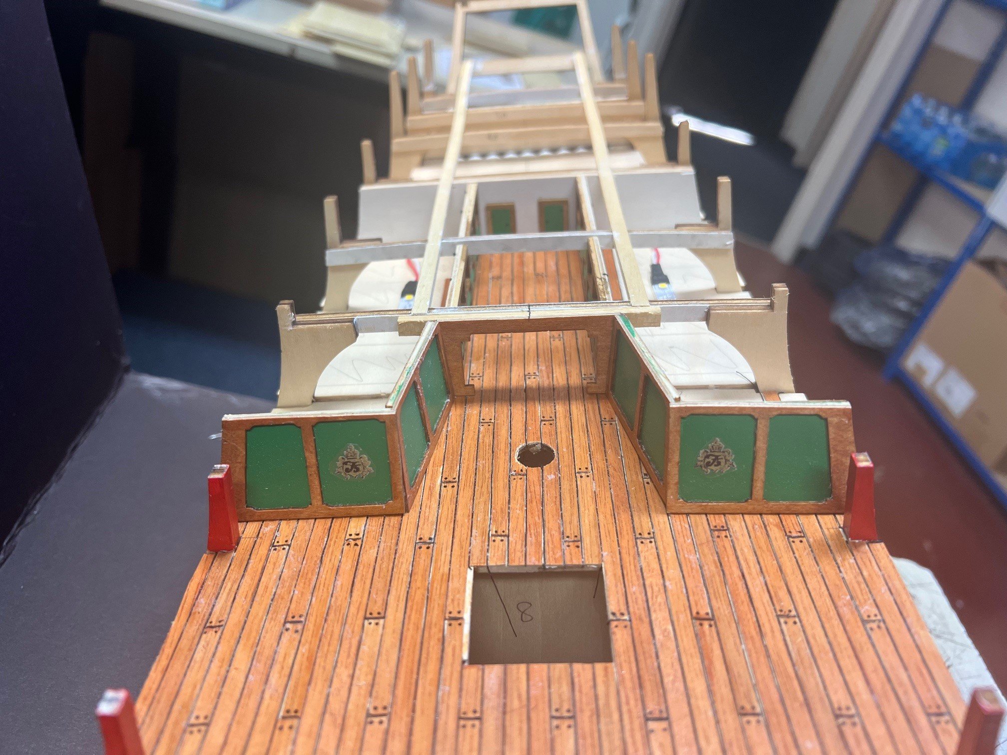

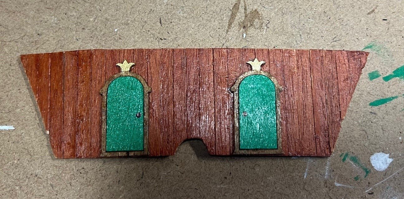

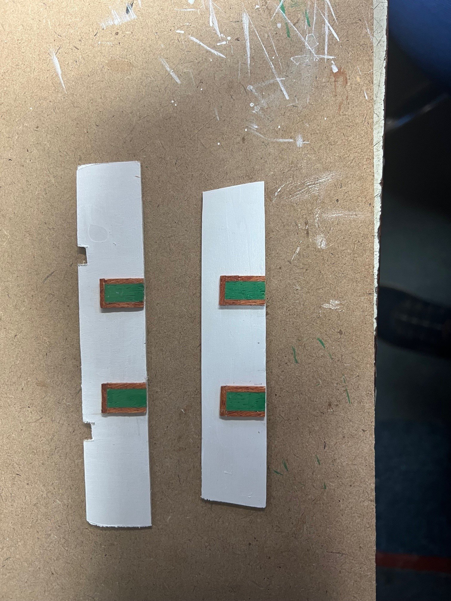

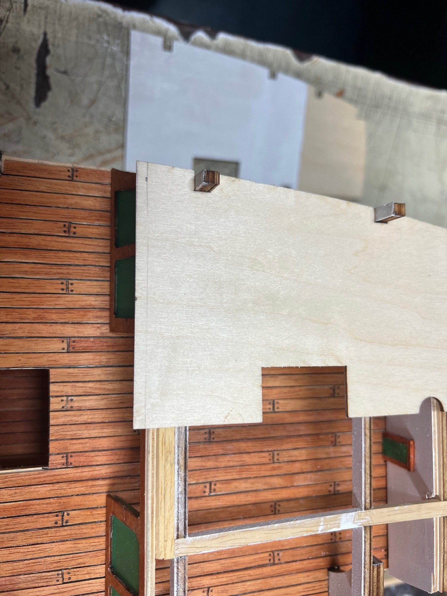

Next up is to add the centre bulkheads on the main deck. As Ed did, I am making them longer and adding sides.  I want to light the ship up, so I cut 3 windows into each side and put an LED light behind them. I used cotton for the window crosses and added a piece of acetate to keep them in place and give a bit of blur to the LEDs. Added 2 doors to the rear bulkhead.
Fixed them in place along with the kit supplied bulkheads. Had to reduce the height slightly to account for the planks. I used a spacer to get the correct depth to the former #7A and small spacer butts so the front bulkheads don’t move.

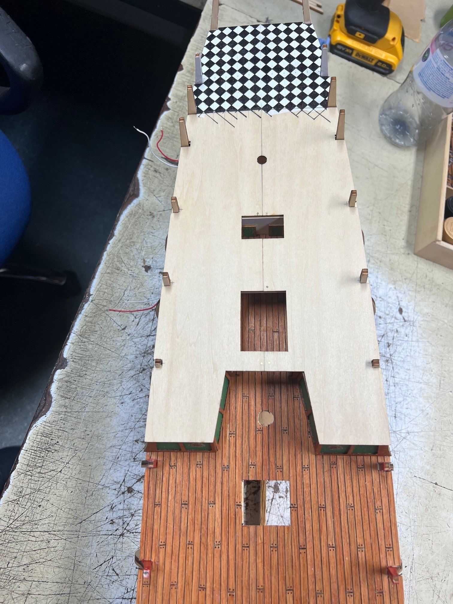

Next up, the quarterdeck. Attached a back bulkhead to the lower deck cabin and checked it fitted before fixing. As with the lower deck, it was slightly out but after a little filing, all was good. Glued and nailed in place which is when I realised the deck didn’t quite reach the end of the rear frame #1. Added floor diamonds and started preparing the planking.
Planking well under way but need to order some more supplies. Made up two more bulkheads. 1 for the Quarterdeck cabin and one to go under front deck. Not sure how far back this will go and if I want side bulkheads. Hoping to add another LED and open 3 cannon ports but on checking the plans, 2 of the ports protrude into the frames. Not sure moving the ports is going to work as they will be out of line with the others and look like a dogs dinner. Back to the original build to see what can be done. Will also see if I can open up the rear cabins in anyway by removing some planking behind the stern gallery.

Front deck back bulkhead fitted. Used a spacer to stop it falling backwards. Front bulkhead also fitted again with a spacer to stop it falling backwards and to give a stop point. Marked the deck with a fitting line to get the correct angle.
Note:  If following this example, make sure the mast fits before fitting the back bulkhead and that the mast hole on the lower deck is filed out before fitting the deck.

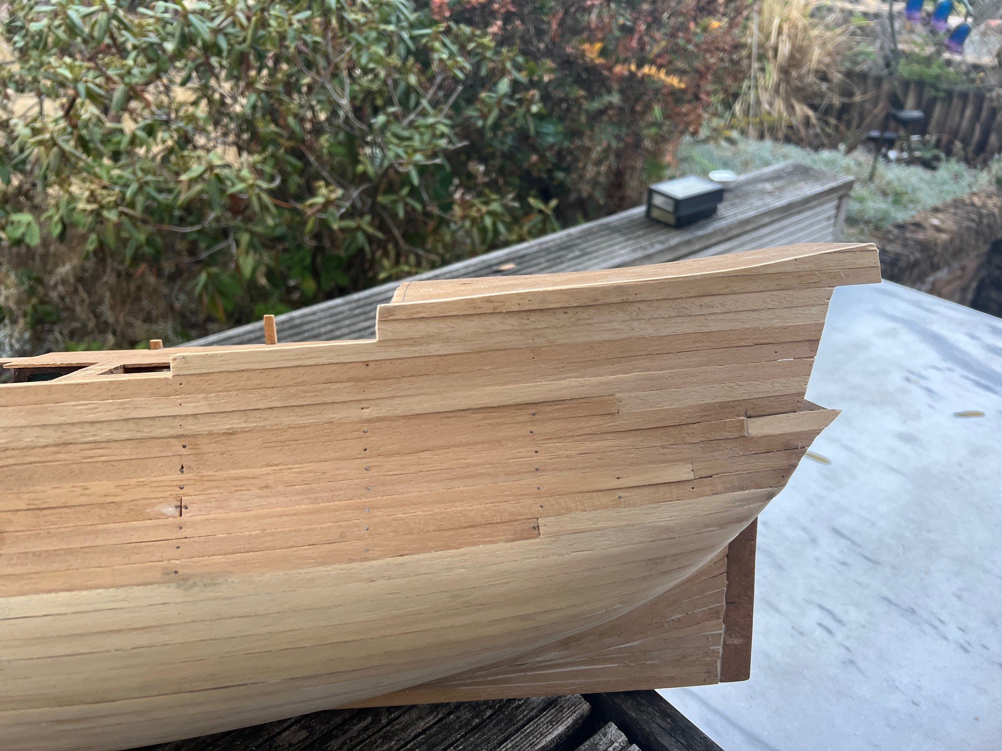

Planking completed except the edges. Need to shape the formers prior to fitting the last edge planks.

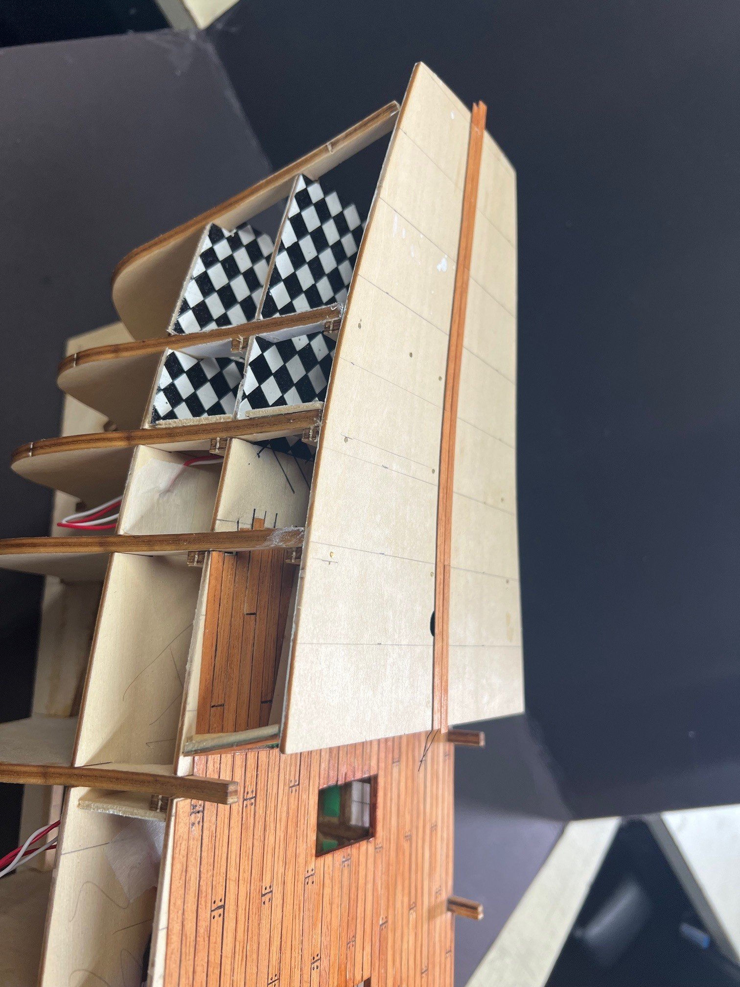

Onto the rear upper deck. Assembled and fitted the last bulkhead which is very tight to the rear mast so check and double check before permanently fixing. The centre of the bulkhead seemed very thin and had a slight bend so added an extra piece of wood to strengthen it. Also added another piece in the centre to give the deck something to bind to and take out any remaining bend in the bulkhead. Deck went on without any dramas and now on to planking.

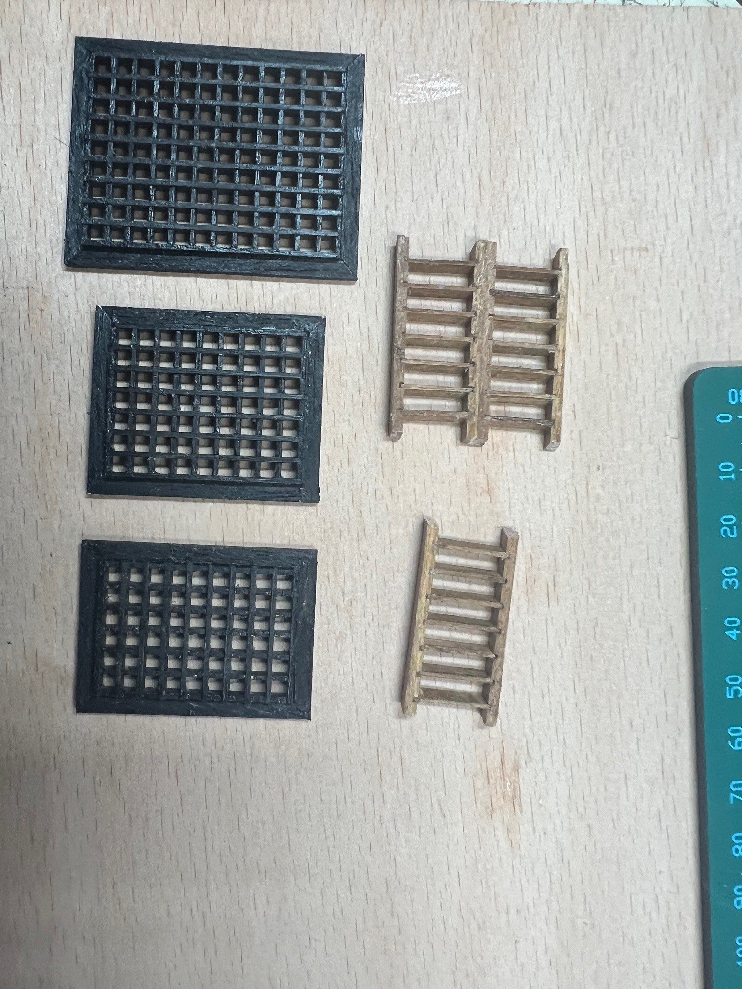

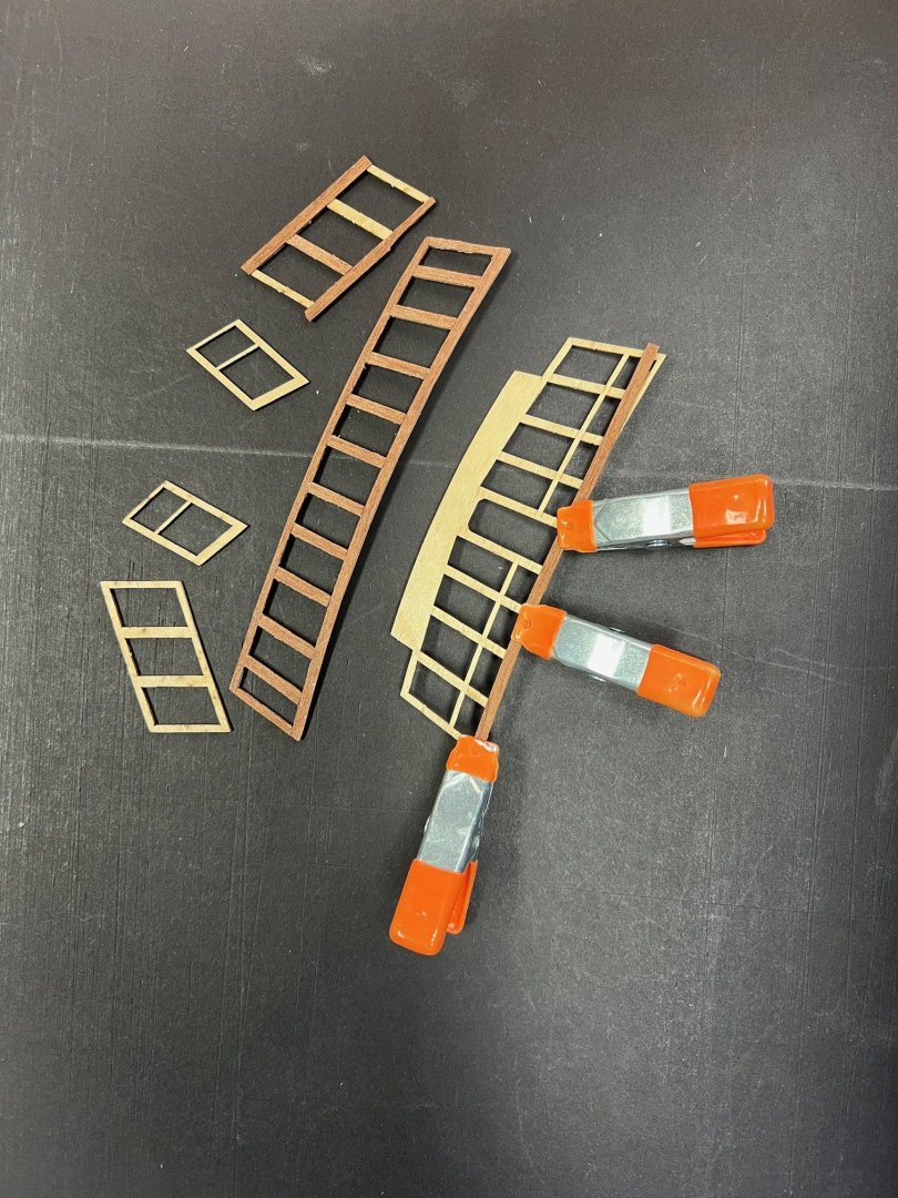

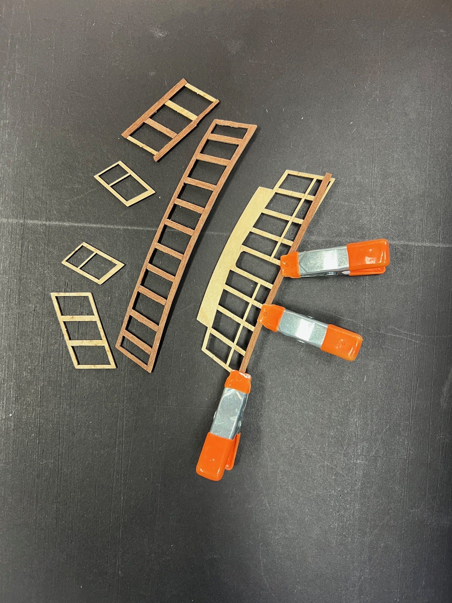

Also built the hatch covers and a couple of ladders. Used large 3mm hole hatches as that will allow better viewing and light from the LED’s. Went for black to give a bit of contrast to the mahogany deck. Made a little jig for the ladders to keep them straight and stained them dark oak.
