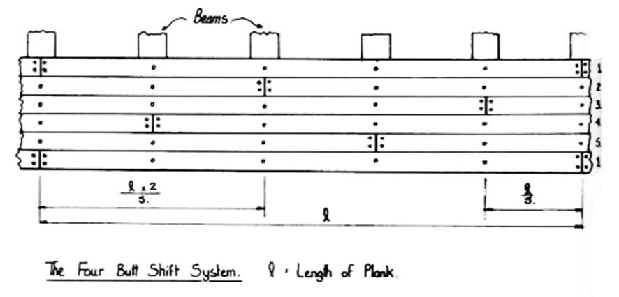

58b7fbdd3d3e6_4-buttshift.jpg.217a2a466ac1f1336d535d7175229e4b.jpg.599c4fac4bbc19e2e9d884482043da18.jpg
This is an example of 4 butt shift system. There is also a 3 butt shift system.

From my personal observations of various ships, I can say that in the real world the shipwrights were less rigorous to adhere to a strict 3 or 4 butt shifts, like it is shown in various books. They were using, what was available at the moment in their yards, at the same time trying to save on the wood.
So, rarely you can see these strict patterns in the real ships.
In my opinion, you can safely butt shift your planks observing rather loosely this 4 butt shift, if you want it (also, the bigger the ship, the bigger the shift, e.g. the Victory and alike would have a 4-butt shifts, perhaps the Constitution 3 butt shifts , a smaller frigate or a brig 2 butt shifts, and so on...
Thank you for this, I assumed that this was just a deck planking layout but It seems that it was applied to hull planking too. I am probably going to make use of this plan coupled with the suggestion by Dziadeck below.

I have decided to go for roughly a 4 butt shift while simultaneously always erring on the side of longer planks rather than shorter planks where a question comes up about where a joint should land. this is a small detail but the intention is to show that the builders in america at the time would have had access to more abundant timber resources than their european counterparts. I have quickly found that landing on a perfect 4 pattern shift very rarely happens. a plank ending near the bow or stern can easily be extended a few feet or a oint landing too near a gun port can be shifted. quickly leading to a lost 4 butt pattern,
in short im using the 4 butt pattern as a guide while working as a ship builder would have...as far as possible.

This is a hull plank layout, as best as I know. But I'm no authority on the subject of deck planking either.

The (few) contracts and specifications I have seen tend to say something like "not less than X between butts of adjacent planks" and "not less than Y planks between two butts on the same beam".
Regular patterns could be efficient when large, open extents were being planked but it must have needed a lot of thought when working around hatchways, mast partners and the like. Some off-cuts might be useful, when filling in between obstacles. Some longer lengths could avoid a butt here or there but not if they threw off the pattern and drove more cutting somewhere else.
