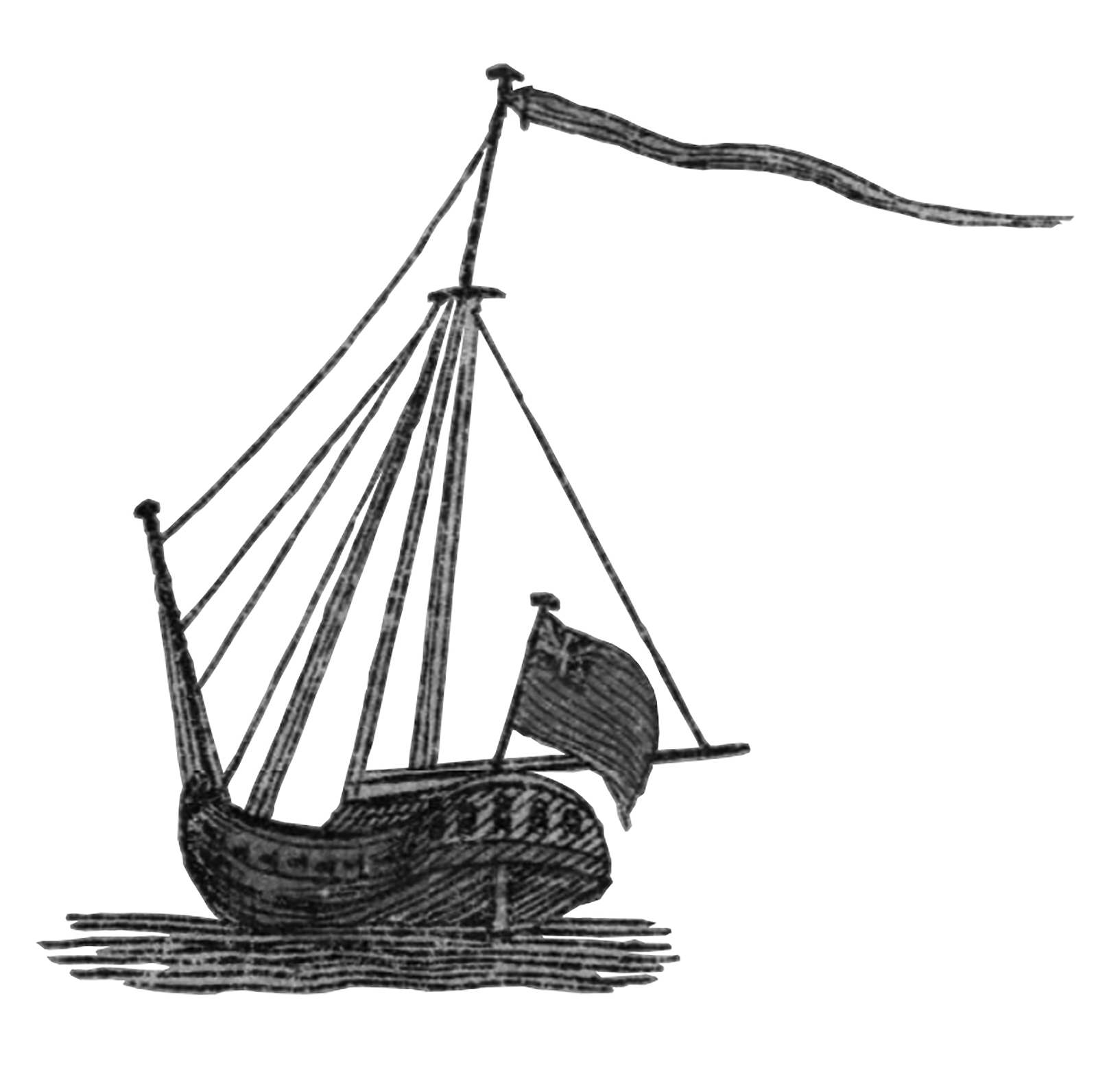

PS. the attached image is of the Sloop Liberty from the propaganda painting by Paul Revere, which is why it is cartooned by added guns and flying the Sons of Liberty flag, instead of the standard British flag.
